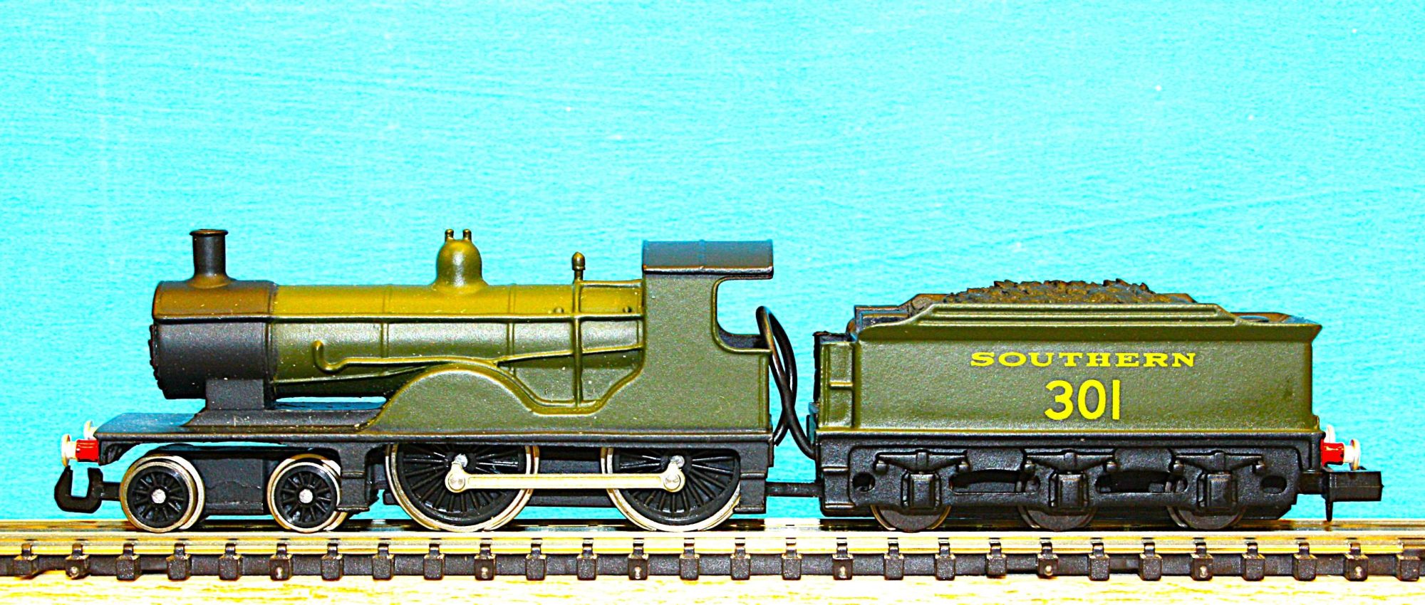

[I don't think the extended smokebox and Urie chimney help the looks of the 'T9' but they made it a better engine.]
