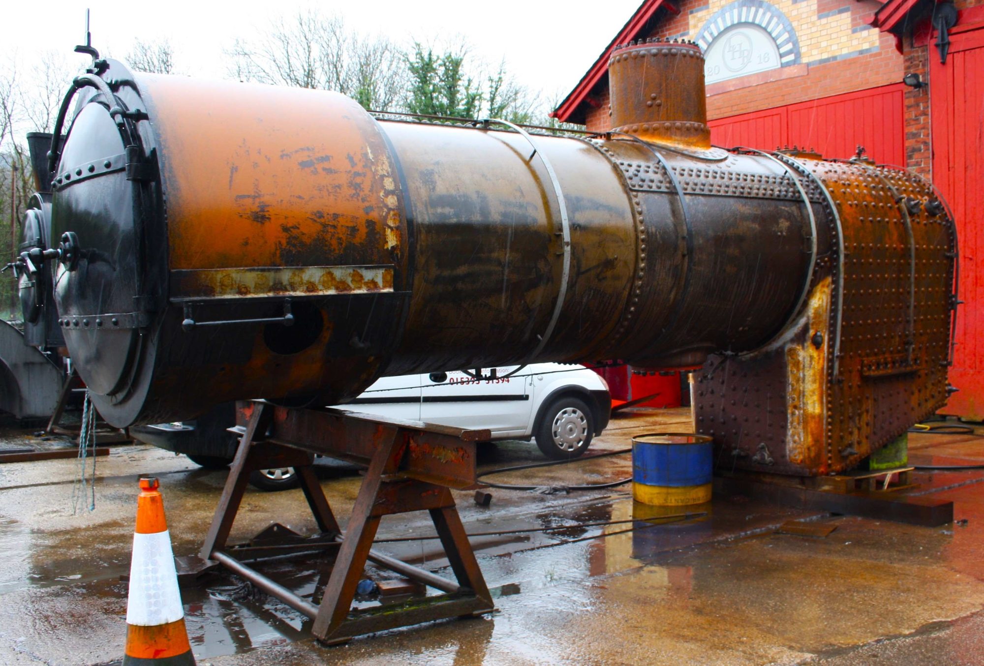

It is important for the live steam for the regulator valve to be collected where the steam is driest, to avoid admitting water to the cylinders.  You know how many locomotives have a rather attractive feature atop the boiler?  With older locomotives it's usually bigger and in later locomotives it tends to be smaller, as the boiler diameter increased over time but the loading gauge normally didn't.  Once the decorative cover is removed it looks somewhat less attractive.  Its purpose is functional - the hottest steam in the boiler rises into a collector in the dome and is fed to the regulator valve, connected to the regulator handle.
[Not much elegance about this - a steam dome without a fancy cover.]

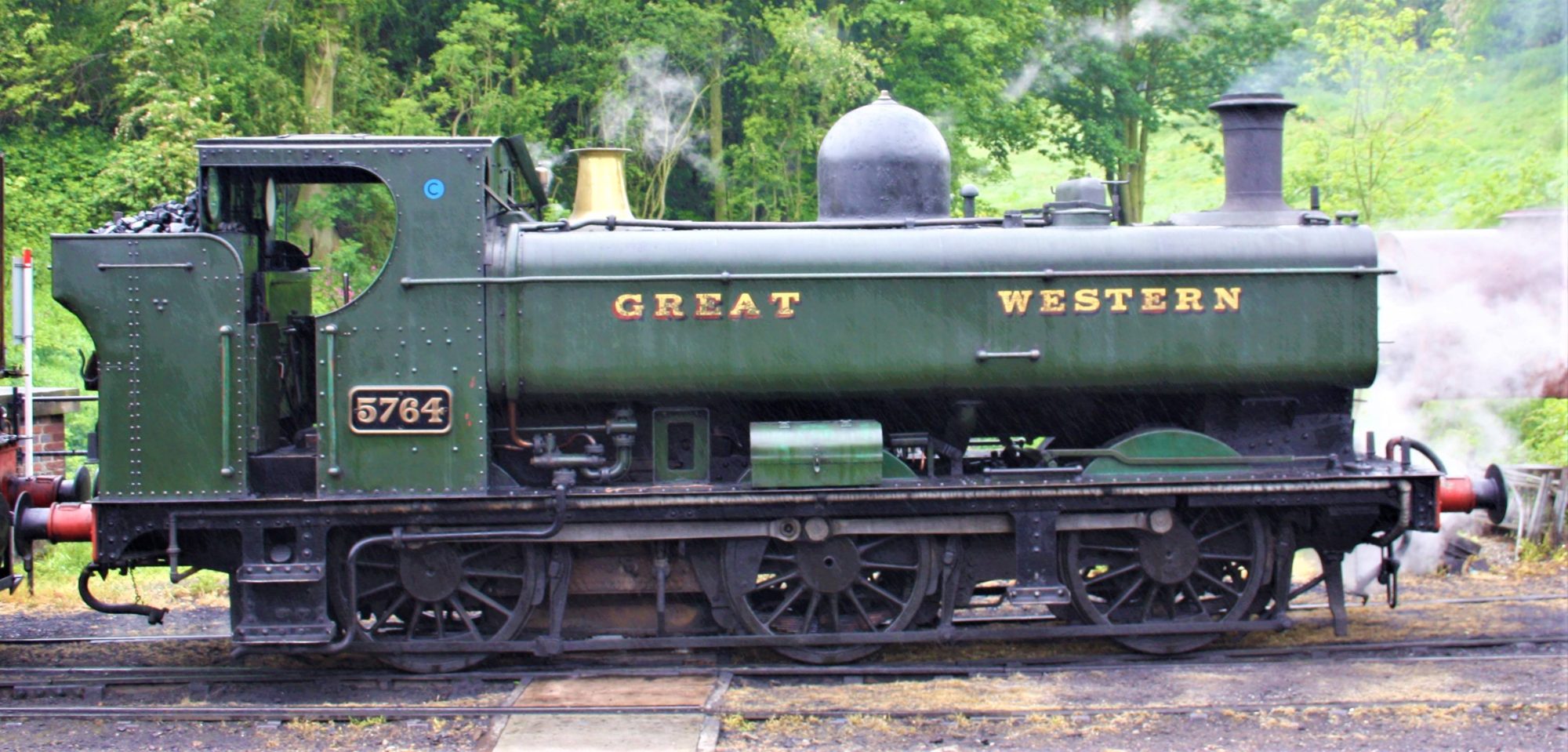

The GWR was interesting (isn't it always?).  Mr Dean favoured large domes and Mr Churchward's carefully designed and magnificently constructed standard boilers were  were domeless.  But the GWR had a legacy of pre-Churchwardian types, many built after the great man's retirement, with magnificently-domed boilers.  Just think of all these pannier tanks.  Mr Hawksworth eventually introduced pannier tank designs with domeless boilers.
[Steam domes come in various sizes.  0-6-0PT No. 5764 has one of what might, politely, be called Jane Russell proportions.]

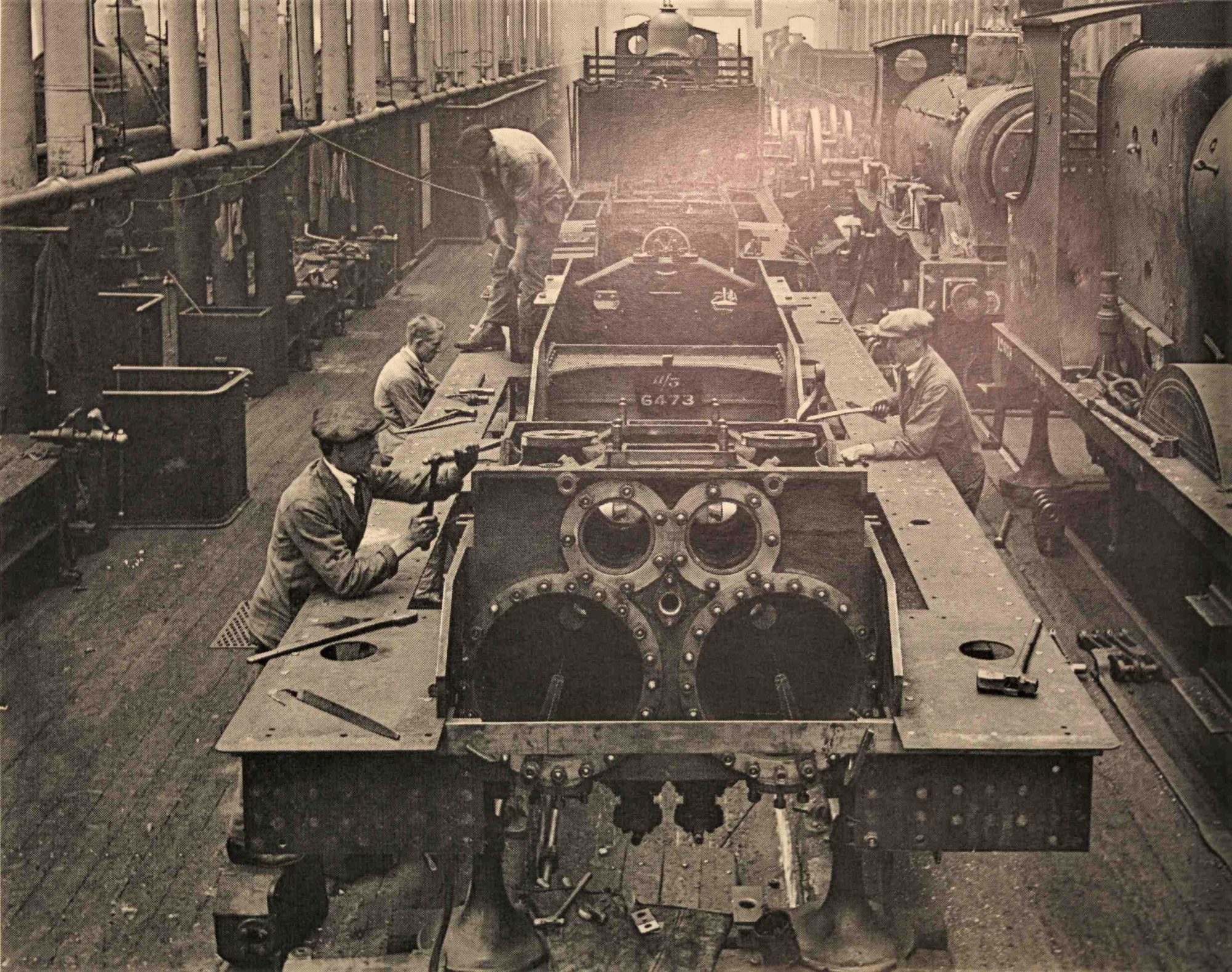

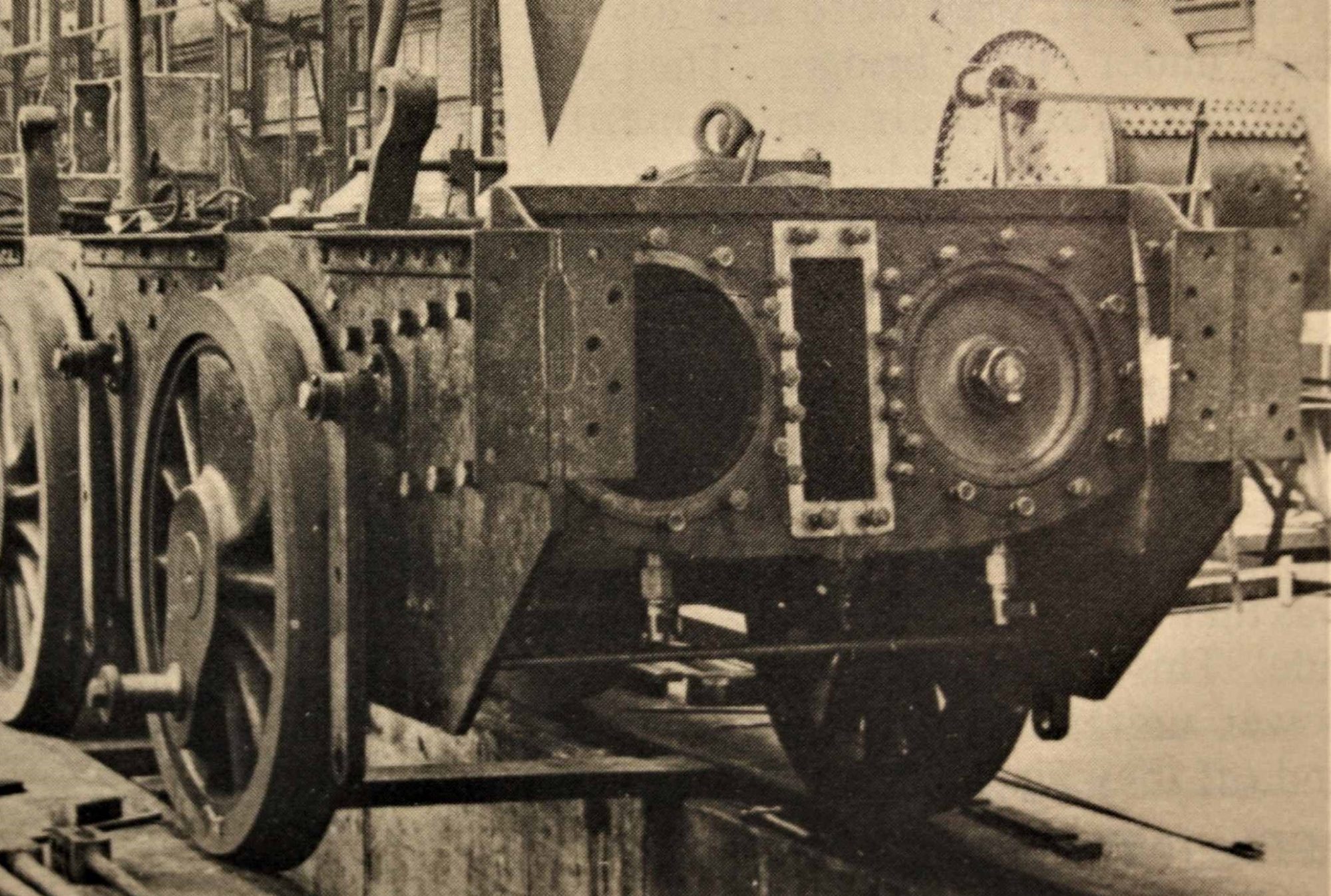

Back to the picturingham of the semi-dismantled 0-6-0ST.  That space in the cylinder block, between the cylinders, is the valve chest.  Incidentally, the arrangement of inside cylinders with a common steam chest between them, as seen in the picturingham,  was patented by Robert Stephenson & Co, in 1841.  Although I consider this short mini-series as entertainment, rather than educational, I'd be super chuffed if anyone reading it comes away with a better appreciation of the contribution to the development of the steam locomotive made by that remarkable man, Robert Stephenson.

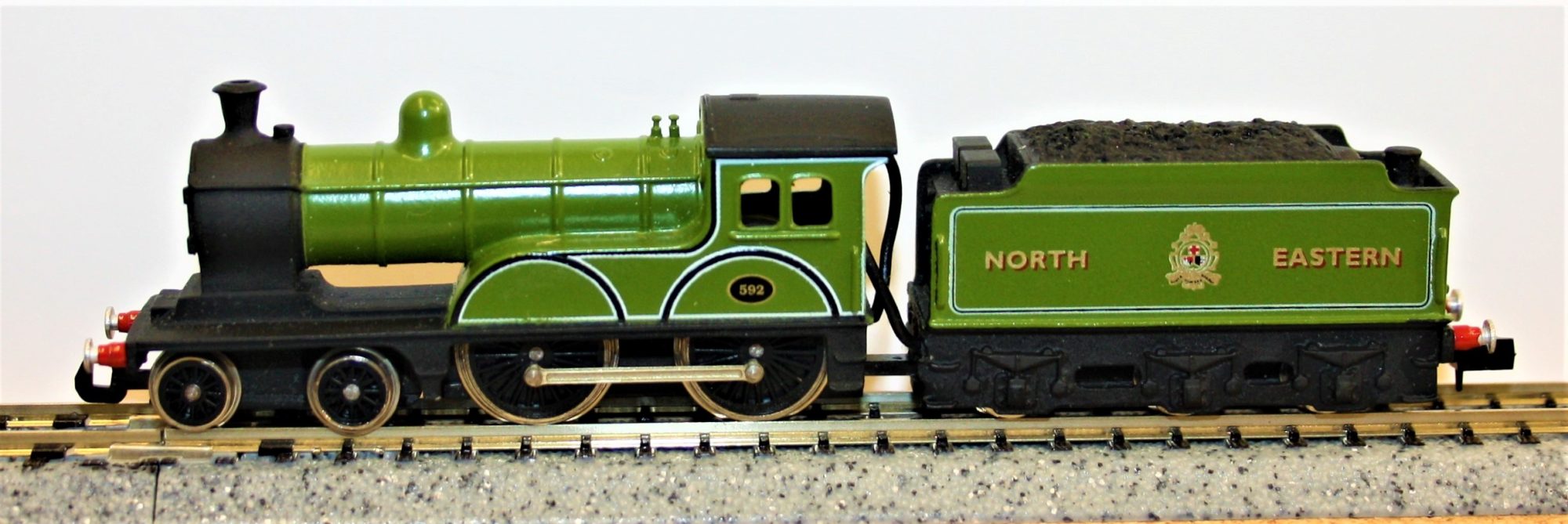

I think the exploits of Wilson Worsdell's 'R' class 4-4-0 for the NER, introduced in 1899, really showed the superiority of piston valves.  The first of the class was put onto a double-manned diagram:- Newcastle-Edinburgh-Newcastle-Leeds-Newcastle, Monday to Friday.  That's 455 miles each day.  She had an easier time of it on Saturdays with a diagram of 161 miles.  Boiler wash-out on Sundays.  This is a total of 2,436 miles each week.  At the time, it was considered that this level of performance was made possible due to the class being equipped with Mr Smith's design of piston valves.  I love an excuse to include a picturingham of a Union Mills 'R' class:-
Even allowing for the many deficiencies of my coarse photography, you might be able to discern that the 'R' is an inside-cylinder locomotive.  Yes, some traditional-looking British inside-cylinder locomotives had piston valves, hidden between the frames.  The multitude of MR/LMS '4F' 0-6-0s can certainly be called 'traditional' - here's one of the class being erected:-

The '4F' has 20 inch diameter cylinders.  As the picturingham shows, the space between a locomotive's frames is limited.  We start off with a gauge of 4 ft 8 1/2 in., take off a bit for the width of the frames, then another bit for the clearance between the wheels and the frames. The flange roots of the wheels cannot be hard against the inside face of the rails, so we need to add another bit of clearance to allow for the 'coning' of the wheel tyres to be effective.  All these bits add up and act to restrict the distance between the frames.
Which means the space between the frames is a constraint on the diameter of the cylinders of an inside-cylinder locomotive.  I had an agreeable time looking through some books and the largest diameter of inside cylinders I can find is 20 in., like on the '4F' seen in the picturingham or the powerful GER 0-6-0s later known as class 'J20'.  There are others, but I cannot find an example with cylinders over 20 in diameter.  Do you know of one?

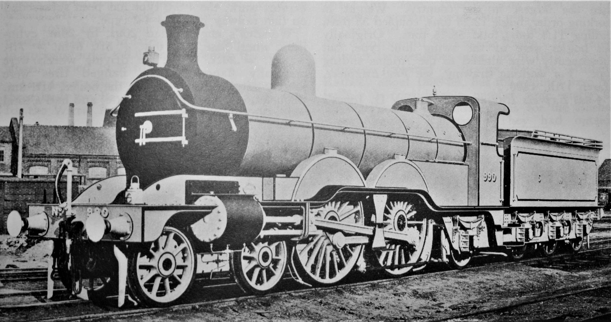

Then along came Mr Ivatt the Elder with his first 'Atlantic', No. 990, happily still with us, which was the heaviest locomotive in Great Britain at the time of its introduction in 1898.
No. 990 was the first British express passenger tender locomotive to run on five axles.  The previous tender engines with 10 wheels, David Jones' 4-6-0 locomotives of 1894 for the Highland Railway and William Dean's experimental Great Western 4-6-0, No. 36, of 1896, were for goods traffic.

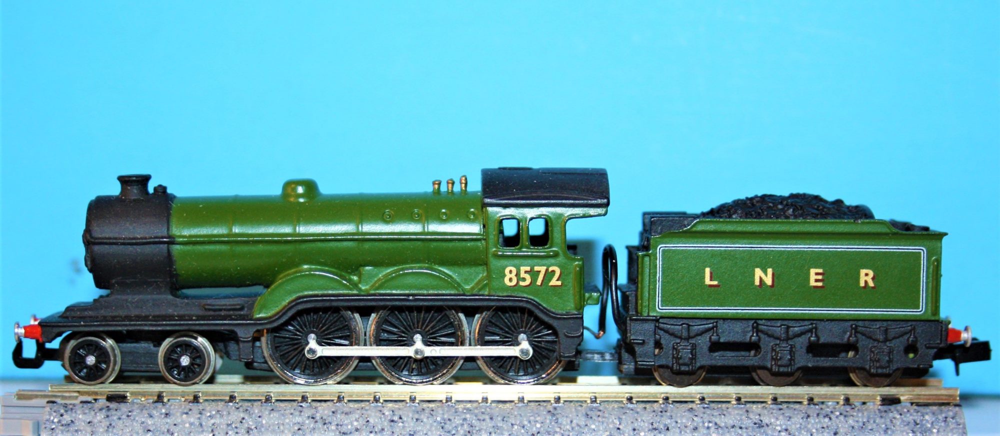

I've got a question for you that you don't need to answer if it at all derails your thread. In the last photo of the model 4-6-0, we see the centre drivers being closer to the front drivers than the rear ones; that is, they are not quite in the middle. It seems to me that there are many 4-6-0s that share this asymmetry such as the various class 5 locos. Yet, in Pacific wheeled locos, the middle drivers are usually right in the middle.
Webbo
Hiawatha
@Webbo I think this was done to get even weight distribution on the three driving axles while on Pacifics this could be achieved by the distance of the trailing axle.
