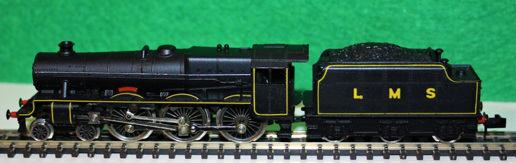

[A '5XP' or 'Jubilee' 4-6-0.  This one is by Rivarossi for Peco and her performance has not resulted in 'considerable recrimination'.  Quite the opposite, in fact.}
But, what was wrong?
It's always nice to quote from David L Smith, who saw these engines at work in Scotland 1935:
'A Newton Heath fireman, leaving Glasgow Central with the 4.30 pm, told me to watch the exhaust as they pulled out.  Sure enough, in the centre of the column of white steam was the thin black column of water, like the lead in a pencil.'3
Being a good engineer, Mr Stanier did not forbid criticism of his designs and the problems were identified.  The 'Patriots' had 24 flue superheaters, but the new design had the traditional Swindon two-row, 14 flue superheater with a surface of 227 sq ft.  It was found that this resulted in a 100oF (38oC) reduction in steam temperature compared with the 'Patriots'.
