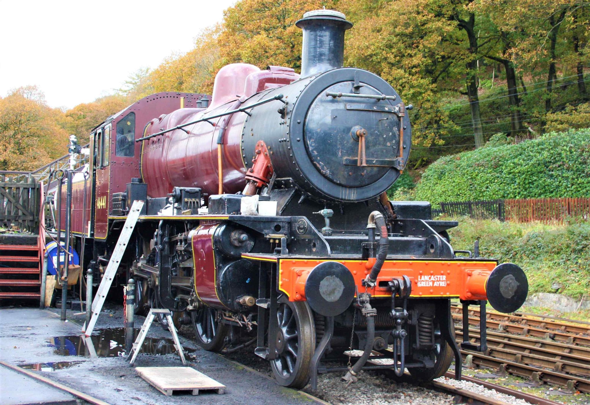

[But not on the '56xx' class, as can be seen from the valve chest covers below the smokebox.]

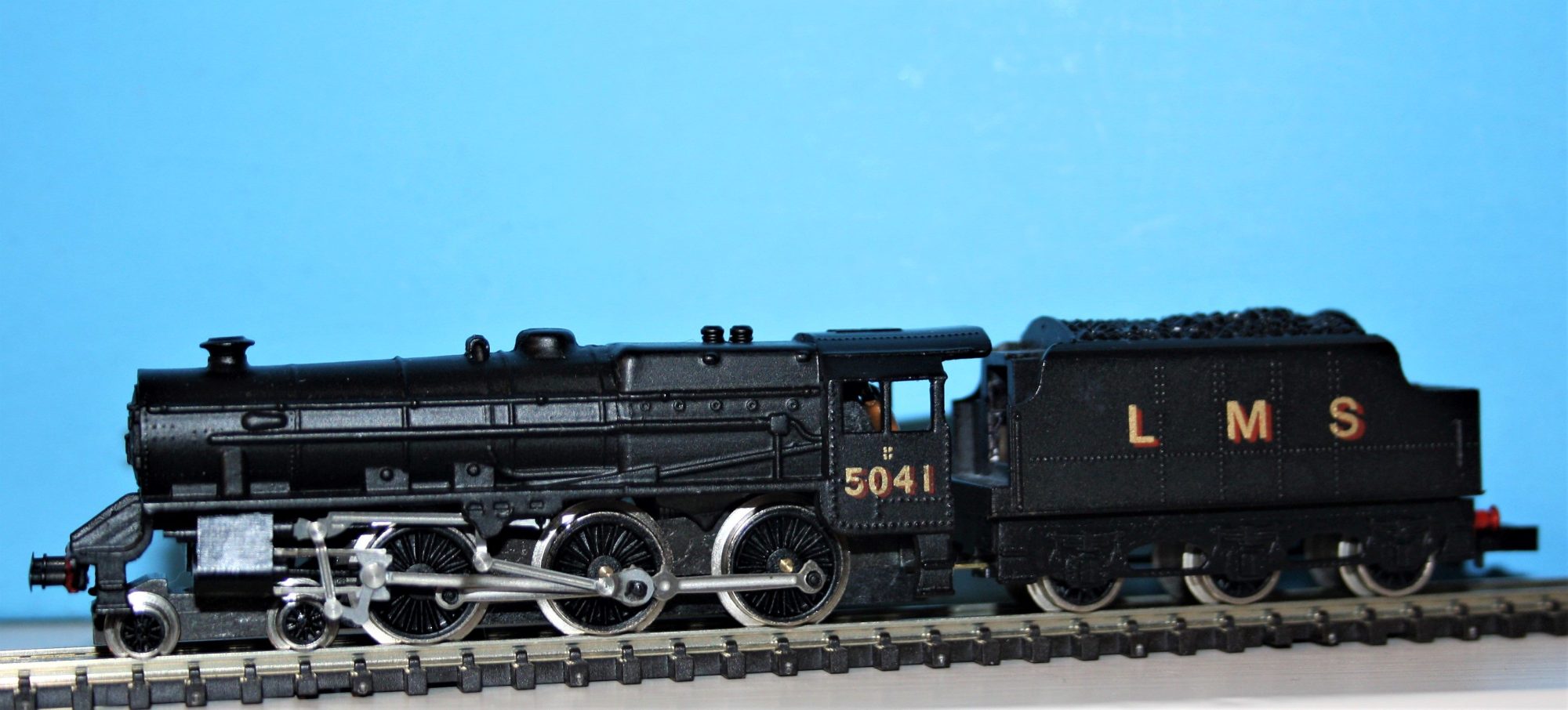

The LMS '2P' 4-4-0 class of 1928 was economical and had low maintenance costs.  It also had a performance below what could be reasonably expected in 1928. The similar looking and similarly dimensioned 'D1' and 'E1' 4-4-0 rebuilds on the Eastern Section of the Southern Railway were amazing locomotives with a truly sparkling performance. There were several reasons which contributed to the disparity in performance and I think we'll return to this case study later1 (so no picturingham of a Union Mills '2P' at present). One of these was Derby Drawing Office decided to put the piston valves of the '2P' below the cylinders.  In 1928! Yes, the Midland had put the valves below the cylinders on some classes years before, but there was no excuse for it now.

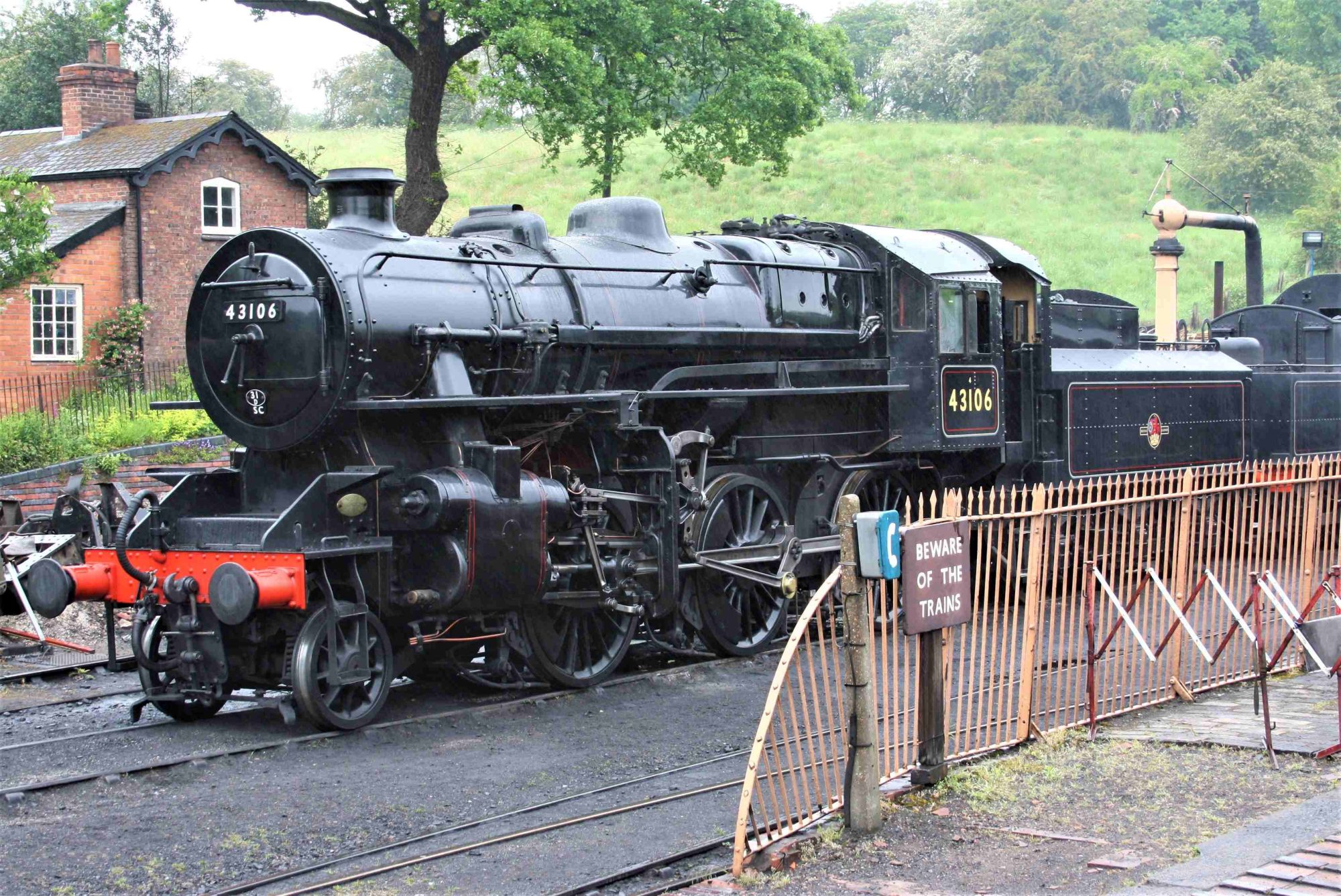

As we have seen, the era of the Big Engine saw two outside cylinders becoming increasingly popular.  As superheating became widely accepted, piston valves became the norm and these were usually located in valve chests above the cylinders.

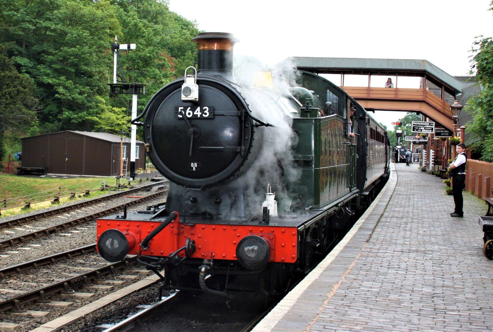

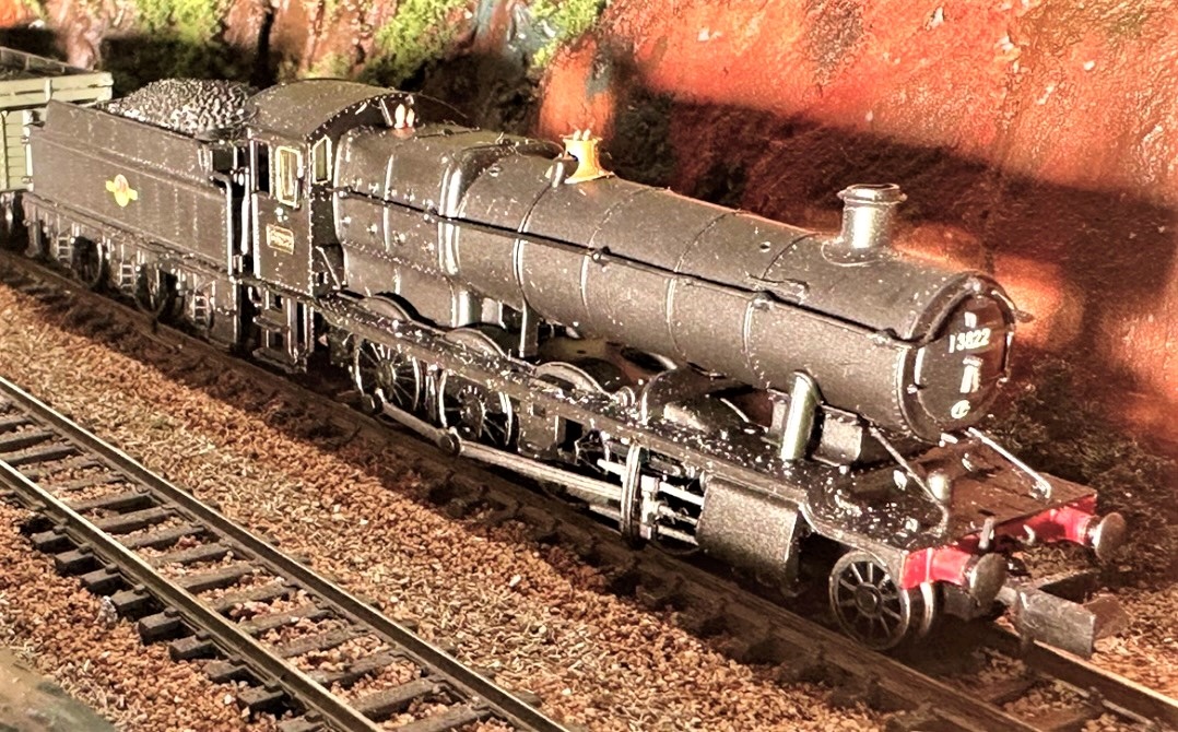

In the earlier designs, including Mr Churchward's, the steam passages went from below the smokebox to the valve chest.
As modellers, we are familiar with what we call outside steam pipes, from the top of the valve chest to the side of the smokebox as seen on this 'Black Five' 4-6-0:-
These were a wizard wheeze to allow the live steam to take a more direct route from the smokebox to the valve chest.  What we see on our models are just nice covers, the actual pipes are more work-a-day as can be seen:-
[This picturingham shows the steam pipe going from the smokebox to the top of the valve chest.  Inside the smokebox, the steam pipe is connected to the superheater header. Special thanks to the wonderful people at the Lakeside & Haverthwaite Railway who kindly indulge me as I potter around looking at their lovely locomotives.]
I'm not sure when these outside steam pipes were first used.  Typical Churchward locomotives didn't have these, but the GWR 'retro-fitted' them to a lot of locomotives from the mid-1920s as well as making them standard for new construction.

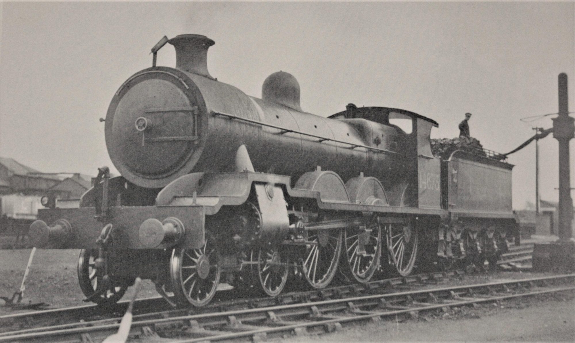

Mr (later, Sir Nigel) Gresley's 'H2' and the first 20 'H3' 2-6-0s2 for the GNR did not have outside steam pipes. These appeared from No. 1660, built in 1918, onwards and then became standard for both classes.
An earlier application of outside steam pipes can be seen in James Manson's two superheated 4-6-0s of 1911 for the G&SWR, Nos 128 and 129:-
[This old photograph clearly shows the outside steam pipes on LMS No. 14973 (formerly No. 128).  She is in black livery and towards the end of her life.  Withdrawal came in December 1933.  Note no smokebox numberplate, Caledonian 'semaphore' route indicator, and the typical G&SWR water column.]
Please let me know if you can think of an earlier use of outside steam pipes.  This is an important point as it is visible evidence of locomotive engineers becoming aware of the importance of straight and wide steam passages.  To be fair, Mr Churchward had a good appreciation of this.  In later years, improvements to the 'steam circuit' would assume great importance.  I think we are likely to return to this topic later and we might even meet a jolly clever French chappie.

Mr Ivatt the Younger's '4MT' 2-6-0 is a good example of a thoroughly modern two cylinder locomotive. The high running plate gives us a SuperSpiffing view of her large piston valves atop the cylinders, with nice straight steam pipes leading to the sides of the smokebox.
I suppose, for us 'N' gauge modellers, that's all we really need to know.  This ultra-brief mini-series attempts to go slightly (and 'slightly' is important here) beyond what we really need to know, so that we have some idea of what causes our lovely little locomotives to look the way they do.
