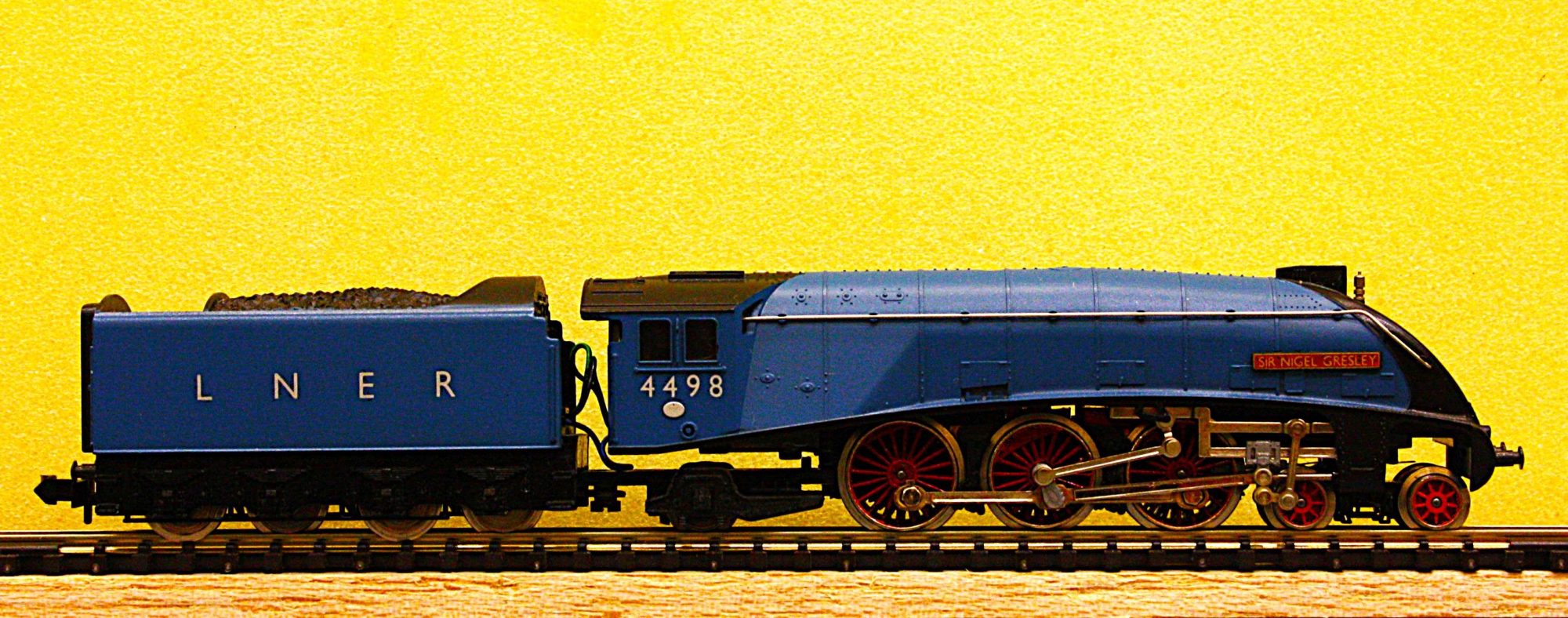

[Sir Nigel Gresley's masterpiece - the 'A4' 4-6-2 of 1935, seen in post-War condition.  This class was the last LNER-designed 'Pacific' to have the ALCO/Altoona/Gresley 'rationalized proportions'.  Later designs varied and we might consider this later.  The excellent 'A4' boiler featured a combustion chamber.]
The 'R' is by Union Mills and the 'A4' is from Minitrix.  Her eight-wheeled tender appears to have been over-demanding of this coarse modeller's dexterity.

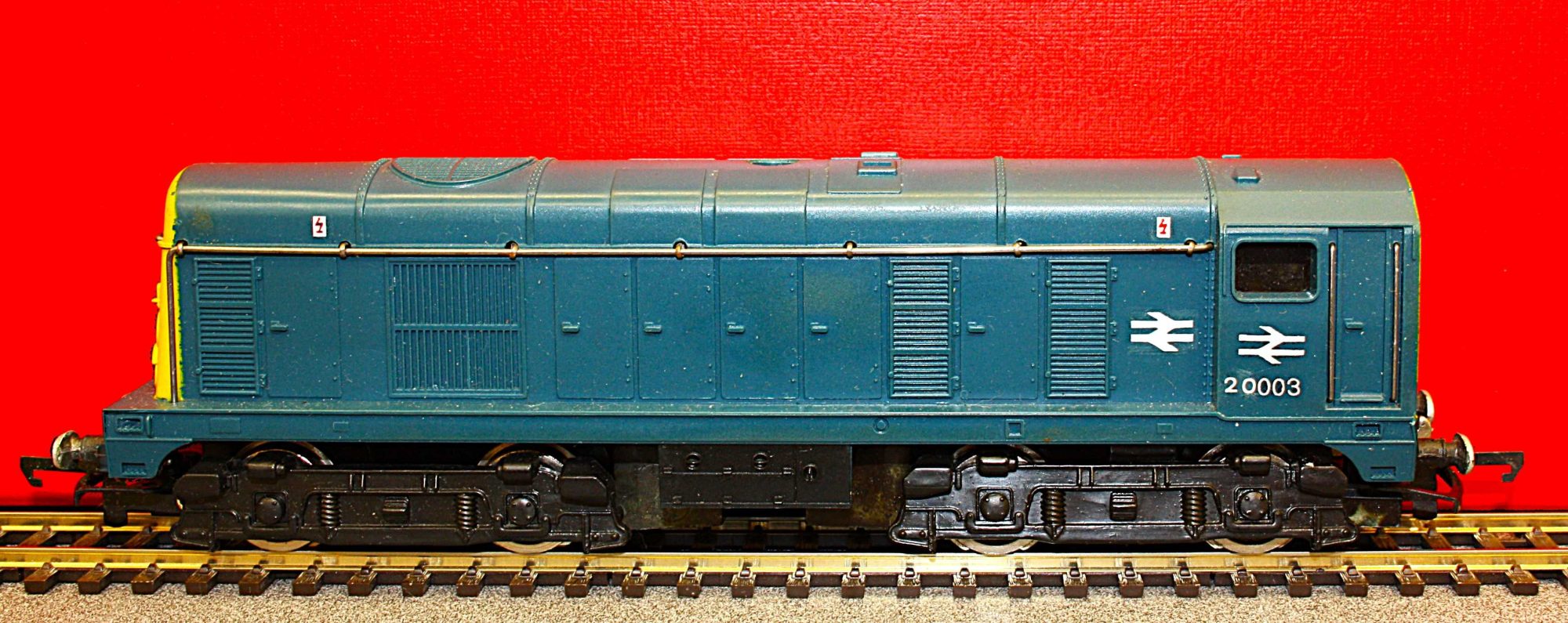

A Coarse Guide to the Steam Locomotive for 'N' Gauge Modellers - Part 30
Hello Chums
'Something for Nothing?'
This diversion is so long that it has a postington of its own.  Viewer discretion is advised as it deals with infernal confusion engines and (clothes peg on nose time) SuperSmelly diesels.  It is intended to help make a point about the quest for efficiency but can be avoided happily if desired.
Not much about motor bicycles this time - we'll start with motor cars instead.  Hopefully, we'll get to trains later.  For a while the supercharger (or 'blower') was in vogue.  Driven off the crankshaft, this was a contraption that compressed the inlet charge for induction, resulting in more petrol/air mixture in the cylinder.  This cause a fiercer explosion and a stronger power stroke, allowing your 'Blower Bentley' to thrash the opposition.  A benefit indeed.  Incidentally, WO Bentley was not enthusiastic about supercharging and there was a lot of private development work done.
But the engineering cost (why is there always a cost?) for this benefit was a drain on crankshaft horsepower (hp) to drive the supercharger and, of course, the complexity, and financial cost, of the supercharger.  For racing, providing one had a wealthy sponsor, the latter was liveable with.  As for the former, providing the additional hp obtained exceeded the hp used, the supercharger was a benefit.
Motor bicycle moment; Georg Meir won the 1939 Senior TT with a supercharged BMW flat twin.  Dashed unsporting conduct and jolly bad form.  Post-War, blowers were banned.
Superchargers never really caught on for private motoring as the additional hp obtained was hardly worth the costs for road use.
But what if the benefits of the supercharger could be obtained without a drain on crankshaft hp by making use of the residual power in the hot exhaust gasses that were otherwise going to waste?  The costs would reduce to simply be the cost of the apparatus and the turbocharger arrived on the scene.  Some motor cars have these and the young-at-heart motorists that particularly enjoy them usually refer to them as 'turbos'.
A much, much more beneficial use of turbochargers is for diesel engines in commercial road vehicles. And, of course, the SuperSmelly diesels that run on rails.
[This English Electric 'Type 21', probably the most successful of the 'Modernisation Plan' diesel classes, has an 8SVT engine developing 1,000 hp.  My late Father-in-Law was an engineman at Inverness and he was particularly impressed by this class, considering them powerful and reliable locomotives.  The model is by Wrenn and is based on Hornby-Dublo tooling.  Someone, not me, has done a magnificent re-numbering job.]
The English Electric designation - '8SVT' - can be explained easily. The number is the number of cylinders, 'S' means supercharged, although it's actually turbocharged, 'V' is the engine type (other types have different letters - 'K' is an example - and 'T' is for traction use.
It was discovered that compressing the inlet charge caused it to heat and a cooler, lower density charge is more efficient, so an 'intercooler' was added to some engines to cool the charge.  This is designated by a 'C' (for cooling) - 8CSVT. A turbocharger and intercooler can make a diesel engine more than half again as powerful than in a normally aspirated state.  This is considered to be well worth the cost associated with the apparatus.
Which takes us to the point.  'Something for nothing' is difficult to obtain in engineering.  Rather, it is all about the cost to benefit ratio.  We'll return to steam in the next part for a first look at an example of the quest for economical increased efficiency.
'N' Gauge is Such Fun - as is Hornby-Dublo and Wrenn!
