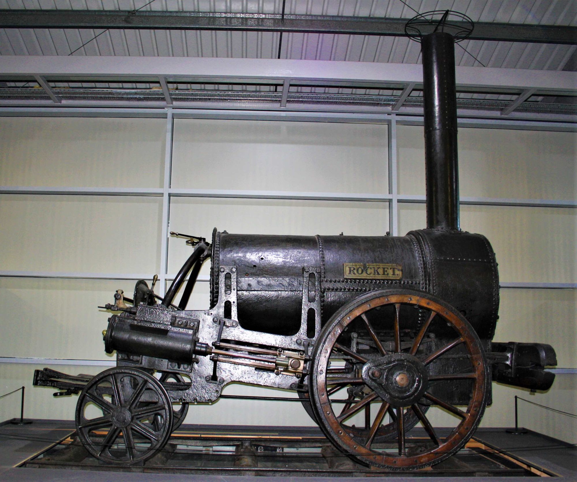

We all know Rocket – a yellow locomotive with a separate tender.  A horizontal boiler, with a chimney at the front, mounted on wheels.  Driver and fireman together on a footplate behind the boiler.  Remove the adjective 'yellow' and the description could equally apply to Evening Star.  Even on the outside, Rocket set the norm for the steam locomotives that followed for more than 130 years.  And what is in the inside is even more important.

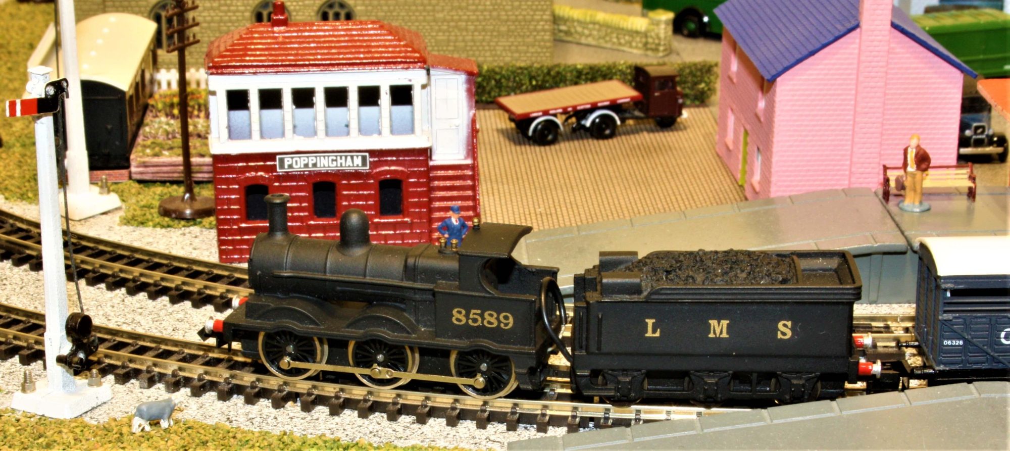

[This picturingham shows Rocket, somewhat altered, in her final condition and her tender is missing.  Not yellow now!]
So, we start with Rocket.  Not the first steam locomotive and not even the first steam locomotive built by a Stephenson.  The investigation of pre-Rocket locomotives is a fascinating subject, more akin to the study of iron dinosaurs than iron horses.
As Rocket is fundamentally a horizontal boiler on wheels, we'll commence with wheels.
Right-o, as you know, Rocket looked like this, Oo – a pair of large diameter wheels at the front and a pair of smaller diameter wheels at the back.  Soon after Rocket, there were oO variants (Robert Stephenson & Co's Planet of 1830).  There were also OO locomotives, an arrangement that was also used on some pre-Rocket locomotives.

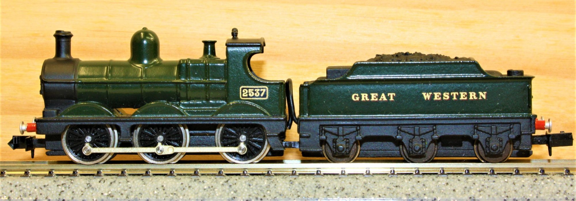

Here is a practical example of what, when the 'LNWR 18-inch Goods' (commonly called Cauliflower) class was introduced in 1880, was known as a 'six wheels coupled* goods engine'.  And in Whyte notation a 0-6-0.  Much easier!
[No little wheels and six big wheels in the middle makes this Union Mills locomotive a 0-6-0.  Flossie and an interested passenger view proceedings.  Signalman Farmer stands at the bottom of his Lone Star signalbox's stairs.  He's not happy with the equivocal aspect of his Up Starting Signal.  Time to call out a S&T man

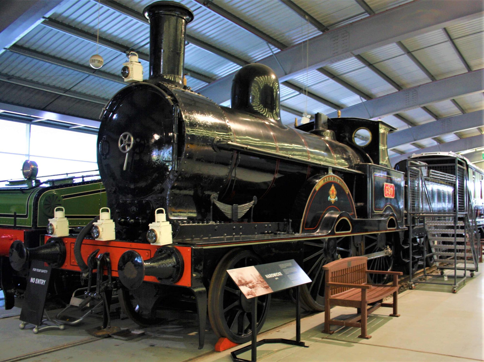

[Probably the most famous of Mr Webb's 2-4-0 locomotives for the LNWR, Hardwicke of !892.  A later development of the pioneering 1876 locomotive but, fundamentally, similar.  By this time the use of inside steel plate frames was pretty much normal practice.]

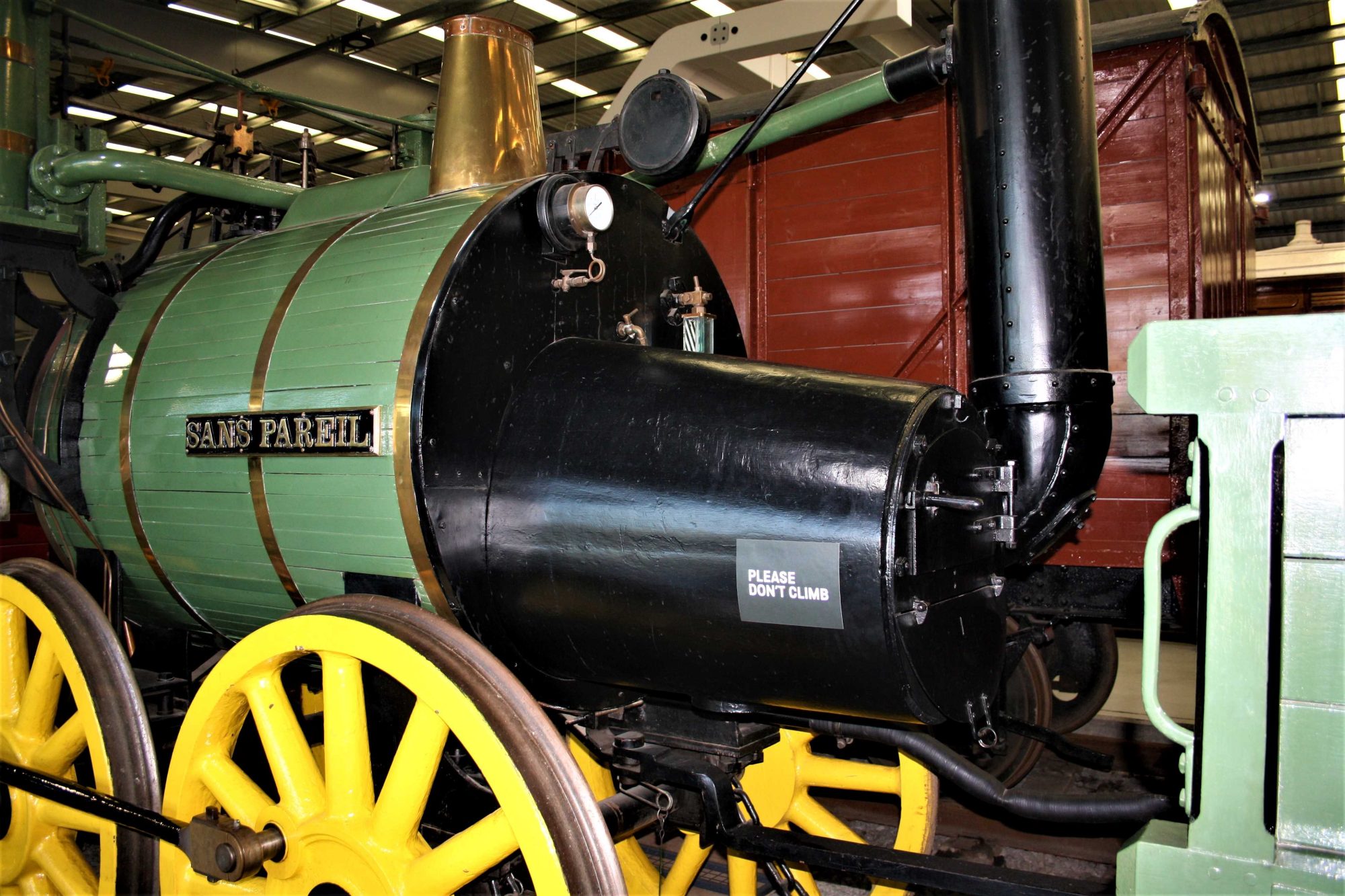

[This is a replica of Timothy Hackworth's Sans Pareil, which came second to Rocket at the Liverpool & Manchester Railway's Rainhill Trials in 1829.  She was a 0-4-0 of, at the time, fairly convention design.  Her defeat at Rainhill marked the beginning of the end of the era of Steam Dinosaurs.  You can see the crank, crankpin and coupling rod.  The use of coupled wheels pre-dated the Rocket era.  However,Sans Pareil had 4d's worth of driving wheel-to rail contact and Rocket had only 2d.]
