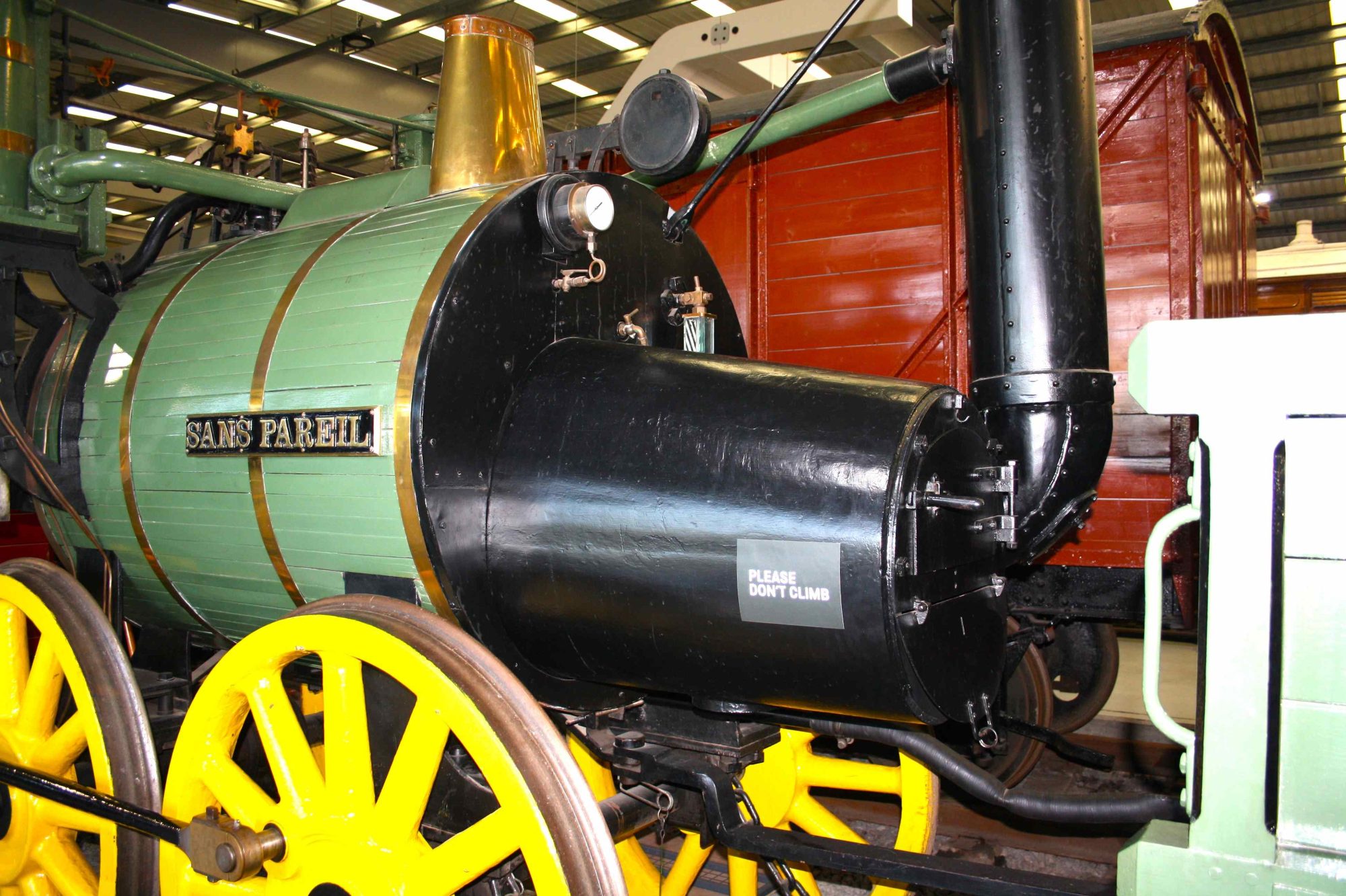

The picturingham shows a replica [note the LNER-style gauge glass] of Timothy Hackworth's Sans Pareil, the original of which was built for the Rainhill locomotive trials of the Liverpool & Manchester Railway in 1829.  This is a good example of a conventional steam locomotive of the time, with its return flue boiler pressed to 50psi.  The fireman stood at this end and the driver was at the far end, an arrangement dictated by the return flue.
Perhaps this is the most convenient time to mention that locomotive boilers are almost always placed horizontally, as seen on Sans Pareil, but vertical boilers have occasionally been used.  Braithwaite & Ericsson's Novelty, also built in 1829 for the Rainhill trials, was of this type.  Vertical boilers were commonplace for other applications for many years, but we won't consider them further.

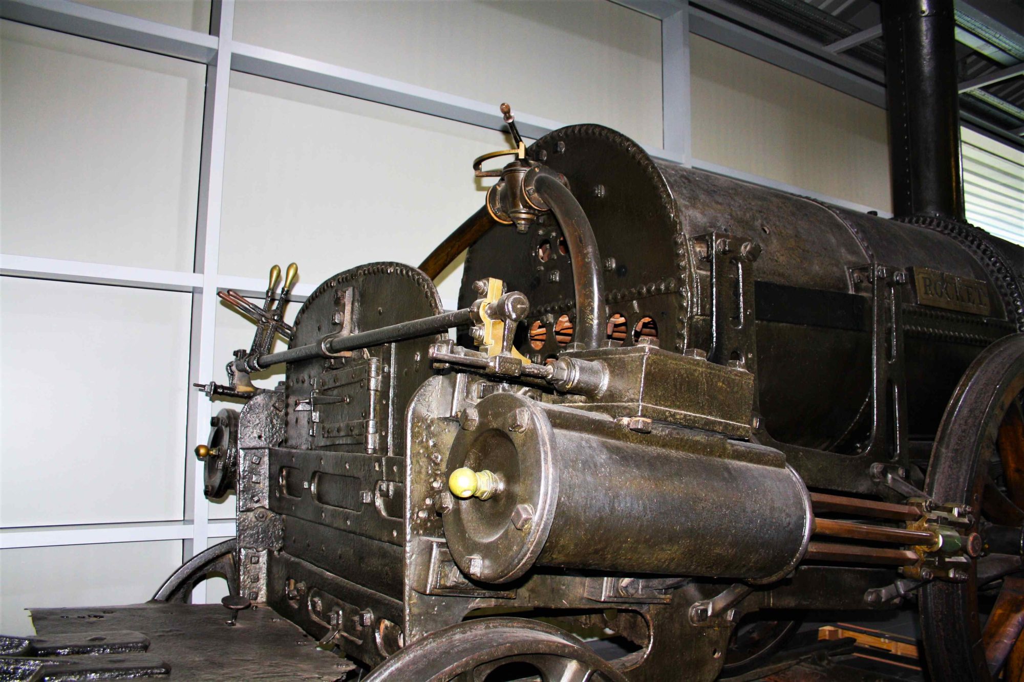

As can be seen in the picturingham, Rocket had its fire in a separate firebox at the rear of the boiler.  There were four copper pipes connecting the water jacket around the firebox to the boiler to allow for circulation of water.  OVS Bulleid had a similar idea with the thermic syphons fitted to his 'Pacific' locomotive classes built for the Southern Railway about 120 years later.
Northumbrian dispensed with the external firebox in favour of an internal firebox contained within the boiler, rather than as a separate component.  Planet also used this arrangement which became standard practice for locomotive boilers and remains so to the present day.

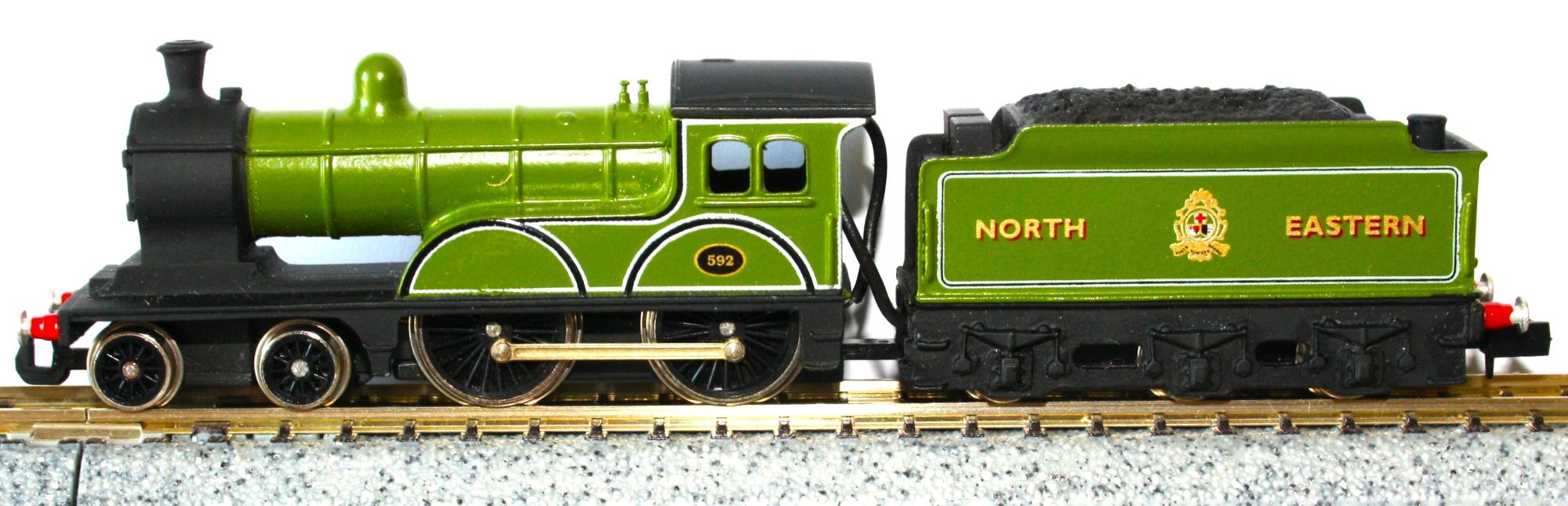

The picturingham shows a typical late 19th century locomotive – in this case a North Eastern Railway 'R' class 4-4-0 of 1899.
One can see the boiler is horizontally-mounted on top of the frames and its diameter allows clearance for the large coupled wheels, 6' 10" in this case, outside of the boiler.  The end of the boiler nearest the cab contains the internal firebox (just like Northumbrian of 69 years earlier), the middle part is the multitubular boiler and the black-painted part at the front is the smokebox, where the hot gasses from the fire are drawn through the tubes and ejected up the chimney by the action of exhaust steam from the cylinders passing  through the blastpipe – a system we noted was devised by Timothy Hackworth in 1827.
This is what we modellers tend to think of with regard to the boiler, firebox and smokebox, but it really is just the external cladding and paint (SuperSpiffing 'Saxony' Green in this instance) that we are bothered about.  For steam locomotive people, these are the least of their worries.

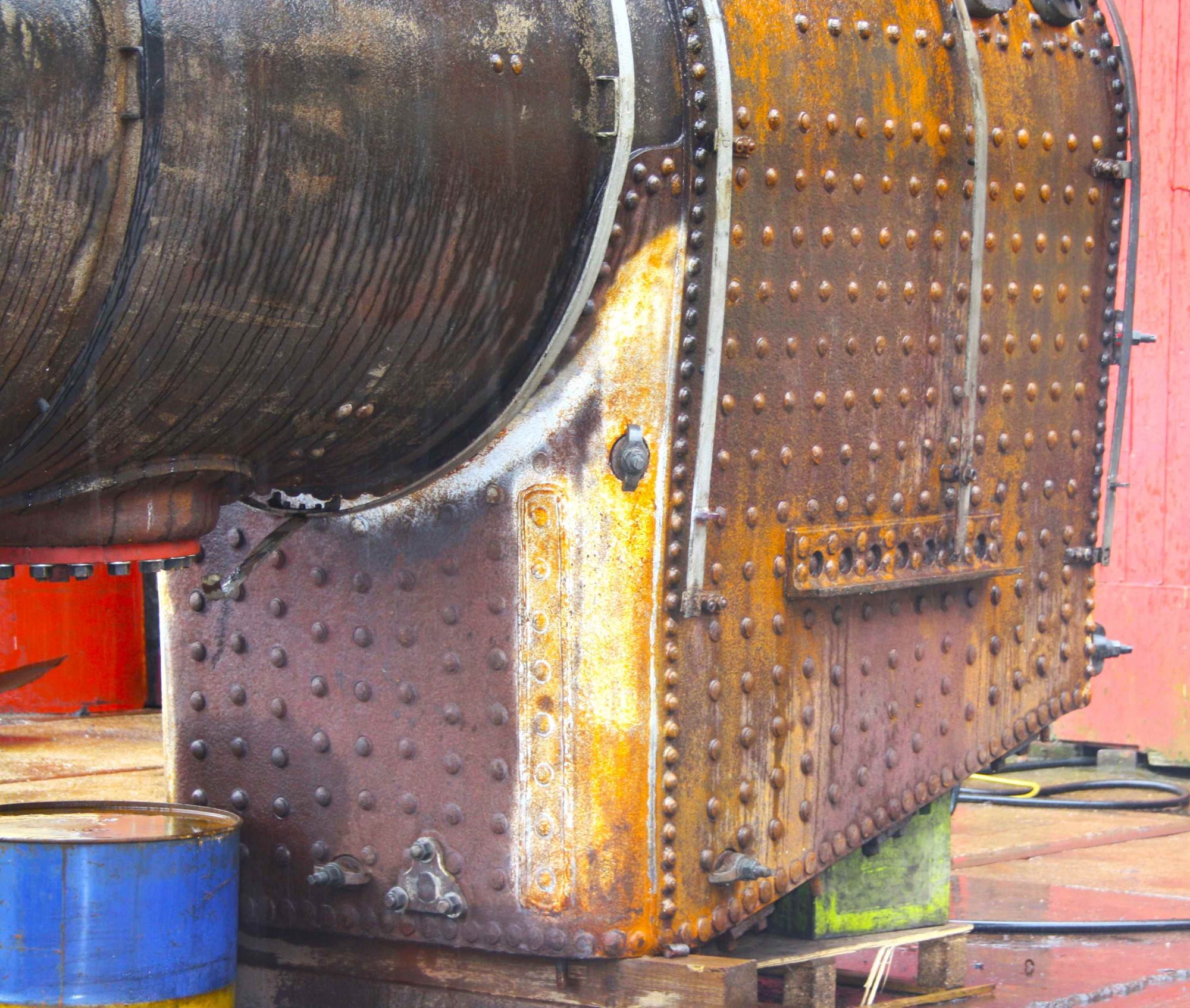

I thought it might be a wizard wheeze to show you a somewhat similar boiler without its fine outer clothing.  Persons of a nervous disposition (and rivet counters!) are advised to look away now.
Not quite so pretty. Smokebox at the front, complete with its opening door to provide access, multitubular boiler in the middle and the part containing the internal  firebox, called the outer firebox, at the far end.  The internal firebox quickly became known as the 'inner firebox' and we'll use that terminology from now on.

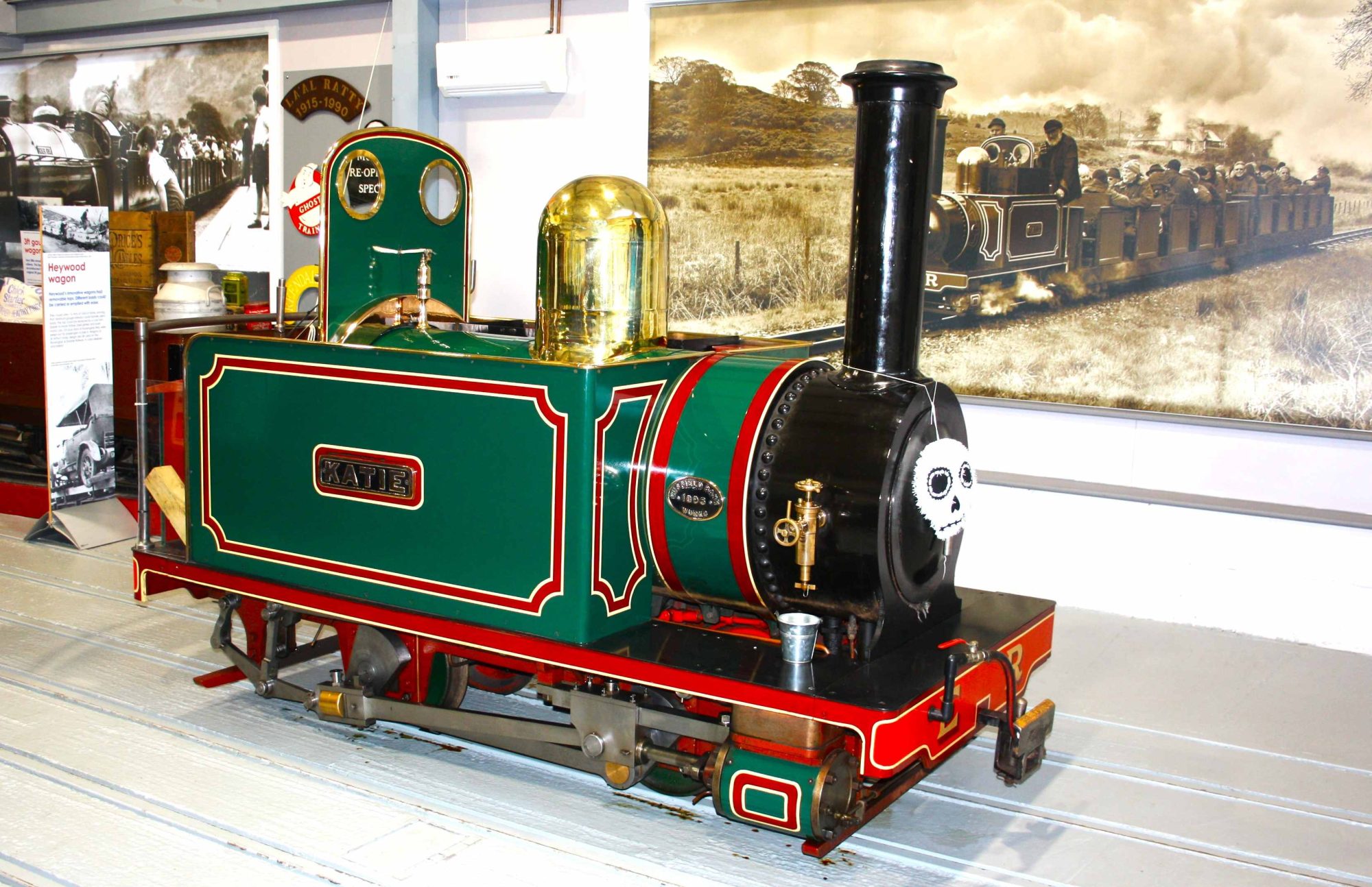

We have seen a side view of a locomotive's boiler, photographed in the rain at Haverthwaite.  If we nip round the SuperScenic Cumbrian coast far a while we arrive in Ravenglass and, in the Ravenglass & Eskdale Railway's fine new museum, we meet a cutie called Katie.
See what I mean?

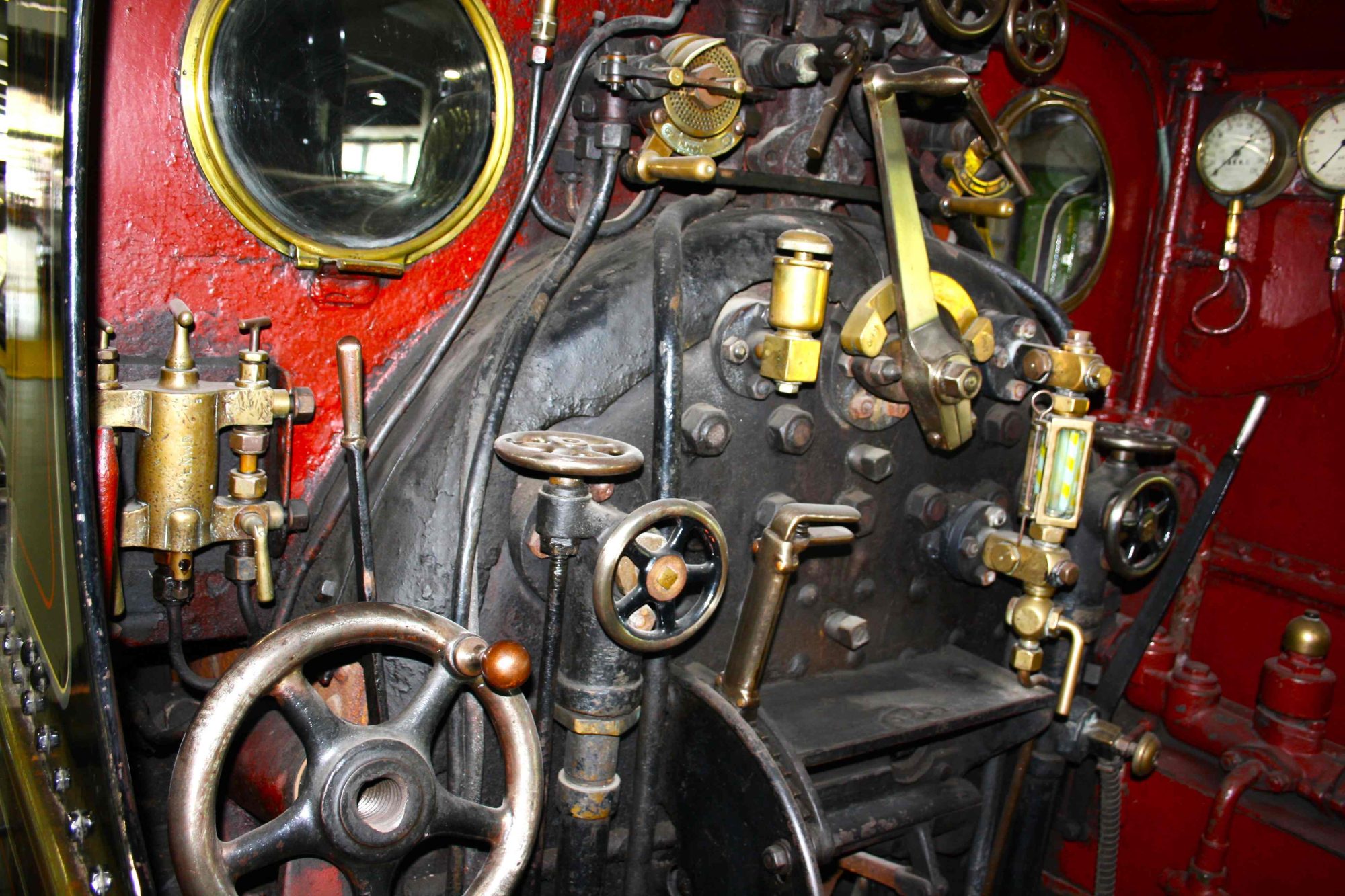

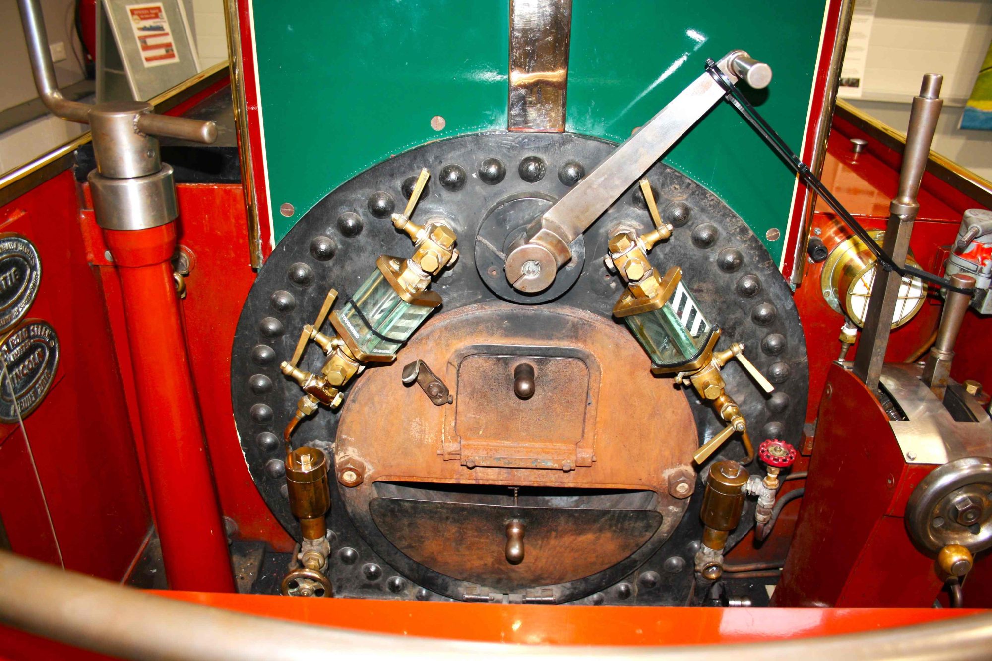

Shimmying round we can see the part of her boiler that concerns the enginemen for most of the time.
The firehole door, through which, when opened, the fuel is shovelled onto the fire can be see.  As can these jolly important items, the gauge glasses, which show how much water there is in the boiler.  As a recent reconstruction, Katie has two of these. Please note they have 'zebra stripes' - this was an LNER idea and is pure dead brilliant as they say in a city to the west of here.  Prior to this clever wheeze, an empty gauge glass could be mistaken for a full one with potentially explosive consequences.  Literally.  When viewed through water, the stripes change direction1, greatly reducing the likelihood of a potentially fatal misreading of the water level in the boiler.
If we move up to a bigger scale – no, we aren't going '00' – we can see the arrangement on a standard gauge locomotive.  In this case, London & North Western Railway 'Precendent' 2-4-0 No. 790 Hardwicke.
She has only one gauge glass – she will also have try-cocks, which later fell out of favour with British railways when two gauge glasses became the norm2.  Apart, of course, from on the Great Western.
Her firedoor is bigger than the one we saw on Katie and the two prominent pipes and valve wheels on the faceplate [backhead for GWR people] are for the injectors.  Important things, injectors.  They force cold water into the boiler against the pressure of the steam.  Jolly clever, that.  All done by steam pressure and cones.  Not the seaside sort - they are made, carefully, from metal.

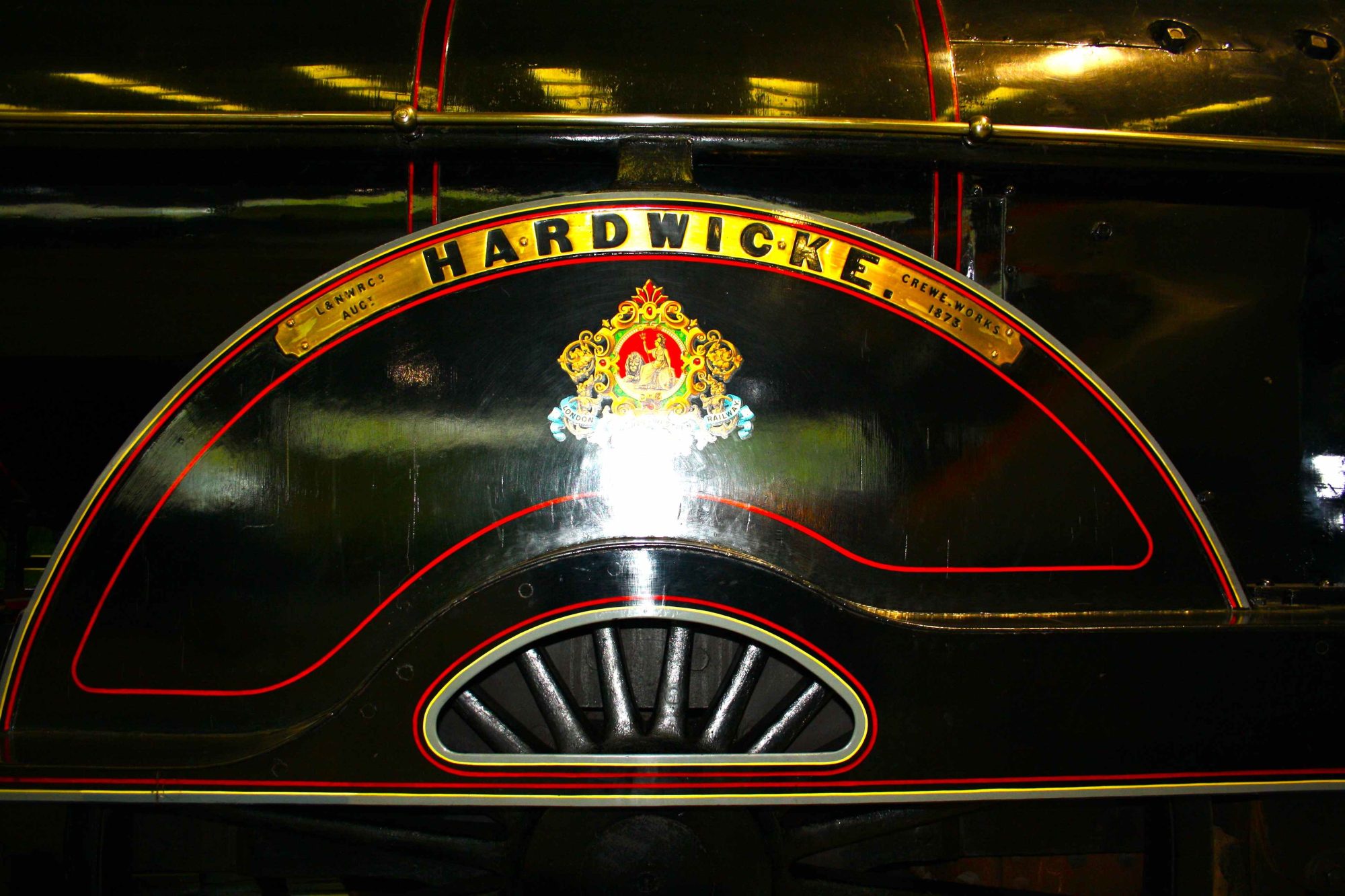

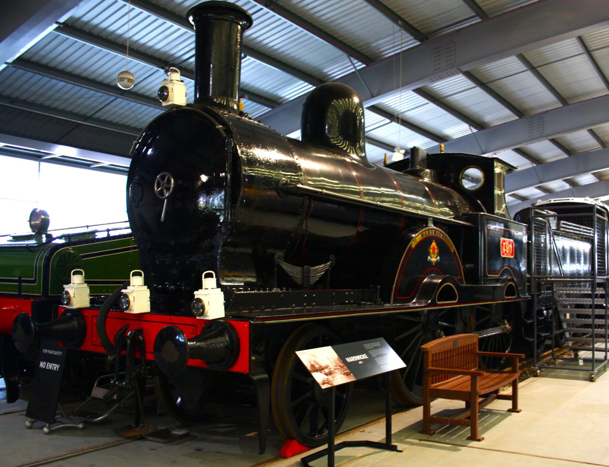

I included a picturingham of Hardwicke's footplate in Part 13.  I though it impolite not to show the whole engine.  Here she is:
And her combined name and builder's plates - August 1873:

Thank you, Martyn and that might well be the case.  M. Giffard built a steam-powered airship.  And... it flew (or so I understand)!
Certainly, the injector he invented in 1859 (others had a similar idea but Henri Giffard got it right) transformed steam on rails.  Sharp, Stewart & Co. obtained the patent rights for the United Kingdom in 1860 and the feedwater pump quickly became obsolescent, except when locomotive engineers experimented with pre-heated feed water.  Mr Stroudley used crosshead pumps to deal with hot feed water on the LB&SCR.  On the G&SWR, James Manson with 4-6-0 No. 129 and, less successfully, Peter Drummond with the fifteen 0-6-0 engines of the '279' class, used steam-driven pumps which removed any requirement for furious motion to replenish the water in the boiler. No. 129 also retained her two Gresham's injectors.
If you peer at the second well-dodgy picturingham, you might just notice the fine yellow line between the red and grey lining.  It was to do that line on an '0' gauge model that the late Bernard Millar resorted to the use of a tiger's whisker.
