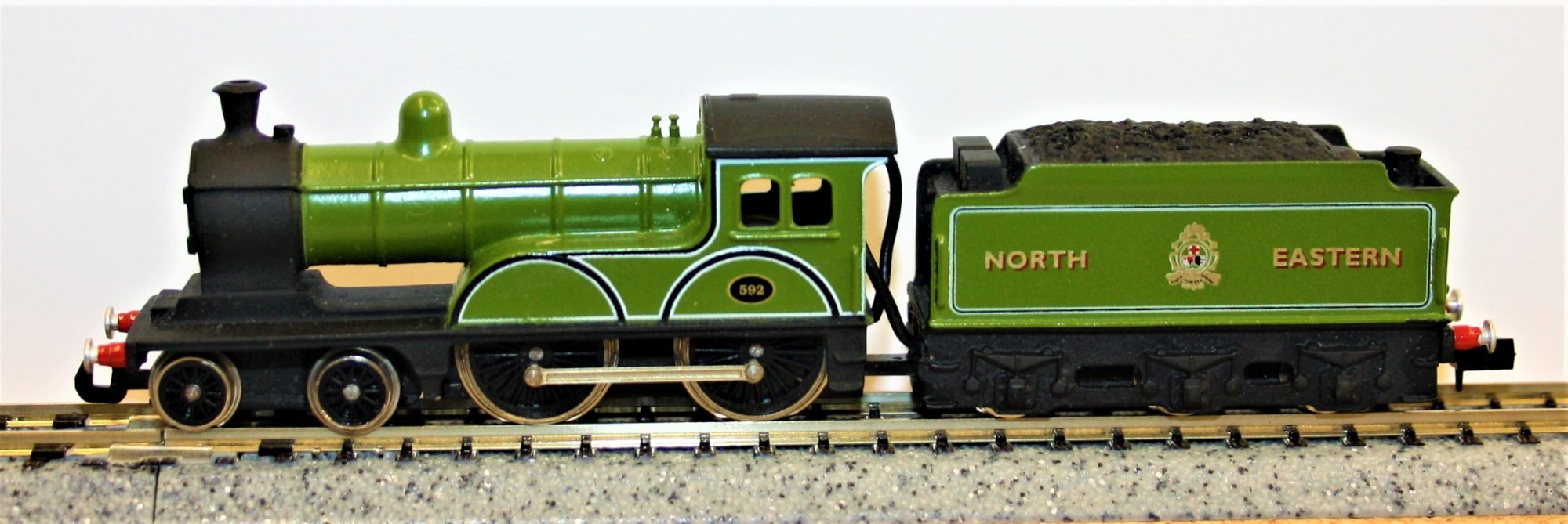

[A North Eastern Railway 'R' class 4-4-0, later LNER 'D20'.  A first-class passenger locomotive with big coupled wheels – 6' 10" diameter.]

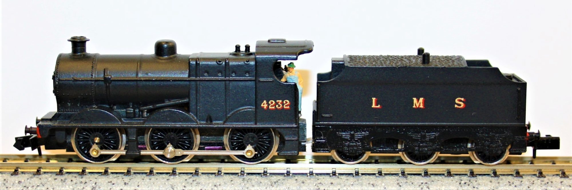

[The picturingham shows a '4F' 0-6-0, a class built by the Midland Railway and perpetuated by the LMS after the 1923 'Grouping'.  Powerful locomotives, they suffered from bearing troubles.  The model is a ProperlyPoole Graham Farish example and runs very nicely indeed with no trace of bearings running hot!  She is about 30 years old.]

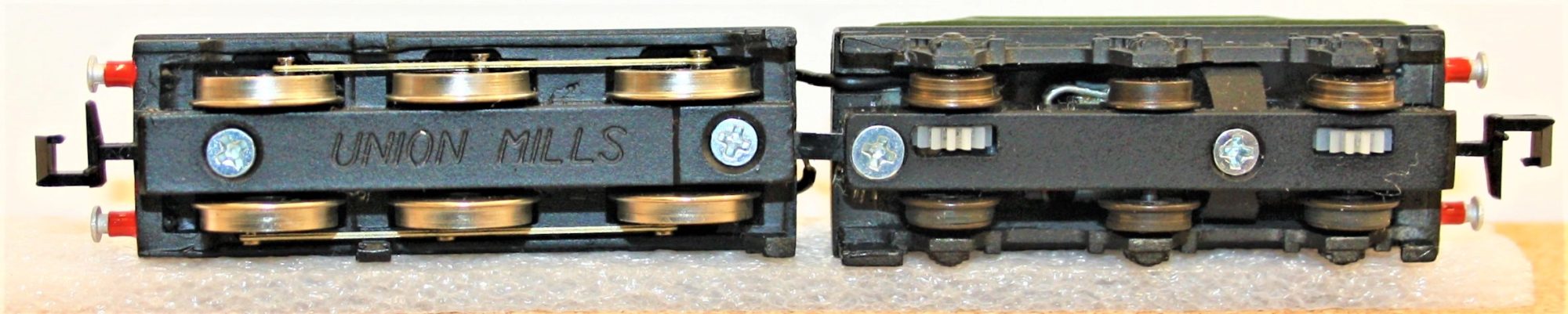

Interestingly, Union Mills models use a sort of upside-down version of this system with the axles revolving in a slotted 'keeper plate'.  This allows the axles to move to help cope with dodgy rail joints and suchlike, although they are not sprung.  It also means that a Union Mills coupled wheelset can be taken out in one piece – nifty, eh?

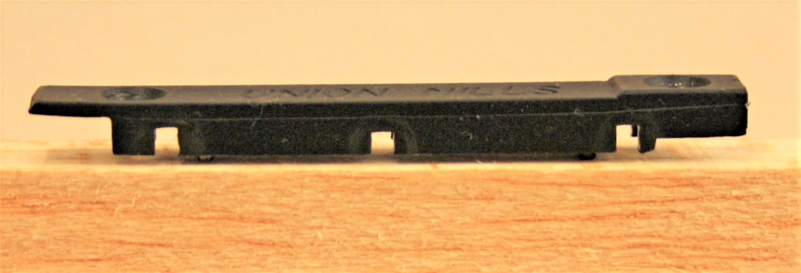

[A Union Mills locomotive (a GWR 'Dean Goods' 0-6-0) from below.  Undoing the two machine screws allows the 'keeper plate' to be removed...}
[... once removed and placed upside down, the 'keeper plate' gives an almost passable visualisation of the side elevation of a locomotive's frames.]

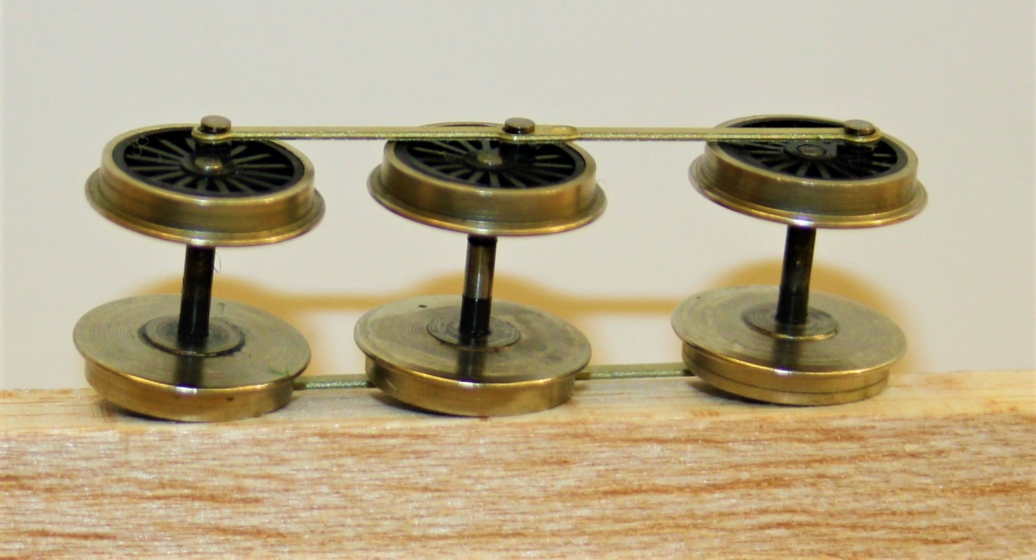

[And here is the wheelset, removed just like the real ones are, albeit they would have had their coupling rods taken off first.  Pressing a wheel onto an axle was a Main Works job, but many steam shed were equipped with lifting gear (or a wheel drop if one is being really fancy) in order to remove a wheelset to give any attention required.]
