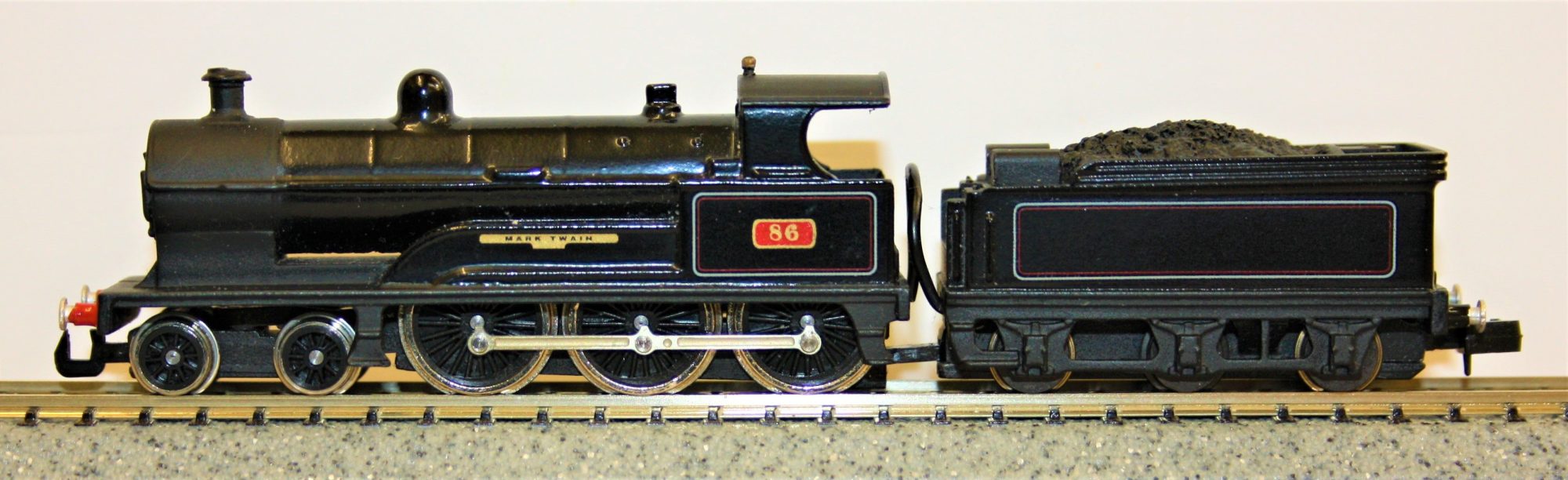

The North Eastern Railway was next to introduce a 4-6-0 and many other railways followed.  Interestingly, three important northern railways, the North British, the Great Northern and the Midland never had 4-6-0 locomotives.  Likewise, the South Eastern & Chatham and the London Brighton & South Coast.
Some of the 4-6-0 designs of the late Victorian and Edwardian period were good performers, but others were rather mediocre.  Simply lengthening an existing 4-4-0 design into a 4-6-0 was no guarantee of success.  Interestingly, Mr Jones' 4-6-0 was an entirely new design.  What appears to be a similar 4-4-0, his 'Loch' class, was introduced two years later, in 1896.
[A typical 4-6-0 of our period.  Resplendent in the famous LNWR 'blackberrty black' livery, this locomotive is a 'Prince of Wales' class 4-6-0, No. 86 Mark Twain.  The class was introduced in 1911.]

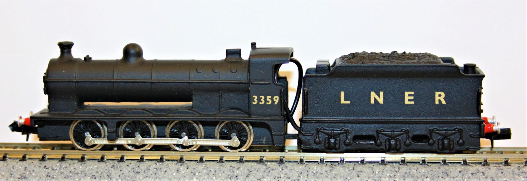

In 1889, five years before the introduction of the 4-6-0, the first 0-8-0 locomotives appeared in Great Britain, on the Barry Railway.  These had been built by Sharp, Stewart & Co for export to Sweden, but their customer was unable to pay for them. Beginning in 1892, FW Webb had lots of 0-8-0 locomotives built for the London & North Western Railway and some other railways introduced the type.
Incidentally, the Barry Railway examples were not the first appearance of an eight-coupled locomotive in Great Britain. In 1864/66 two 0-8-0 tank locomotives were built for the Vale of Neath Railway, two for the Great Northern and one for the Llanelly Railway.  All five had been scrapped before 1880.
[An interesting British 0-8-0.  One of HA Ivatt's 'K1' class of 1901  for the Great Northern.  Class nickname, 'Long Tom'.  LNER designation, 'Q1' or 'Q2']
