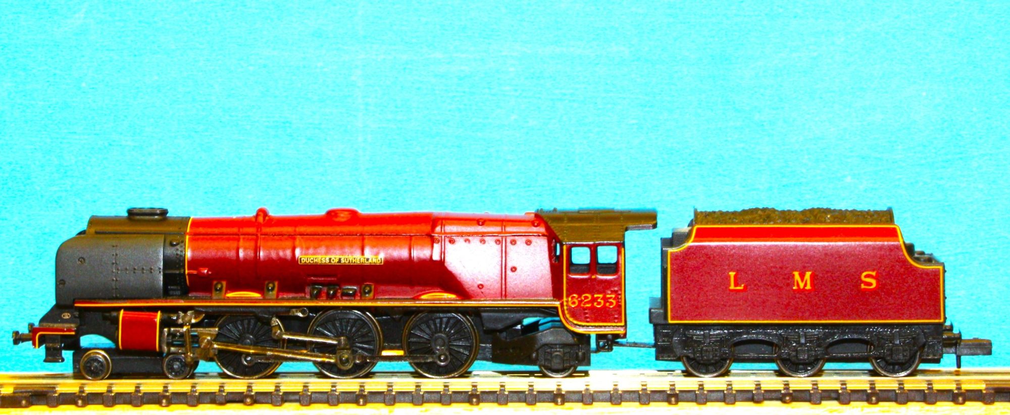

Although this was a massive grate area for British practice at the time, Sir Nigel Gresley's 'P2' 2-8-2 of 1934 also had a 50 sq. ft. grate area.2
Just look at that enormous firebox on No. 6233 Duchess of Sutherland.  Just the thing to produce the power for the banks on the West Coast Route.  I was born too late to appreciate main line steam (I can only just remember it) but my late father took me, in a work's van, to the road outside Butlin's holiday camp at Heads of Ayr to see this magnificent locomotive.  I like my Graham Farish model of her, but it's of 'Far East' manufacture.  I'd swap it in an instant for a ProperlyPoole one.  With an additional bribe of some cash in a wee broon envelope.
