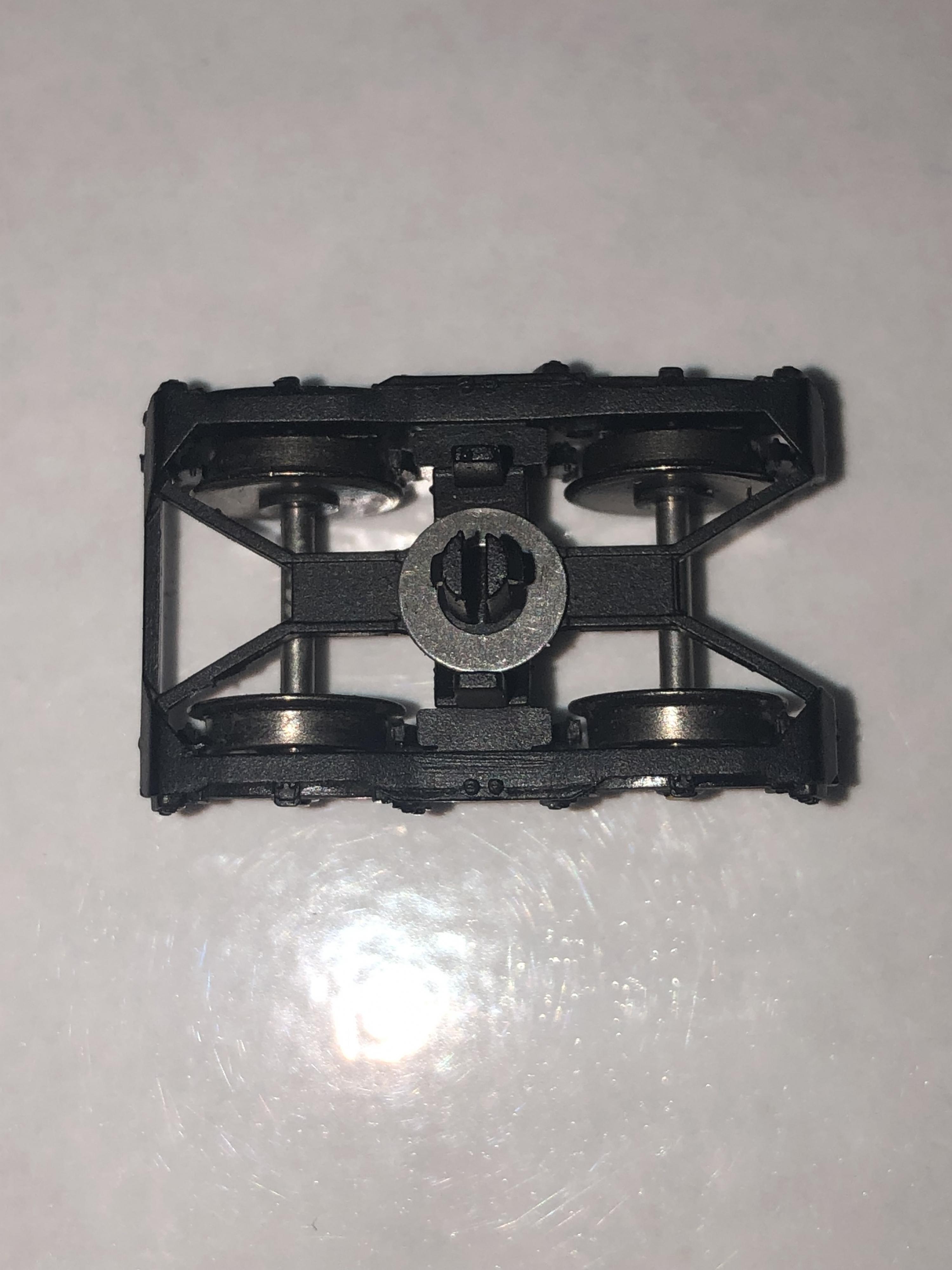

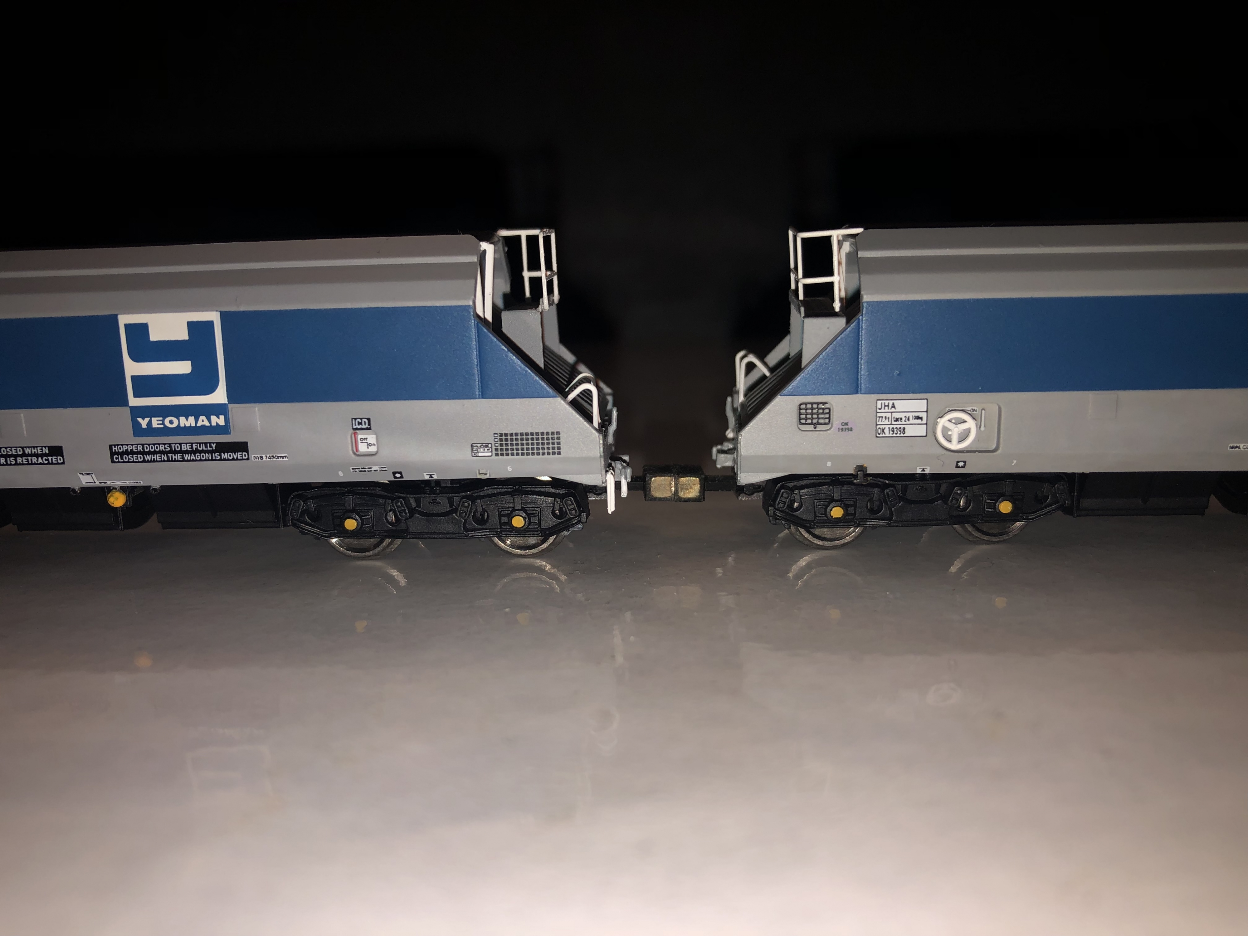

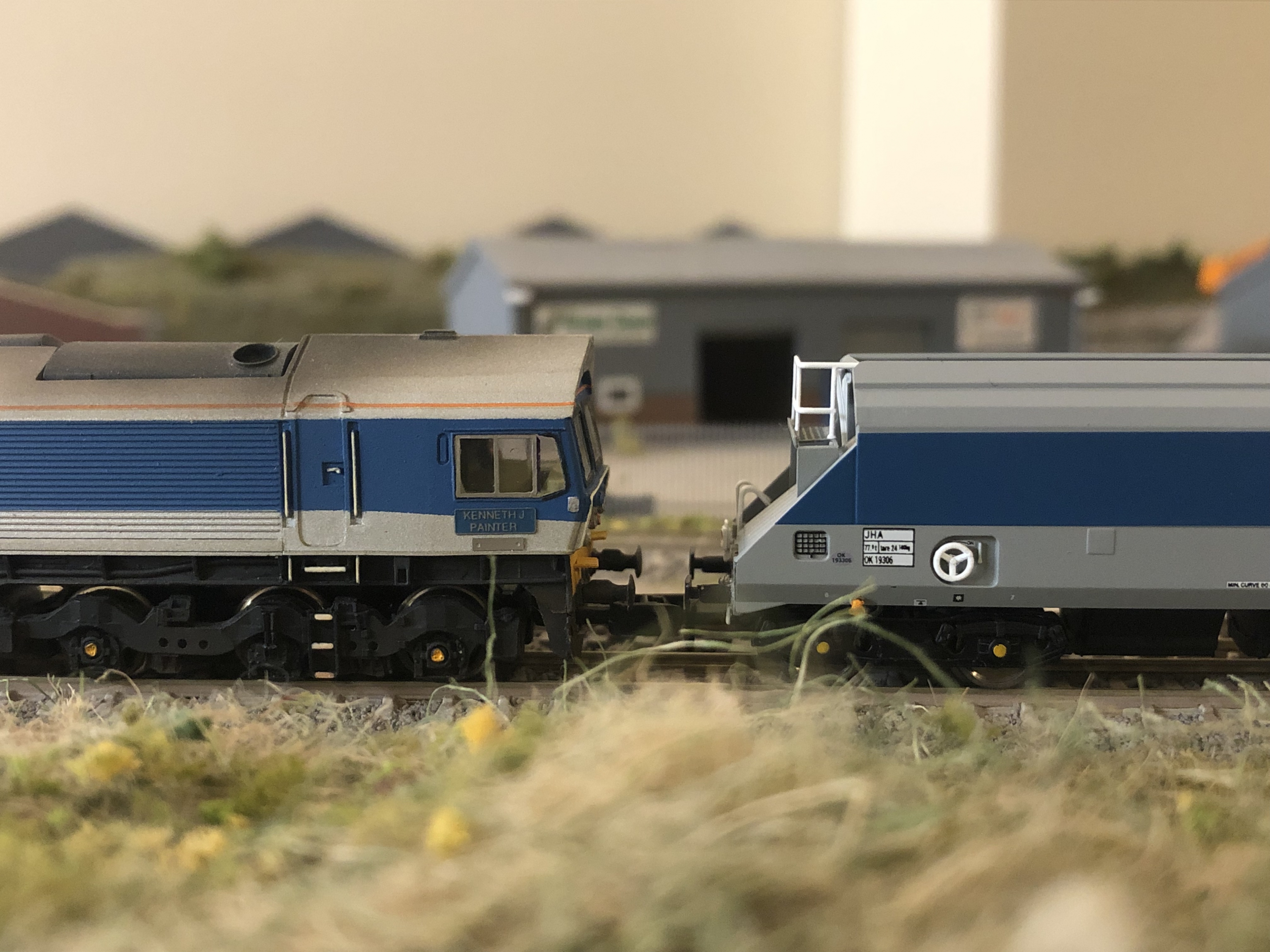

Progress has been made, using a 0.25 shim the wagon wheels now run freely with no drag, much better than grinding the underside of the wagon floor.
The left hand wagon has the shim the right as out of the box. There is a slight height difference if you look closely.
The raised wagon next to the class 59 to show height comparison.
The shim in place on the bogie.
