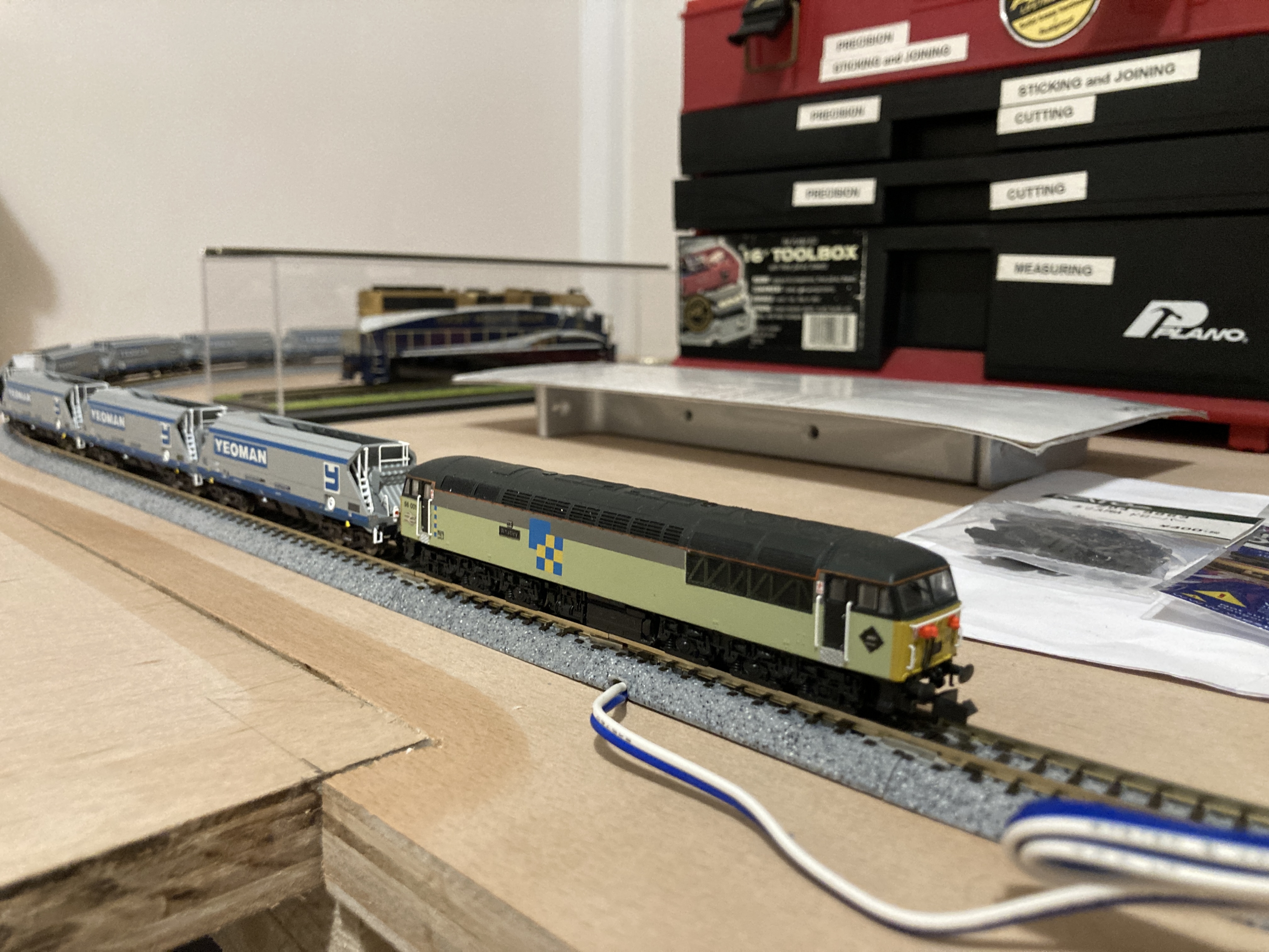

I'm up to 19 of these wagons now with hopefully the last 1 being returned on Monday and replaced to make it 20. I've also been playing around with loads and will put more details on those on my own layout thread in the next 20 minutes or so but here's my rake of 19 being hauled by a Dapol class 58 on probably around 30% full power.
And from a distance which shows the full rake in 1 shot

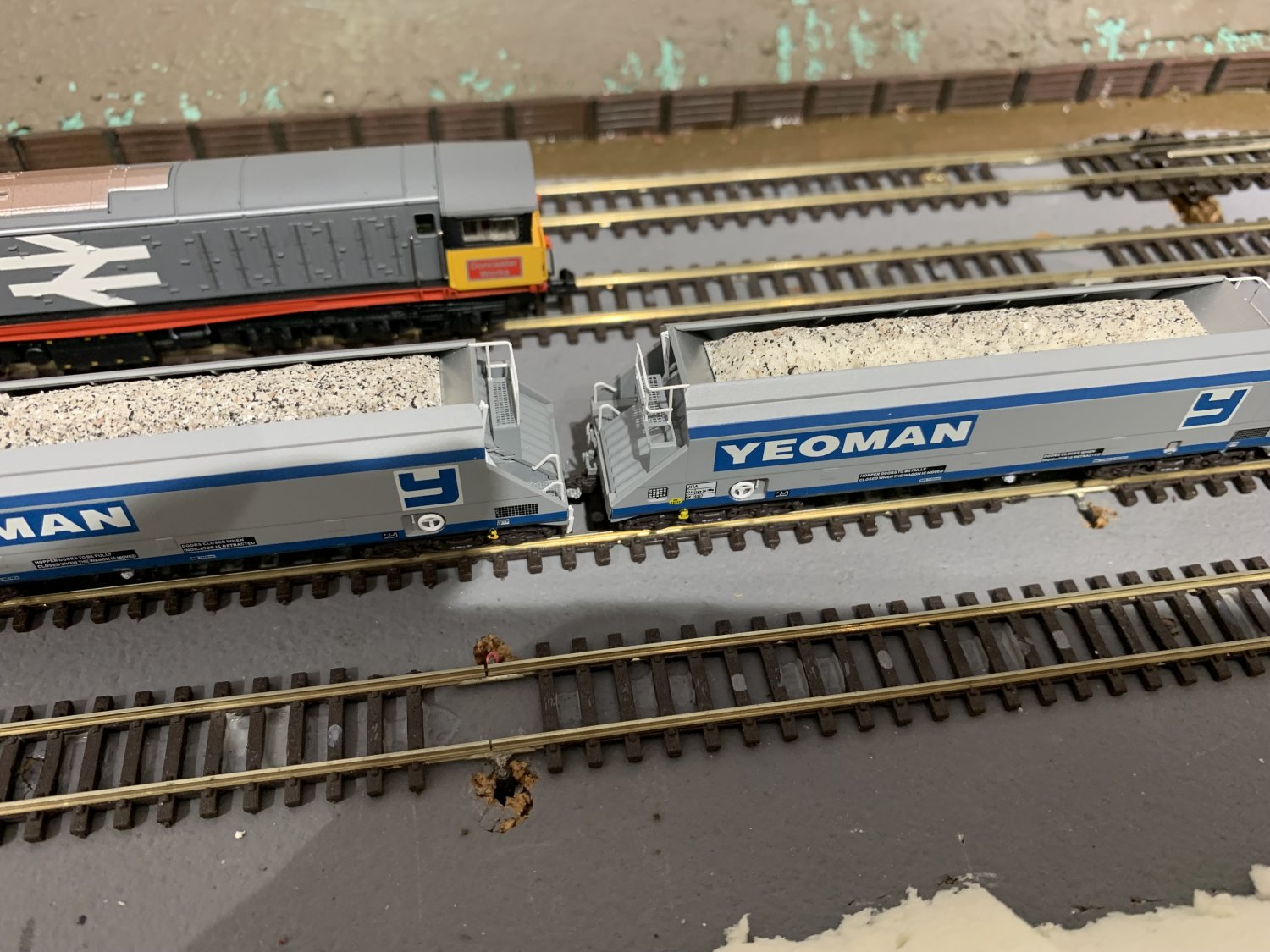

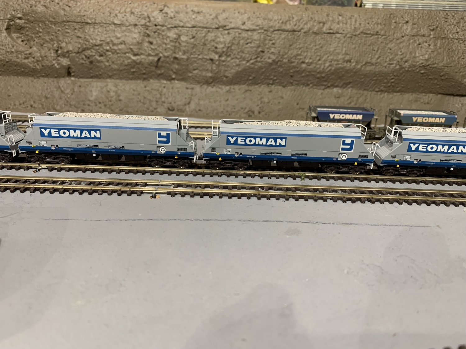

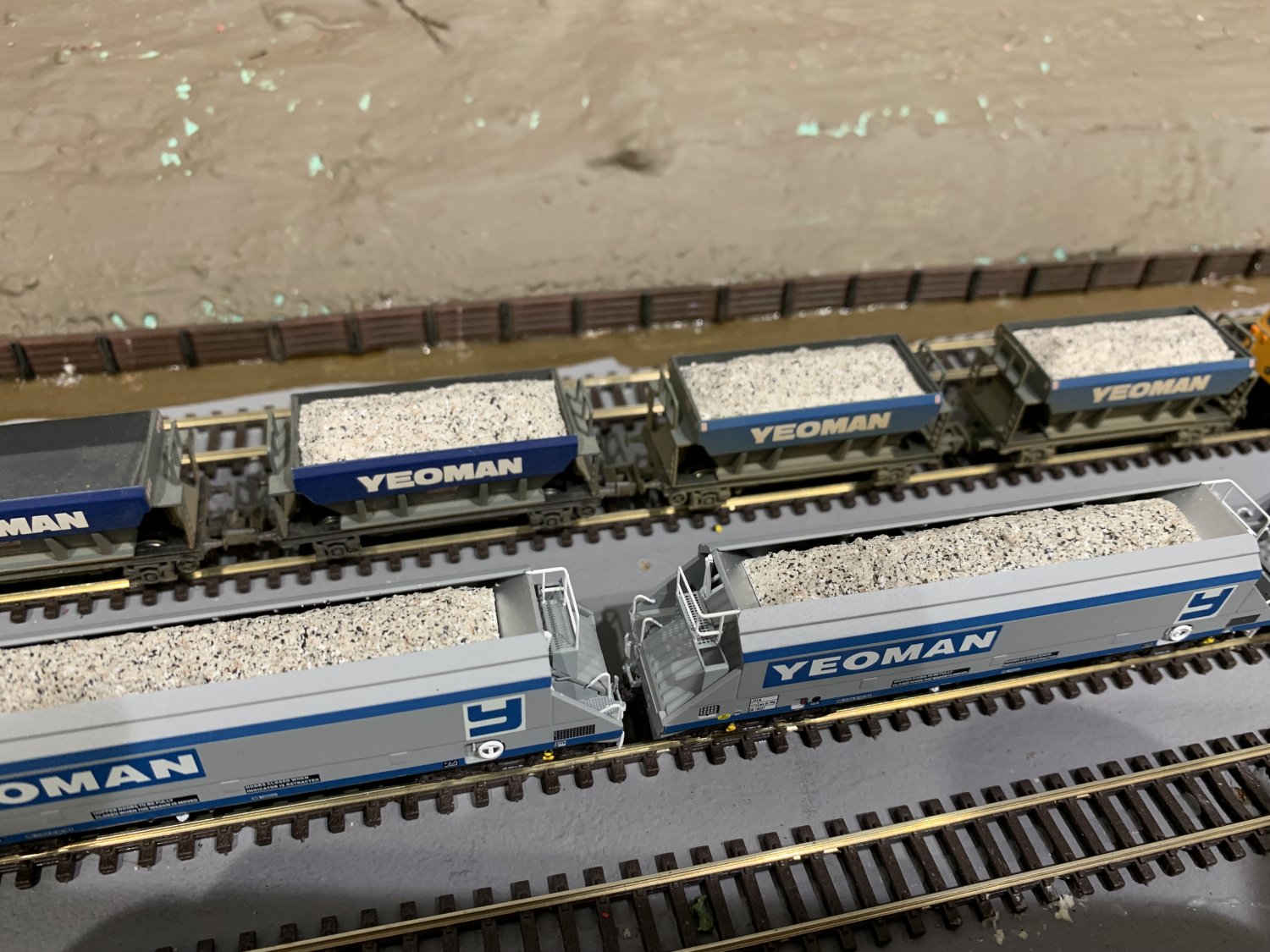

For those who don't follow my layout thread, and there are many reasons why that may be the case, here are a few pictures of my efforts to add a load to these wagons. The plan was to make sure that no 2 loads are the same. I think I achieved that:

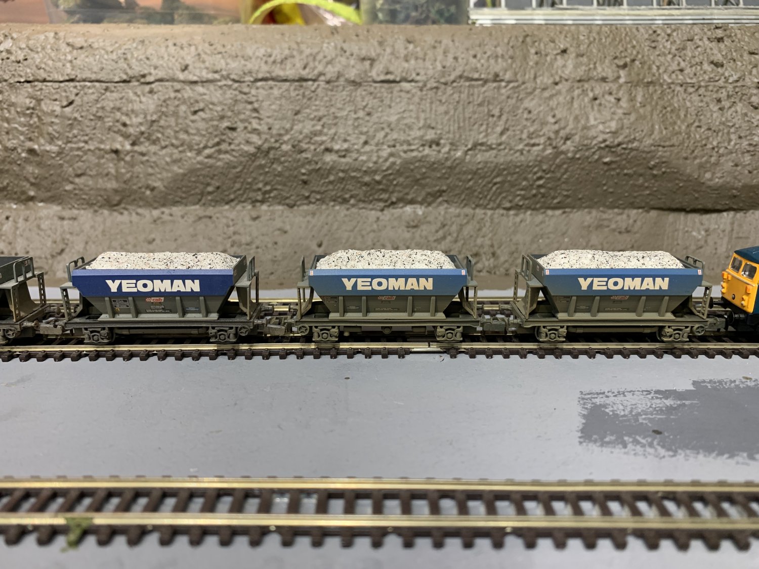

And some older 50 ton Farish wagons 'filled' using the same method:
woodbury22uk
They look good to me. Back in the late 1980s/90s these trains were normally loaded on the move. The wagon was tare weighed, the load calculated, and distributed from a hopper onto a belt which was above the centre line of the wagon. From being in the loading control room a few times at ARC Whatley (not Yeoman's at Merehead), it was apparent that the fine tuning by the operator resulted in very similar looking loads for every wagon in the train, but noticeable differences between one operator and another. Some would have an even load along the length like yours, others would have a more peaked load at the end of the wagon loaded first and a small trough at the end loaded last. From memory the actual tare weights and the painted tares were very similar, even with box wagons, indicating the skill of the grab operator emptying a box wagon. The big shunters used on the loading tracks had very even slow speed control. An operator letting stone fall outside the hopper was not popular, even where the brake gear had a protective shedding plate. The process was quite mesmerising.
Mine are probably a little less even than they appear in the pictures. However, maybe I will create a few peaks and troughs in the next batch. Due to the shape of the wagon and the fact that I want these to be removable, I can't make them too high or I will never get them into the wagon if you see what I mean.
Thanks for the info.

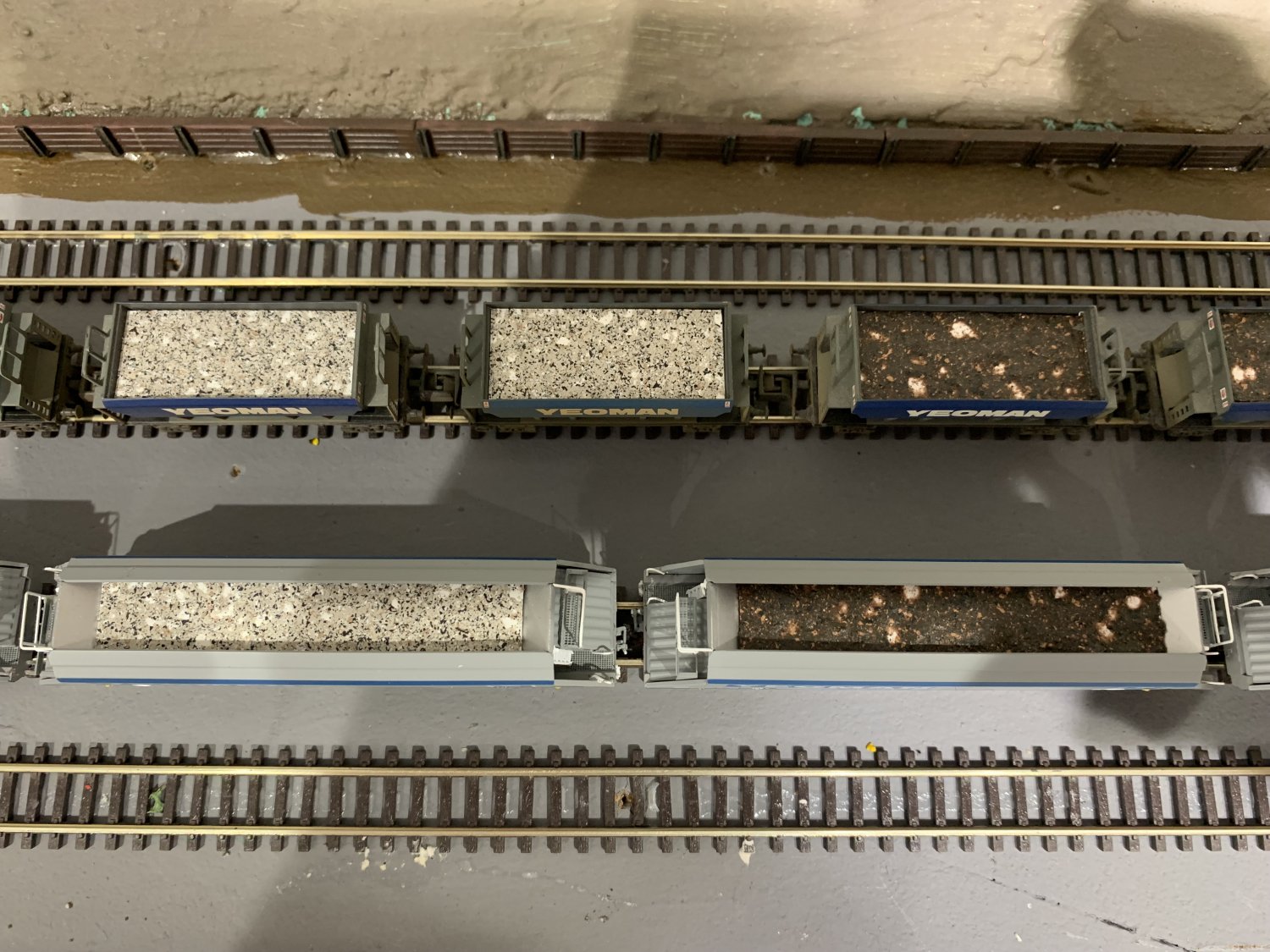

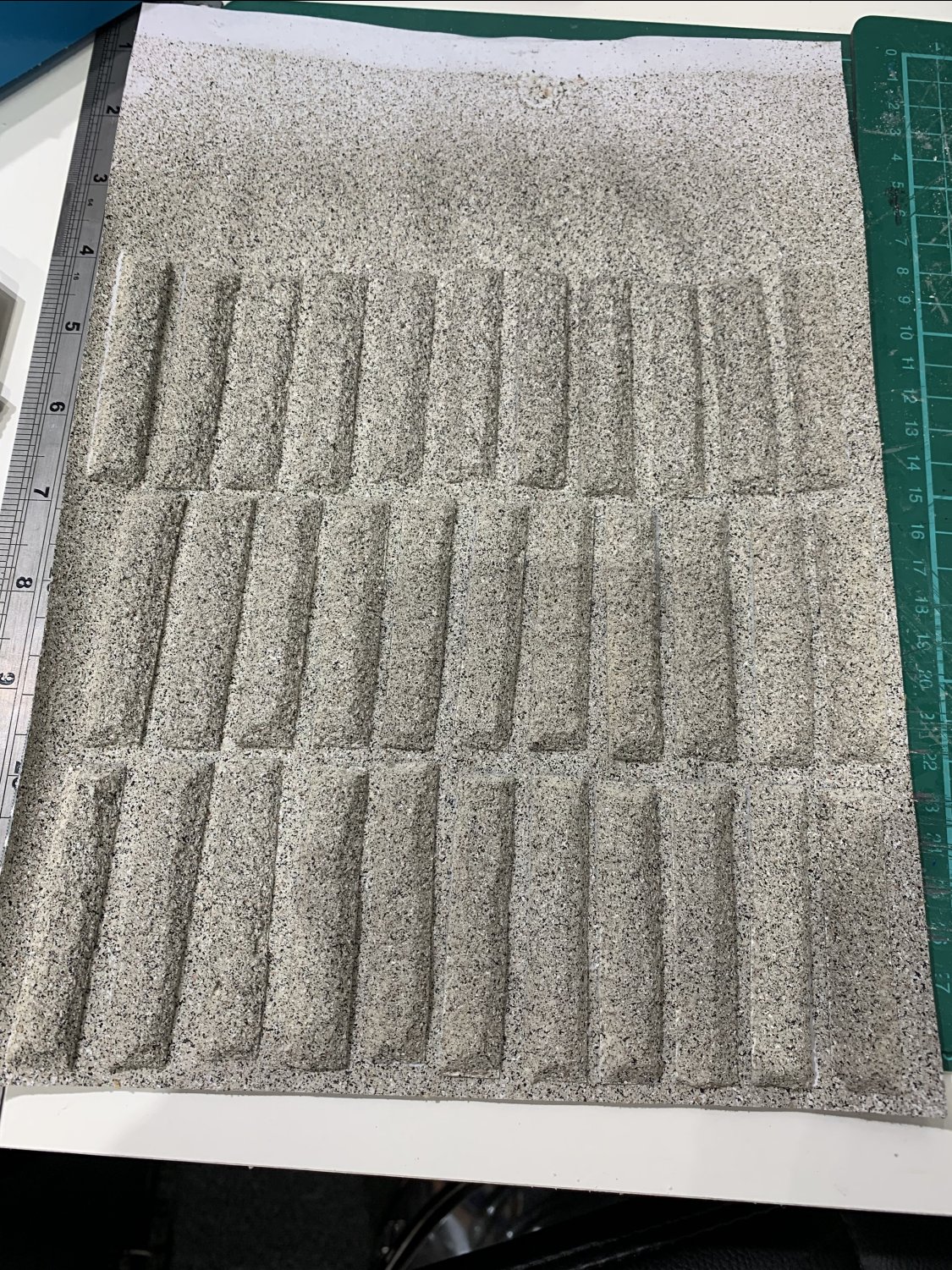

I haven't needed to remove the brakes but will bear it in mind if I ever feel the need to. I have been making loads for mine though. Apologies if any of these pictures have appeared here before but my first attempt at a load was too flat:
The next attempt was where I realised that the ends needed to have angles filed/sanded into them underneath as the ends appeared square and there was a gap at each end (best seen in the wagon on the right):
I've been busy today and have hopefully learned from past mistakes by making a few more which are neither flat nor have square ends:
These should be ok but I won't be able to try them until next weekend or if I get home early tomorrow I may be able to fit a few and I'll post the results here  :thumbsup:
