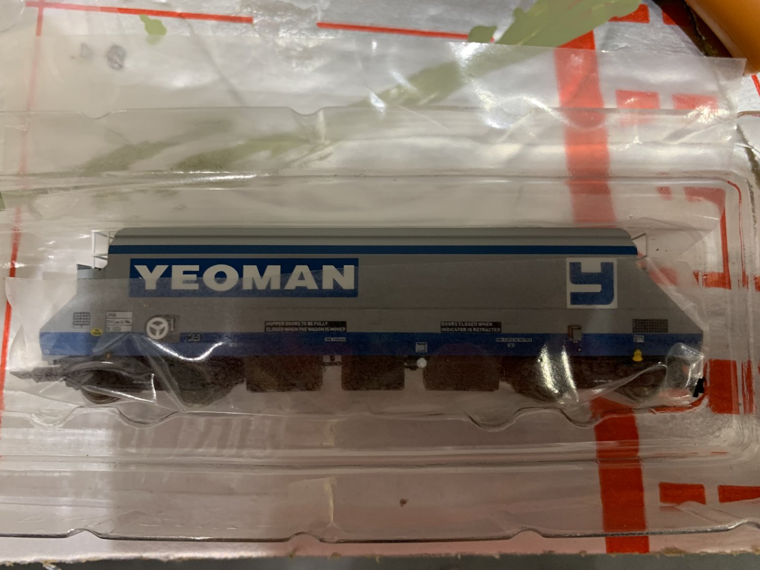

The reason for this it seems is the way they were put into the box inserts. They seem to be pushed towards 1 end and not in the preformed tray as they should be:

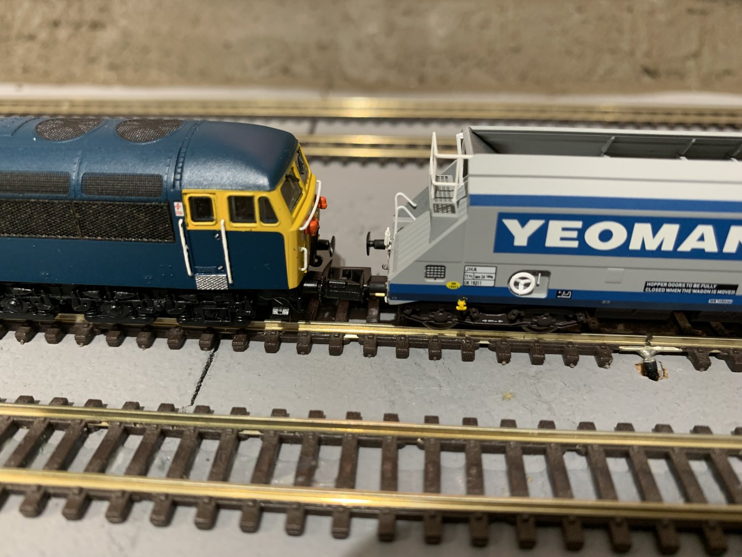

The end wagons also seem to suffer from the mk3 coach uncoupling syndrome where the coupling arm rises over points but doesn't drop back down meaning they will either uncouple immediately or when they next encounter a curve:

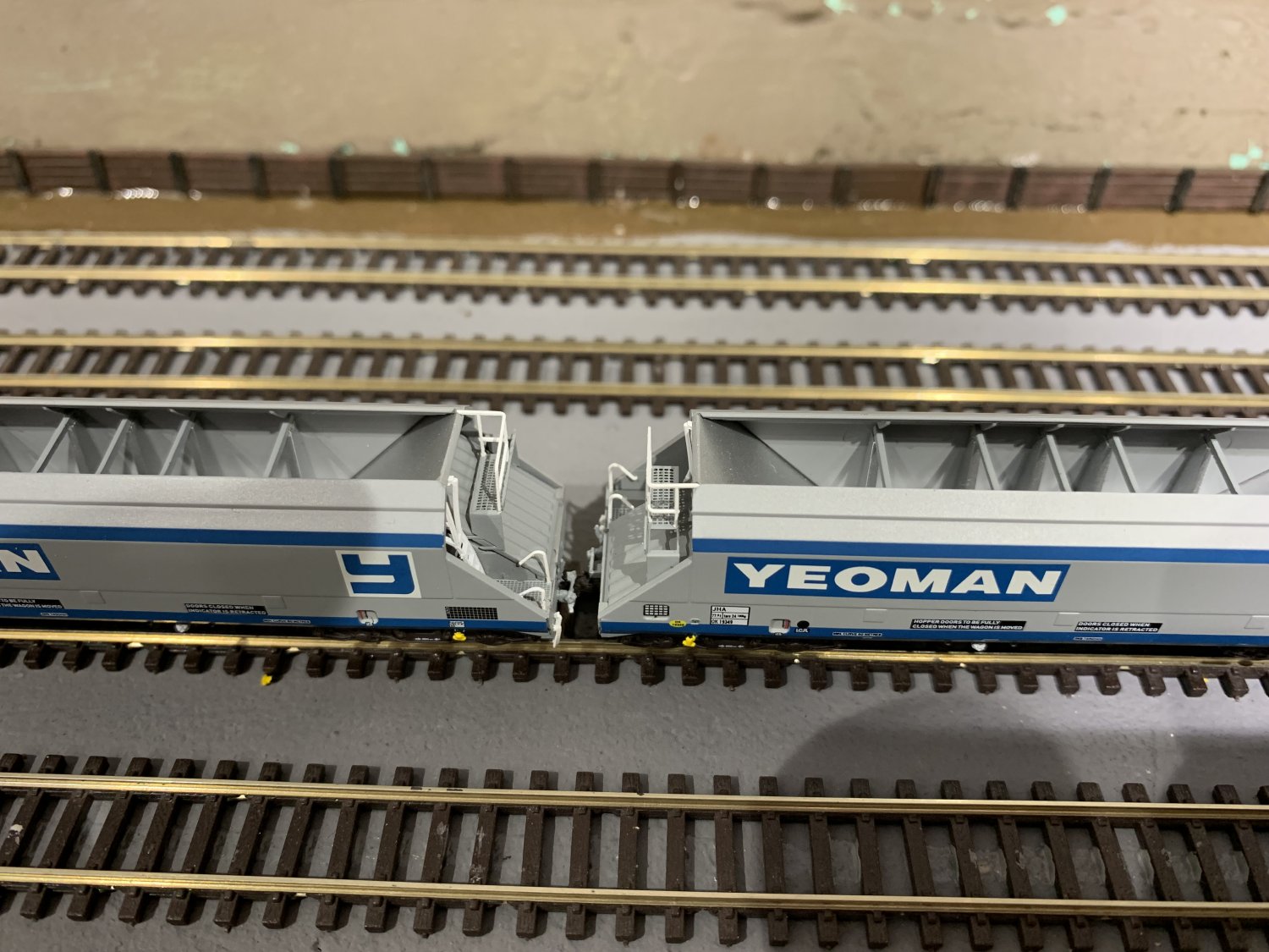

Close coupling between wagons is good though:
