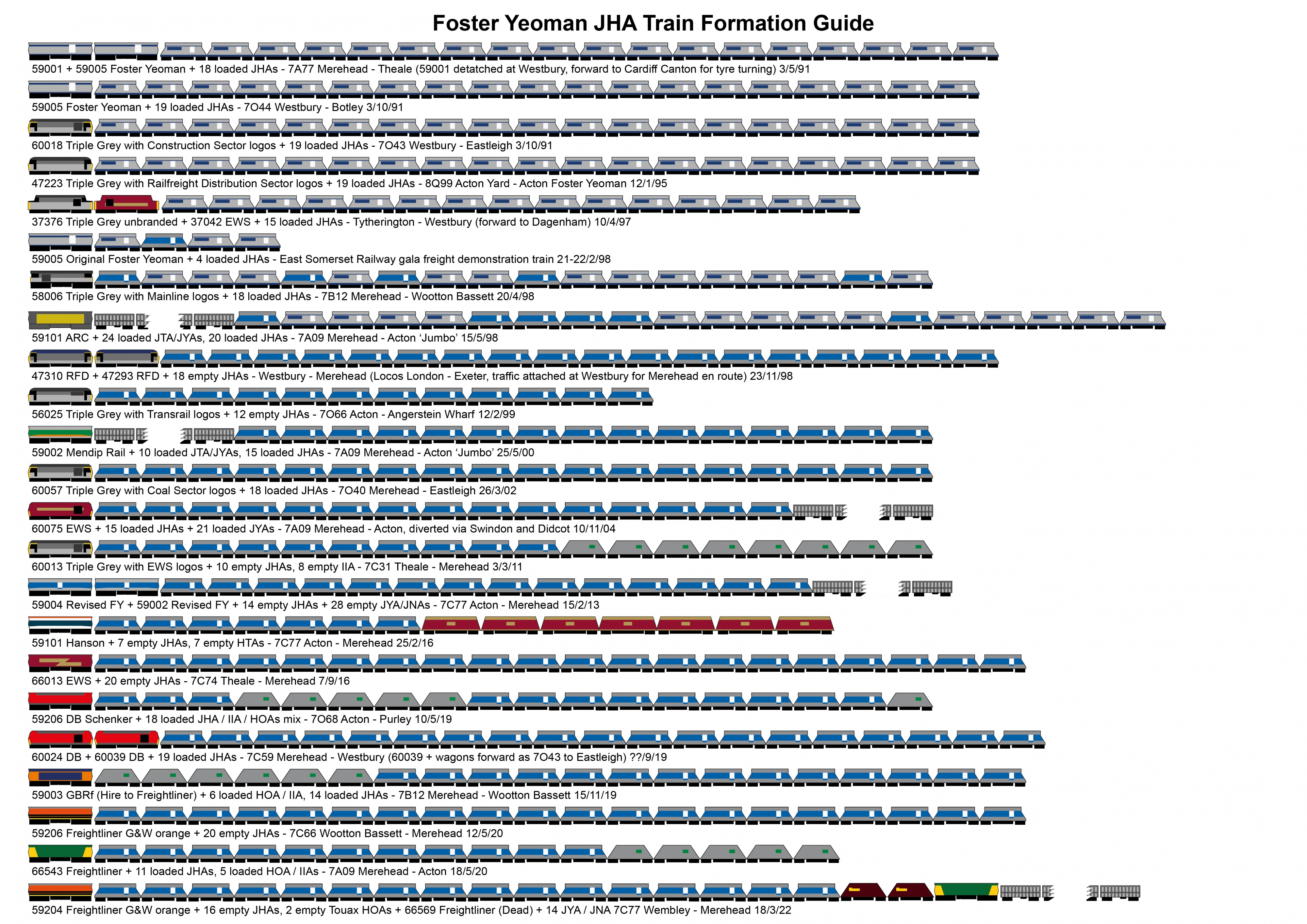

steadfast
#22
Here we go then, hope this is of use to someone. This isn't the be all and end all, but hopefully gives a flavour to operations with the O&K hoppers. The jumbo trains to and from London are reguarly over 40 wagons with a single 59 up front.
Best thing to do is right click and select view image in new tab, this will let you read the text and see the detail.
Jo

steadfast
Each depot will have a particular number of wagons it can receive and train lengths will be based around this.
Terminal A can take 19, so Merehead will shunt 19 wagons together to form that train. This could be 2 outers and 17 inners, or something as exotic as outer, outer, outer, 8 inners, outer, outer, 5 inners and a final outer.
Terminal B takes 15 wagons, so Merehead need to knock 4 out before the set reloads. This could be a block of 4, or individuals down the train, particular if those being knocked out are cripples.
The addition of IIAs and HOAs to the Mendip fleet (which are singles, with buffers both ends) means if you need to add wagons to a set, you may just add the required number to one end, as it is less shunting than splitting the set.
The only hard and fast rule of inners and outers is that you always need an even number of outers.
I've sent the graphic I posted a few post back, and an accompanying text to Neale for an upcoming journal and am working on a similar graphic for the class 59s.
Any questions fire away and I'll do my best to help.
