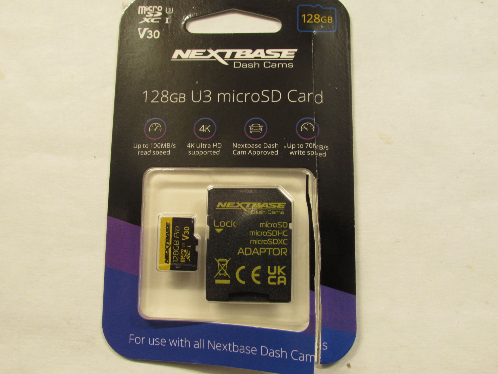

OK, I bought the card from Comet online (£54.99 + £3.95 postage) and it arrived today.
Apart from not purchasing from Nextbase I've done everything they tell me to do :confused1:

Is there an option on the device to format the card? I've had occasions when a camera doesn't like the Windows PC formatted files and doesn't play nicely. Can't speak to Nextbase ones, though.

@Yet Another makes a good point. Nextbase do recommend that the SD card is formatted in the dashcam.
This item, taken from the Nextbase site may be of use Mick -
https://support.nextbase.com/hc/en-gb/articles/360018104518
Having formatted the card on my laptop and putting it in the dashcam I did get an "SD Card error" message along with "Format the SD card", which I then did in the dashcam but nothing got recorded. I'll have another go tomorrow just formatting it in the dashcam and also reduce the vid length time to 2 mins from 3 mins just in case it makes a difference.

Well, I'm baffled. Having formatted the sd card in the dashcam yesterday 'in situ' and it not working, this morning I brought the dashcam into my abode, plugged it in to the USB point on the laptop and then formatted it on the dashcam as opposed to the laptop. It now works.
I cannot see what difference it would make in formatting on the dashcam in the house rather than in the car but obviously it does.
