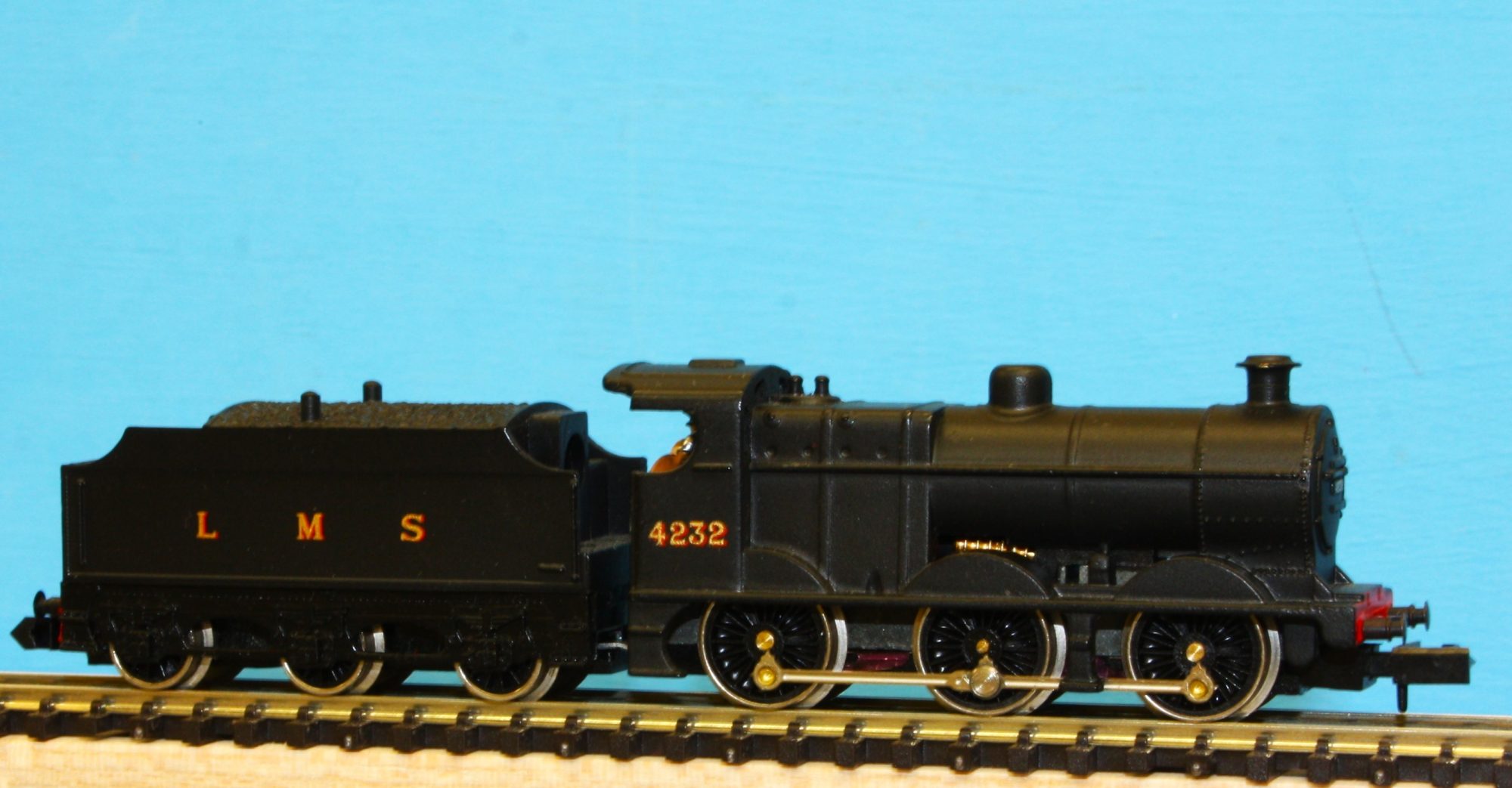

'4F' 0-6-0 No. 4232 is an old ProperlyPoole Graham farish model and I think she captures well the look of the prototype.

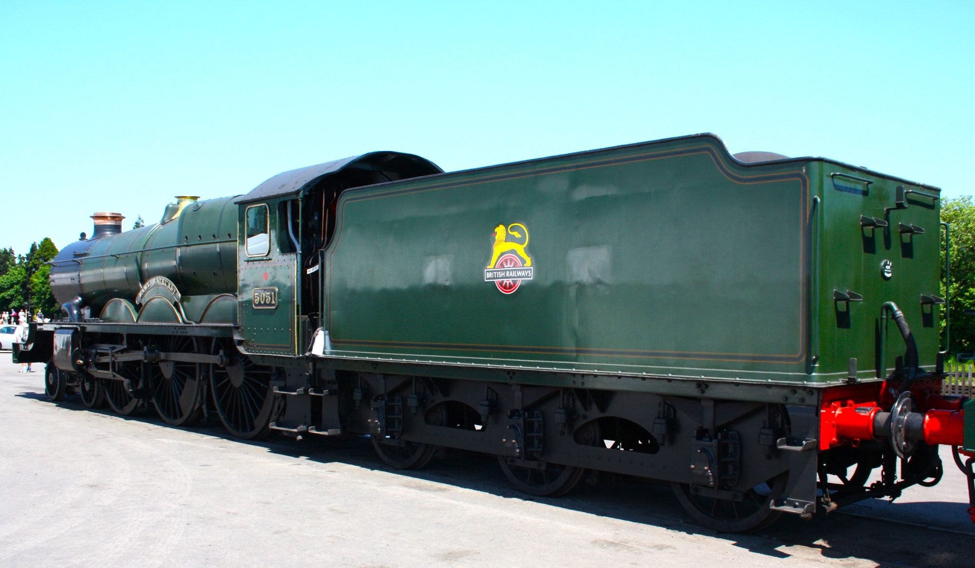

'Castle' 4-6-0 No. 5051 Earl Bathurst (sometimes Drysllwyn Castle, her name in 1936-37, prior to renaming) is a Great Western Society locomotive.  She was photographed at Toddington on a sunny day.

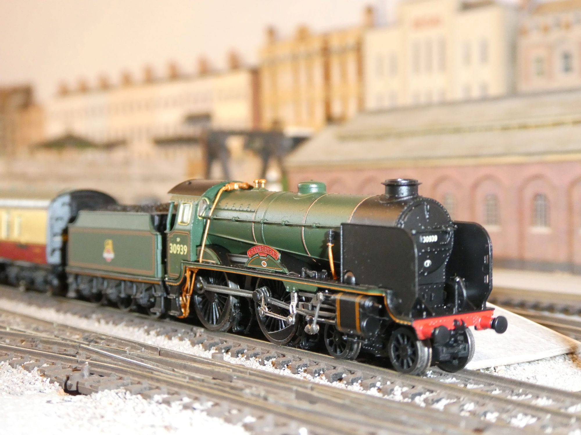

I try to include at least one picturingham in these postingtons and I like the 'Schools' class.  But I don't have a photograph of one.
Brainwave!
Friend of Poppingham @Ali Smith is a scholar and a scholar (albeit not necessarily in that order) and he and Rob have the absolutely fabulous Vermouth layout.
Bingo!
It is understood Mr Maunsell would have preferred to use a Belpaire firebox in the 'Schools' class and that the first design proposal used a firebox based on that of the 'Lord Nelson' class.  However, the restricted loading gauge of the Hastings route, especially Mountfield tunnel, required a width of no more than 8' 6 1/2", with, importantly, only 7' 7" width at cab gutter level.2  This meant the side sheets of the cab had to be turned inward from about half-way up - such a distinctive feature of the class.  The very narrow cab width, coupled with a Belpaire firebox, would not have given sufficient room for cab front windows of a practicable size.  So the same round-top firebox as on the final series of 'King Arthurs' was used.  Ali's phabulous photograph demonstrates these features to perfection, so you can see the reason the engine has a round-top firebox is so the enginemen can see.3

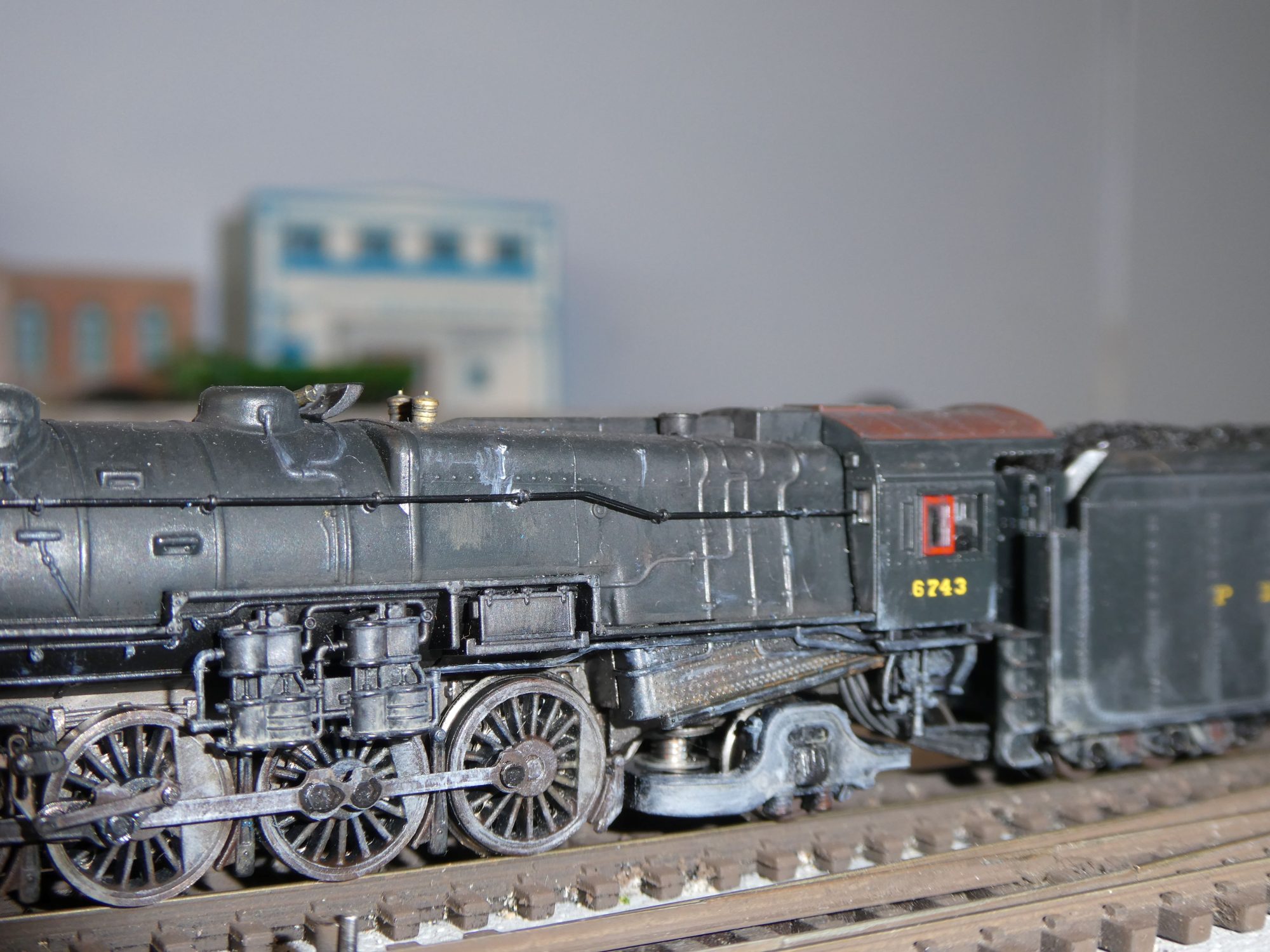

I was wondering if it might be a jolly jape to include a picturingham of a massive American locomotive with a wide firebox.  @Ali Smith read what passes for my mind and sent this SuperSpiffing photograph of a Pennsylvania Railroad 'M1a' 4-8-2.  This class was introduced in 1930 and some engines survived to the end of steam on the Pennsy in 1959.  The use of the Belpaire firebox - a Pennsy specialty - was uncommon in the USA.
Pennsylvania in Dorset - Moonshine Vermouth?

Many thanks to Ali for the photograph of the 6743.
