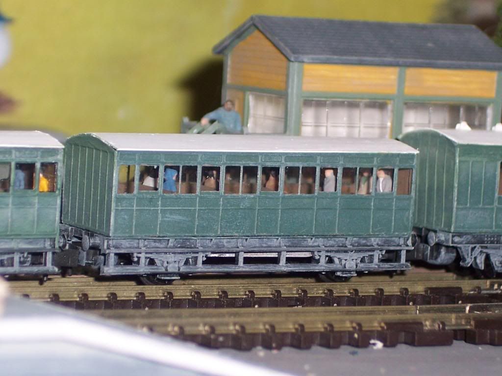

Hi,
So far these have been the only etched brass kits I've built. Got them from Etched Pixels. Relatively easy to put together. In didn't solder them but simply used super glue. They have seats and passengers with clear acetate for the windows.
Alex  :wave:
CarriageShed
Quote from: Alex on November 30, 2013, 03:34:04 PM
Hi,
They look great from here, Alex, but how about a close-up? ;)
Alex
If I have time I'll dig them out tomorrow and take some close ups.
Alex  :wave:

Alex
CarriageShed
Quote from: Alex on November 30, 2013, 07:23:36 PM
Found some photos of my coaches.
Thanks!  :thumbsup:
They do look really good, even without any markings on them. Are you going to add transfers or lining?

Hi Pete33,
No I wasn't going to add any decals. They were bought for my coal line and were going to be used as miners coaches. From what I gather they were very beat up and not in a very good condition.
Alex :wave:
