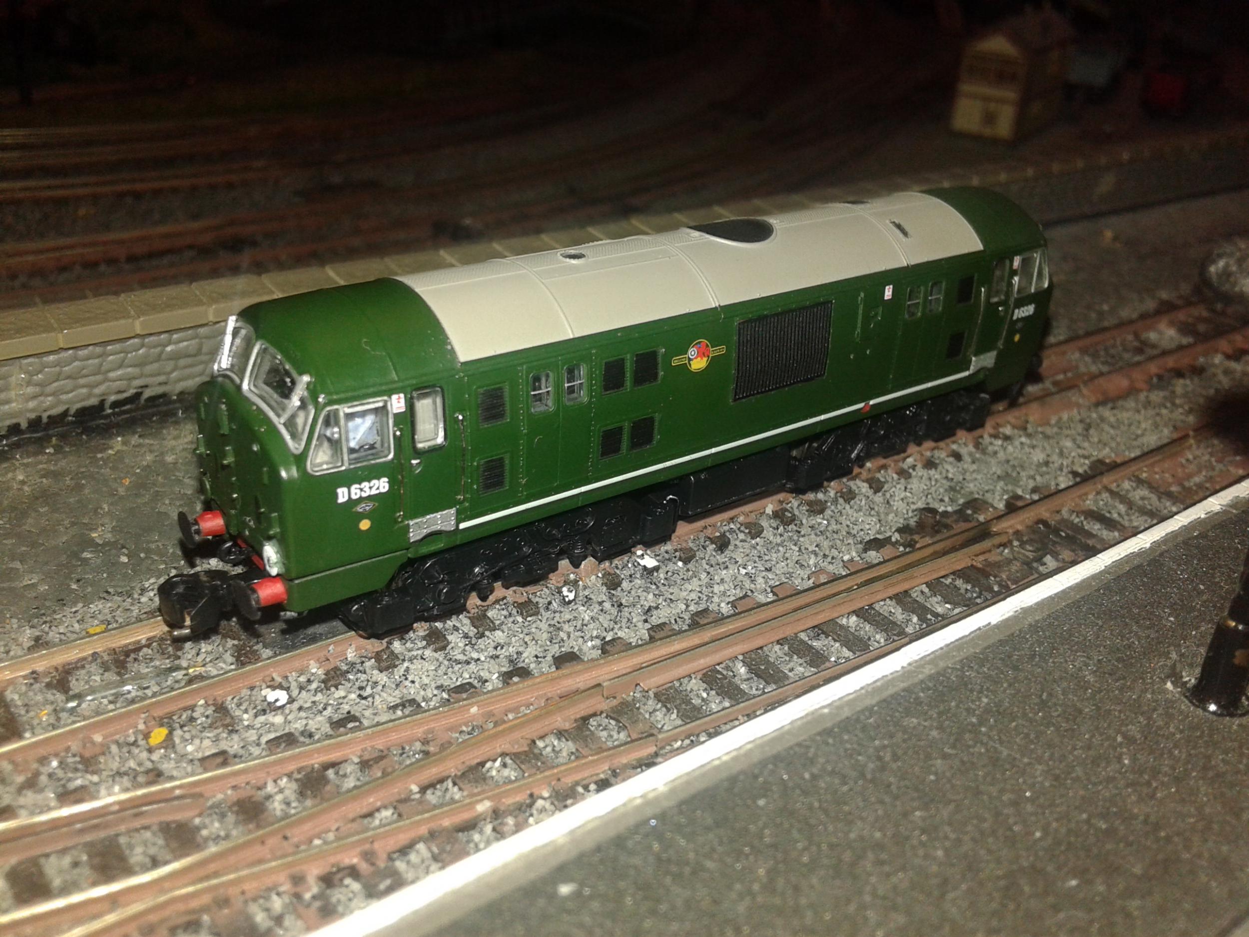

One of Hatton's Dapol bargains, only £76.
Here she is in all her glory, D6326 and even better she was known to have run on the Fairford Branch, albeit only goods between Oxford and Witney as far as I can tell.  She's now fitted with a driver at both ends and has Class 9 (stopping goods) disc head codes applied.
One word of warning:  When first received it wasn't a brilliant runner, wouldn't go from forward to reverse without a nudge and stalled occasionally.   :(
Reason was both the bogie pickups and the phosphor bronze contacts they rub on were badly corroded plus the bogie side of the pickups had a lot of black gunk on them, guess it was old grease.  Once degreased and all corrosion removed she runs brilliantly, in fact now one of my quietest and smoothest runners.  Next job will be to order another sound decoder for her.
