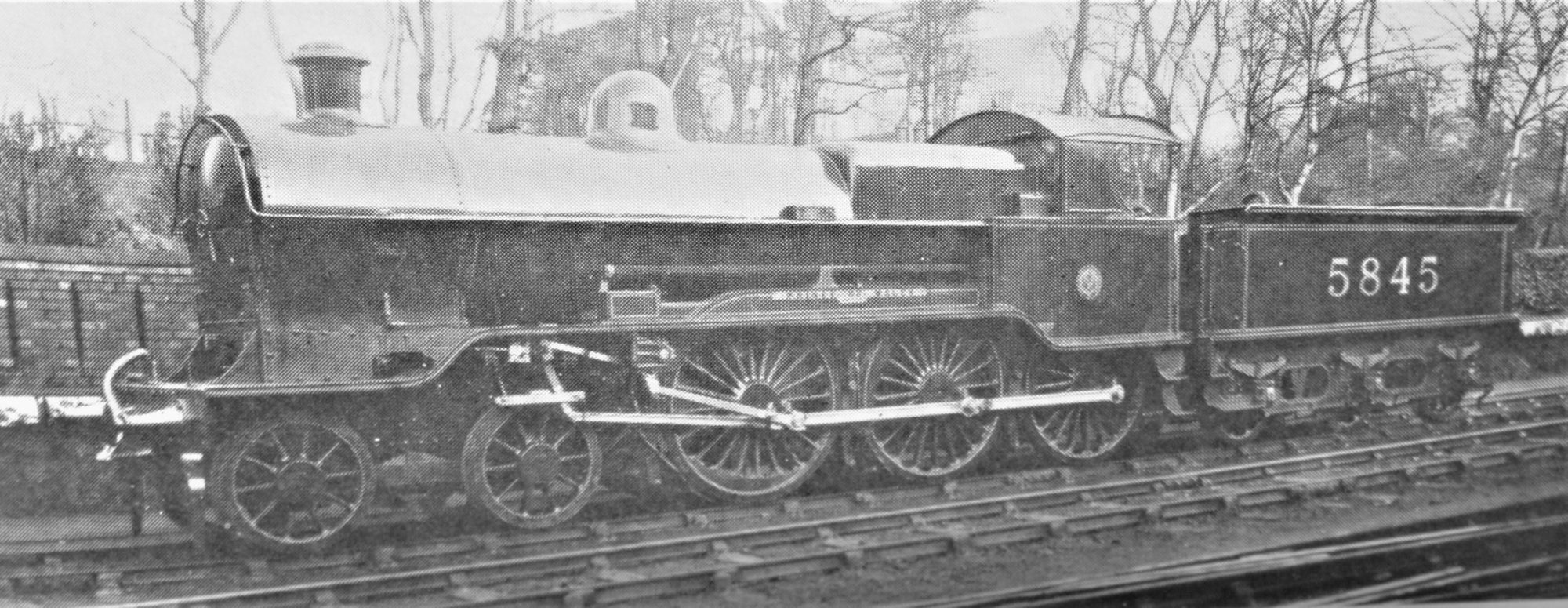

We mentioned earlier the death of CJ Bowen Cooke, Chief Mechanical Engineer of the LNWR, aged 61 in 1920. HPM Beames was appointed as successor. In anticipation of the 1923 Grouping, the LNWR and the LYR amalgamated on 1 January 1922. George Hughes had been appointed Chief Mechanical Engineer of the LYR in 1904 and was appointed Chief Mechanical Engineer of the enlarged LNWR.
At the Grouping, Mr Hughes was appointed Chief Mechanical Engineer of the LMS, a position he held until his retirement at the end of 1925. Sir Henry Fowler of the Midland was appointed Deputy Chief Mechanical Engineer to Mr Hughes and succeeded him after his retirement.
It's difficult not to feel a tad sorry for Mr Beames who went from Chief Mechanical Engineer of the mighty pre-amalgamation LNWR to Mechanical Engineer for the LMS Western Division, based at Crewe. This role had no design responsibilities.
We discussed earlier the Achilles' heal of Joy valve gear - the hole in the connecting rods for the pin for the jack link - and the connecting rod failures that occurred, especially as locomotives became more powerful in the era of the Big Engine. We mentioned a 'Prince of Wales' 4-6-0 suffered a catastrophic failure of a connecting rod which resulted in the death of both engineman.
Mr Bowen Cooke's new 'Claughton' 4-6-0 design of 1913 was equipped with Walschaerts valve gear.
But what of the 244 'Prince of Wales' class locomotives, construction of which commenced in 1911 and continued until 1922? These were powerful superheated locomotives capable of sustained hard work, particularly over the steeply-graded parts of the railway north of Crewe.
Mr Beames set his mind and Crewe Drawing Office to solve the problem. The solution was interesting - replace the inside Joy valve gear with outside Walschaerts valve gear.
Four locomotives were converted between March 1923 and April 1924 and then the programme petered out. Apart from an extraordinary occurrence.
The LMS ordered from Beardmore in Glasgow, which had already built 90 of the class during 1921/1922, another example. She was built with outside Walschaerts valve gear and had a Belpaire firebox. Built in March 1924 and given LMS crimson lake livery with number 5845, Beardmore exhibited this oddity at the British Empire Exhibition between April and November of that year. She was even given Prince of Wales nameplates when on exhibition. To avoid potential embarrassment, the first engine in the class, former LNWR No. 819, had her rightful Prince of Wales nameplates removed for the duration.
And, with other locomotives becoming available, that was the end of the conversion programme. Sir William Stanier's great restocking of the LMS was not kind to the 'Prince of Wales' class, with the four conversions being withdrawn between 1933 and 1936. No. 5845, then renumbered 25845, was withdrawn at the end of 1947.
Incidentally, the final member of the class, unconverted of course, survived until 1949.
With regard to No. (2)5845, Mr Beames had developed a programme of replacing the round-top boilers on as many LNWR locomotives as possible with Belpaire boilers. The LMS-liveried 'Cauliflower' shown in a picturingham in Part 65 is a good example of this. That explains the Belpaire boiler. The outside Walschaerts valve gear was the same as the four recent conversions, so that is understandable.
But why on earth order a single 'Prince of Wales' two years after the last member of the class had been delivered? What were the LMS authorities thinking about? (2)5845 was the last locomotive to be built to an LNWR design.
This is purely speculation (all right, a guess), but I wonder if Beardmore, keen to diversify its munitions factories into locomotive construction, and wanting a locomotive to display at the British Empire Exhibition, made the LMS an offer it couldn't refuse.
Why was this part entitled, The 'Tishies'?
Please look at the outside valve gear in the picturingham of No. 5845 and imagine what it looked like when the engine was running.
At the time there was a well-known racehorse called Tishy and she had the strange characteristic of changing her stride during a race, giving the appearance of her crossing her legs. Notwithstanding this trait, she had been successful and was the favourite to win 1921's Cesarewitch Handicap. She came in last! A feat which I understand she repeated in 1922.
She became something of a national institution and even featured in a cartoon strip in a newspaper for many years.
Seeing the first conversion running, with her valve gear seemingly moving in all directions, when Tishy was so much in the public mind, made the name inevitable.
So there you are - a strange tale about locomotive valve gears. Tishy died in 1923 but her memory lives on amongst steam engine people with an interest in the odder branch lines of locomotive history.

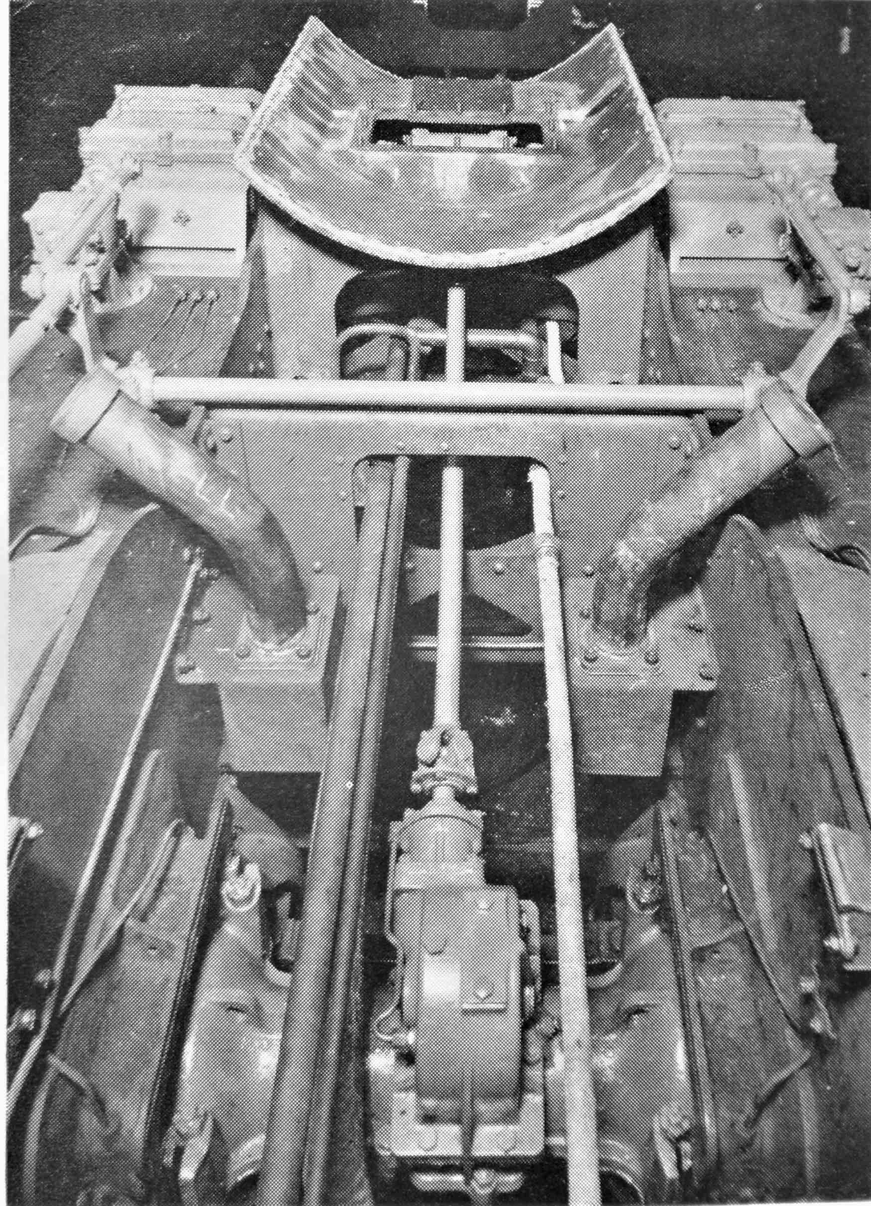

But Dolgoch is an oddity.  You see, she has a long wheelbase and the firebox sits between the two axles. Her outside cylinders drive the rear coupled wheels. The proximity of the firebox to the driven axle means there is no room for the eccentrics for her valve gear on that axle.
Mr Fletcher didn't worry about that, instead, he placed the eccentrics on her leading coupled axle. Lets think about this for a moment.
Locomotive valve gears derive their necessary movement from the strokes if the piston. Pretty much universal practice is to take the drive for the valve gear from the driven axle, although we noted Joy valve gear which took the drive from the connecting rods. In the case of Dolgoch, the drive for the valve gear was taken from the coupled axle, not the driven axle.
It's always good to hear from LTC Rolt - here he is on this peculiarity of Dolgoch:
'[...] while to incorporate the inside valve motion, which was almost universally favoured at that time, a devious and not altogether satisfactory expedient had to be adopted. Because the rear driving axle was behind the firebox, the eccentrics must needs be mounted on the leading axle whence they drove the Allan straight link motion, while the valve rods, of banjo form to clear the axle, passed between these eccentrics. This means that the valves were driven via the coupling rods, and the more technically minded will appreciate that this added source of lost motion gravely prejudiced the maintenance of an accurate valve setting. Moreover, sandwiched between such narrow frames, the lay-out was necessarily cramped and inaccessible.' 1
Therefore, if we are going to design a steam locomotive, I suggest we take the drive for the valves off of the driven axle. However, that supremely practical and confident engineer, Mr Ivatt the Younger, chose to take the drive for the valves of this LMS '5MT' 4-6-0 from the leading coupled axle, rather than the driving axle:-

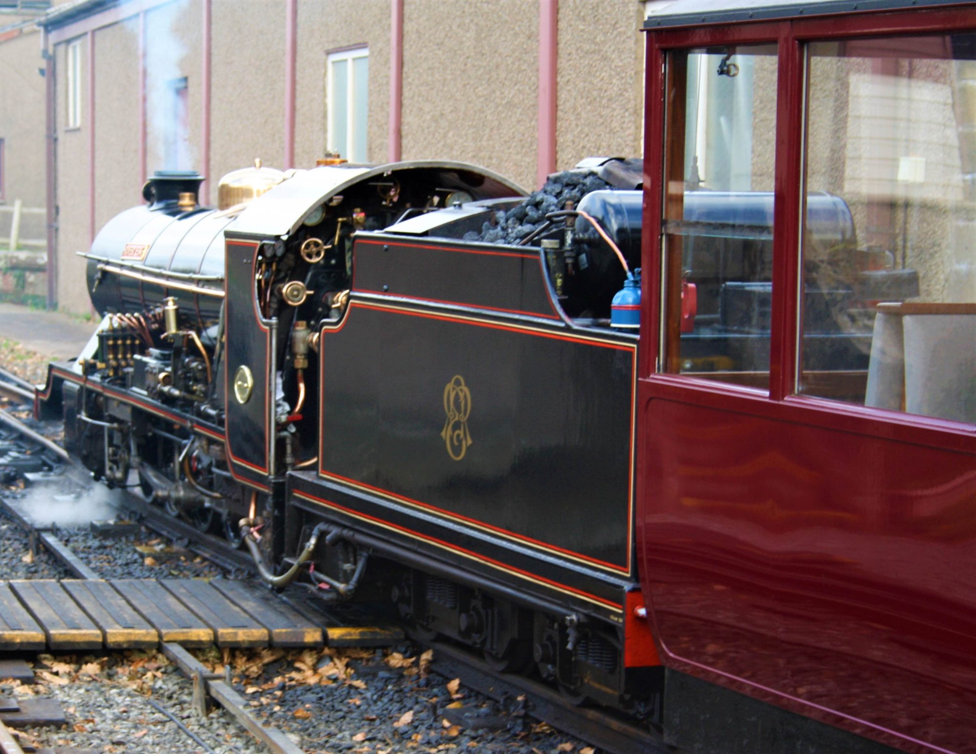

The Ravenglass & Eskdale Railway had been converted from three foot gauge to fifteen inch gauge during the Great War. By 1920 it was apparent that a new and powerful locomotive would be required to work both the passenger and stone trains.
2-8-2 River Esk was designed by Henry Greenly and built in 1923 by Davey Paxman of Colchester. I understand this firm had the British rights to Lentz poppet valve gear and this might have been part of the reason for River Esk being fitted with it. Unfortunately, the valve gear wasn't successful in this application and she was rebuilt in 1928 by the Yorkshire Engine Co, when Walschaerts valve gear was fitted.
And here she is, waiting to leave Ravenglass with a train to Dalegarth.  What a railway this is. If you haven't been on it yet, I recommend you consider a visit. The people are lovely, the locomotives are fascinating and the scenery is exquisite.

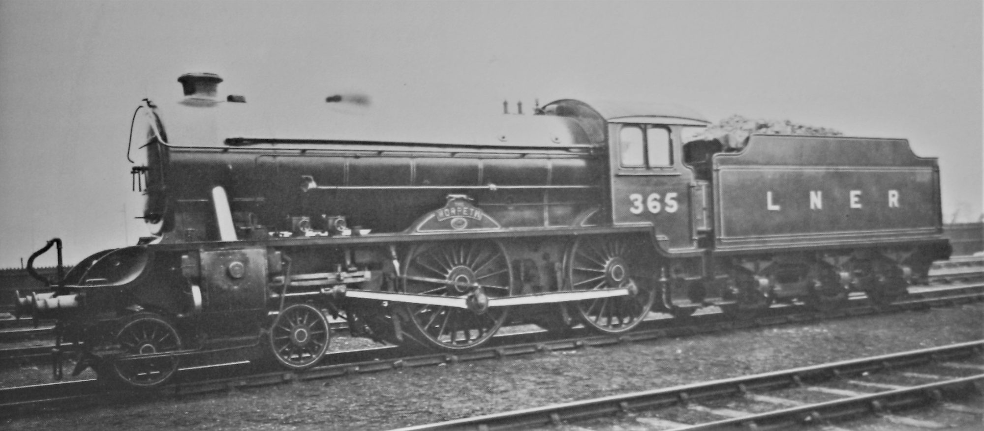

In September 1927, the first of a new class of 4-4-0 for intermediate passenger duties emerged from Darlington Works. This was the 'Shire' class - 'D49/1' in the LNER classification system. Six of the class were fitted with Lentz poppet valves and were designated 'D49/3'. Similar to the 'B12' 4-6-0 locomotives with Lentz valve gear, the 'D49/3's weren't as successful as hoped and, when these six engines required new cylinders in 1938 they were rebuilt as piston valve locomotives and became part of class 'D49/1'.
It is important for us to note that these early experiments with Lentz poppet valves were of the oscillating type, where the cams were driven by modified conventional valve gear, either Stephenson or Walschaerts. As we have seen, they were something of a disappointment.
Rotary Rather than Oscillating
However, Mr Gresley still thought poppet valves had potential, but a different operating system would be required to give a rotary motion. 'J20' No. 8280 was given an experimental rotary gear, driven from a coupled axle through a gearbox, in 1927.
The experiment was successful and, in 1929, 'D49/1s' No. 336 Buckinghamshire and No. 352 Leicestershire were fitted with Lentz poppet valves operated by rotating cams, driven by a bevel gear off the driving axle.
Although this gear had the disadvantage of initially only allowing five cut-off positions, a further series of these locomotives, built for the North Eastern Area, were fitted with rotating cam Lentz valve gear, which was modified to allow seven cut-off positions. This was the 'Hunt' class; No. 336 and No. 352 were renamed The Quorn and The Meynell in 1932 and became part of the class, designated 'D49/2'. The D49/2s retained their rotary cam Lentz gear until withdrawal.
['D49/2' No. 365 The Morpeth

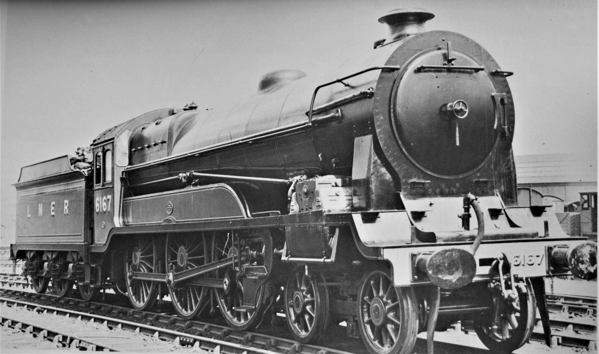

Making a change from Lentz valves, the LNER converted two 'B3' class 4-6-0 four cylinder express locomotives, Nos. 6166 and 6168, to Caprotti valve gear in 1929. These locomotives were from the former Great Central's 'Lord Faringdon' class which was known to have an especially high coal consumption.
The two converted locomotives had am average coal saving of 16%. Two further B3 class engines, Nos. 6167 and 6164, were fitted with a modified Caprotti valve gear in 1938/1939. The conversions were classified 'B3/2'.
[One of the first two Caprotti-fitted 'B3' 4-6-0s, No. 6167]

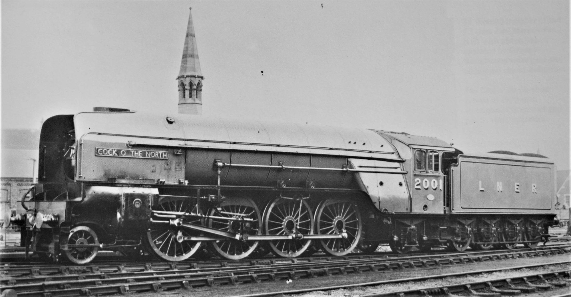

... so it'll be a jolly jape to end with another 2-8-2. Mr Gresley's mighty 'P2' for the difficult Edinburgh to Aberdeen line.
The first locomotive of the class, No. 2001 'male chicken' (changed by forum) O' The North was completed in May 1934. She was to a striking design, with her front reminiscent of No. 10000, 'Hush-Hush'. She was fitted with Lentz rotary valve gear and had an ACFI feedwater heater.
In December 1934, Mr Bulleid took No. 2001 to the locomotive testing station at Vitry-sur-Seine near Paris for extensive tests. These were hampered by niggling matters like overheating bearings. On her return, No. 2001 entered service.
[No.2001 'male chicken' (changed by forum) O' The North
The second of the class, No. 2002 Earl Marischal was completed in October 1934. She was similar No. 2001 'male chicken' (changed by forum) o' the North but had piston valves and the ACFI feedwater heater, which had proved troublesome on No. 2001 was omitted.
The other four locomotives entered service in 1936. They were equipped with piston valves. Unlike the first two, they had wedge-shaped fronts, like the 'A4' class. In my view, they looked wonderful in this condition and the first two were altered to suit. Then, Mr Thompson rebuilt the class as ungainly 'Pacifics' designated 'A2/2'. The rebuilds returned to Scotland but were soon banished to the southern part of the East Coast Main Line.
As to why only No. 2001 had Lentz valve gear, it is difficult to be precise. Certainly, she appeared to have a higher coal consumption than No. 2002, but this might have been resolved by further development of the valve events. On test, her coal consumption per drawbar-horsepower hour was not excessive.  But, in service, she was what Mr Bulleid called 'an extravagent engine'.
He pointed out that this was due to the engine diagrams:
'Instead of working trains well up to her capacity over long runs, she was employed in a service such as Edinburgh to Dundee, went to Aberdeen and hung about there, and did a very poor mileage per day, with the result that she showed a heavy coal consumption, most of the coal being burnt through misuse rather than in working trains.'1
