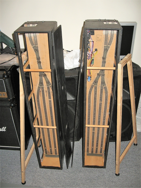

I use a Heathcote shuttle unit and their IR detectors at the ends of two fiddle yards. As well as triggering the shuttle the detectors also fire points in sequence via a diode matrix to perform route selection.  This gives me 7 trains running in sequence between the two yards.  In my case this was to automate running along double track modular boards when not connected into other modules. Although it's double track I just have one train from one end to the other, then another train back along the other line, and so on.
Here are the two yards.  At the top you can see the double track leading out onto the scenic modules - about 14' between the two ends. The IR detectors are where you can see gaps in the sleepers about 4" from the end of each track. The Heathcote shuttle unit is attached to the side wall top left of the right hand box.

@Trainfish I used IRDOT-P units which have a relay to fire the points via diode matrix. They only trigger the shuttle and fire the points on first detection (ie. train arriving at the end of the line). The shuttle unit also has an "inhibit" output which I use to prevent the IR-DOTs mis-firing at the wrong end as the train leaves.
So... train arrives, IR-DOT-P detects it and the points are fired to set for the next train out.   It also tells the shuttle unit to cut track power and start timing ready to run in the other direction. The shuttle then also inhibits all the IRDOT-Ps at that end.
It works very well. The only consideration is when you first power up the shuttle unit will always run the timer first then start off in one particular direction so you'd want that will be to run out of the platform.

@shaker_wooders As per my previous posts above, if you choose the correct Heathcote shuttle module and arrange suitable detectors and diode matrices for the point motors you can have as as many sidings and trains in the sequence as you choose to lay and wire up. You just need to keep one line clear for the first train to travel into. So my yards have 4 tracks at each end and I run 7 trains in sequence.
I forget exactly which of the Heathcote SA modules I used - I'll have to try and check the board or find the instructions - but basically the shuttle module runs the trains and the detectors plus diodes fire the point sequence. The diode matrix is derived from a "truth table" with inputs and outputs, so for example when a train arrives in siding A you work out which points must fire to select siding B; when the train arrives in B which points must fire for siding C to go next... and so on. when a train arrives in the last siding (D) it fires the points for siding A and the sequence starts again.  Mine had the added complication of switching between double tracks as well so I had to fire points at the far end yard too :)
