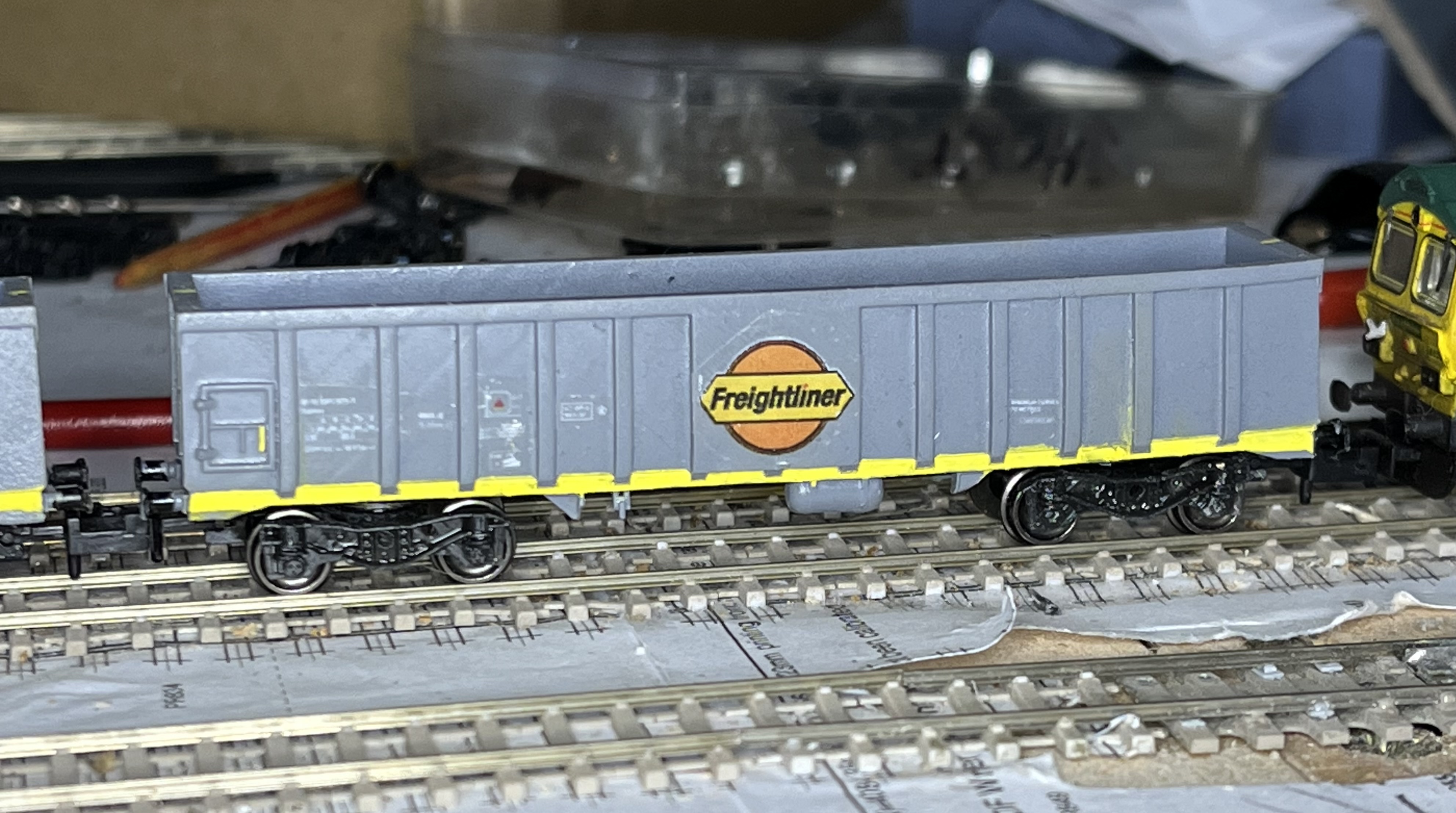

I do print white 'intensity patches' to go under colour decals, which works well. It's actually what Fox provide on some of theirs anyway to avoid decals looking washed out.
That's how the Freightliner logos are done here:
