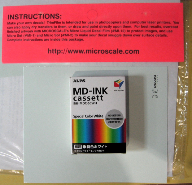

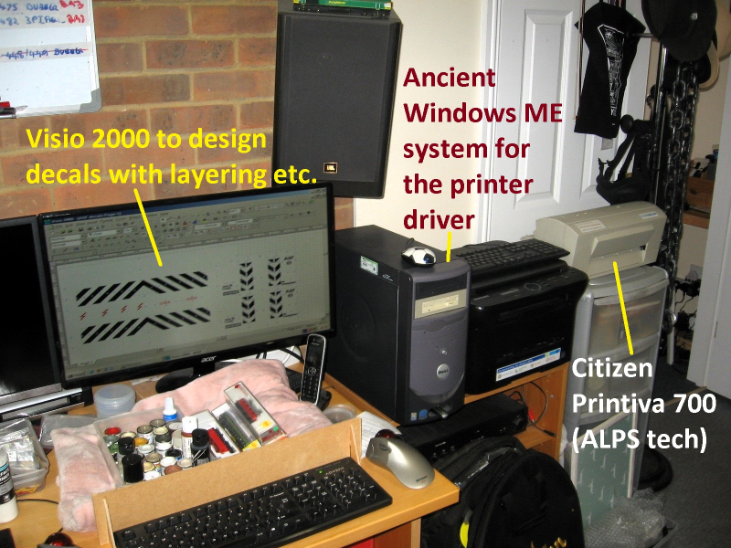

Keep an eye out for Ghost Toner on eBay, then buy a printer to suit. That's how I got mine, paid about £200 all in. Admittedly i was lucky that there was both a toner and a printer for sale at the same time (from different sellers). Definitely not a faultless solution, but probably the most accessible. That said, I'd also actually urge you to consider how much white printing you actually need to do. Of course 'intensity patches' are also a factor here for printing light colour decals over dark colours.
I probably said this somewhere in the thread, but what drove me to make my own was working with a noted producer on some custom decals. The process was insanely frustrating and protracted, with me providing artwork and him needing to 'rebalance' all the colours, that being a never ending cycle of posting samples back and forth. Yes he had the printer to create lovely detailed decals, but if the colours was awful then it seemed moot!
So here's the stuff I use to create decals, bear in mind this is 20 year old tech :)

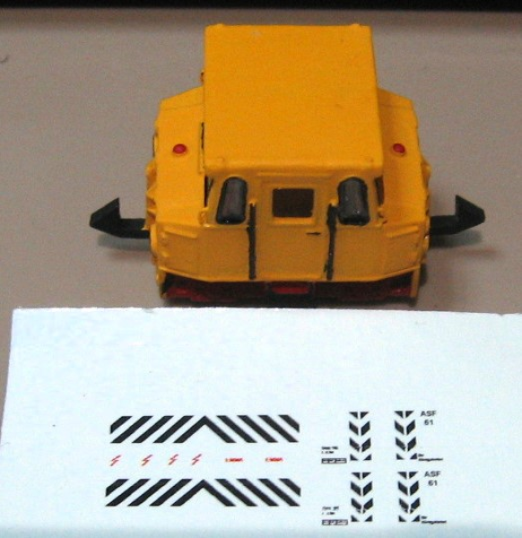

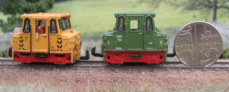

An example set of decals.  The small print is legible, just not in this poor photo :(
The green ASF needed white ink for some of the text and for backing the yellow and red.
