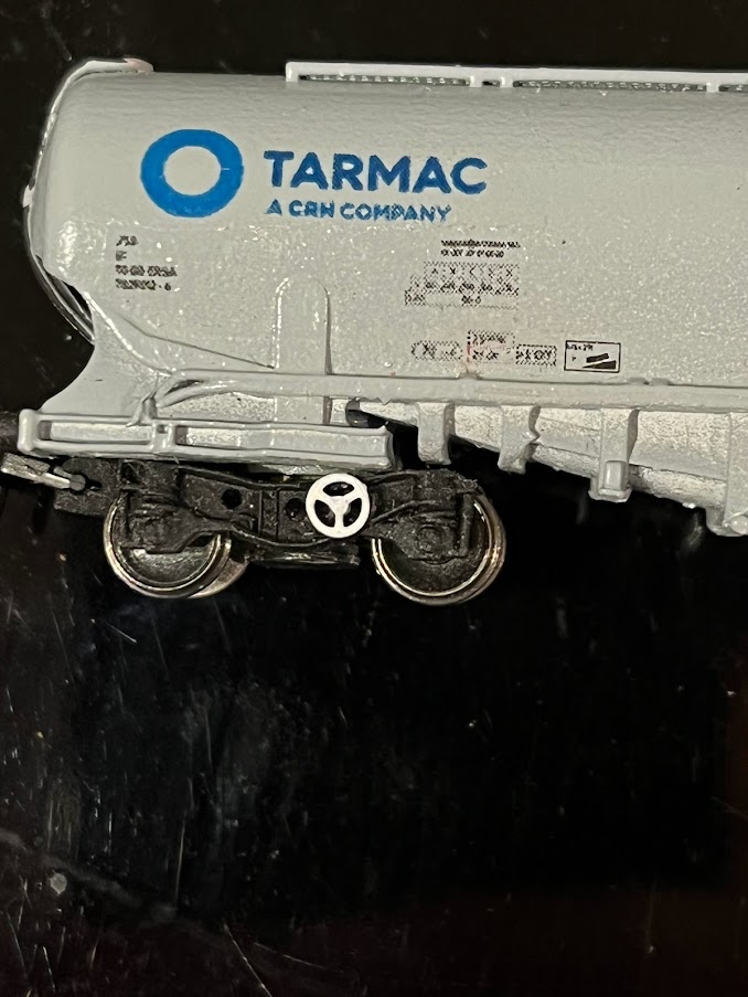

Re-did some of the decals, actually worked well.
Posting this mainly to show the limitation of a laser though with the dot dithering, which is oddly visible on the Tarmac logo. I also printed your 'shields'. Excuse the light, they're in the shadow of my phone - but gives you a benchmark to compare to your existing printer. Obviously this is just on ordinary paper (and standard quality).

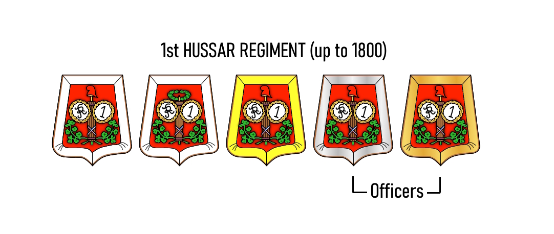

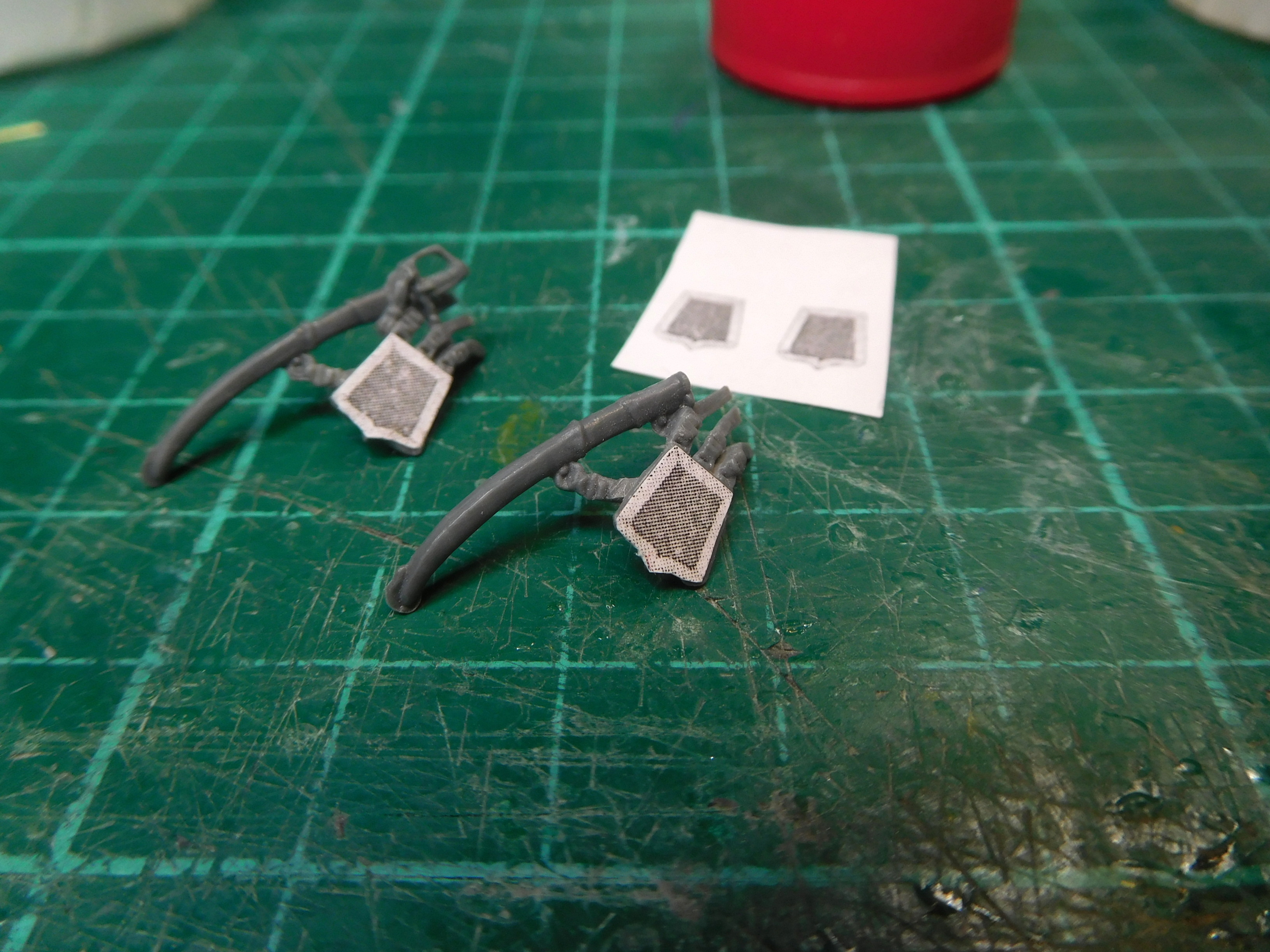

So Njee20, what exactly did you print those French Sabretaches on (printer type)?
My test print on my current faulty Lexmark X9575 is actually a lot better than what you have shown. Yet, this is all good info to have. So thanks for sharing.

Quote from: Doc Pye on June 21, 2023, 04:19:50 PM
HP MFP M177FW laser. Suggests your thoughts may be correct about inkjet, I will say they do look darker in the photo versus IRL, but I can't get a closeup without a better light to hand. I think it's 600dpi by default.
