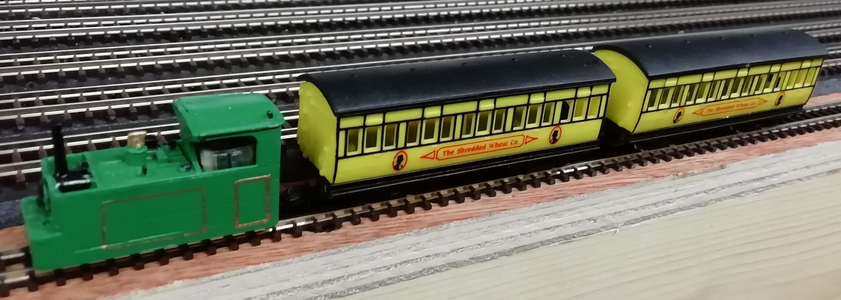

I'm part way through building my layout and am including an nn3 narrow-gauge. I have used PECO's NG-651 tram loco body on a Marklin chassis:
https://www.normanwisenden.co.uk/ng651-peco-narrow_gauge-tram_locomotive_body_kit.asp

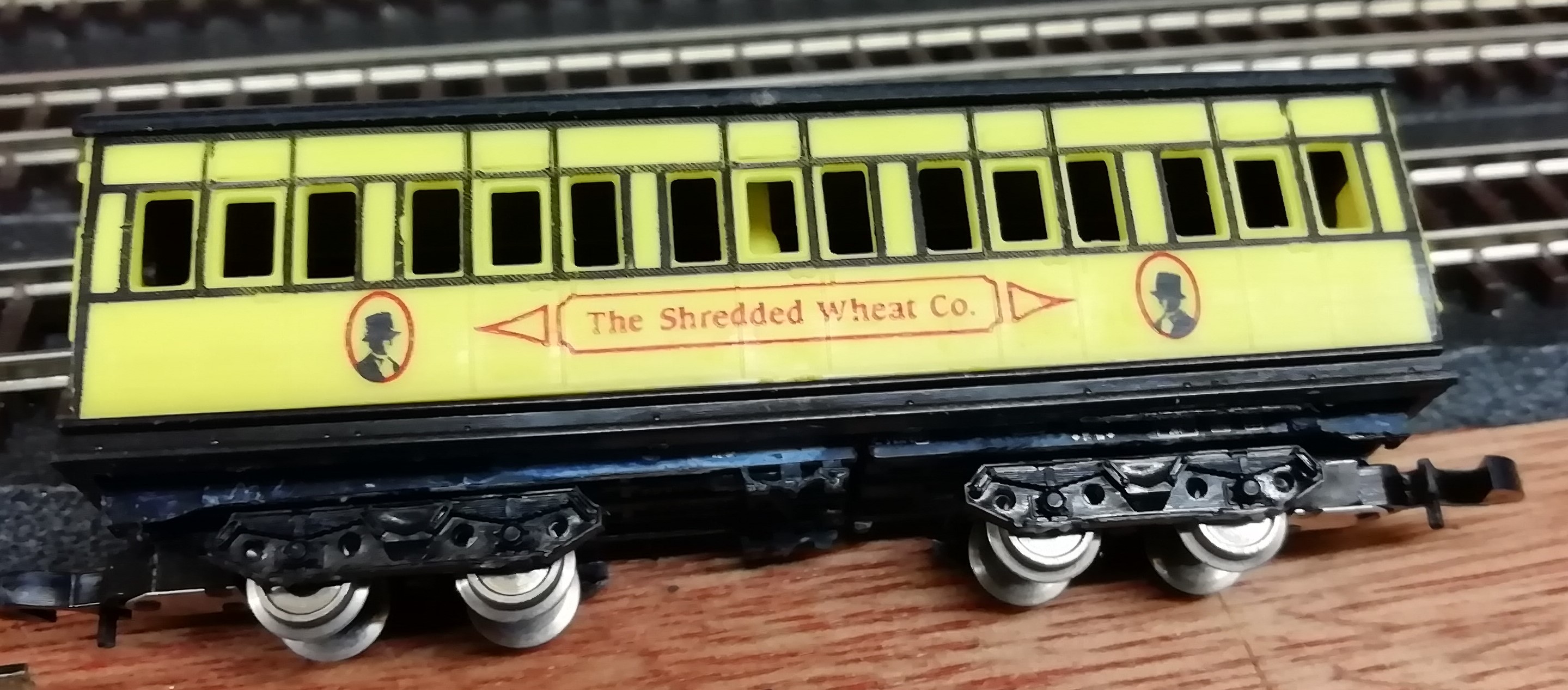

I have currently stripped everything below the sole bars of two Shredded Wheat carriages and glued them to the chassis of a couple of American, Z-gauge, bogie tankers.
brakevan
Having excavated the loft for decades old model stuff I find I have those Shreddie coaches but no idea how I got them!! Great info, I'll check out that Peco loco.
