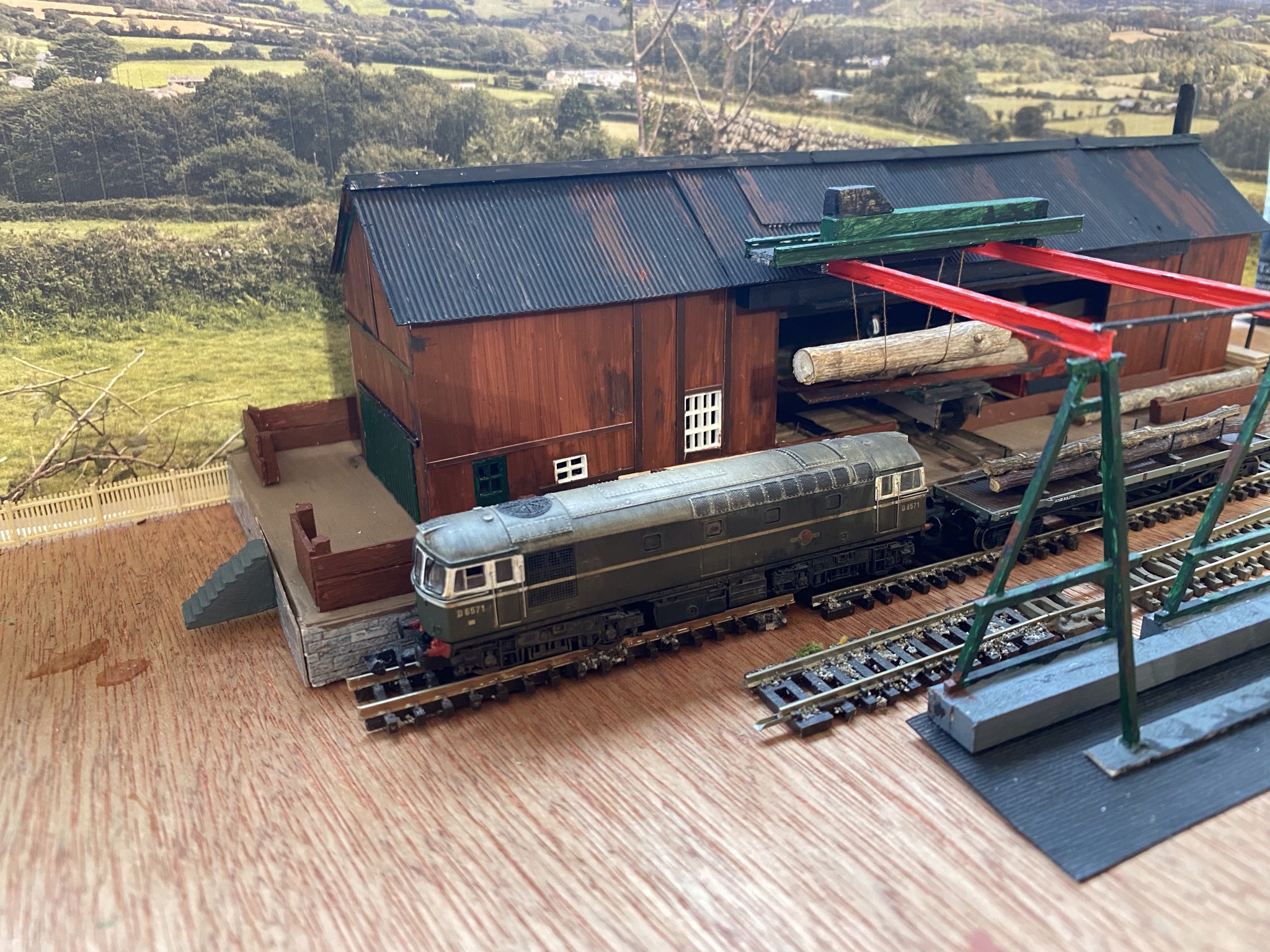

Here's a photo of one of my Class 33s which I've done a while back :
Hope this helps, if only a bit.

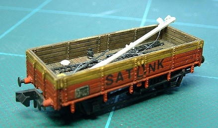

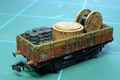

Here's a couple of my attempts on some Parkwood (now Peco) wagon kits. Main body colour was brush painted on before transfers applied & then varnished. The body and interior were then weathered with washes of mucky blacks with enamels thinned with white spirit. I'll see if I can find any more done in a similar way.
I don't believe there's a one-stop approach to weathering. Airbrushes, dry brushing, wipe on/wipe off, washes and powders all have their place and need to be used in combination to get the best effects.
Steven B.
