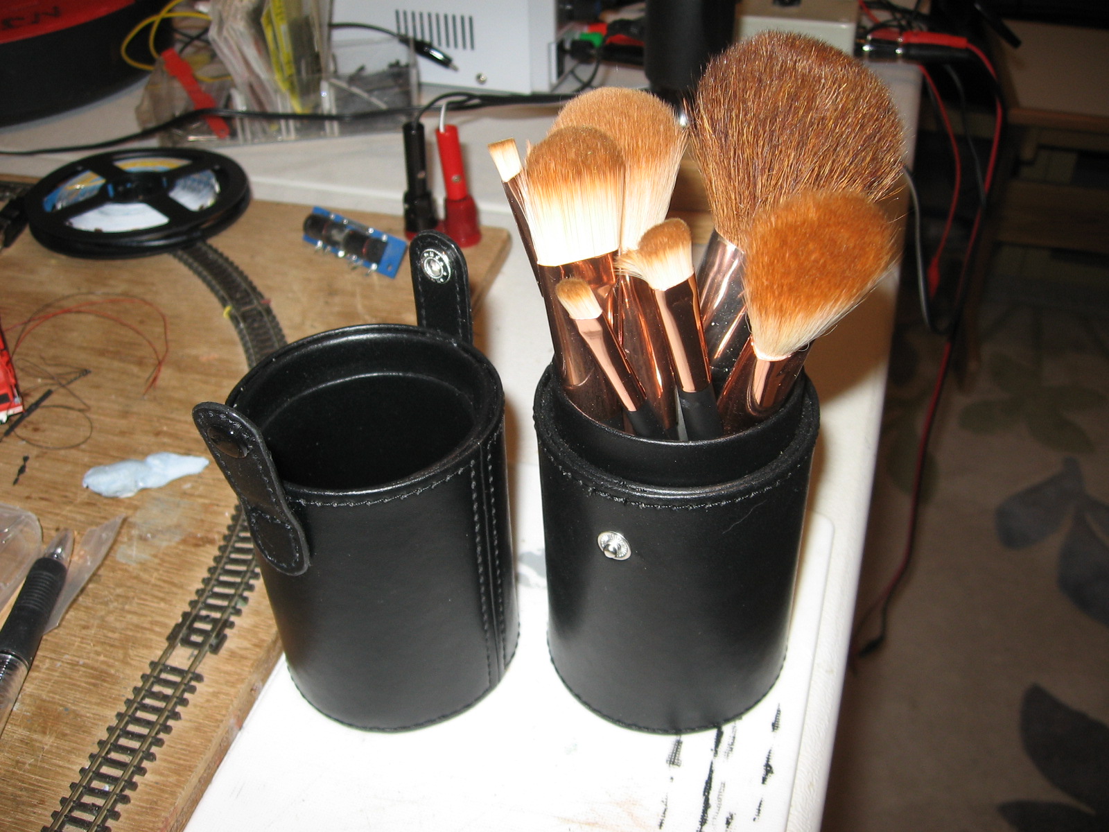

Dental pick, for uncoupling (that's an old one I learned from other N gaugers)
Cheeseboard knives. (the small ones that look like mini plastering knives) Turns out they're rather handy for working with small amounts of plaster on a layout.
Drinking Straws. handy for holding models while airbrushing (stick them to the model with a bit of blu-tac or tape a mini crocodile clip to the end as a gripper). Also handy for making wire-in-tube control for points.
Plasticine, just about everything. Holding models on straws for airbrushing/drying, filling in bits on the layout, weighting down wagons.
SWMBO's makeup brushes - nice and soft for dusting roads and roofs, arranging ballast before gluing etc.
She got so fed up with me borrowing them I have my own full set now ("middle of Lidl" of course)

Kate Moss might argue that they were intended for modelling. :D
