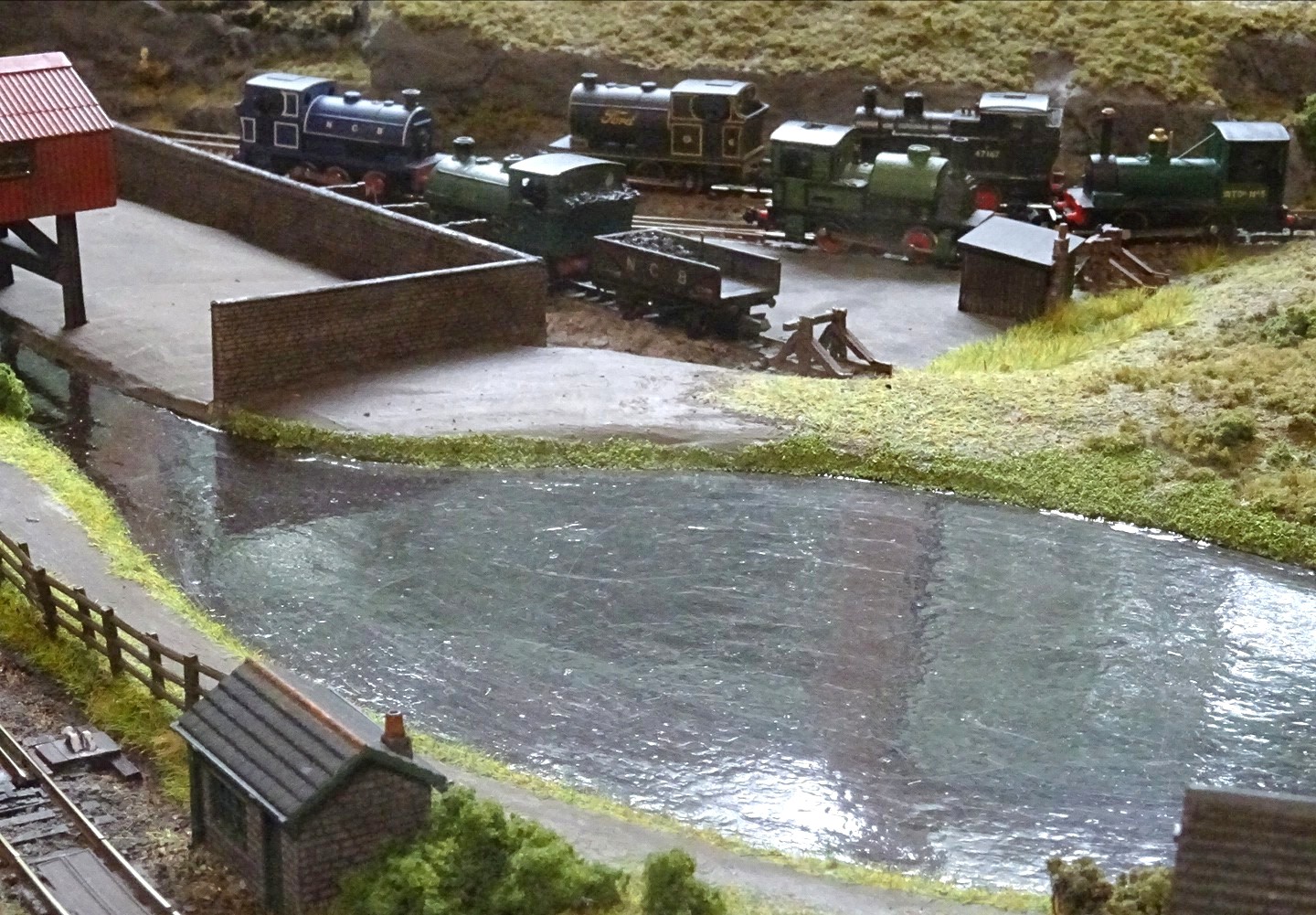

Might be considered a dinosaur, but a brilliant and reliable chassis. I still have some that date back to when they were new in the late 1960s. However they have found a new lease of life under other things.
Full story and pics at:-

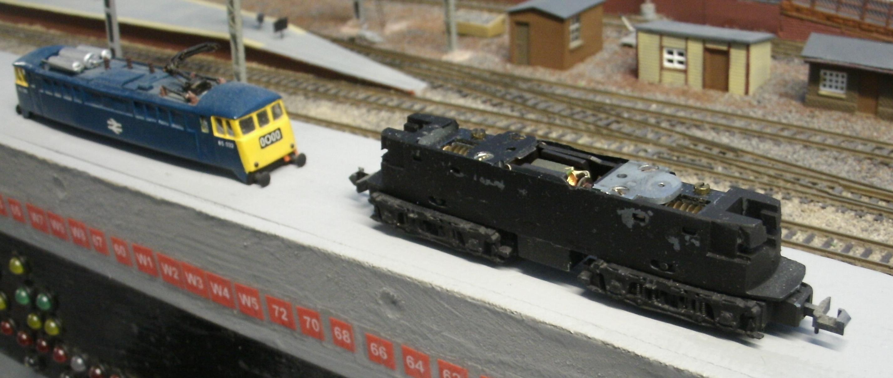

I would have thought British Trix's involvement with the 27 and 42 would have been just the bodyshell, given that the 27 used the chassis from the German E10 and the 42 used the chassis from the German V200.
The 27 chassis remained the same version for its entire life as far as I know and never adopted later the E10 or similar chassis, whereas the 42 adopted the later re-designed V200 chassis (body mounted buffers, different bogie sideframes, long-shaft motor etc.)
