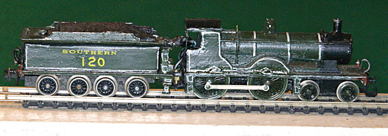

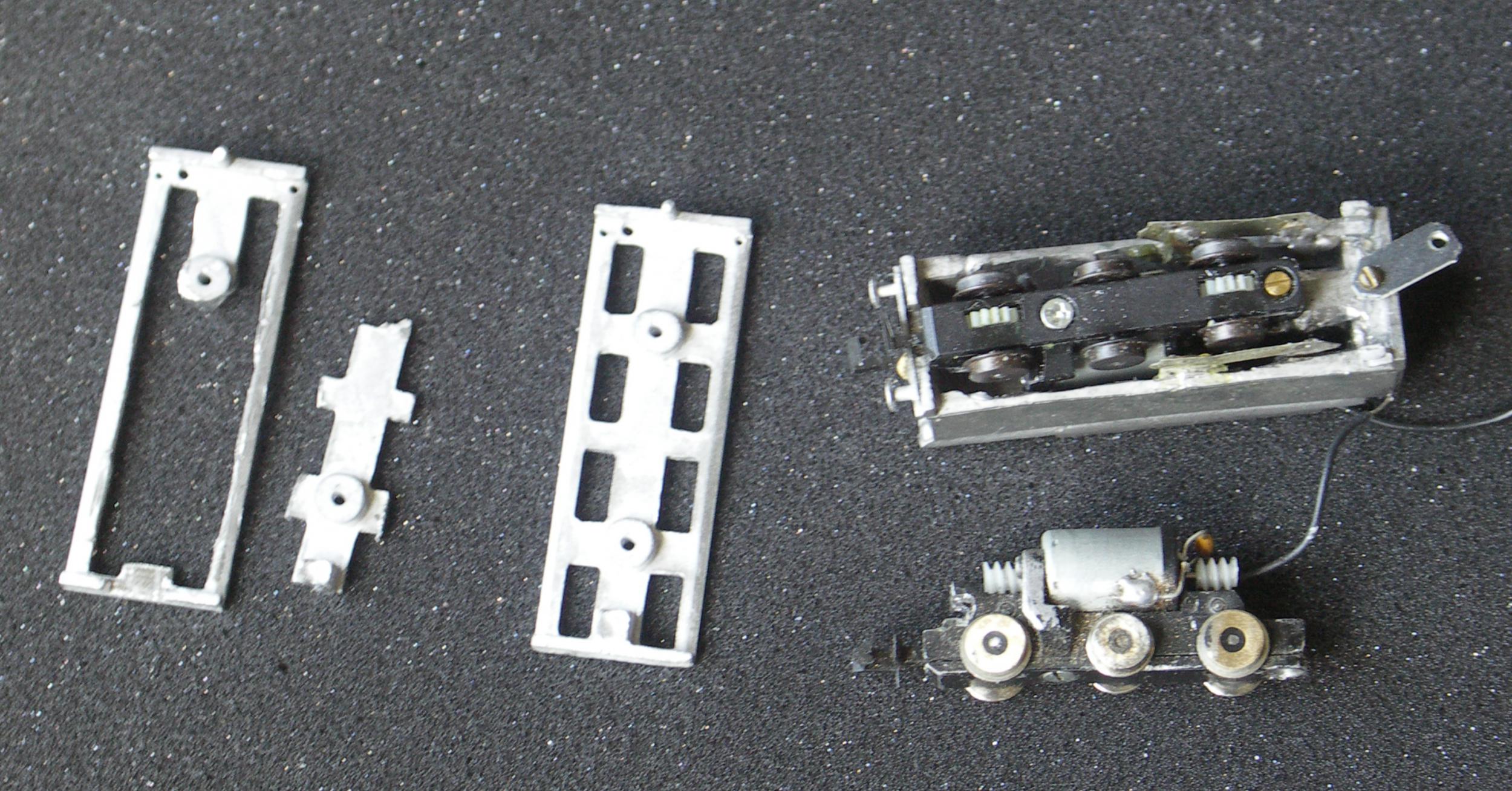

Another vote for the 700, and while you're about it surely an 0395 would not be out of place; just checked shed allocations on SEMG site and there were 3 or 4 0395s listed between 1929 and 1945 but no 700s, also lots of T9s, problem with the UM T9s is they are of the wide bodied 300 series with 6 wheel tenders most of which got loaned out to Eastern and Central sections in the 1930s however there were 4 of the 300 series at Exmouth in 1939 - edged out of th east and central by Schools and electrification, you can do a bash to narrow can and watercart by filing or milling off a few thou from cab sides and splashers and swap the tender for a Langley S15, you then replace the tender for the Langley S15  with a  BHE N15 tender kit and put the UM tender drive in it with an extra pair of wheels, you could also modify the Langley S15 cab to the Maunsell outline although most of the urie S15s had the same tender as the N15. (You can also mix 'n match Langley and BHE locos and tenders with different chassis to produce all variants of H15, N15 and S15)

BHE/UM modification (needs an extra pair of wheels at front)
Maunsell S15 (not on correct chassis just what was handy for photo)
T9 hack

Just had a few words with Mr Heard, 700 & 0395 will probably be in the next run. however he's not contemplating an Adams A12 0-4-2  - so my scratch one may still be unique, the preserved Adams T3 No 563 may stand a remote chance now that it is being returned to steam, I suggested the Swanage railway might want a few to sell in their shop!
