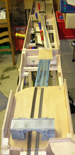

I think that one of the greatest contributions to railway modelling was American Lynn Westcott's open baseboard construction.
Allows scenery above and below the track base datum.
He used ply for the trackbed.
Yes I agree, I leave the top open other than for the trackbed and buildings/roads.

I'm with Bealman-lynn wescott's idea was a breakthrough -using 'L' girders as the Base and working up using softwood risers and plywood track bases it gives you the more options for the scenery or multilevel railway . A good view of the system is in Cyril Freezers book model railway design manual ( don't think Im allowed to upload a photo ?? Copyright ??) You just make up complex points arrangements or other track configuration on the bench -put in you wire droppers motors etc -test then plant the whole board into place and build on ! Revolutionary in its day -still stands today for permanent railways -only seen one on exhibition  trail ! 9mm ply for track bed ( I used 6mm for sides 6/9mm for top  but mines portable !
