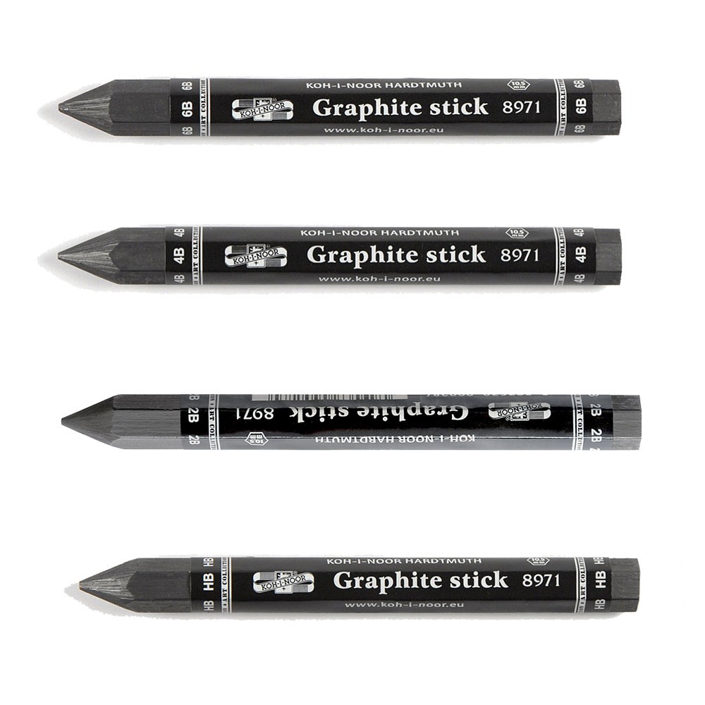

If you don't have slopes (or only small ones) on you layout then a soft graphite pencil rubbed along the track also helps. Don't do it with the power on, you'll short out the track..
It acts like as an electrical lubricant,
This is what I use.
