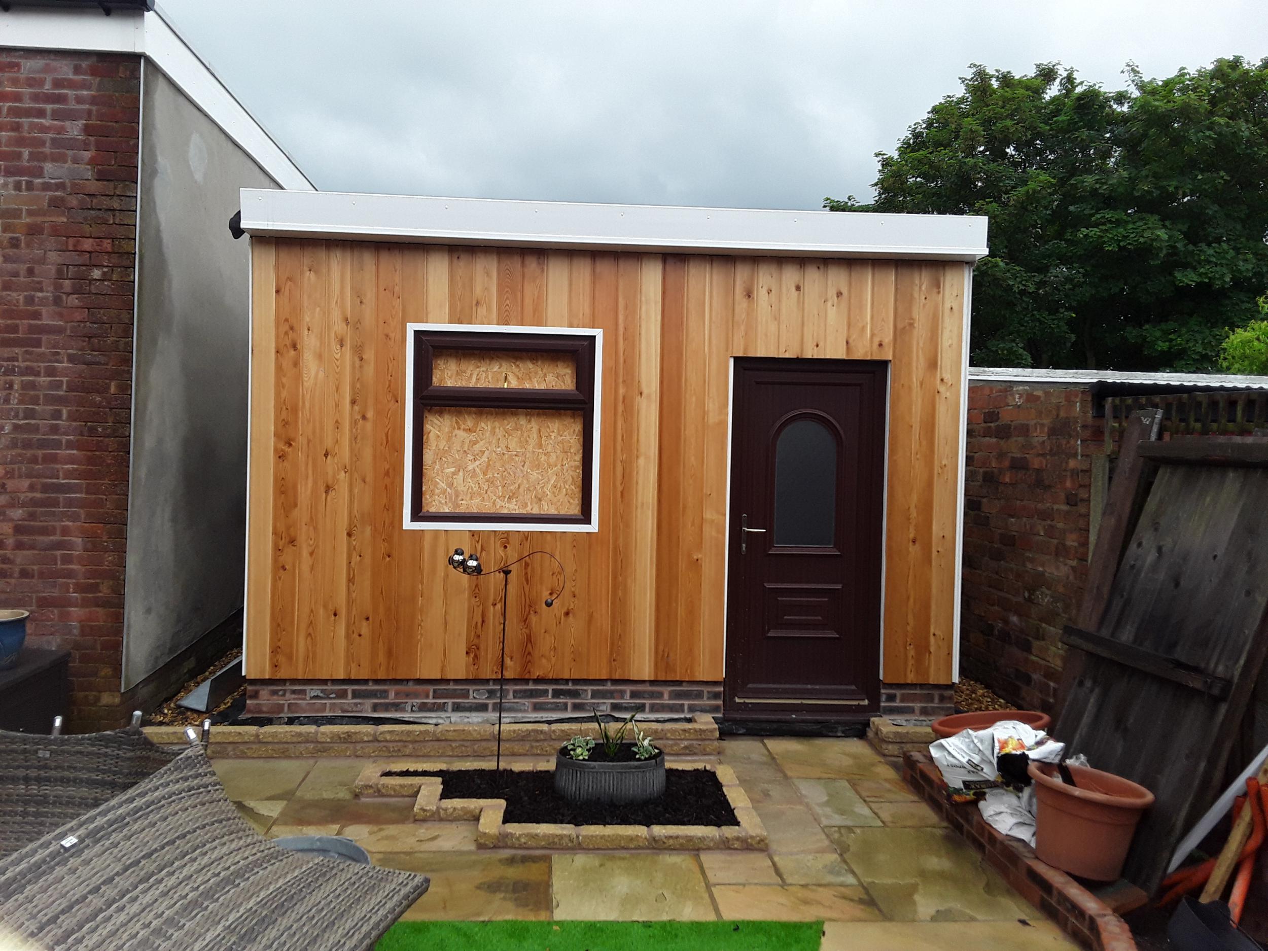

Mines osb board with a waterproof membrane on outside - slate battern - then upvc cladding over that - apart from the front - my one back down with the Mrs that's clad in Siberian larch . Metal roof is Sat on 1" polystyrene and that's Sat on osb board again ! Metal will condensate badly in winter if you don't insulate it - drip paradise ! Woods fine just use polystyrene from wicked - big sheet cheap - buy 5 they go cheaper again !
