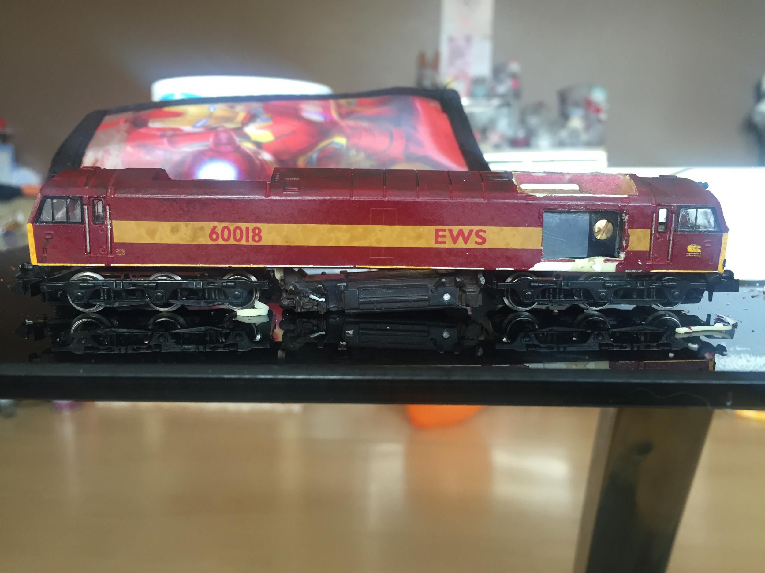

I'm currently trying to replicate a class 60 going through the super 60 overhaul process with a tpm body I received but required some attention when I got it.
I'm currently half way through trying to remove the roof so I can add plasticard to replicate the bulkheads as you can see when the roof is removed, but I'm kinda stuck at the moment because I need to work out how to cut a straight enough line right down the length of the side/roof join

remove body
find a piece of wood that fits snuggly inside the body
get 2 steel rulers
make a sandwich - Ruler then body(+wood) then ruler. make sure the top of the ruler is on the cut line you may need a thin padding layer to protect the paintwork
gently fit sandwich into a vice and tighten
score the line with a NEW scalpel blade ( or several) and keep scoring till a cut is made
Simples!
