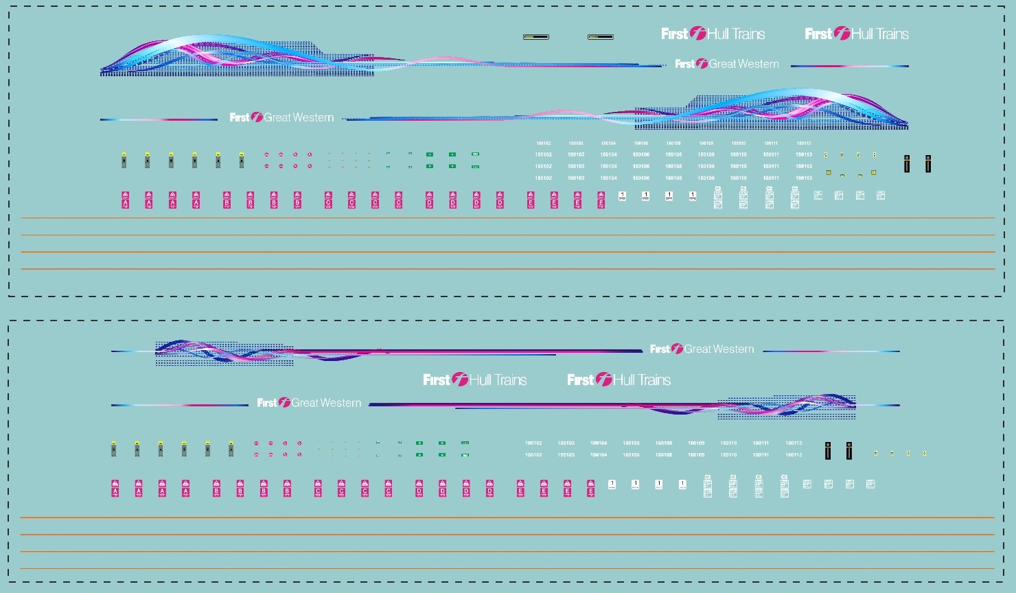

First draft of the artwork for the transfer set.  There are a number of additions including the First Hull logos etc, however we are almost there.
The image is degraded to avoid it being copied  :no:

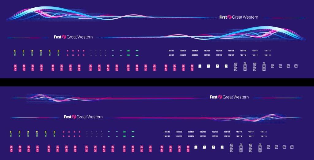

Last draft of the transfer set arrived this morning.  Once I have checked them I will be committing to have them printed.  I will put a post up soon on the final cost per set of 5 coached made up of two ends and three middle coaches.  There are enough spares and duplicates to give everyone a good chance of getting a very good result and there are variations as the originals have changed over time.  The Hull logos are substitutions for the sides and all the Hull numbers are included.  (This print is degraded to avoid copying)

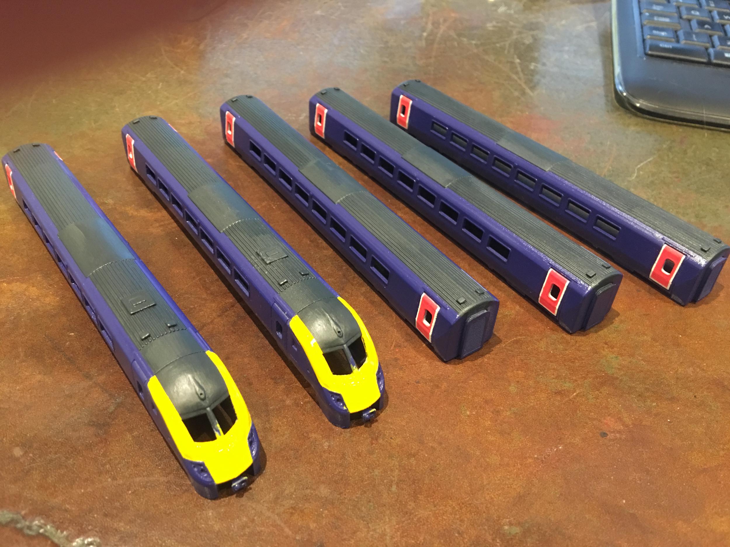

Snowwolflair
Now for the tricky bit.

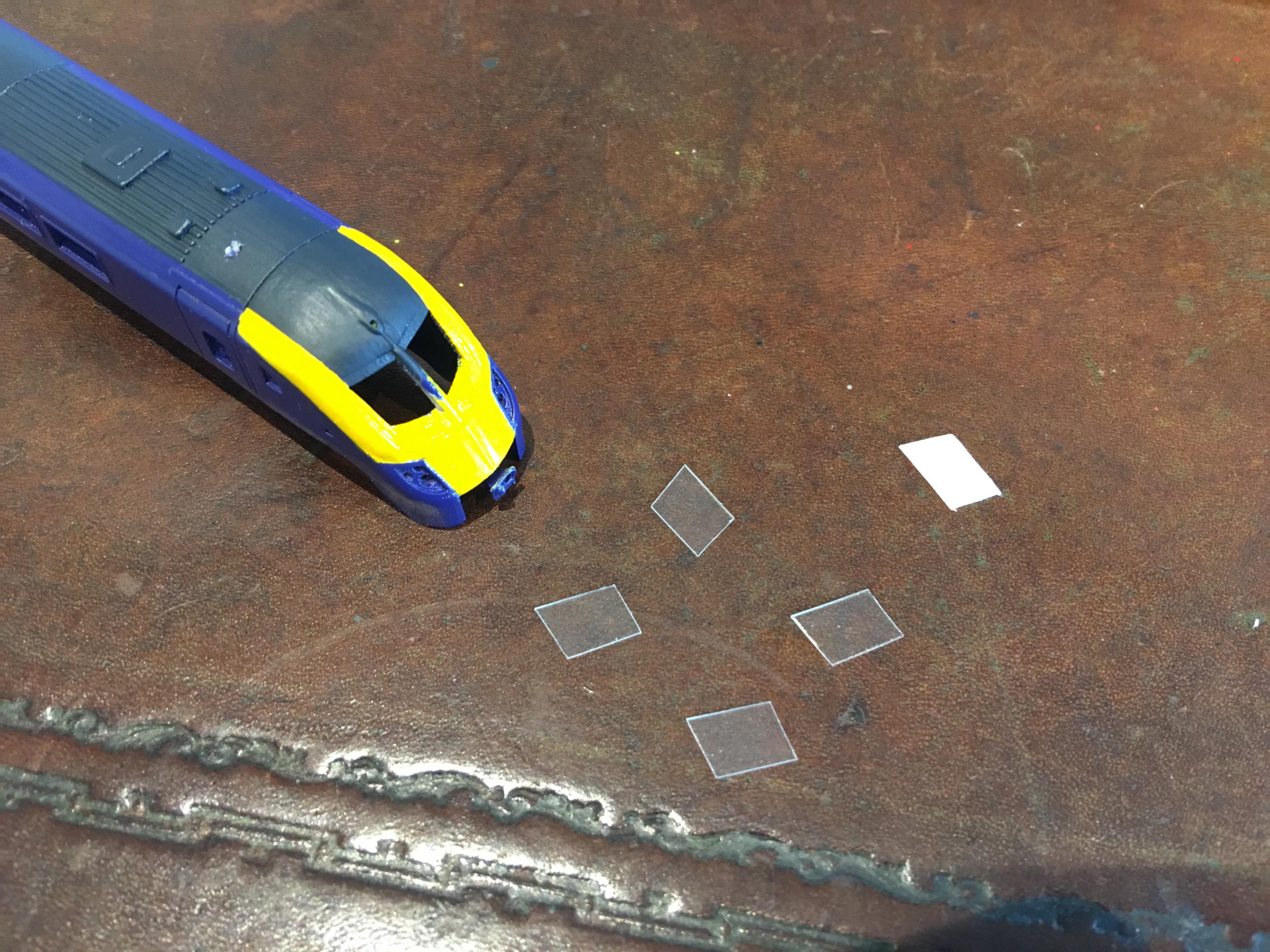

I have painted the roofs and the top of the nose.  As you will see I have still a millimeter or two of the yellow to cover, however, I will not paint this until I have fitted the front windows.
The windows will need to be back painted transparency as they are like modern car windows glued in place with a black border.  You will see there are molding lines to the full extent of the windows as the windows are much wider that the openings.
Just to complicate matters the windows are curved in two dimensions.
As for modelling ability Its just Age.  Age means I have done it before and learned and Age has taught me to be patient.  :)

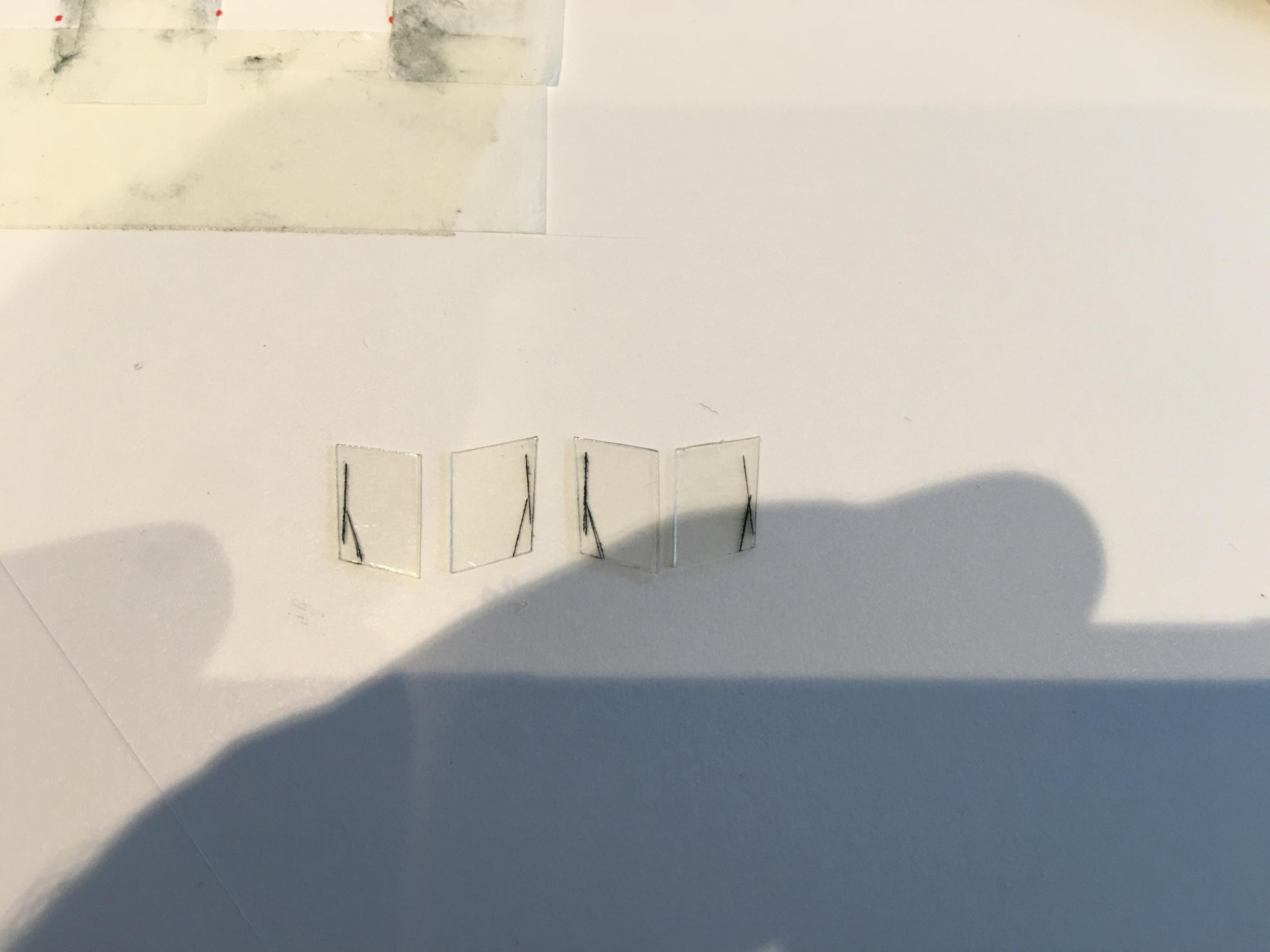

Snowwolflair

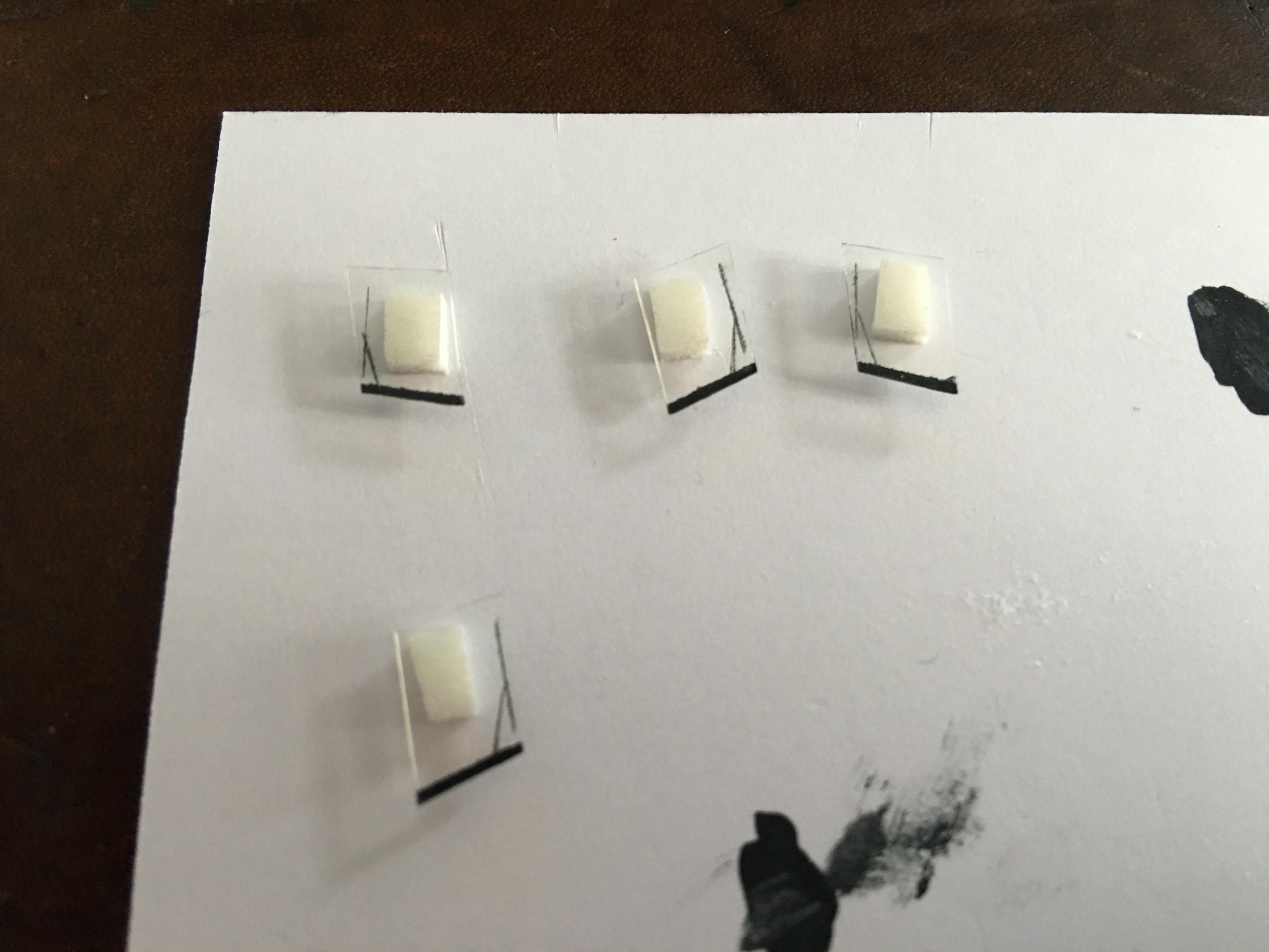

The windows are quite complicated and need quite a few stages to make.  the idea is that the last thing I will do is curl them slightly, however, before that I have to fully detail them and prepare the opening so they just drop in clean and they are done.
The wipers are scribe lines and then washed with paint.  This has the effect and wont get damaged in the future.

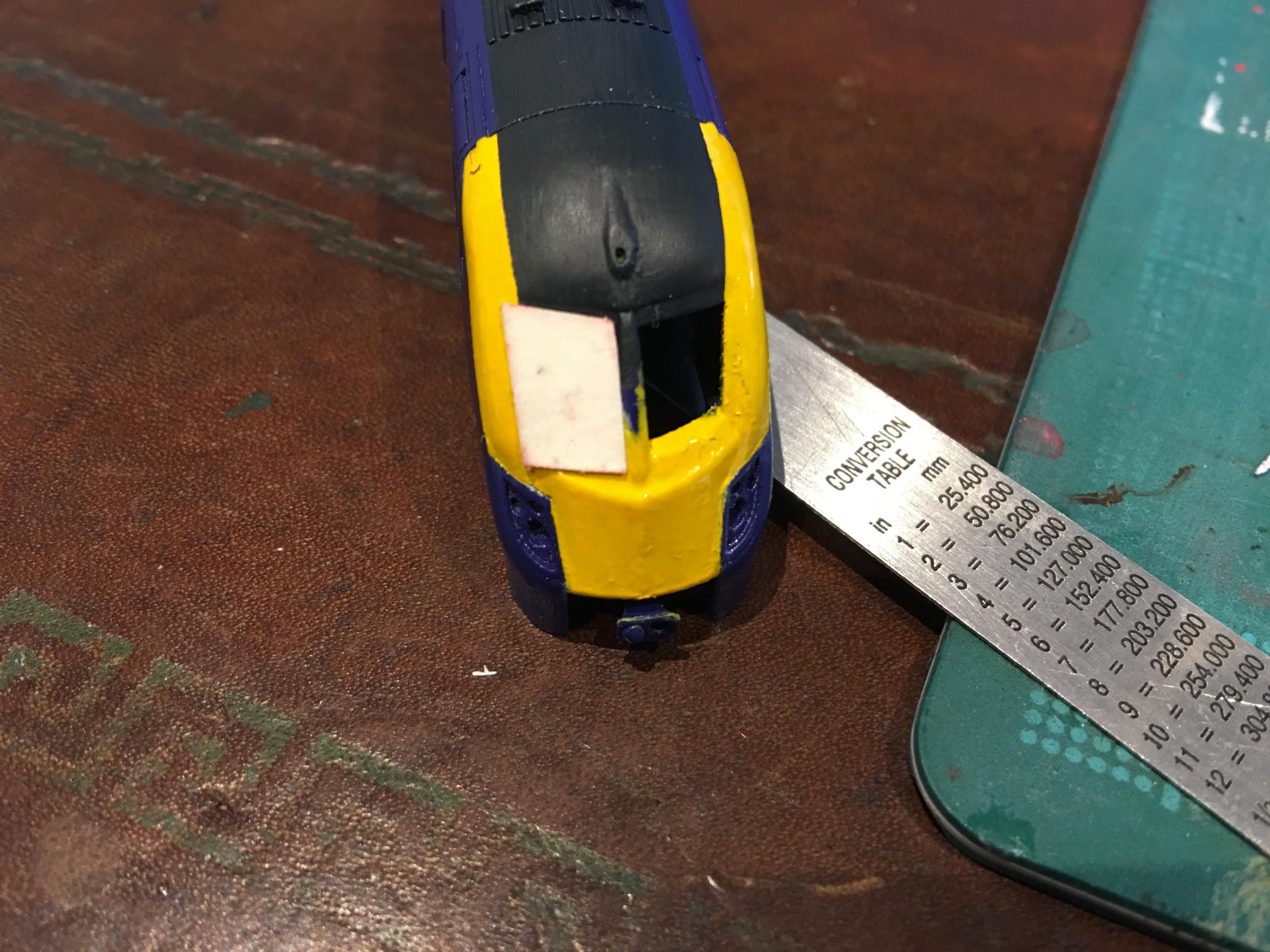

Being cheeky any chance of the dimensions of the windows ... save my grey matter when the time comes, and as you say patience and having got it wrong before -and worked out how to correct errors is one of the cumulative skills that make great modelers.

Snowwolflair
Its a trial fit, and as the body is 3D printed they are all the same fortunately.  What I might do is scan it and add x:y scales so it can be printed out and cut as a template.  I need to paint the edges and when I do this it will be easier to scan.
