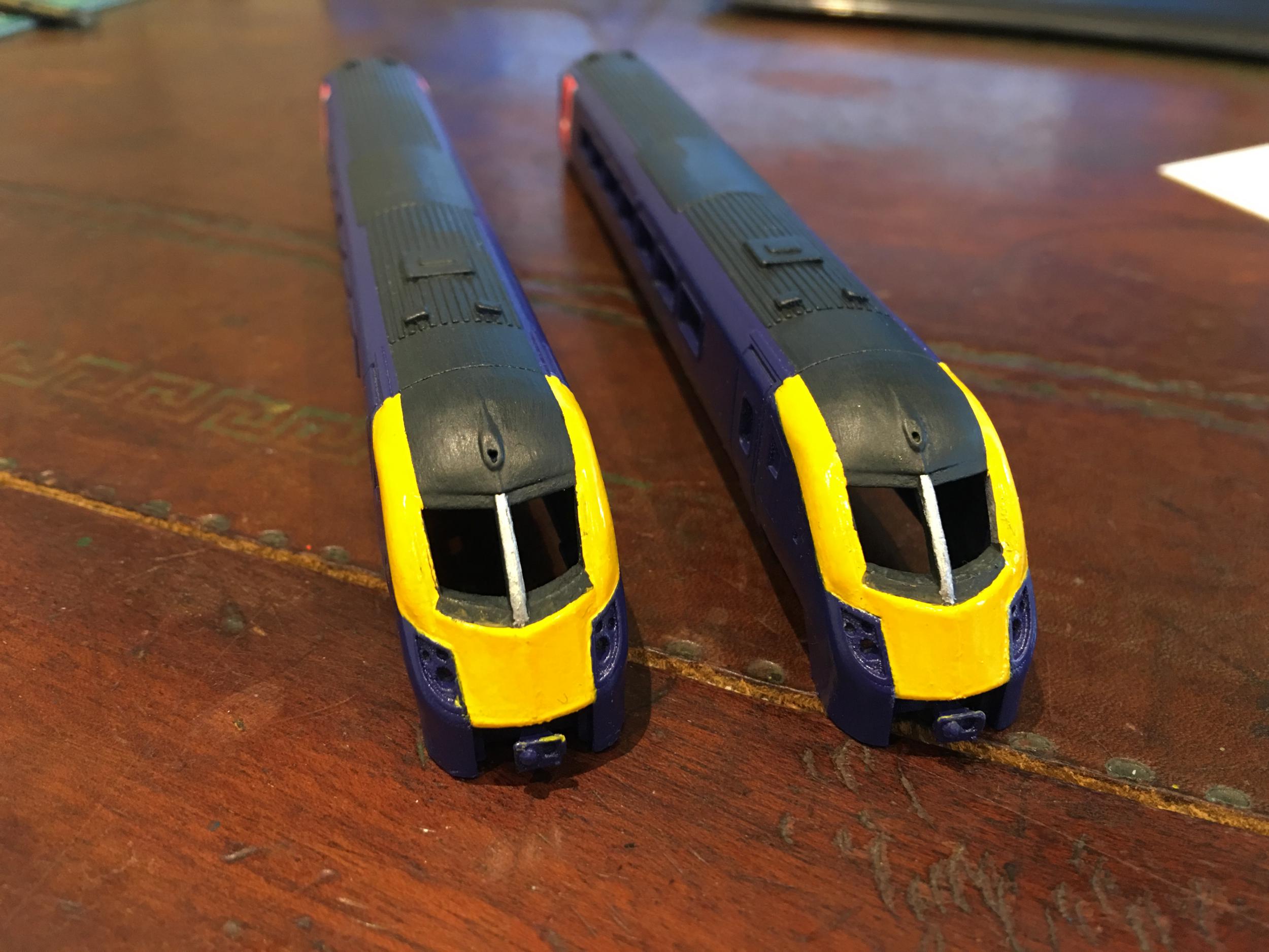

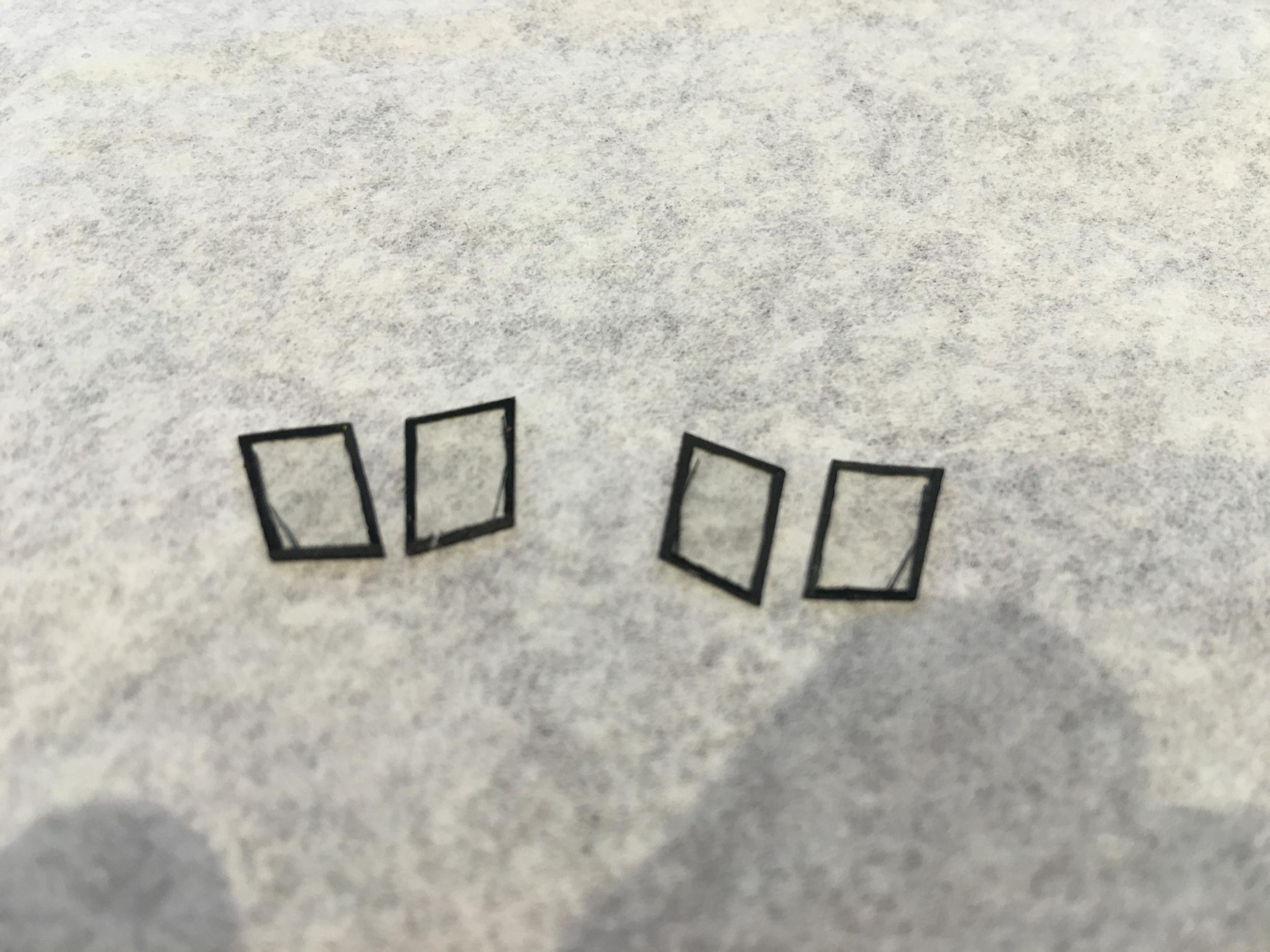

If you know the sizes from the 3D model then you could print the windows on OHP transparency (and include the surrounds and windscreen wiper as part of the print) - that should be flexible enough to curve correctly.
Cheers, Mike
GroupC
Really great modelling here, looking forward to seeing the complete set. Given the amazing standards so far, I presume the wipers will actually sweep too?
Snowwolflair
Overhead transparency is good but usually coated and if not coated the adhesion by laser printing or ink jet is poor.  I could print it by dye sublimation but this only allows single sided printing and for these windows two sided is necessary.

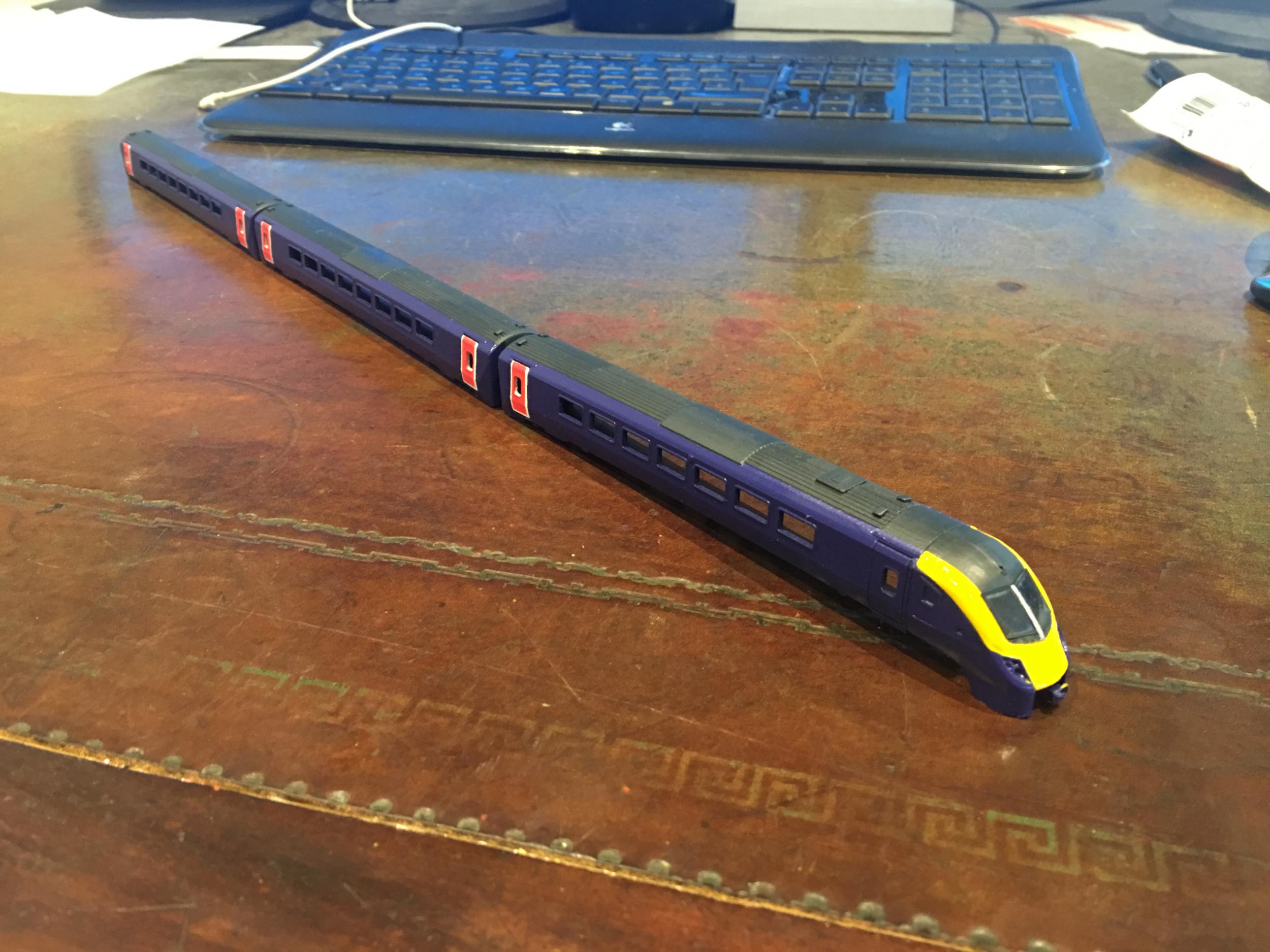

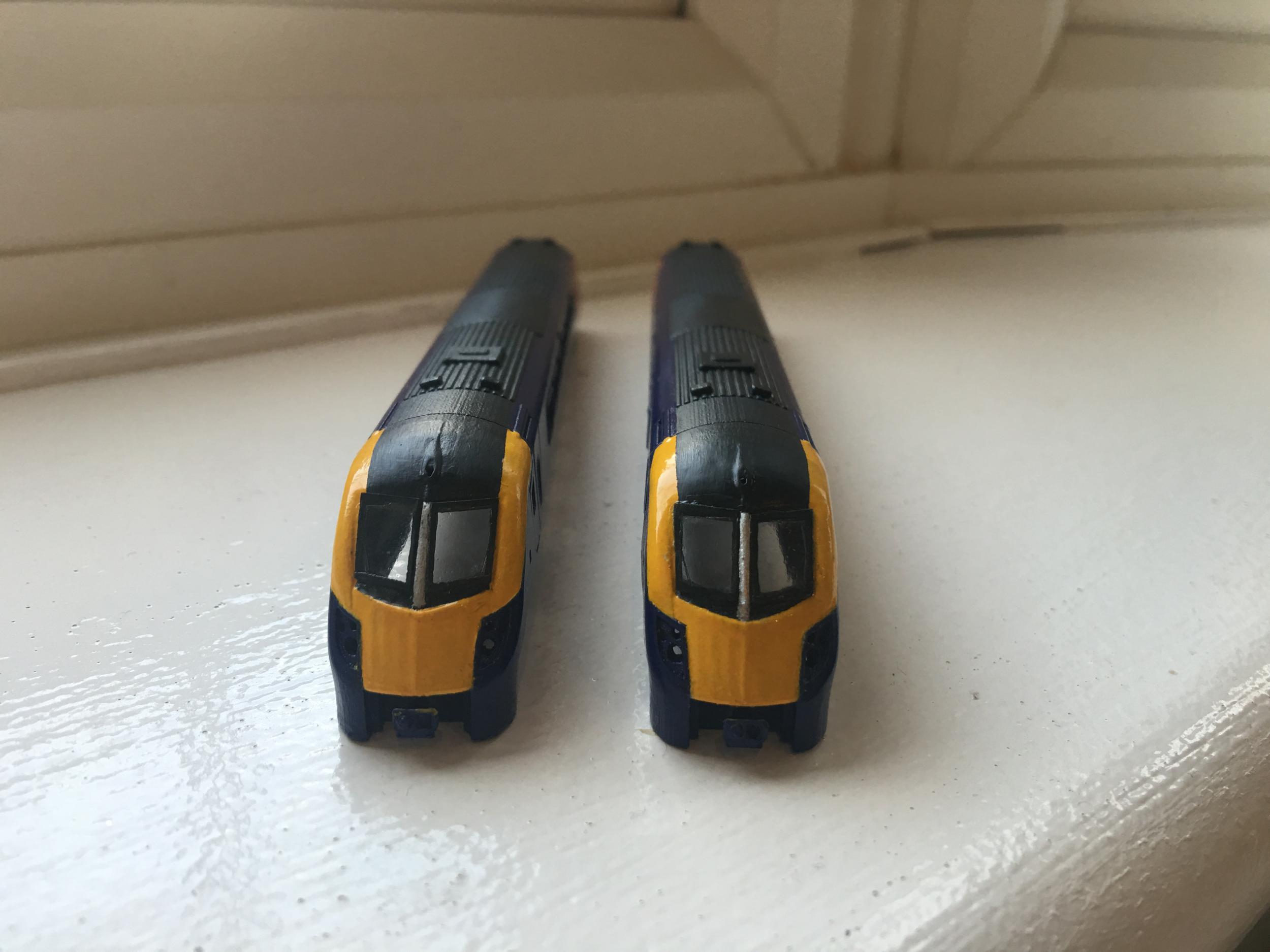

A bit less reflection of room lights on this shot.
Adam1701D
Best Regards,
Adam Warr
Peterborough, UK
Mustermark
Yep, that's coming on nicely. The paint job looks great. Windows are very neatly done too. It's going to be stunning with the decals.

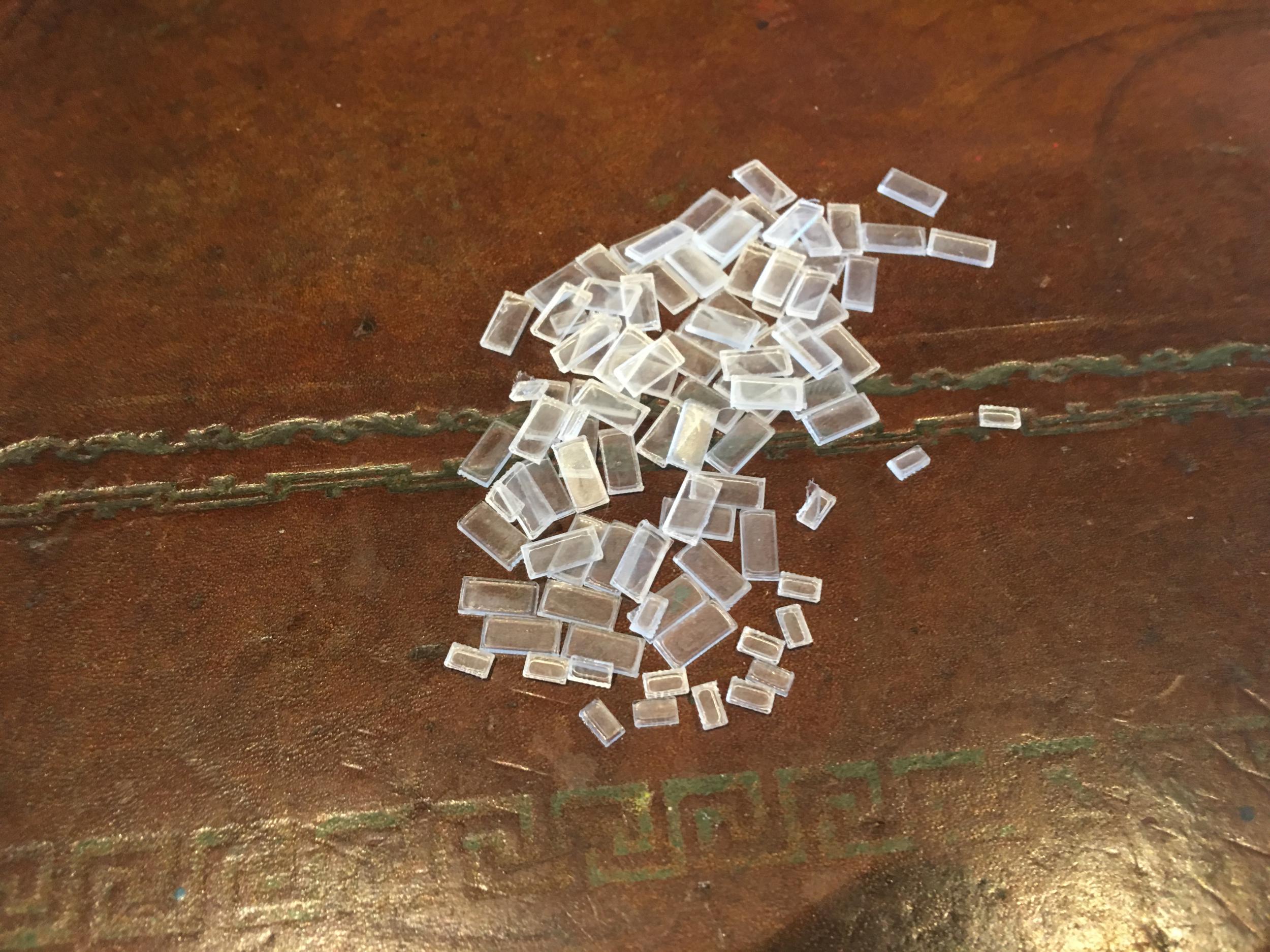

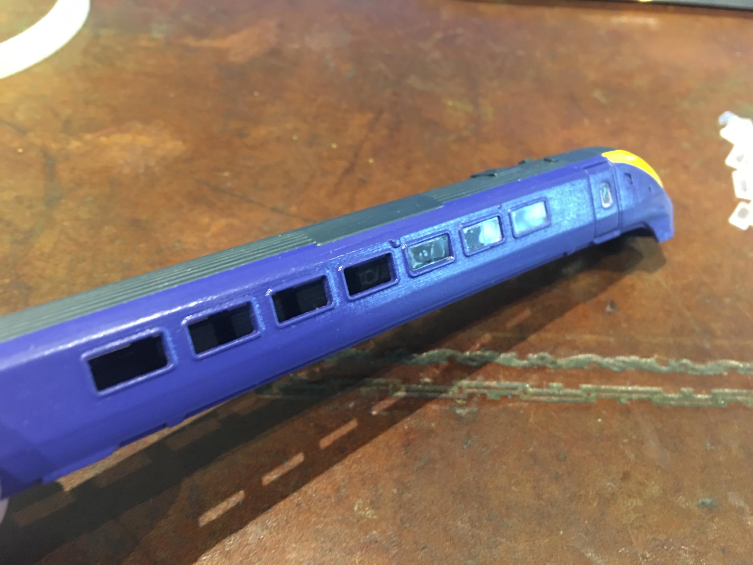

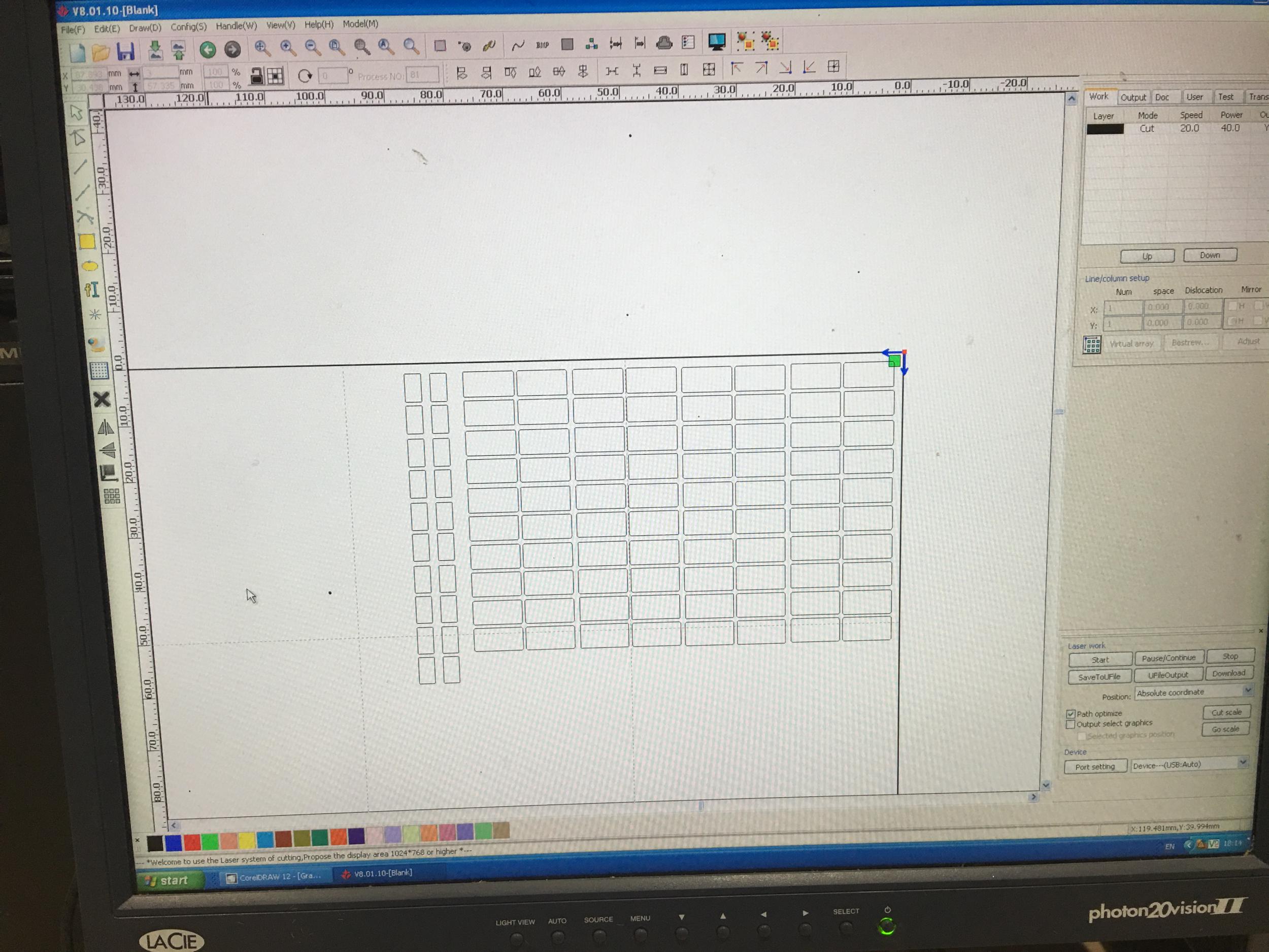

Laser cut windows.  The acrylic has a plastic film on both faces to protect them from the fumes caused by the laser and they get peeled off as the windows are glued in place.
96 windows is going to take a while  :)

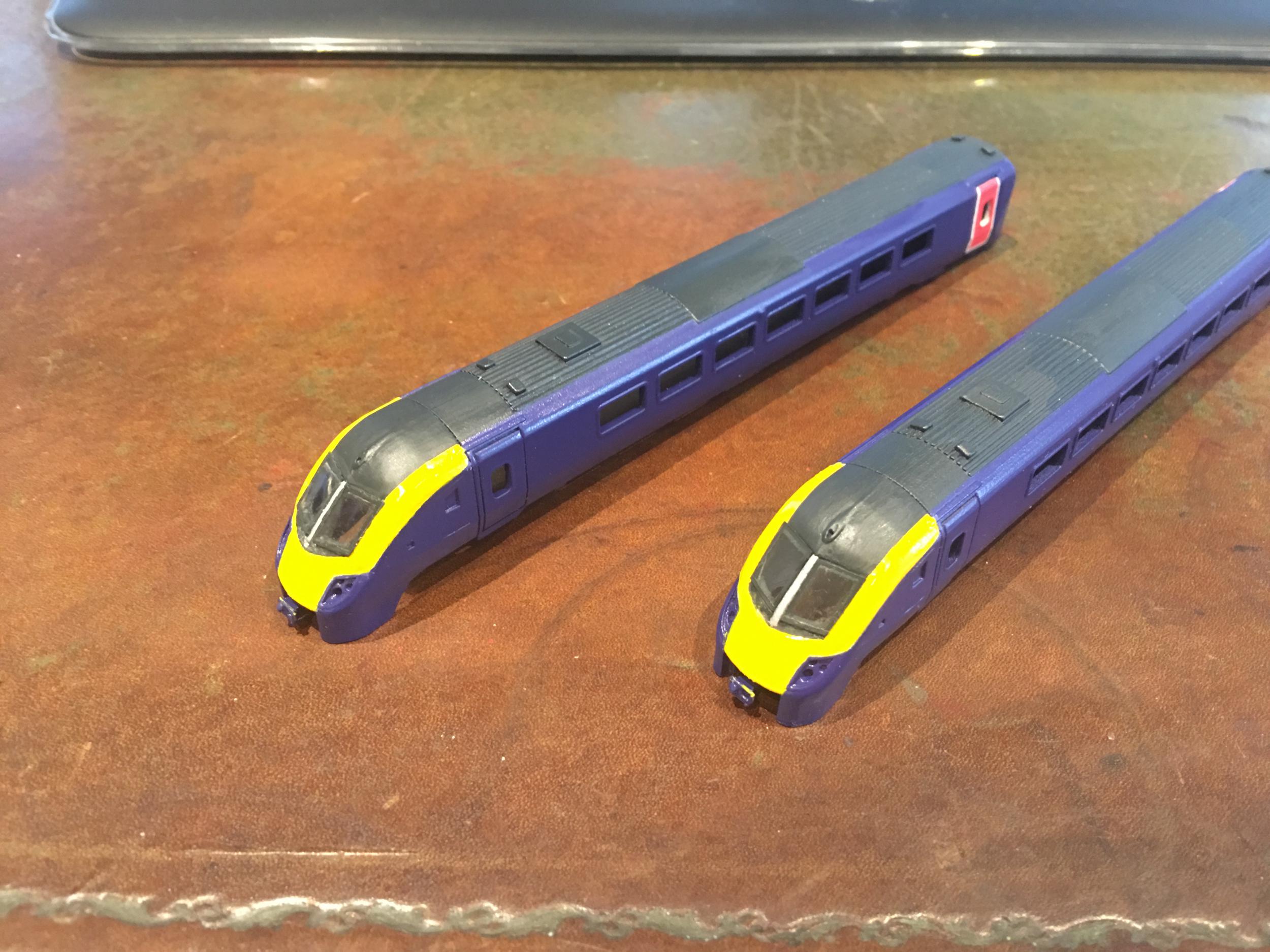

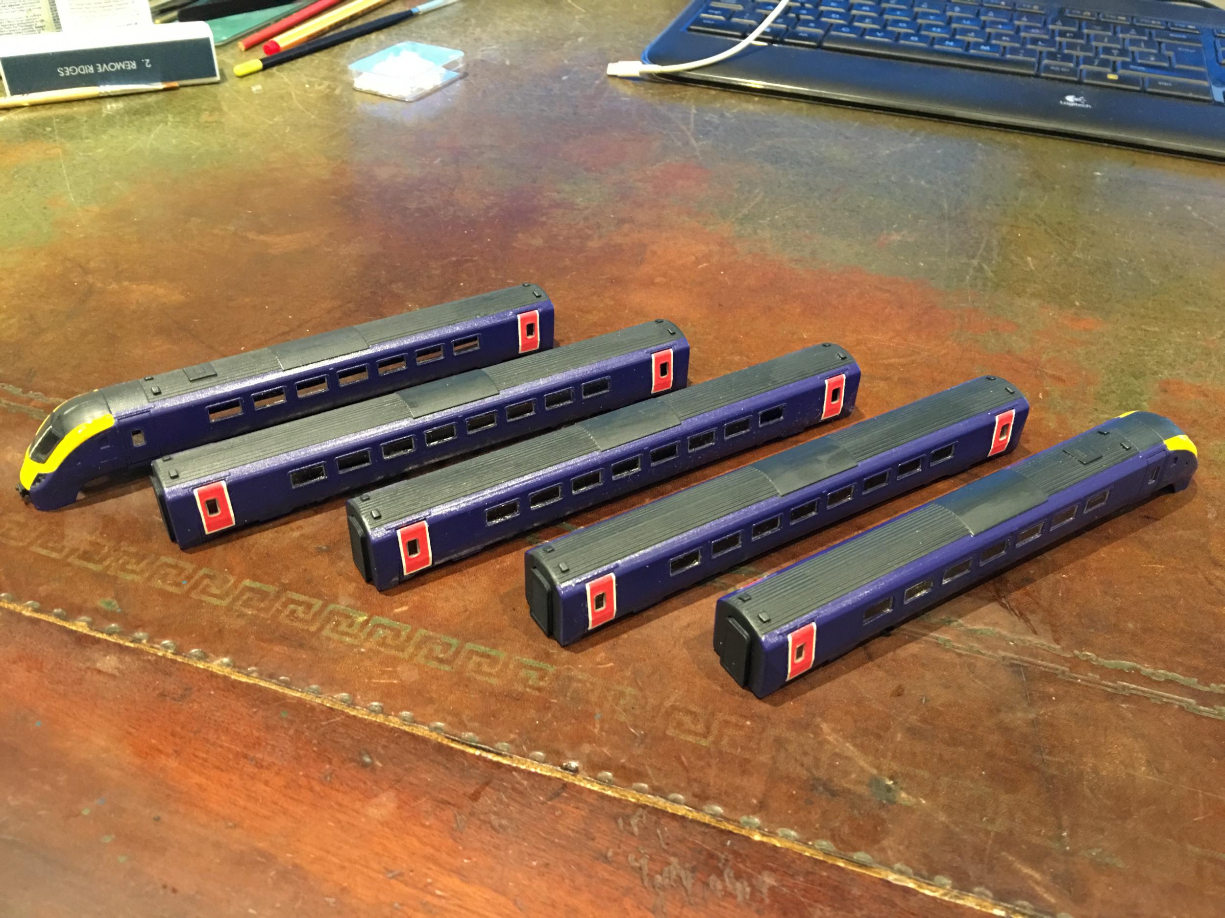

96 windows later, they are all in.  I now need to let the glue cure.  I ended up using the canopy glue "Glue 'n' Glaze by Deluxe Materials.
The advantage of this glue is that on the acrylic windows any smudges, when dry, can be removed with a sharp cocktail stick.
A few more areas to paint and I will be ready for transfers, which are being printed next week.
