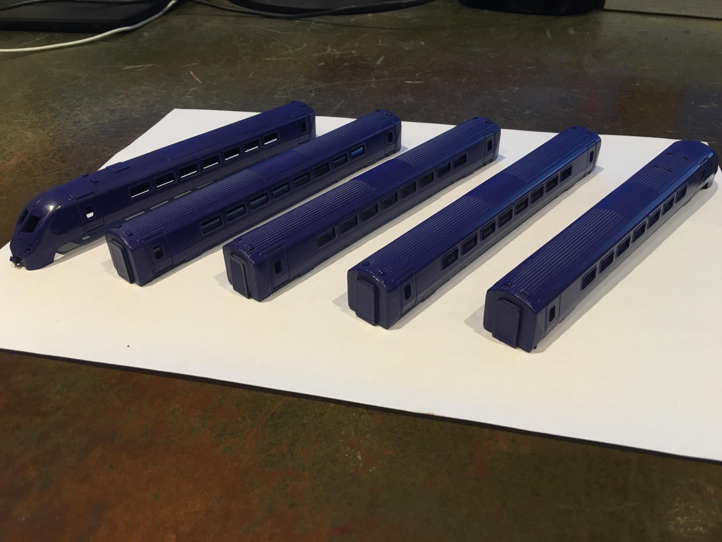

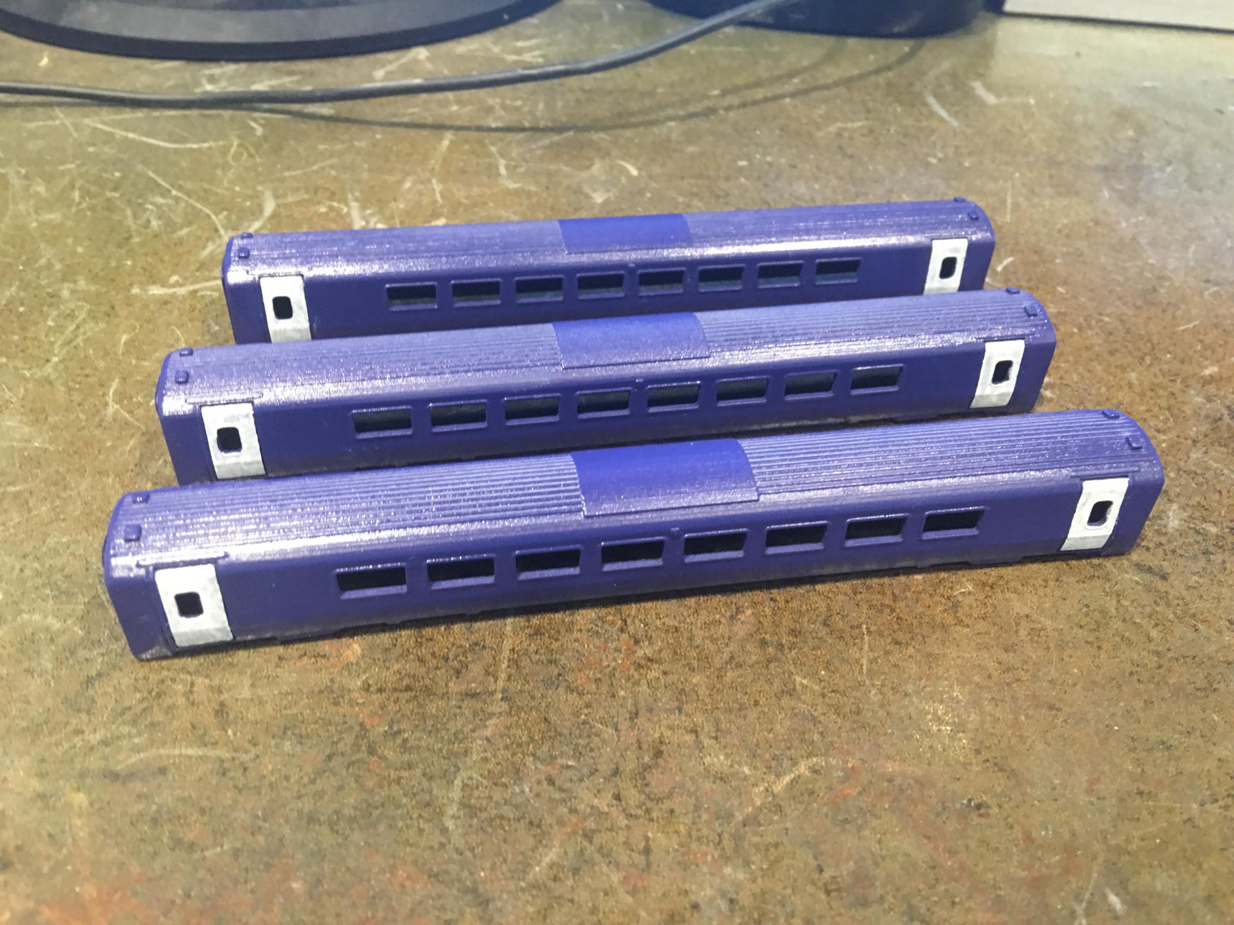

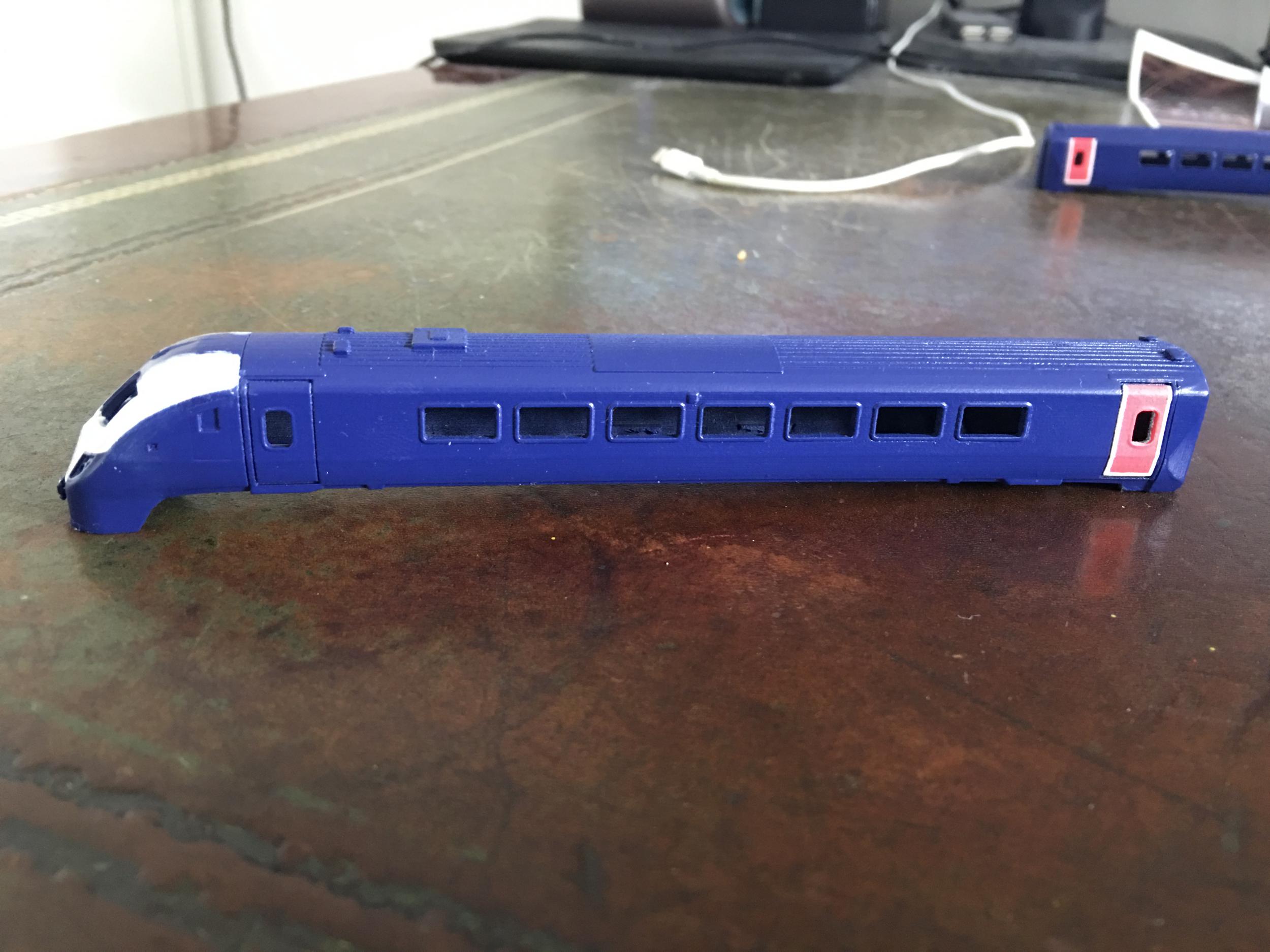

After a lot of burnishing with a fiberglass pen and more than a few layers of primer the top coat has a nice shine.
These now need the paint to cure and that can take several weeks, before any further paint is applied.

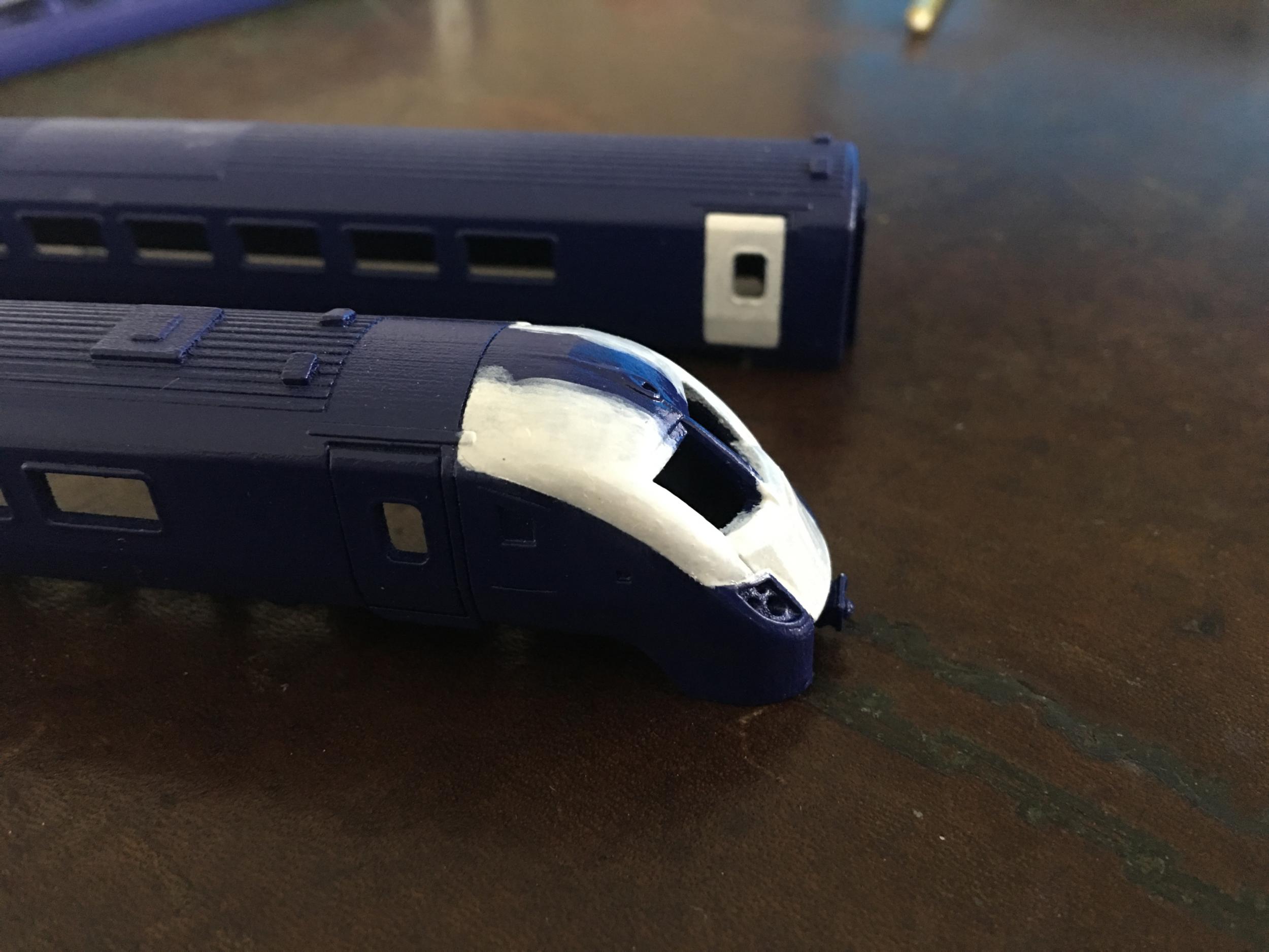

I will need to mask the end panels and paint them white then yellow.  I could have done this before the blue was applied, however the sprayed blue paint surface gives a better under surface for the yellow panels.

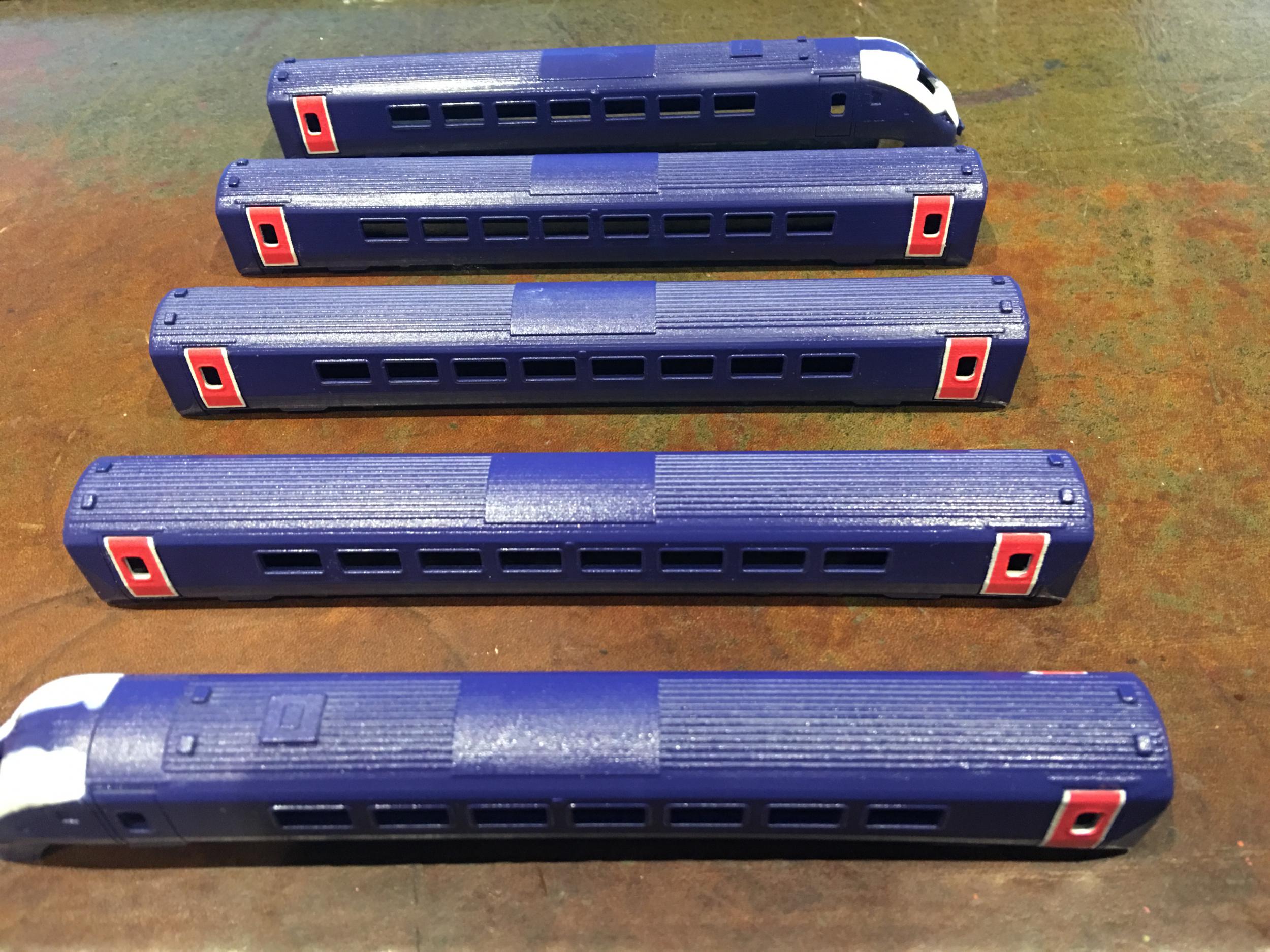

Snowwolflair

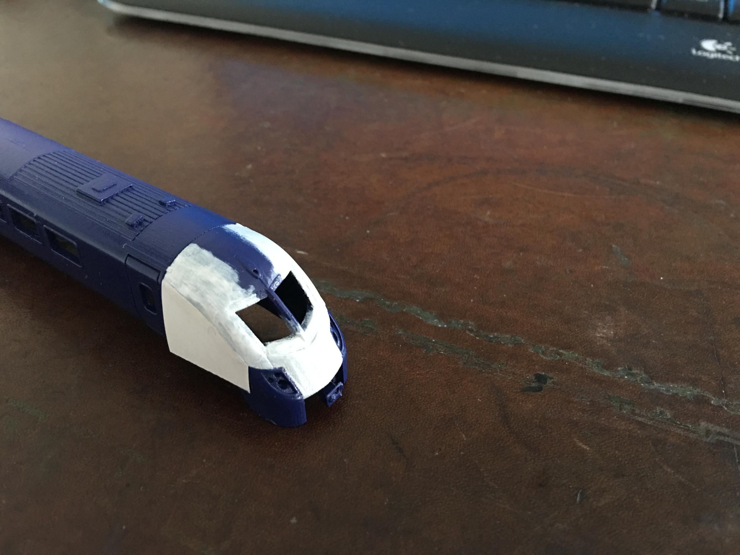

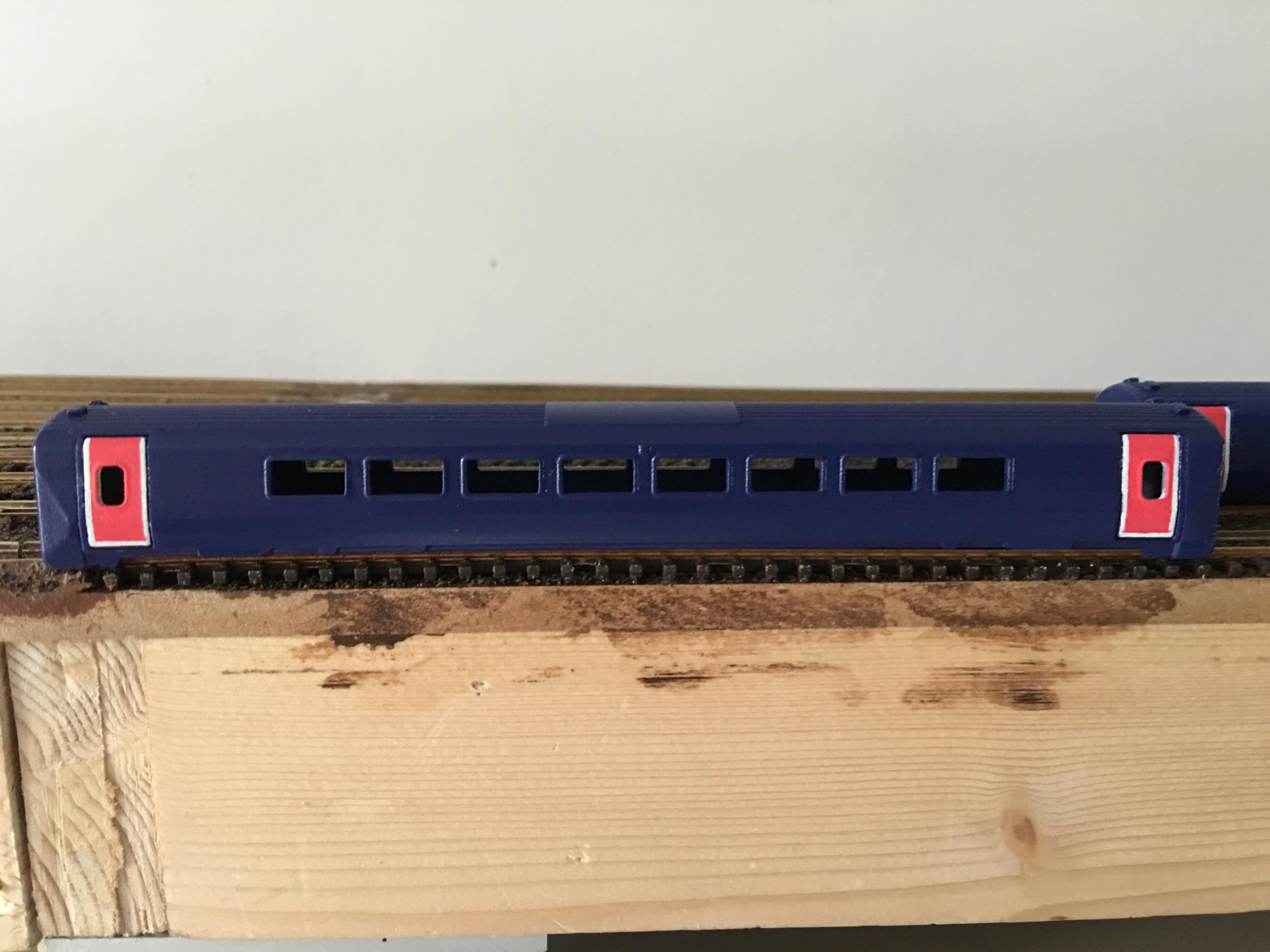

This next stage just takes time a patience.  I'm blocking in white where I will need to paint bright colors, Yellow and Barbie Pink.
There is still a bit of tidying up to do which I do with a cocktail stick dipped in Polycell brush cleaner.  Again this paint will need to cure before the next stage as I will need to use masking tape and I cannot risk the tape damaging the paint below it.

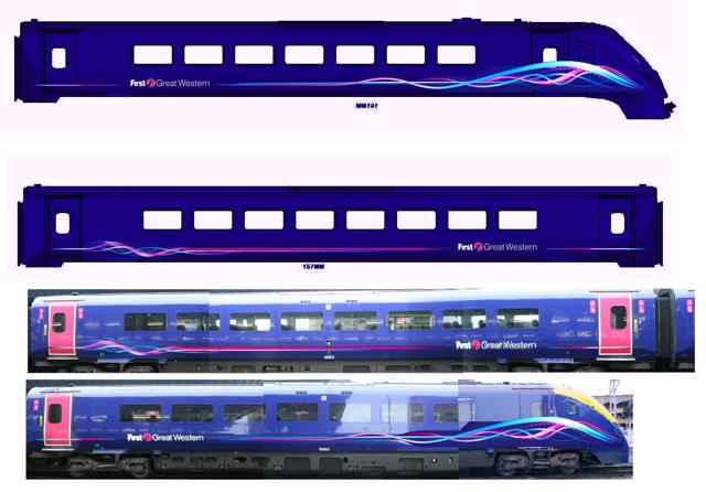

One advantage of having the side CAD profile is I have been able to cut a very accurate curve template.

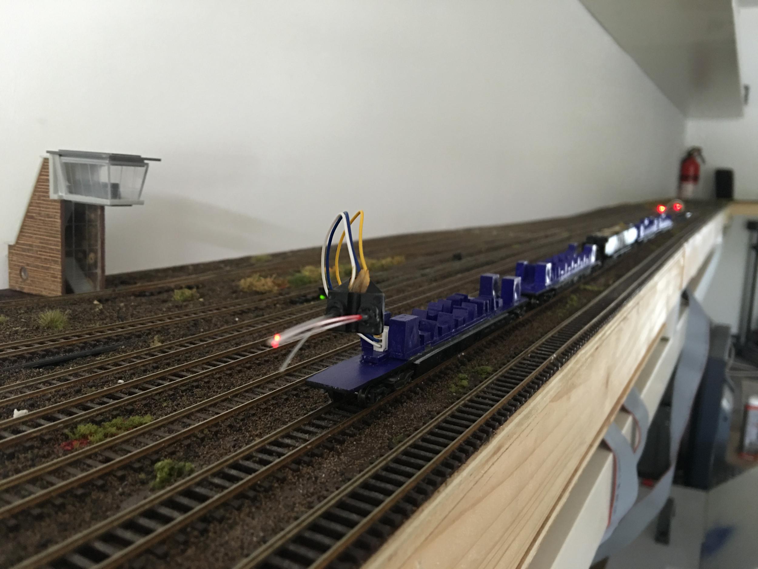

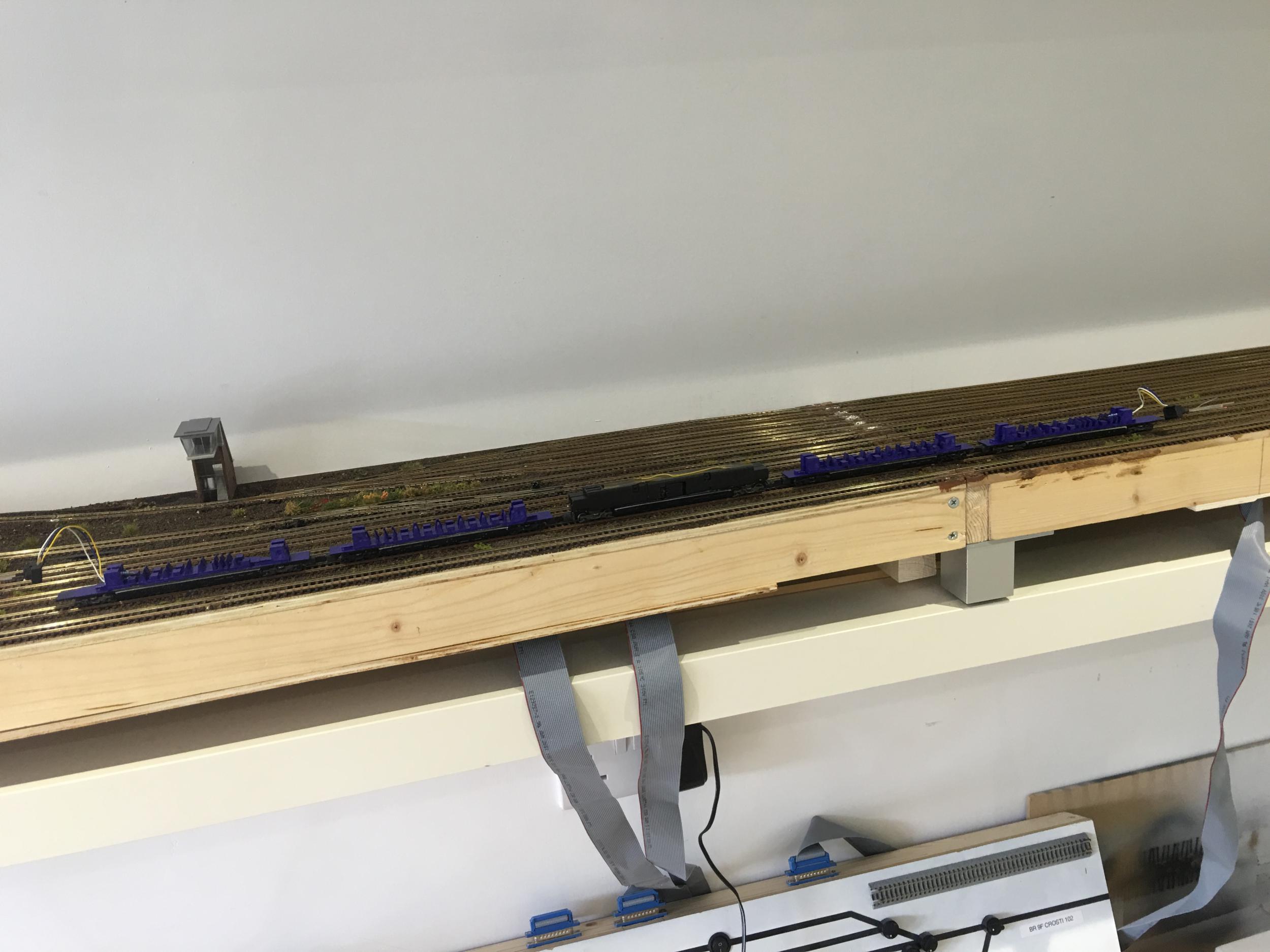

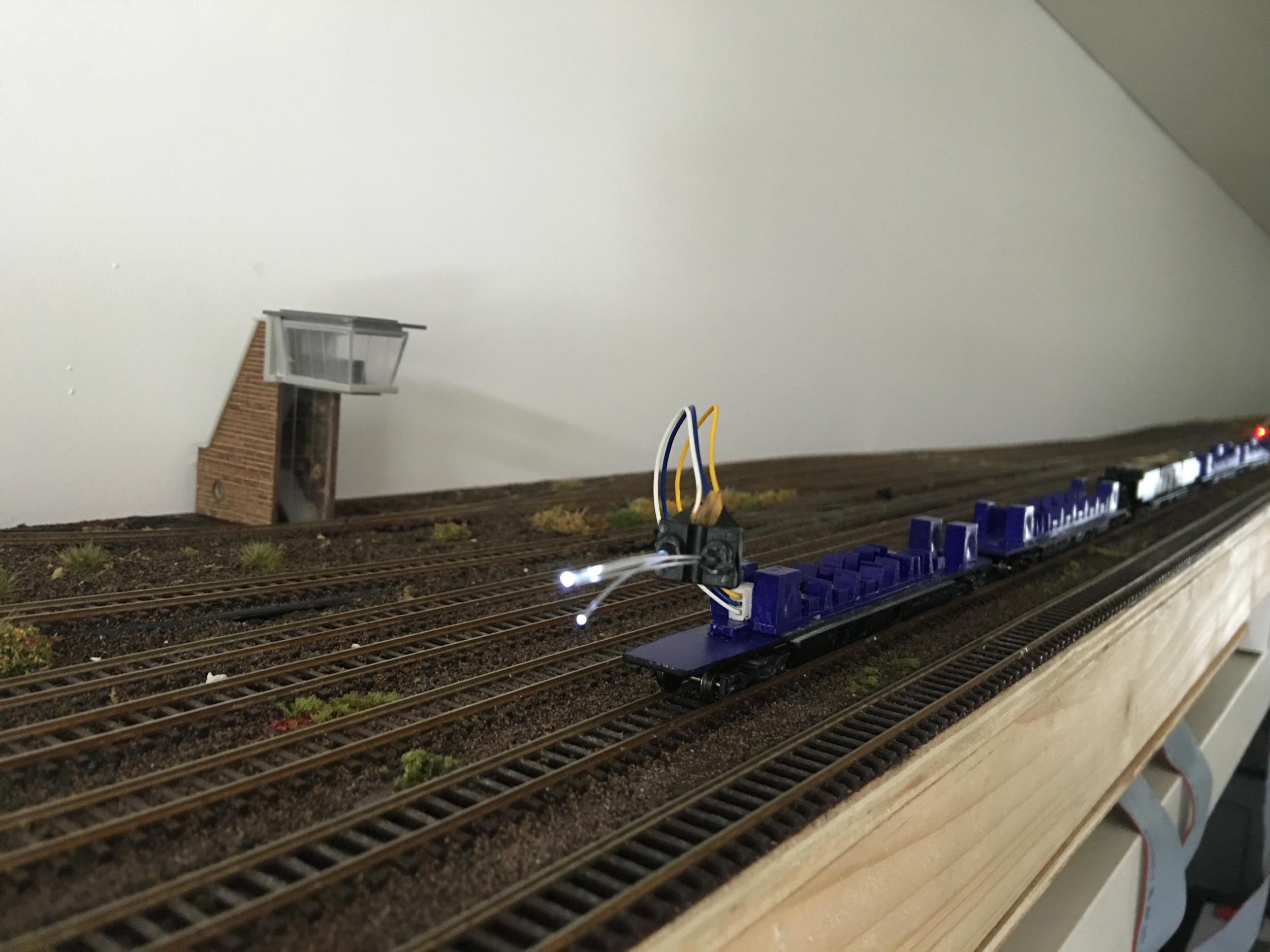

Plugs arrived today from China  :)  so I have wired in the Dapol Voyager light clusters.
A bit of paint to hide the resistors and some detail painting and the Chassis is complete.

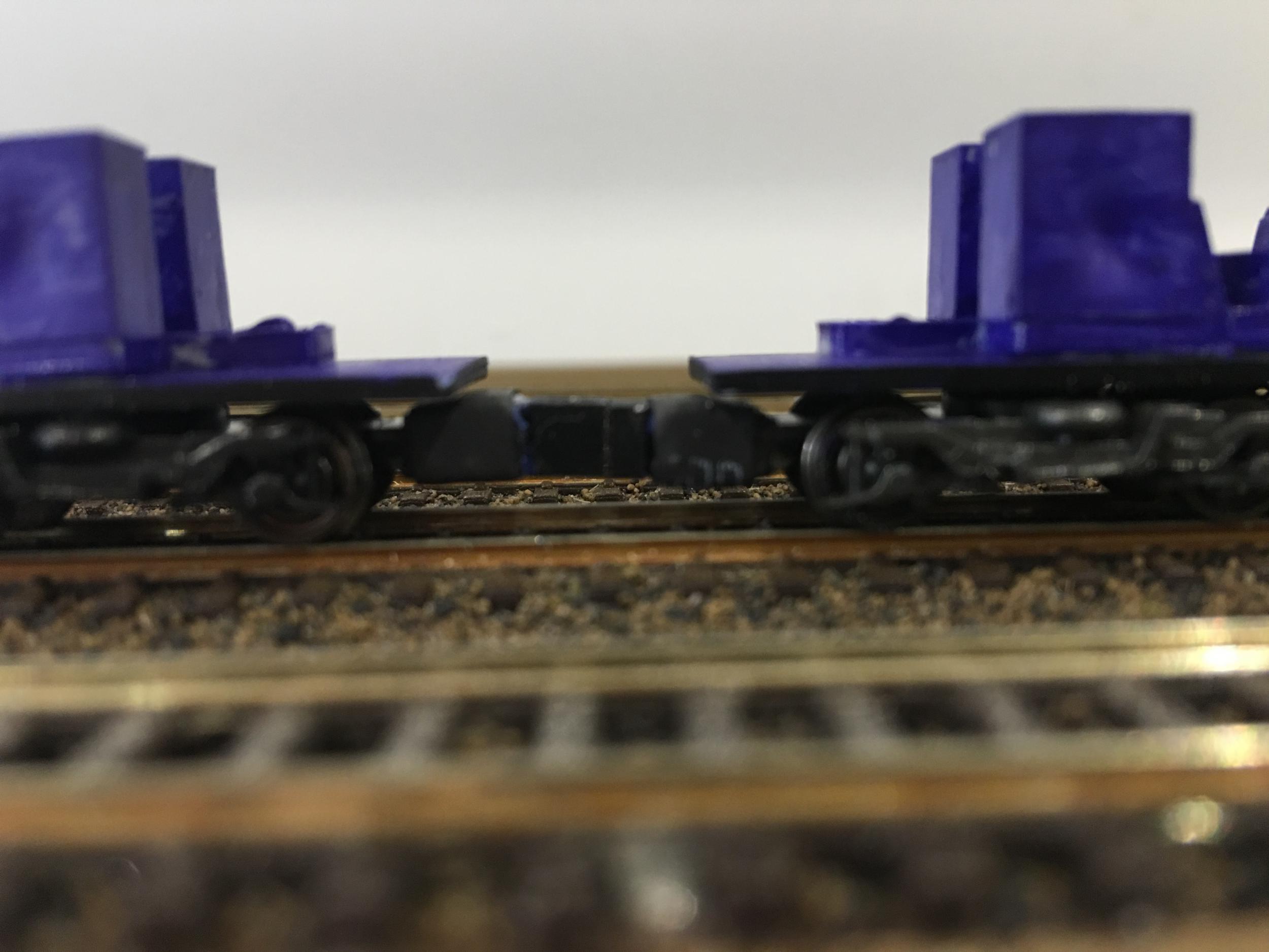

A quick update on the electrical couplings.  Once the silicone is firm I have wrapped the assembly in a heat shrink tube.  this makes it very robust and stable.

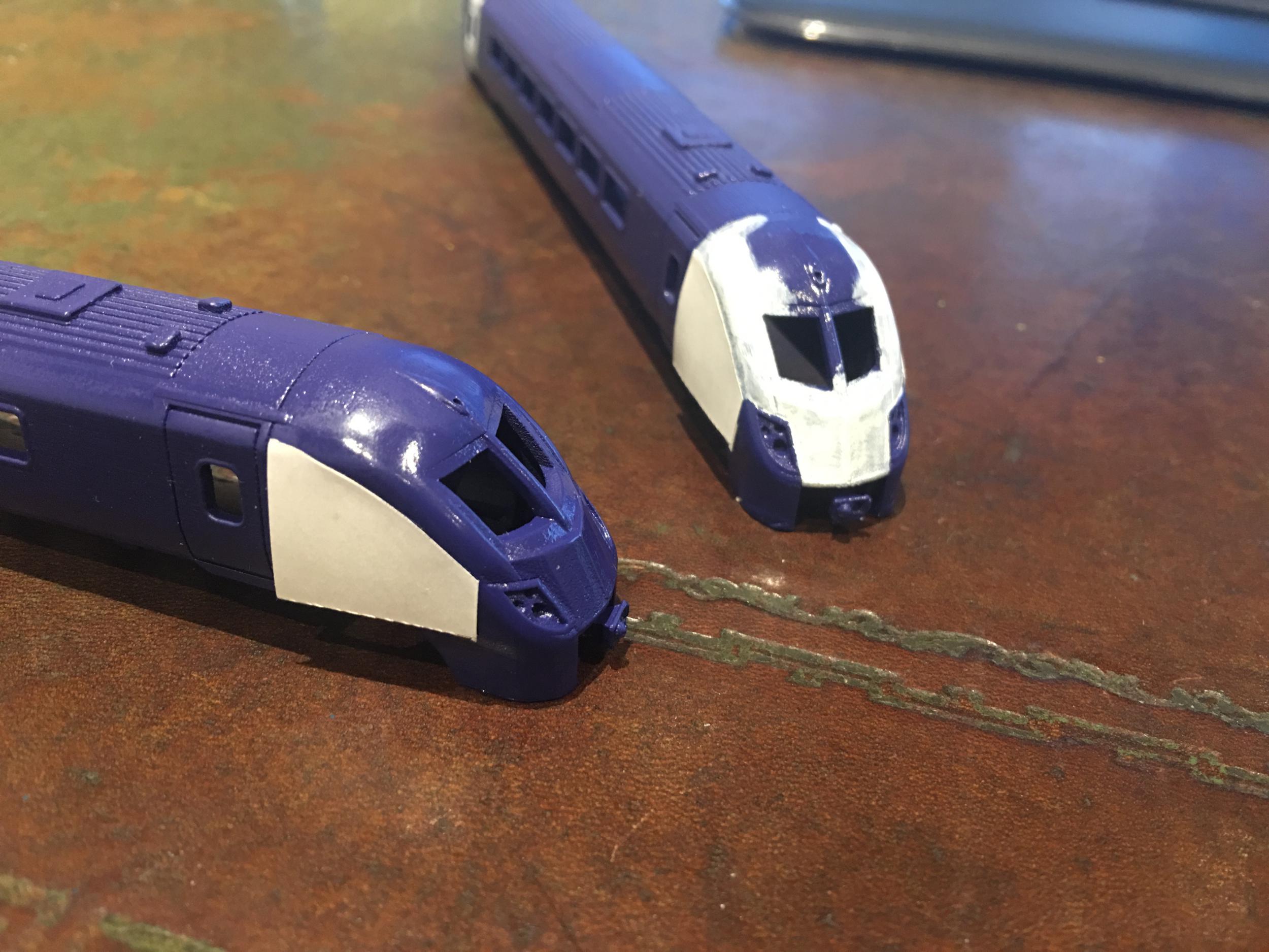

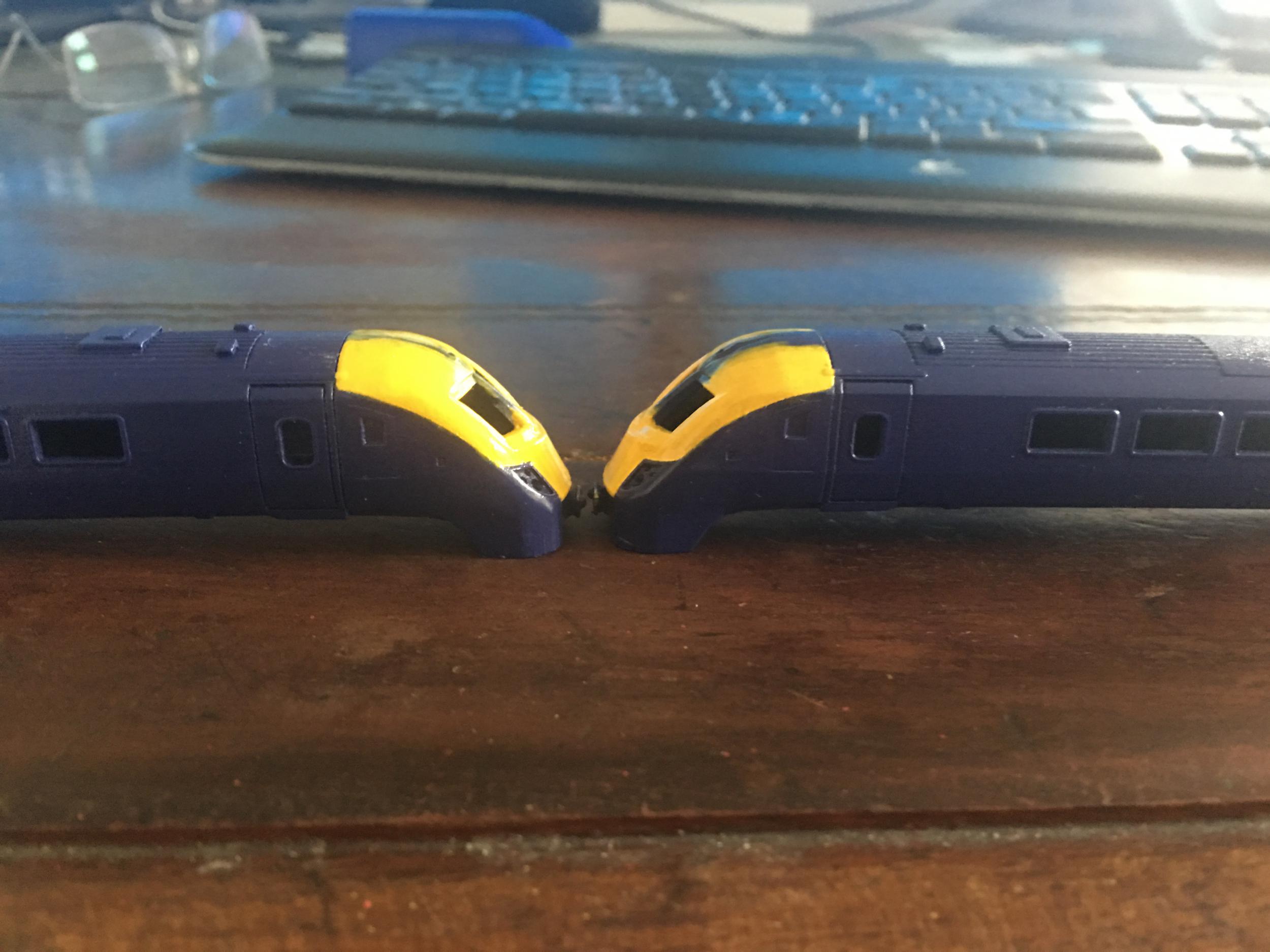

A few more steps.
Its amazing how many thin coats it takes to get a solid yellow.
The yellow area is oversize as there is a common masking line over the yellow and blue and to attempt to pre-mask it and hope to get it straight would be almost impossible.
