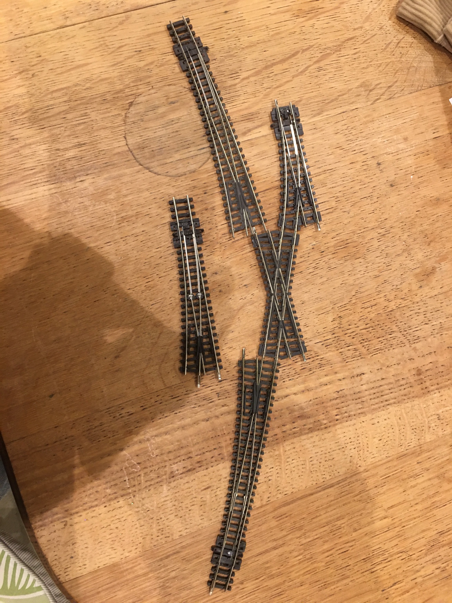

Been trying to work out the best points layout at the major crossing and concluded that I'd arranged 2 points and a crossing to form a single slip crossing! Thought I'd see about buying one but at RailsofSheffield they are £33.95 so going to use my "stock" of points.
Getting to old to remember all the variations on a theme of points, have used Y, short, medium, long and curved so far just got catch left to place!

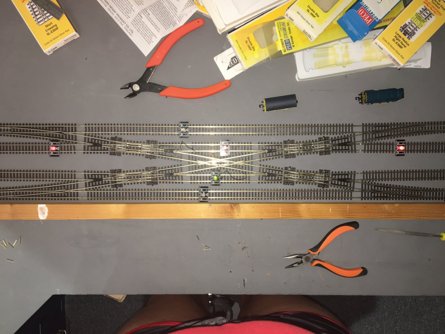

Still trying to decide on how I'm going to wire this lot

John, do you do loans too? There's a fortune in points and double slip crossings - will you actually use all the options for train movements I wonder.
I've reduced the prototype at Reedham by 2 points as I never saw the option of using them in prototype movements!
It also simplified the wiring as there's a branch working in alternate directions connected to the points.

Sorry, not at the moment, I could do with a loan myself right now. I've collected loads of points, slips etc over time so even with no income right now I didn't have to put my hand in my pocket  :thumbsup: Rails Hattons prices come to £205.50 for the bare slips, points and crossover (although they have none in stock anyway) so I do need to get this right first time.

The short answer is yes. The centre lines are the main up and down lines. The bottom is a reversible loop. The top is a reversible end to end. My fiddle yard  and TMD will feed the bottom track from both sides so I can run anything onto and off the 4 lines from either direction and means I don't need crossovers anywhere else.

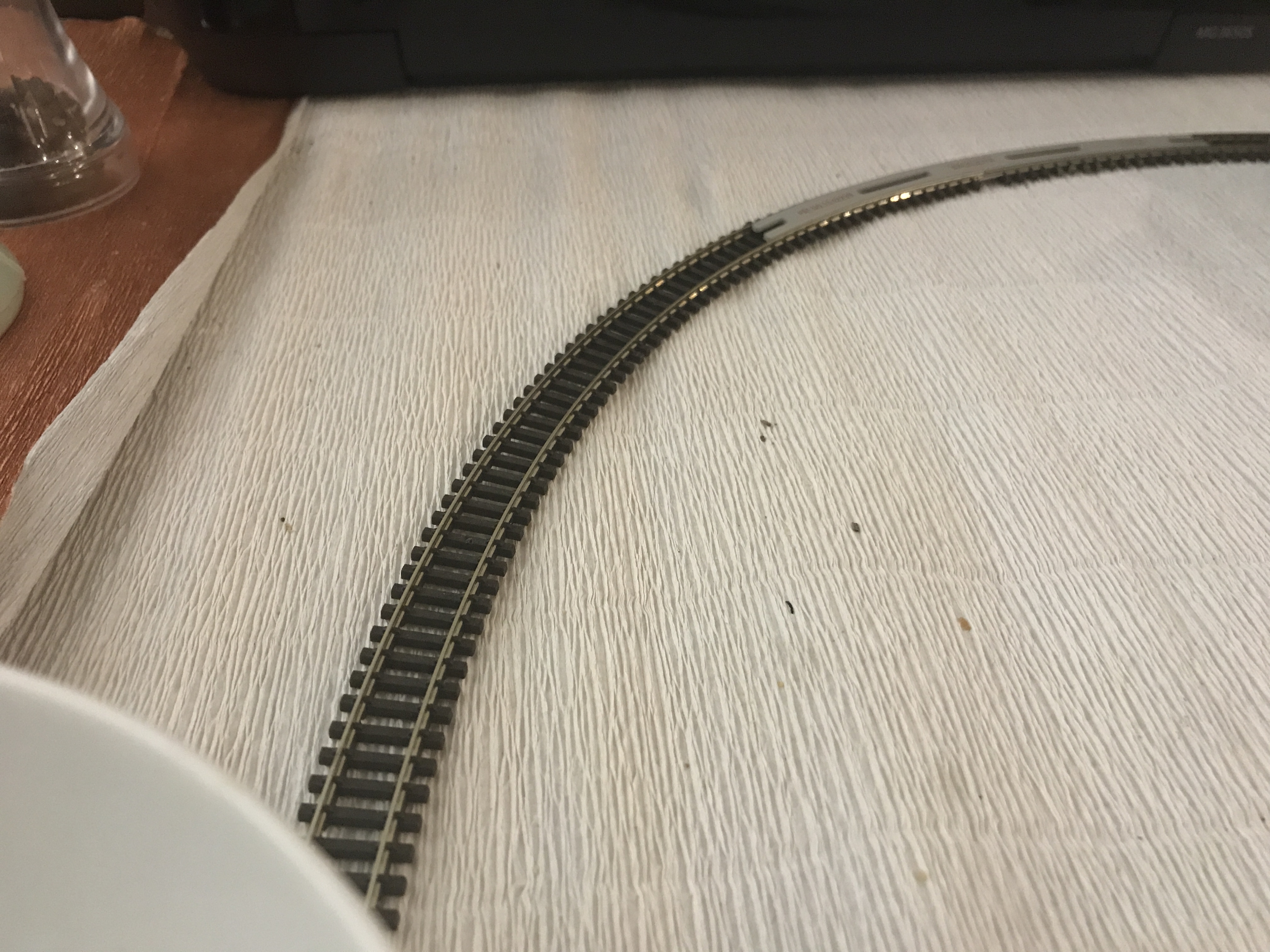

Been reading ll sorts of information about transition curves to help avoid that "whip" you see as model trains enter or leave a curve onto/off a straight section. There's some whiz calculations and and all sorts of ideas about using increasing sizes of Tracksetta etc etc etc.
I thought about this and decided that having marked on the baseboard the restricted line of the 'bend' it made sense that half way round the radius would be smallest.  So i put the 9" Tracksetta in the centre of the length of  flexi track and then bent the free ends to meet the adjoining tracks. Pin the centre point several places before removing the Tracksetta or it will flex to a regular radius when you lift out the guide!!!
Here's the principle showing the transition shape with a 9" radius Tracksetta at the centre

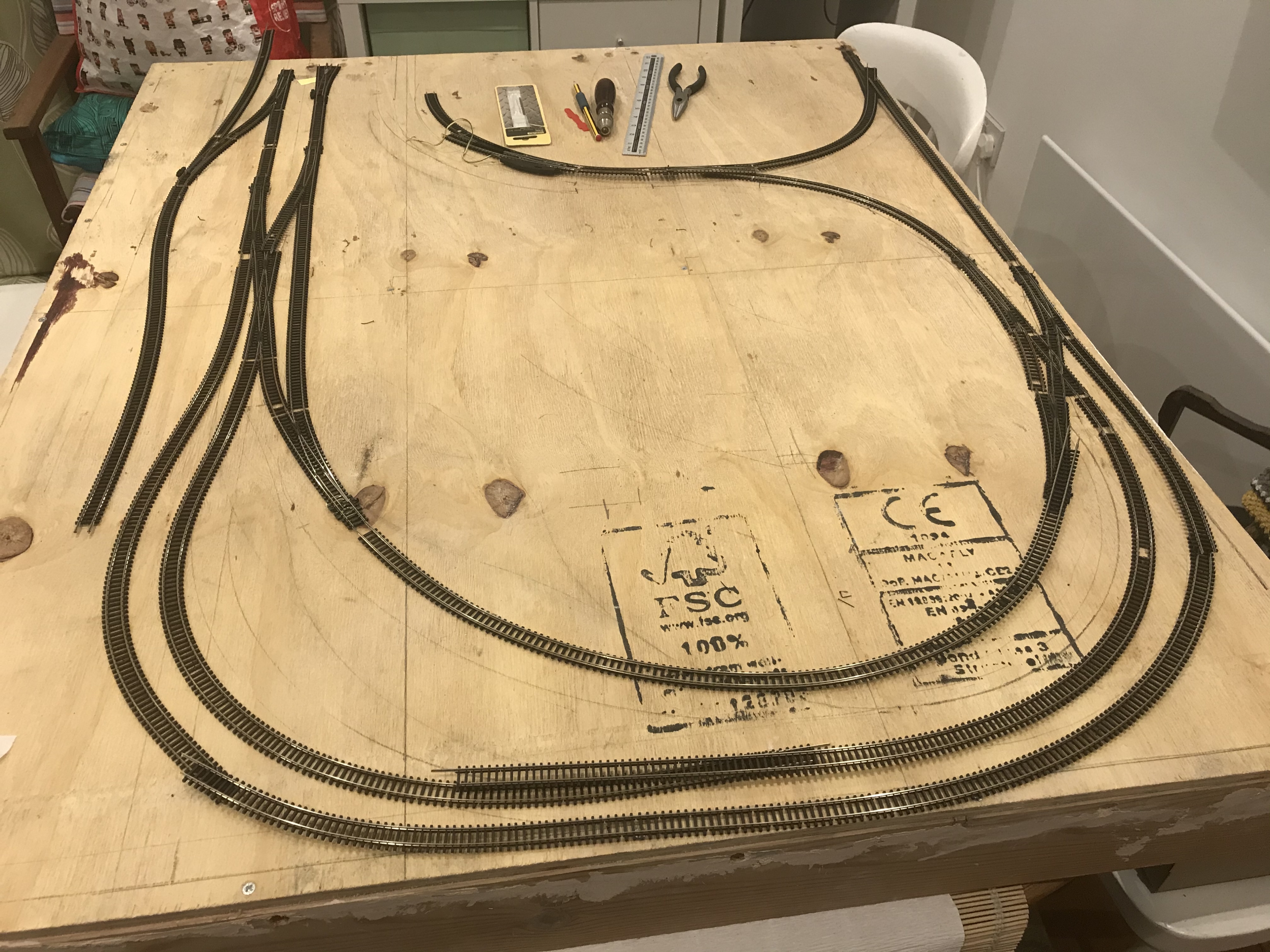

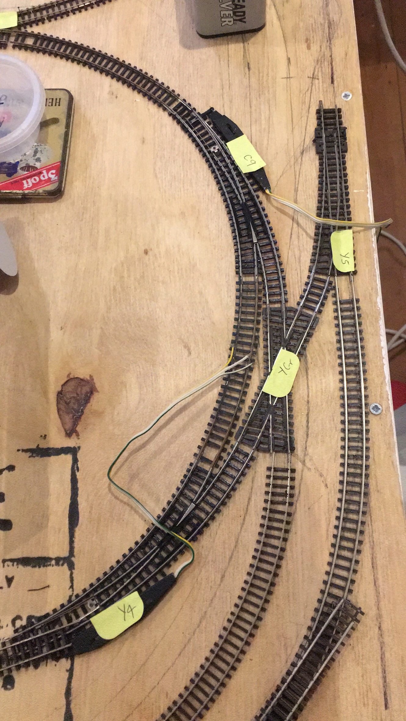

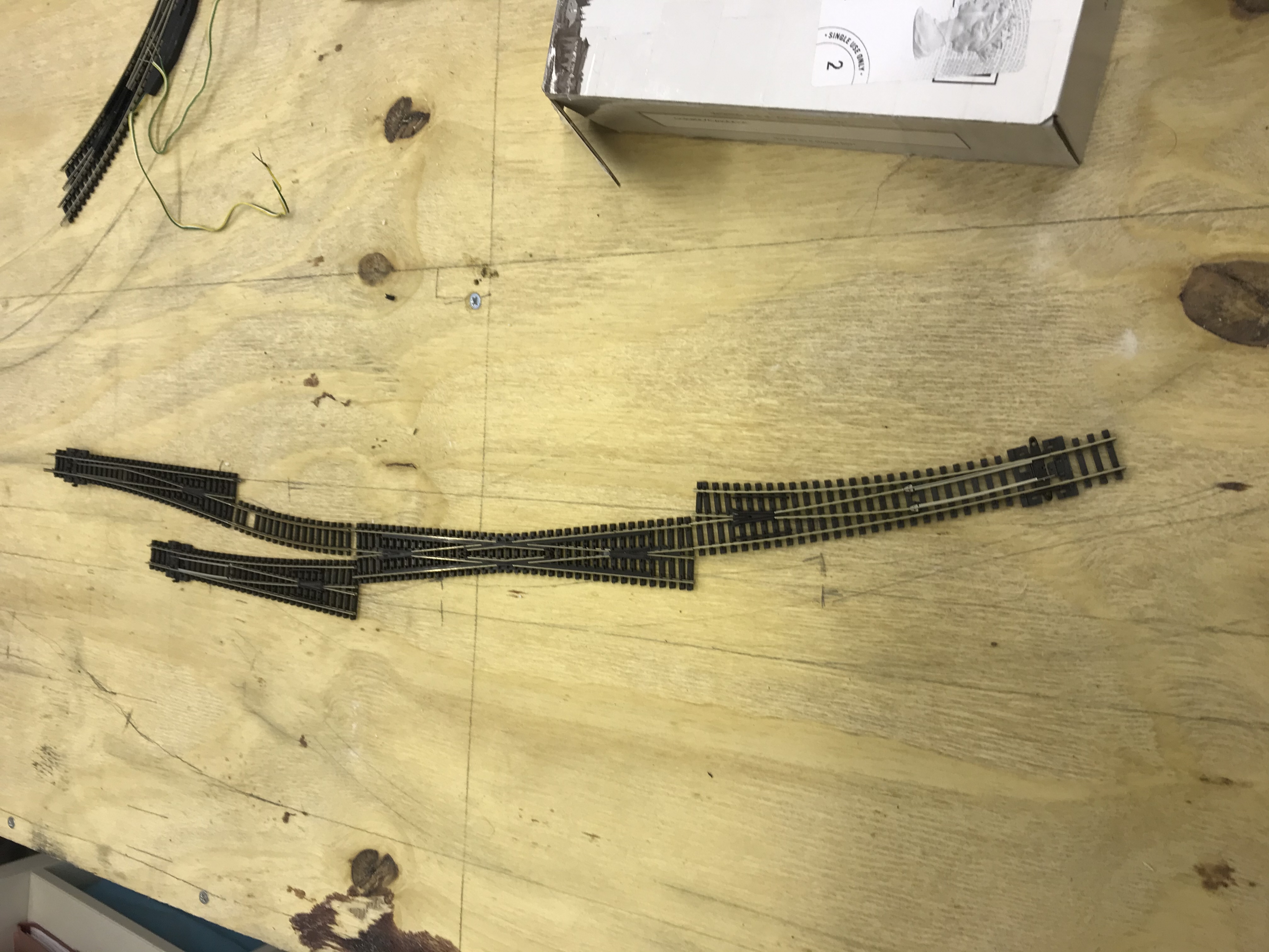

I've also been trying to reduce the curves in part of the layout prior to finally fixing the track. The single slip has now been reconfigured using 2 Minitrix curved points so its a curved" version
The East board has been laid out in a trial version using SH track to check radii, clearances and scenic spaces.

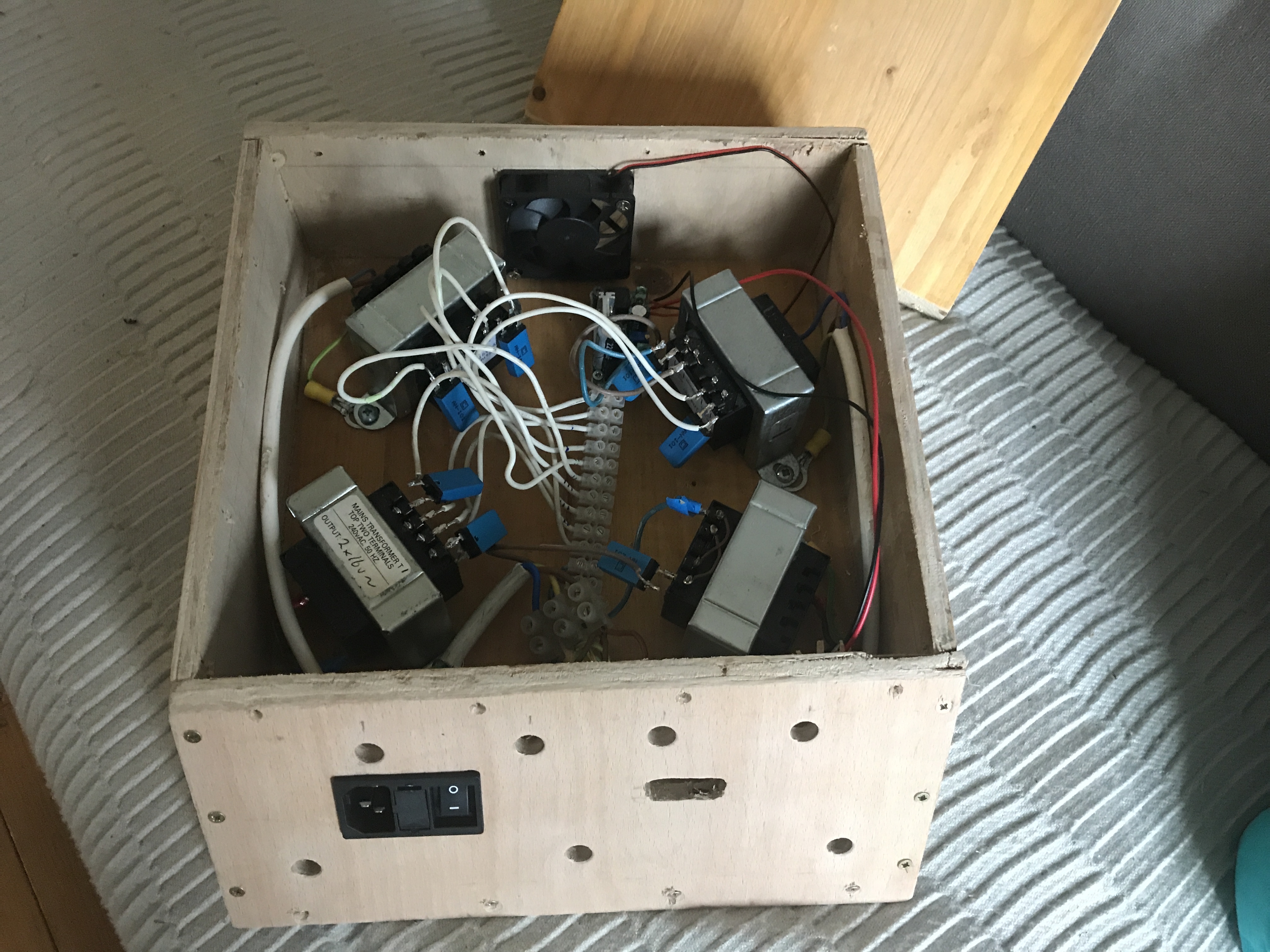

The power pack has been test assembled and all the connections tested with the multimeter. There are 4 transformers giving 5 18vac 1amp supplies for 3 controllers Station Stop and HF cleaner, 1 18vc @ 2.5amp for the CDU and 1 18vac into the converter module for a variable DC supply (probably 10.5v) for LEDs and signal lamps. This will be enclosed in a fan ventilated box with a switched fused inlet and a D-Sub 15 way socket outlet. - box is drying th pVA joints!

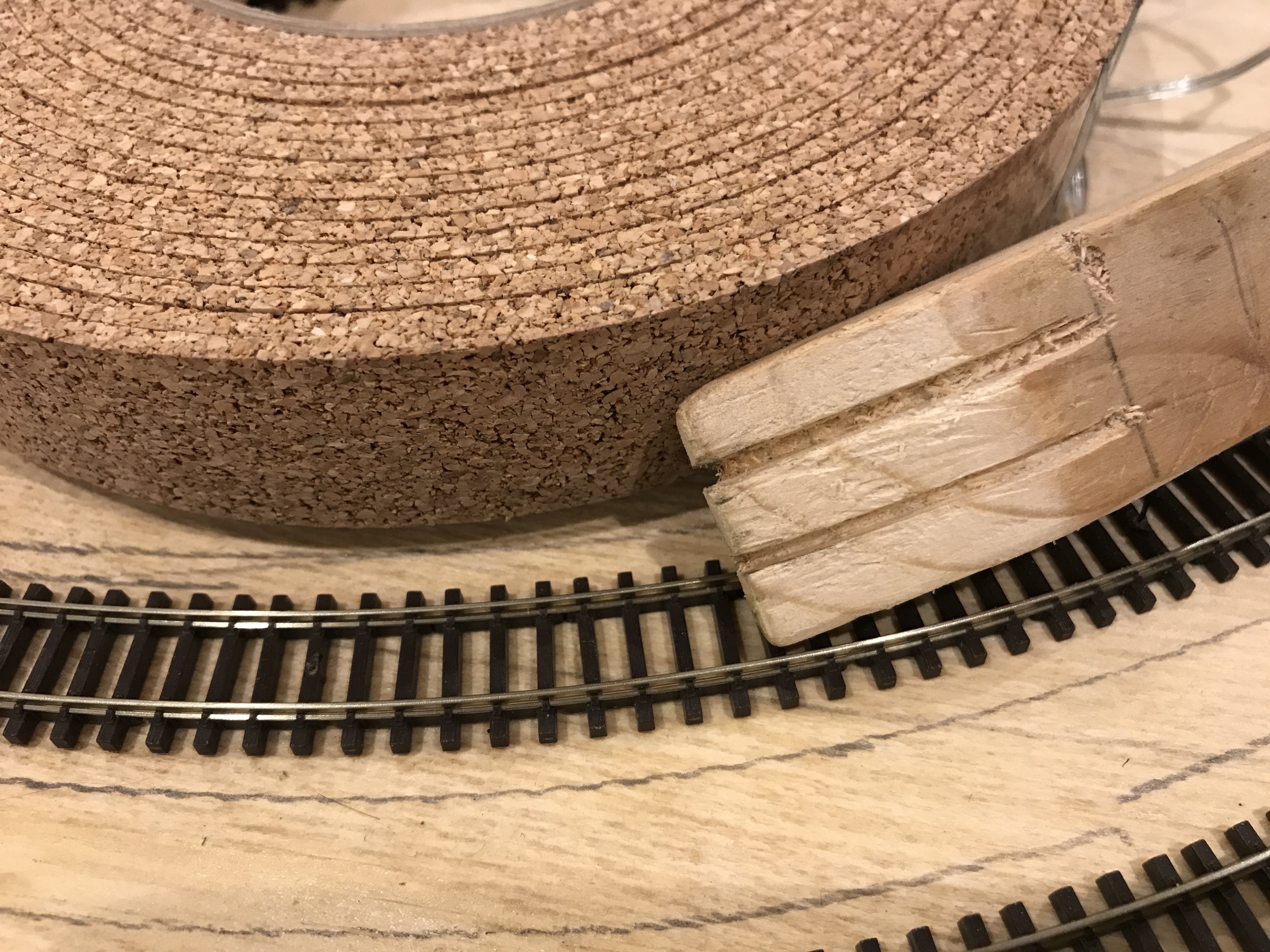

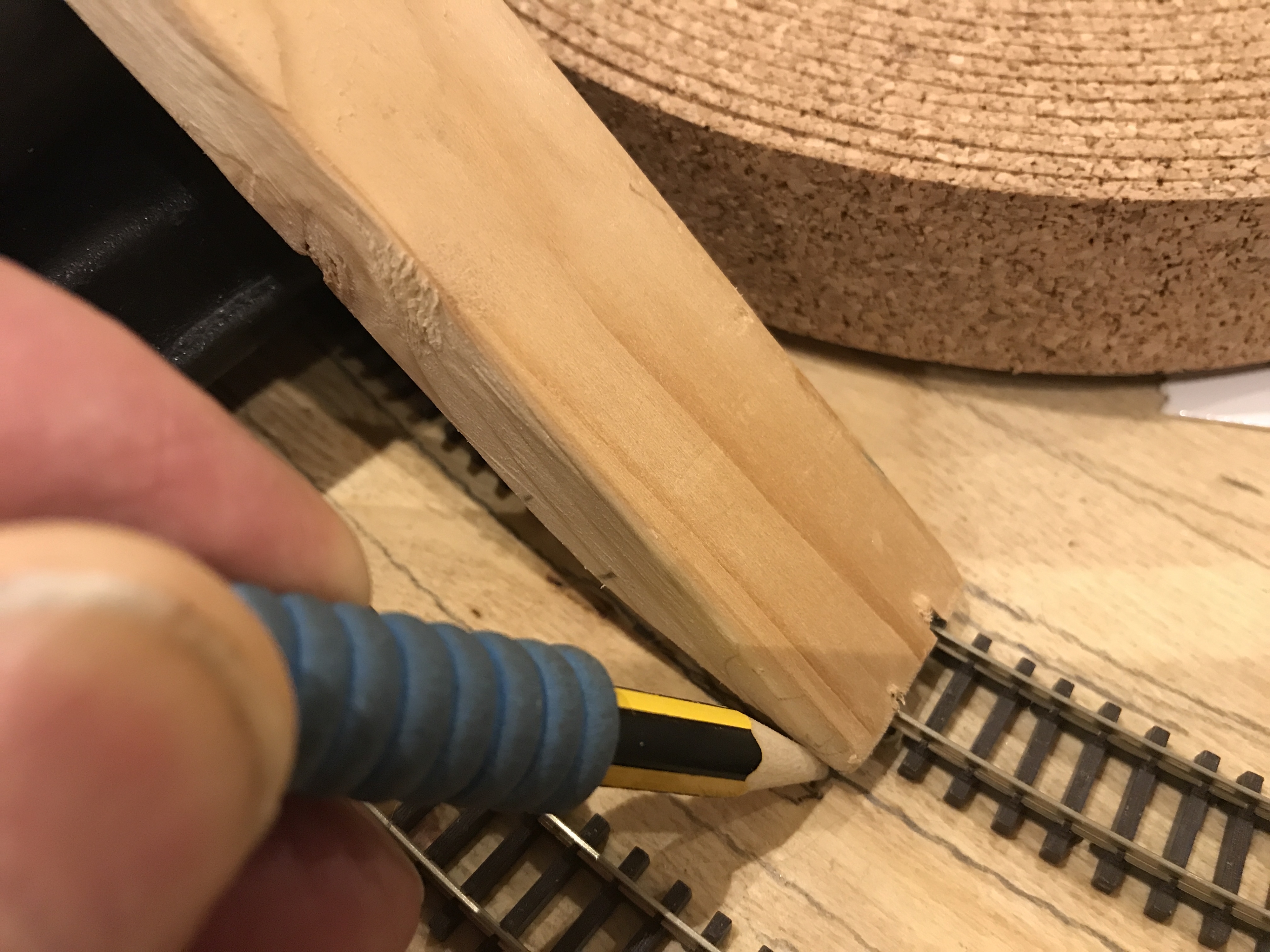

Have LOs thought about marking the board for trial track to be removed and cork strip applied. Made a width-it stick, 25mm wide to match the cork and with 2 grooves to fit the track - pencil pen or marker runs alongside
HF cleaner? Do you consider that really necessary? Few folks use them nowadays.
Greygreaser
Not sure about the HF cleaner but the workshop isn't the cleanest place and so it's switchable to any of the 3 controllers. In time I might abandon it simply by not switching it into the wiring circuit.

I wouldn't have an HF "Cleaner" anywhere near my locos.
They don't clean the track and can fry the components in modern loco's.

Ive seen reports that HF cleaners and DCC don't mix but I'm into DCand many of the items I bought back in the '80s and never got round to building a layout.
Recent purchases have also been 'ancient' DC locos and the layout is being built with 'signal box' control very much in mind as its on the cusp of steam and diesel!
its all a bit 'tonge in cheek' and meant to have a streak of humour in the finished diaorama but to be enjoyable for any enthusiast to operate.
Currently finishing the power box which has 4 transformers AC/DC converter and ventilation fan, mains switched and fused inlet and D-sub 15 way socket for power circuits outbound. All soldered joints and earthing checked with multimeter prior to mains being connected.

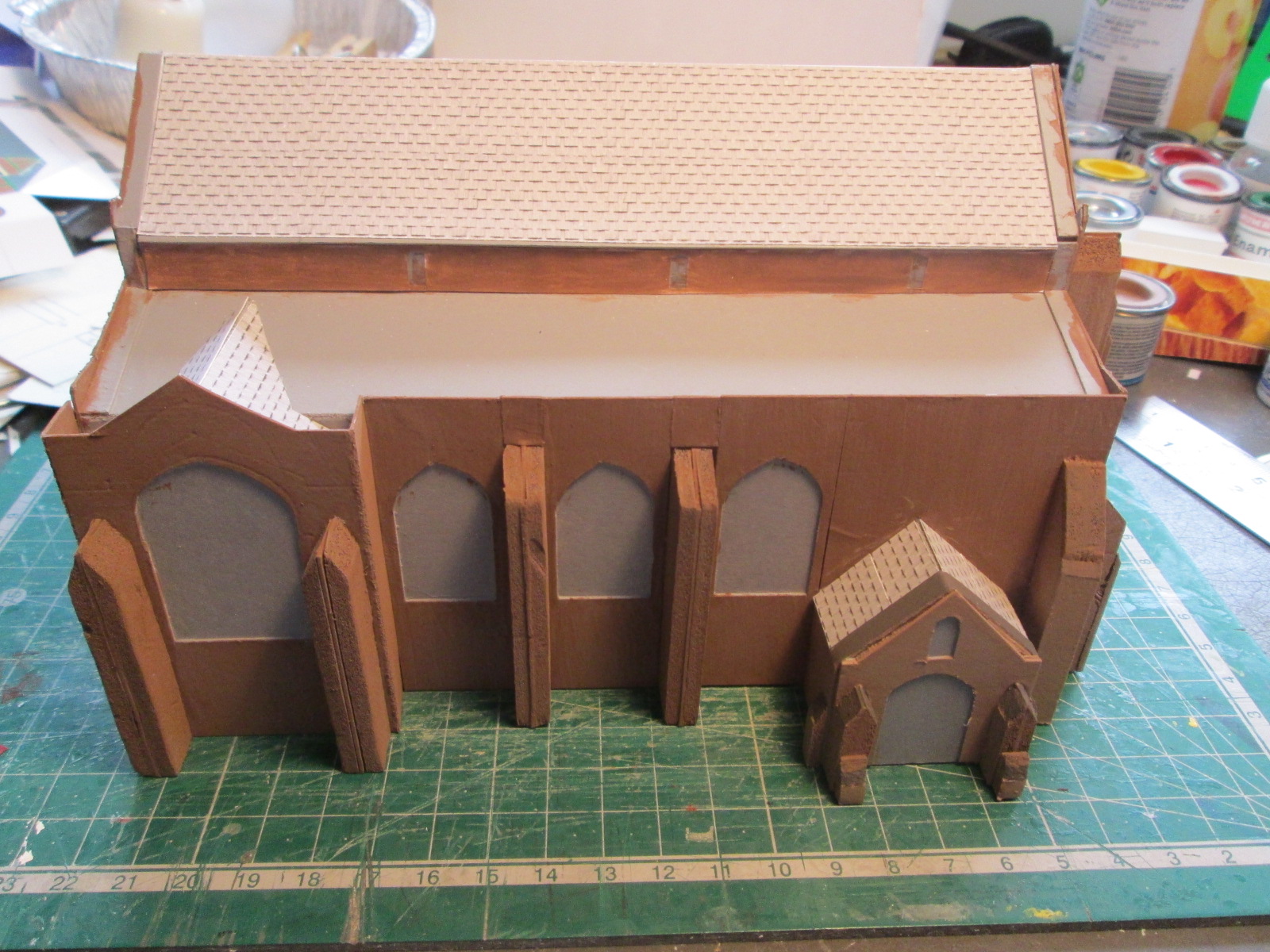

 Right now? This week's project has been going on for about a month...
St Pauls Chuirch, Walsall: so far so good...
Constructed with cereal packets, polystyrene & pva. And much bigger than any available kits!
