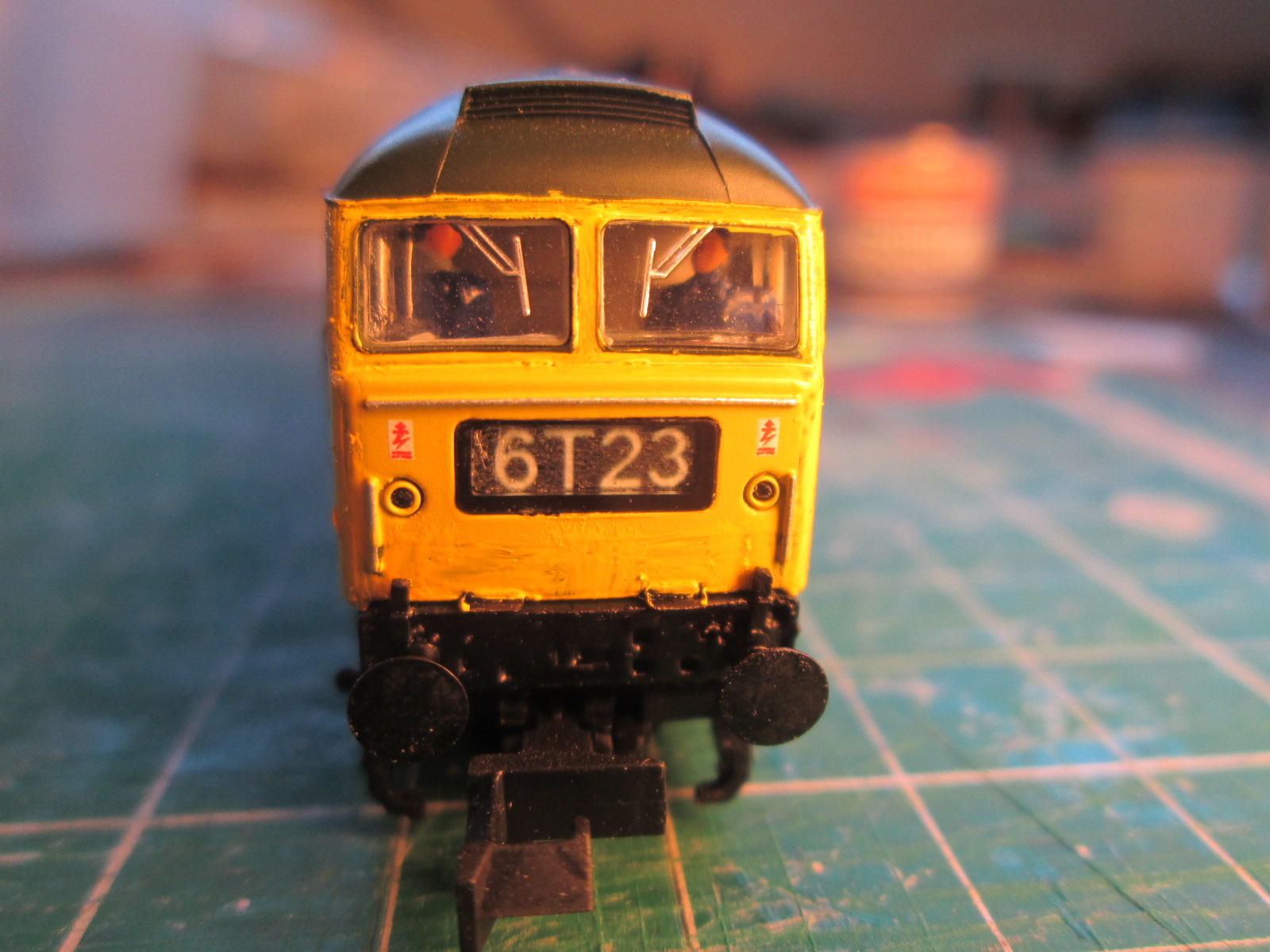

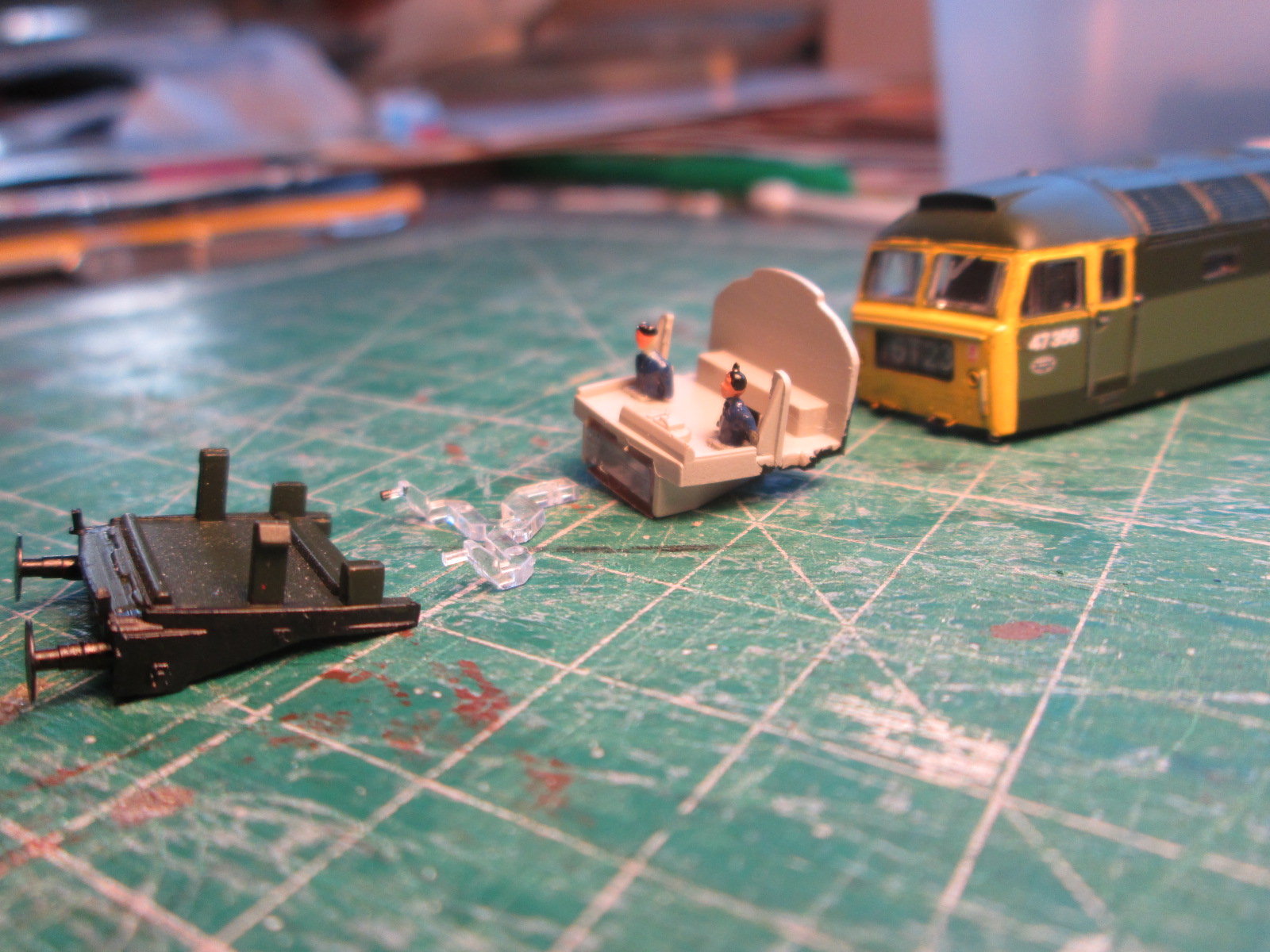

Another day another diesel to do... this is Farish 371-825C (D1779 in green) after I'd prised out the scuttle/bufferbeam, light guide (carefully!), then the cab moulding. I've fitted 'crew' but for reference these a tiny bit too high up - hardly noticeable when finished, though - see picture. I was hoping to remove the cab glazing before painting the yellow, but I couldn't pursuade the windows to move. Painting full yellow ends was a bit tricky - I'm not 100% happy with this, but it looks okay from normal viewing distances.
47356 is numbered with Railtech transfers. '356 together with 365 and 366 all went around with TOPS numbers whilst still in green livery locally, hence this one for the layout.
Here's a picture showing the 'crew':
The headcode is a bit of photograph glued in position after (carefully) scraping away the painted headcode on the inside. It hasn't got dark enough yet but I think the headcode will still illuminate. I painted one of the tail lights black, as it was very rare that a light diesel went around with 2 lit (in 1975, anyway).
Footnote: if you carry out this mod (or just remove the cab end mouldings by gently prising the cab sides apart) be very careful to clip everything back together precisely how it came out - otherwise the body will not go back on the chassis. All the lugs must be fully home in the holes. The one light guide was very fiddly - but that's what it's all about...
Happy modelling, everybody!

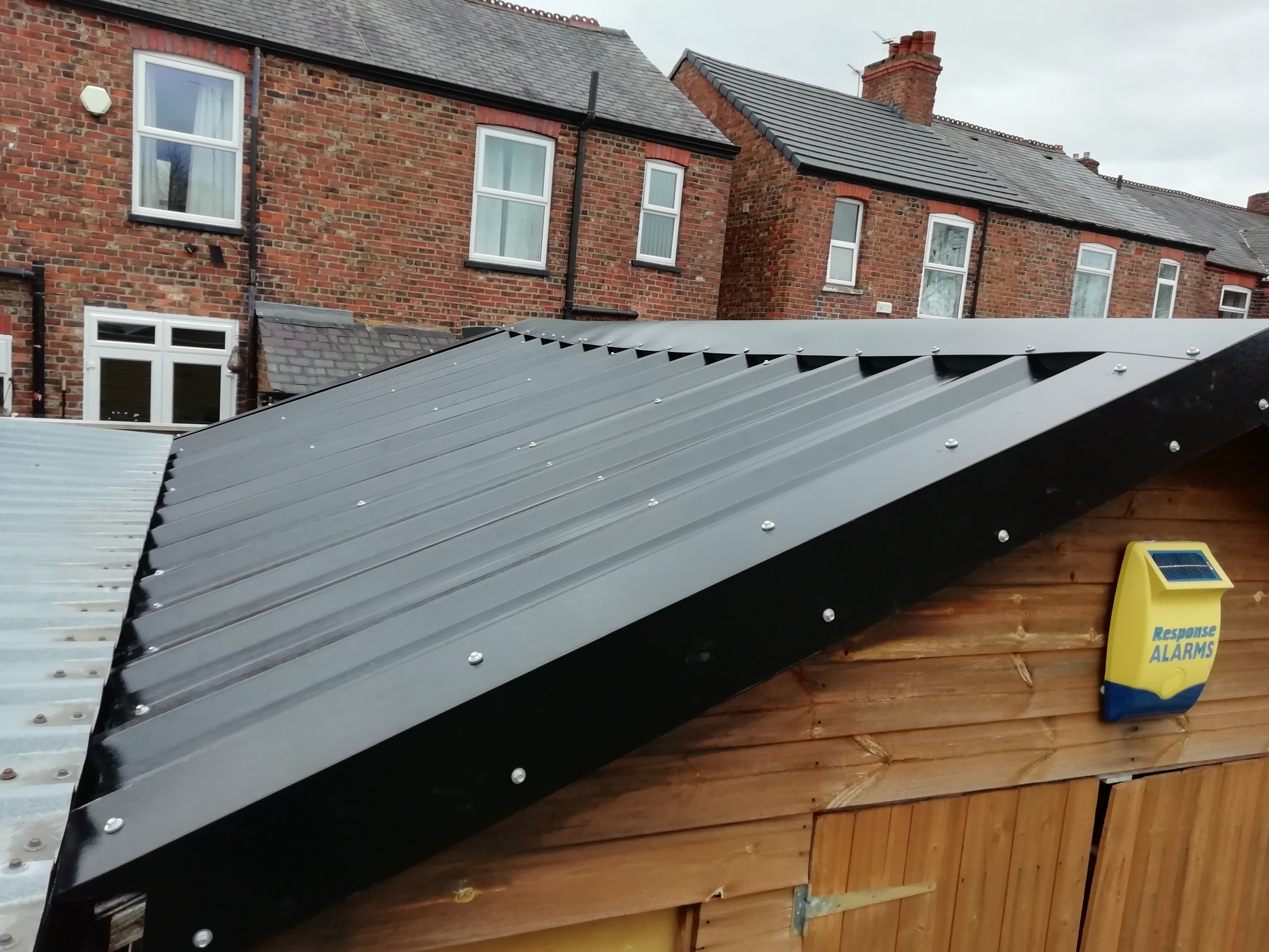

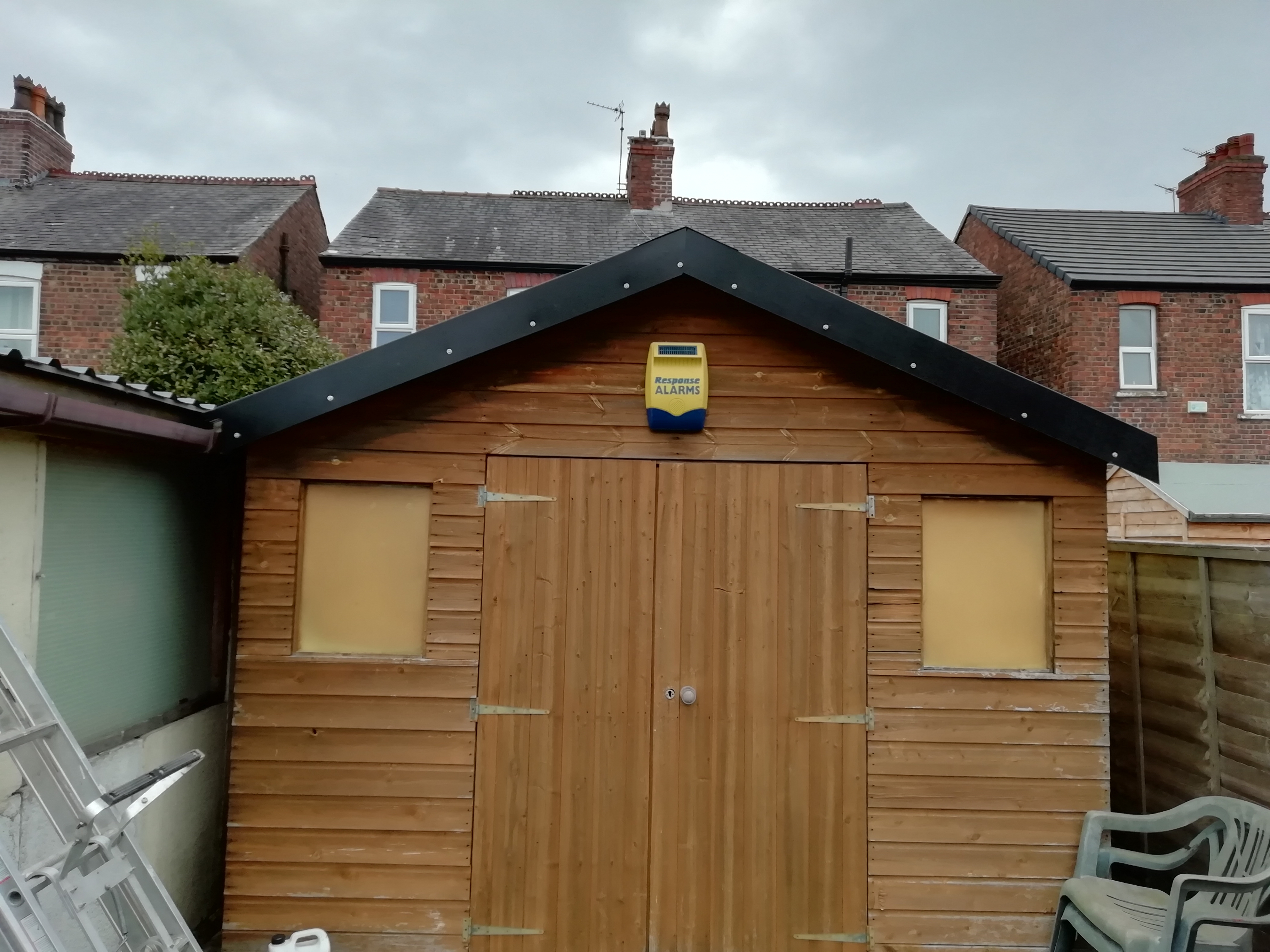

Finally finished the new railway shed roof (except for plastic covers for the screw heads), replacing the completely failed felt and the temporary plastic sheet patches.
The shed and the garage are side by side and actually share a gutter.
PGN
#3110
That's really good modelling, Steve ... completely indistinguishable from the real thing. The painting of the backscene is just awesome. Are the houses low relief?
stevewalker
 :laughabovepost:
No, but the sky is always blue inside and the new roof will help stop it raining over the hills below.

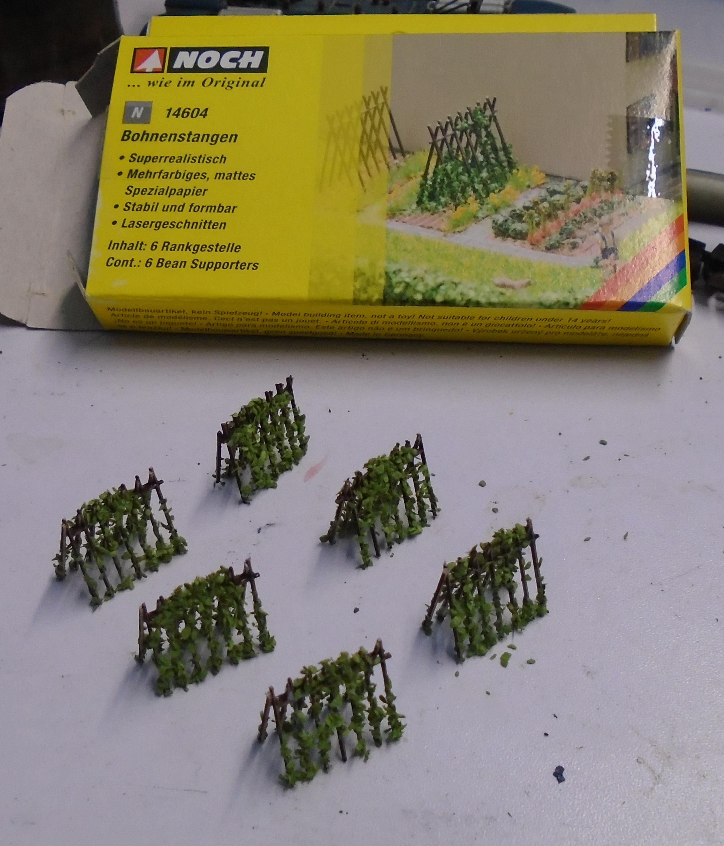

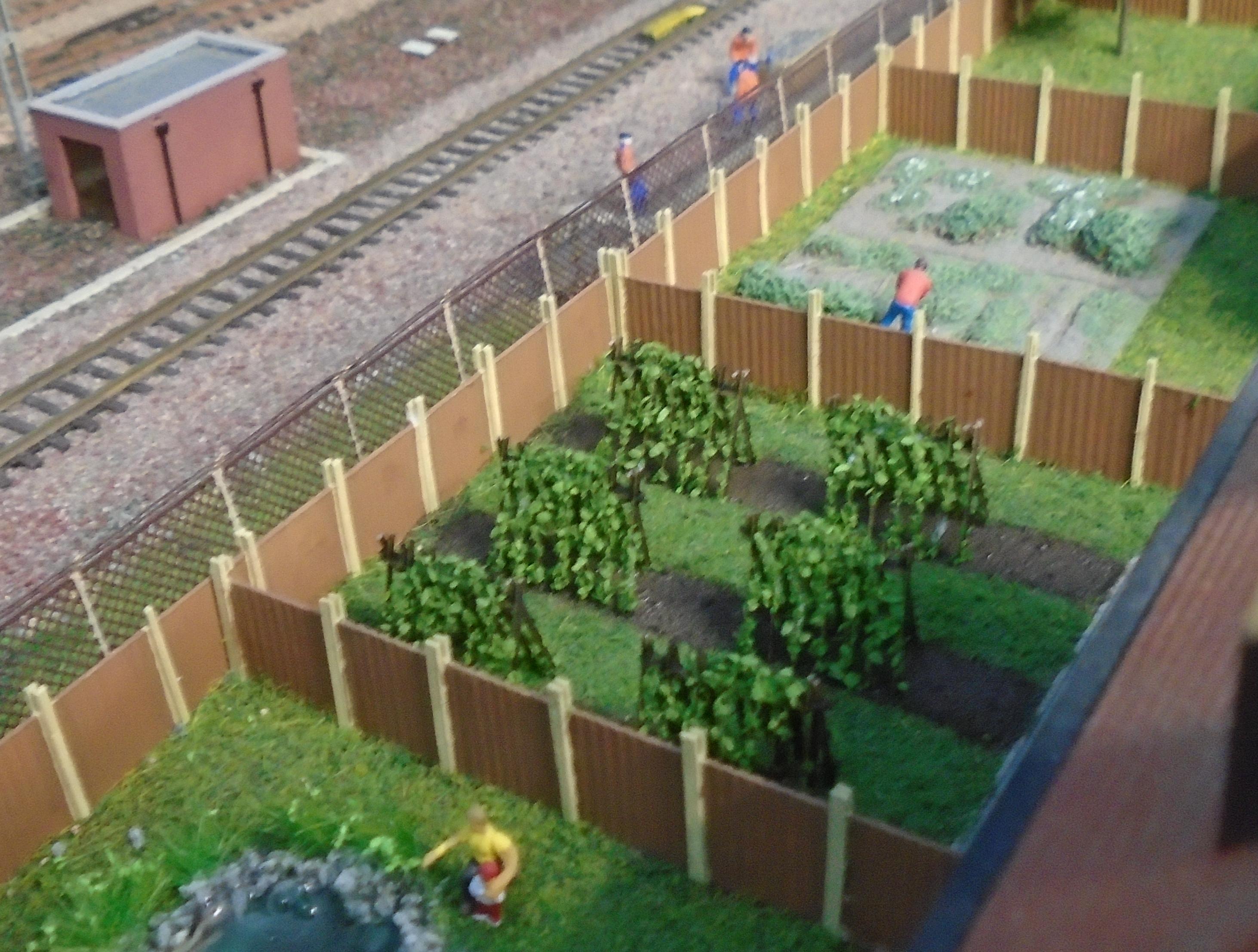

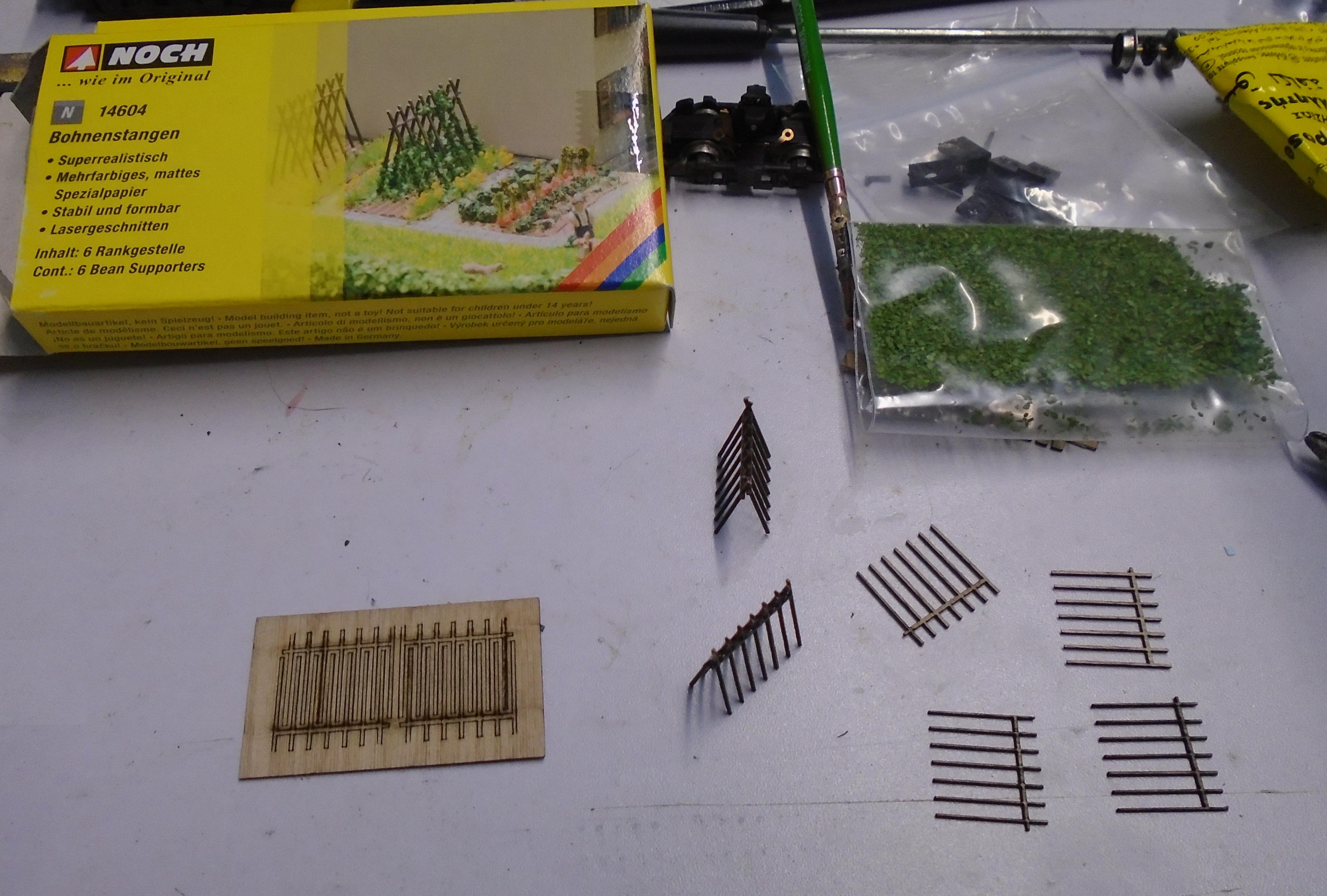

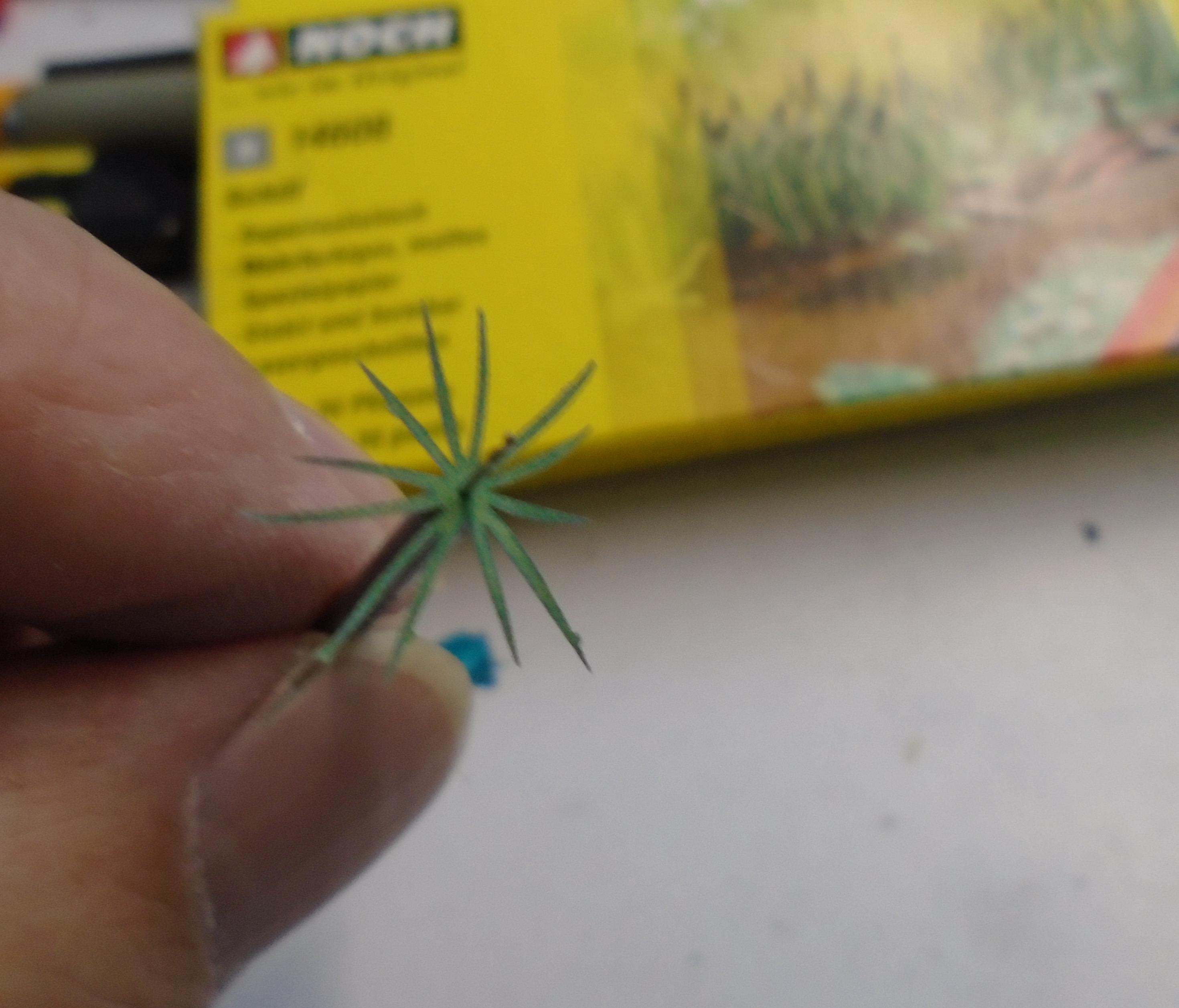

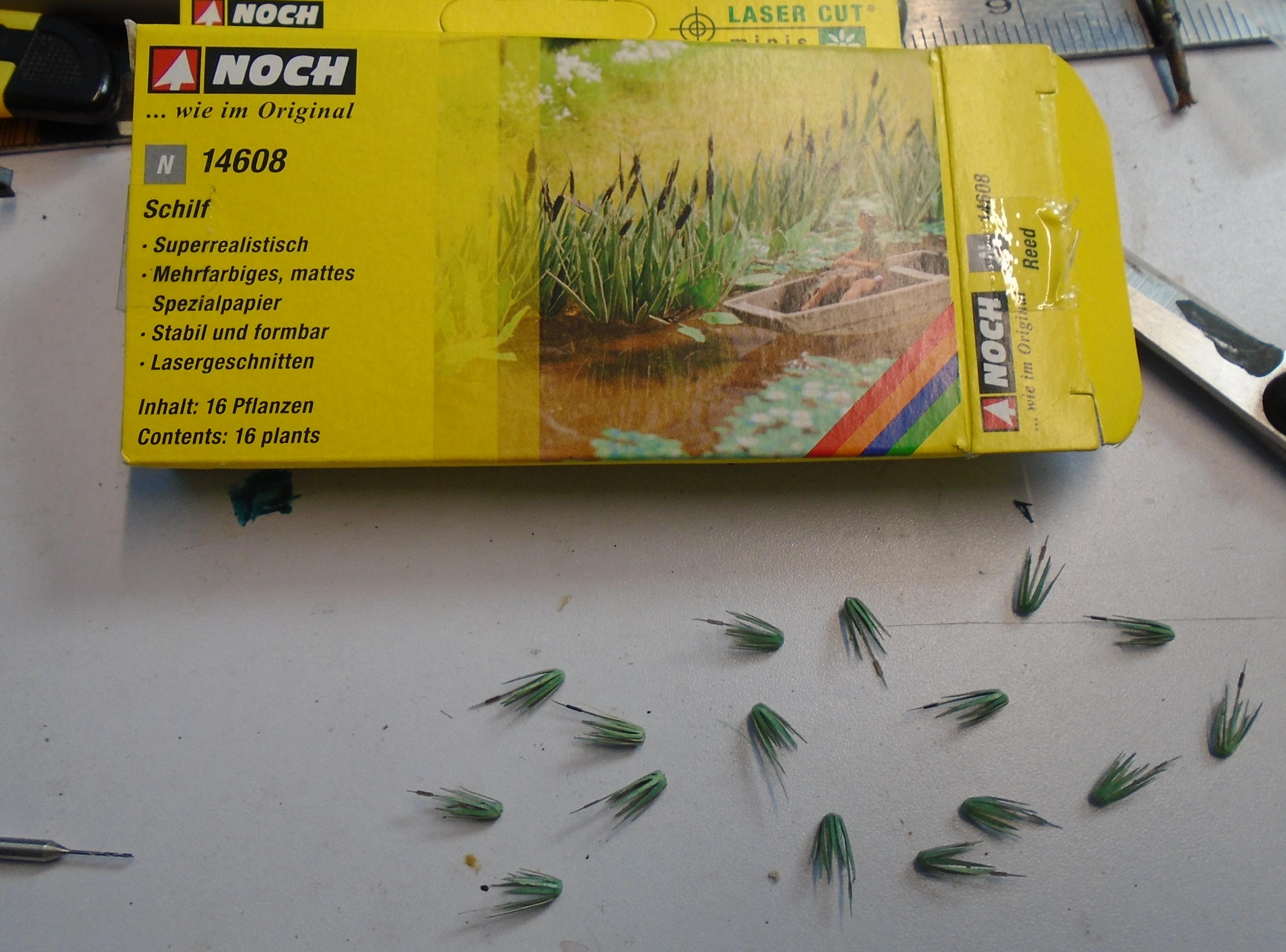

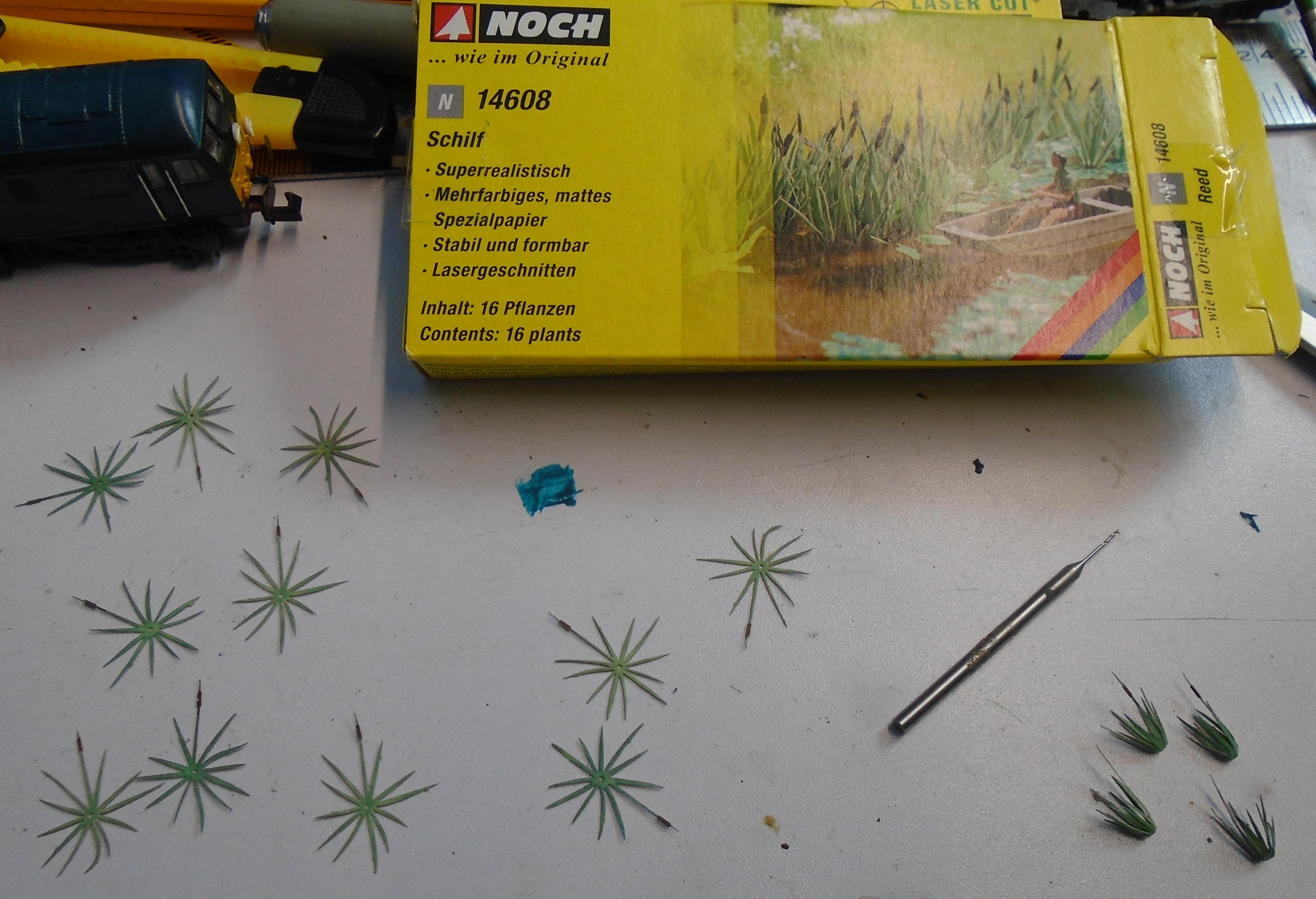

Thought I would have a go at doing some extra scenic work to continue the 'A Model Railway's never finished' theme. Got some Noch Laser cut Reeds and Bean Poles to have a go at. Bit fiddly, but all done in a day  :)
Full story and pics at:-

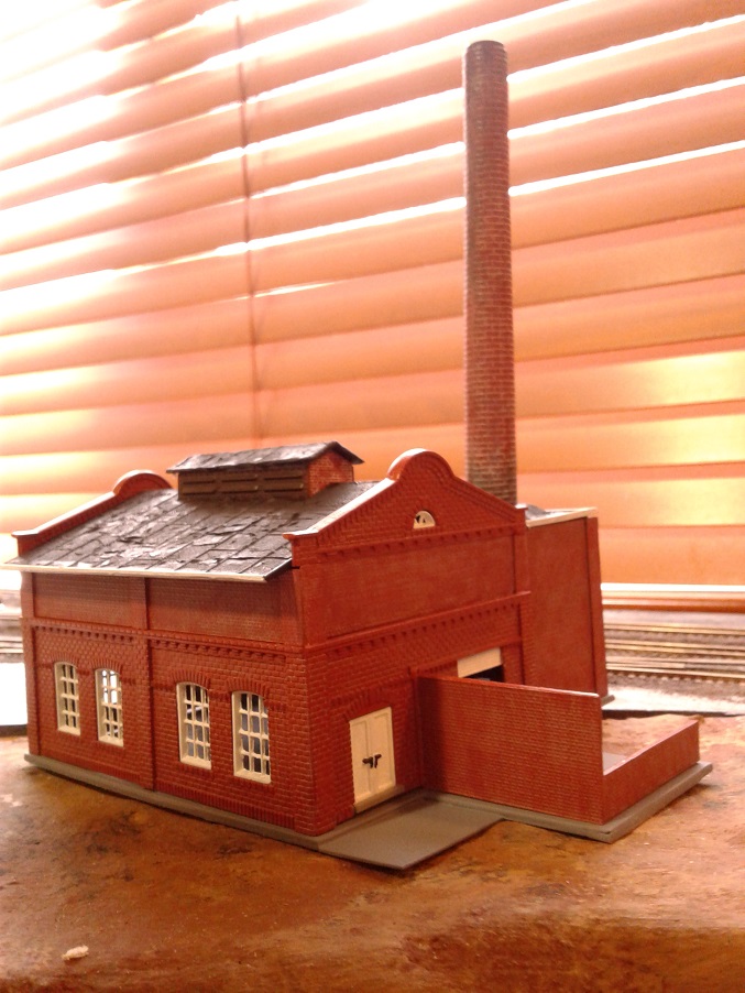

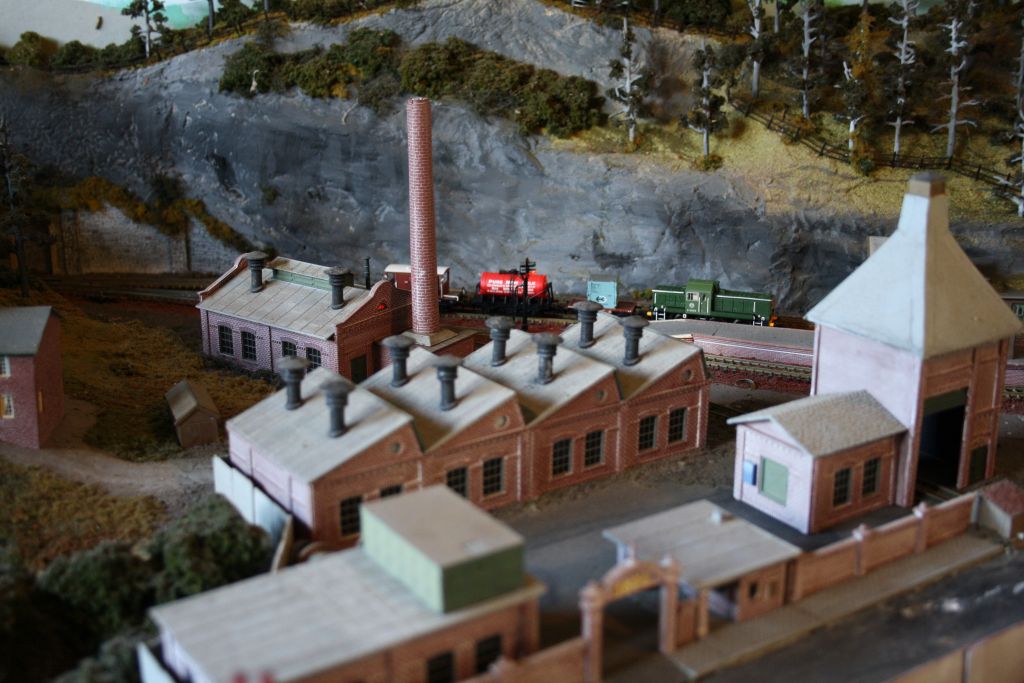

Working on this kit bash for a power house. About 90% complete.
I recognise the raw material. Very kit-bashable.

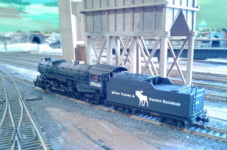

Moose also have this on workbench ... It's what is immediately behind the Mighty Mikado #9509. N-joy!
