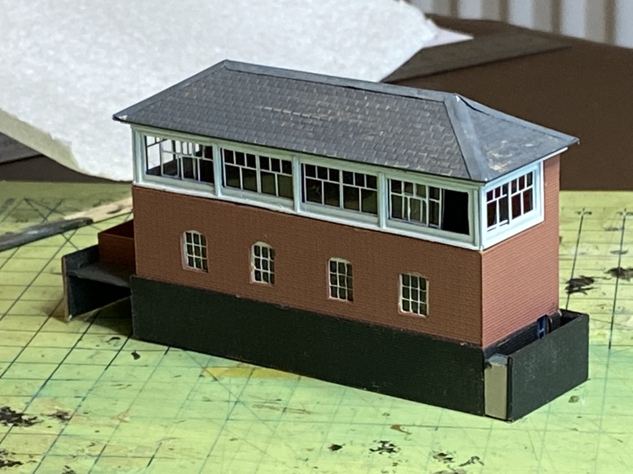

Chris Morris
#3067
Still work to do but coming along. I always model signal boxes with some windows open. Never seen an open signal box with all the windows closed in the summer.

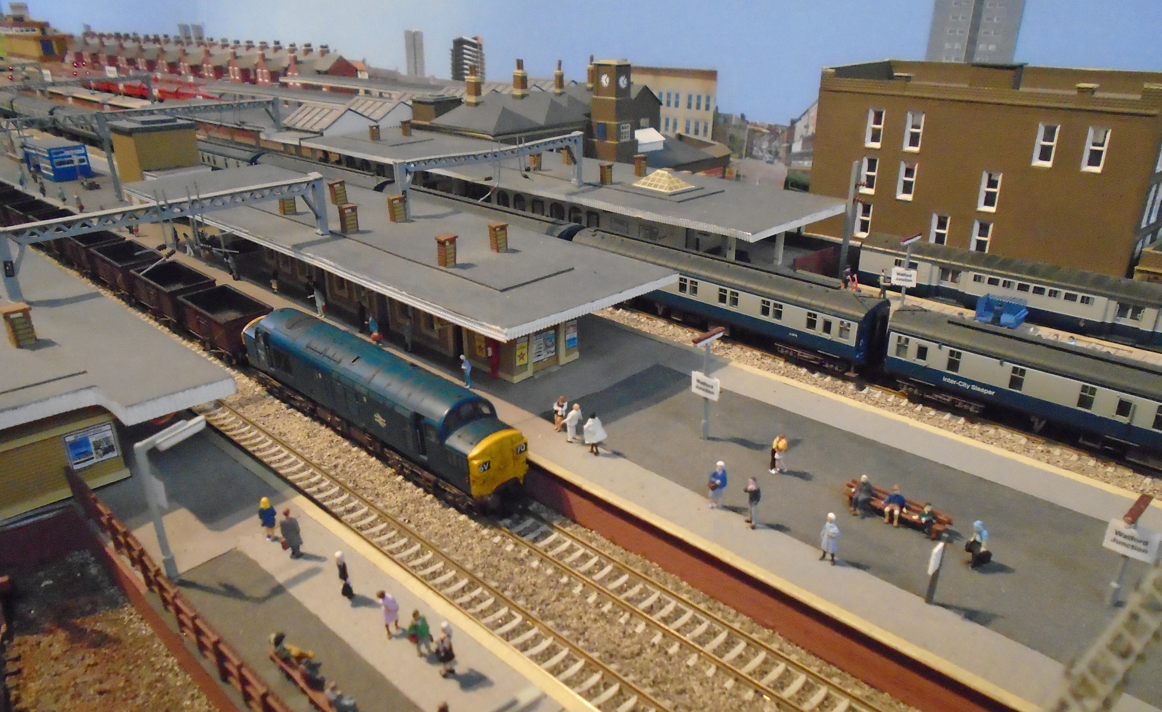

AndyRA
Adding some more figures on the station platforms.
Full story and pics at:-
manicmick

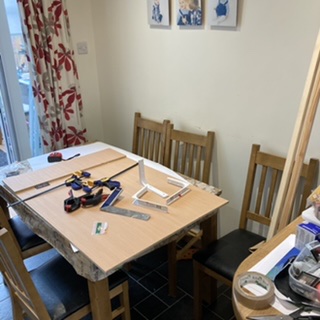

Pjlons83
I've had the woodwork tools tools out for a couple of days  8)
I'm excited about this one!

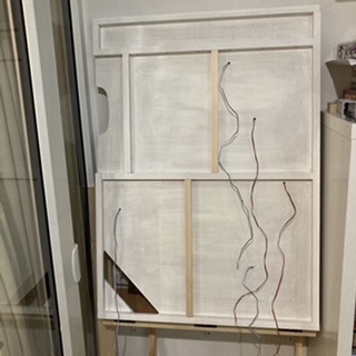

Pjlons83
I've had a good couple of days building this. The track is partly pinned whilst I wait for my new controller to arrive. Then I'll test it all and fix it permanently.

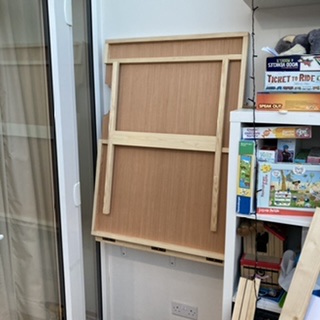

Trenoweth
Building it from scratch. Lockdown project. 120cm x 60cm. Simple layout with Cornish Riviera set plus a Jinty with a couple of wagons. DCC. Wish me luck!
