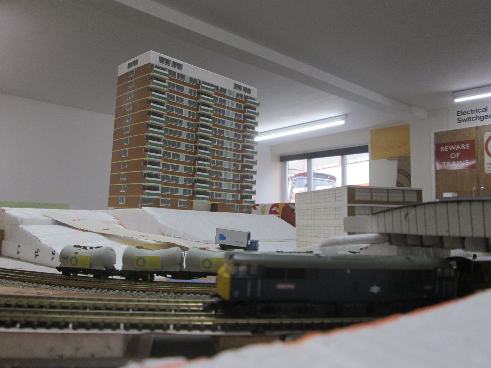

KevTheBusDriver
The block of flats is more-or-less there...
This is a model of Booth House, Teddesley St Walsall, named after William Booth (Salvation Army). Erected circa 1968, it was demolished in about 2008. I delivered papers to it in the 70s! Similar blocks still exist in the Walsall area. An identical called O'Hare house was next to it but I don't have space on the layout for that one!

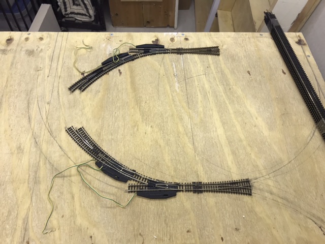

Greygreaser
Quote from: Dorsetmike on December 10, 2020, 07:24:40 PM
I've got to the stage of hunting down shorts and bad rail joins on my new layout. Does anybody else have trouble with Peco rail joiners, I'm wondering if Xuron cutters maybe distort or otherwise make fitting joiners a PITA. I've started to chamfer the rail ends a bit with the disc in the minidrill.
As things progress on the layout I keep getting "new ideas" to alter the original plan, I've figured out where I can use a scissors, (yeah I know it'll be a pig to wire up)
I wish the Kato turntable was a little smaller, it tends to make a 2 or 3 road shed  look ridiculous, but it's motorised with it's own controller.
Mike I bought a number of pieces from Station Road Baseboards and I'm pretty sure they do a turntable and components you can make your own to suit your space/layout. Somewhere I've seen a motor too for driving the tt electrically.
You're scaring me with the rail joiner issues as I've bought a load of Peco ones 🥴🥴🥴

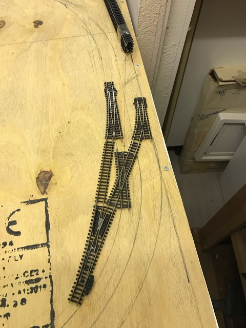

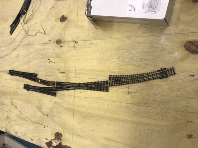

Trying to send a few picks of the point work attempts

Greygreaser
Looks like I sent the same pic twice - it was my birthday this week😊😩
Here's the third bit
