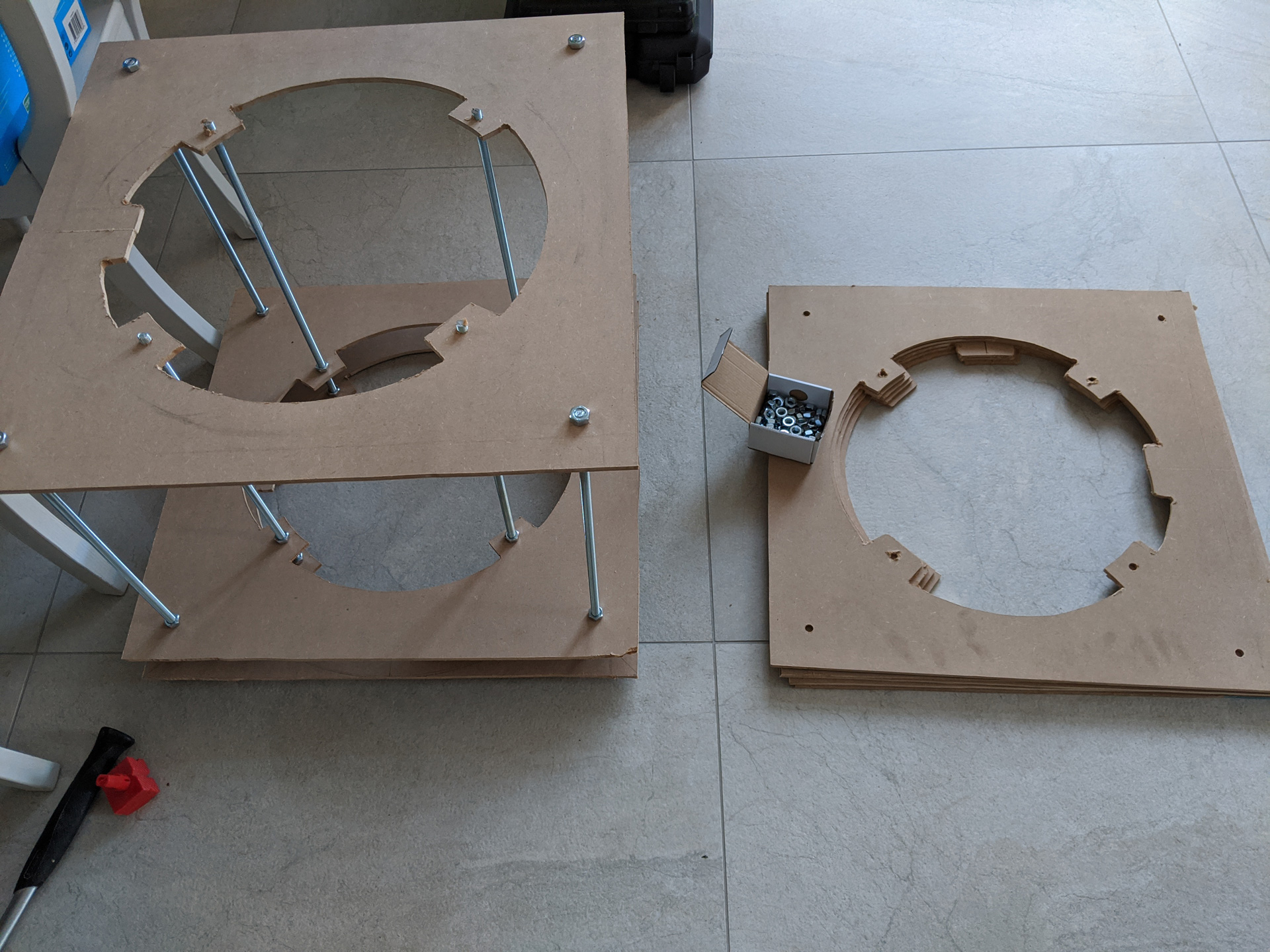

Today I've been building a helix. I'll be testing going 'up' on 3rd degree tomorrow.
Don't judge my woodworking, this isn't scenic. :)

Just testing my first loops of the helix.
Stopping and starting on the gradient with 11 pieces of stock and my trusty Class 25.
  • 3rd degree radius Peco set-track (for testing)
  • Not cleaned, straight out of the box - 1 power connection
  • Gap between levels is 50mm
  • Clearance is at least 15mm, so plenty of room
As a result, could lower the gap to 45mm to soften the gradient some more to be safe.
It does however show the small BoBo loco having no issues whatsoever on a 2.5% gradient with 11 wagons. Next, I'll do 20+ wagons...

Quote from: Newportnobby on April 26, 2020, 10:12:03 AM
@Ted
Is that a kit, Ted? If so, where did you source it and what radius curves fit (it looks quite small) please? (not that I'm after one but others may find the info of use)
No, I made it myself. I was going to buy a kit (lazy) but the guy on ebay is 'away' and the Model Railway Solutions are not taking orders.
So, I had a sheet of 6mm MDF delivered, a few rods, bolts and a Jigsaw.
It's 610x610 (2ft) with a 3rd degree radius and about a 2.5% gradient. Although, I'm working to trim that down a touch.  :thumbsup:

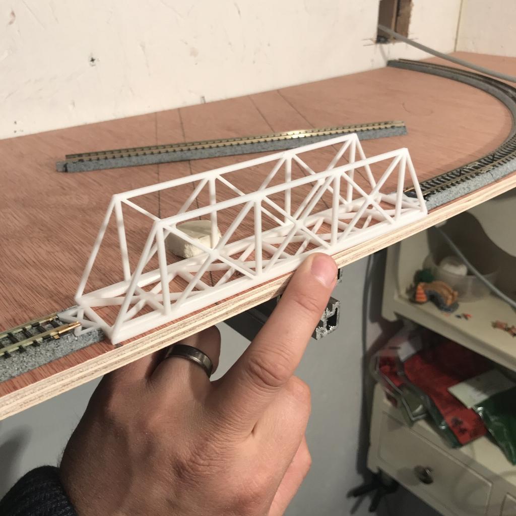

I've restarted my main layout after much planning (mostly in my head) and yesterday I made a bridge with the 3D printer. (just a top section to make and then spray paint/glue). I just looked up my post about scratch building a bridge for the original layout and was amazed to see that it was almost exactly 2 years ago! https://www.ngaugeforum.co.uk/SMFN/index.php?topic=40360.msg490811#msg490811
I'm feeling very please with the results of my latest bridge and my progression in the hobby in general. Its fun looking back at old threads (even though I'm still a relative "new-born baby" in the hobby compared to how long some others have been modelling  :-[ :D ).

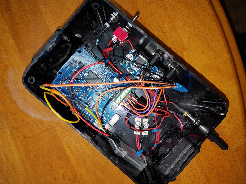

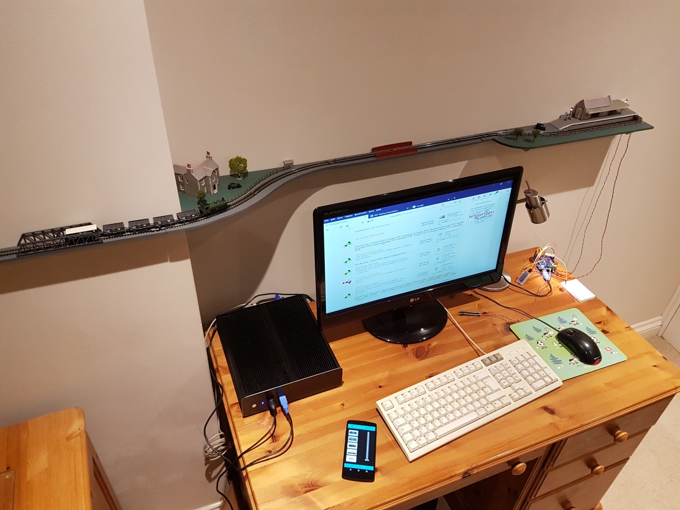

After house move now have space for a new layout. Having more time because of the lock down but lack of stuff to start a new layout thought i'd start work on a dcc controller and software.
Test Track - DCC Controller in the RH corner
DCC Controller now cased

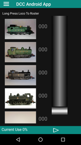

Main Throttle Screen Working on Android

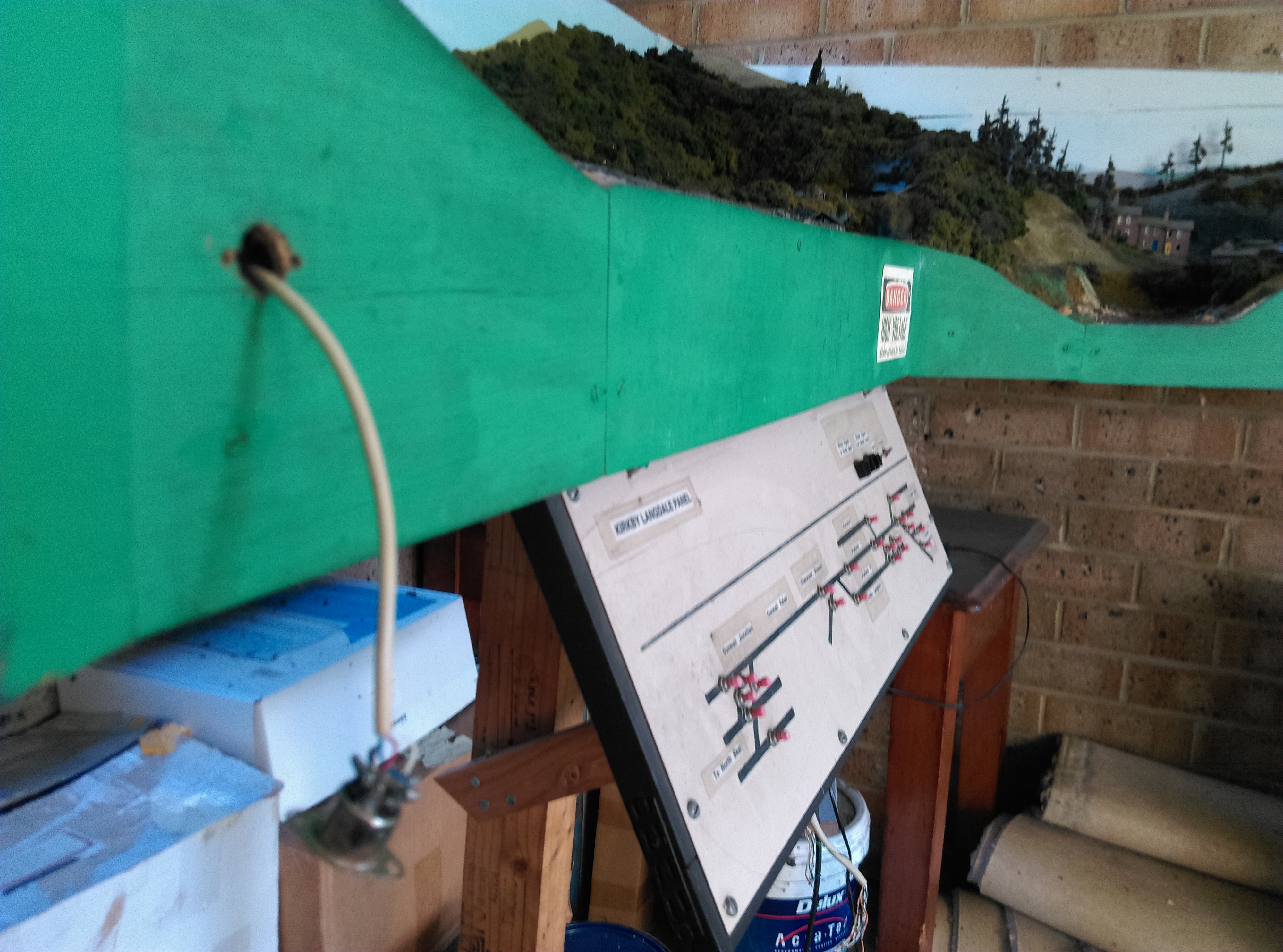

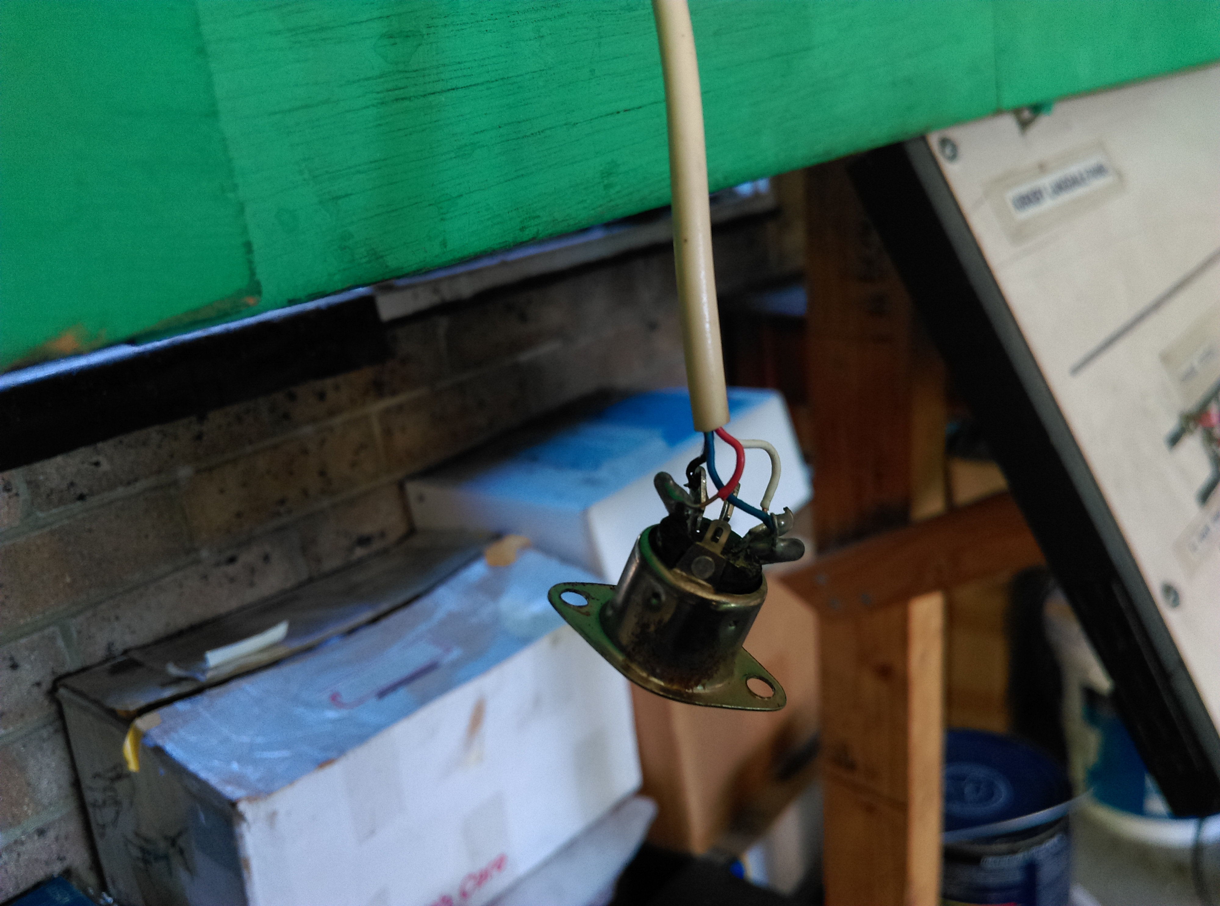

However, now that I am here, there has been a bit of activity lately. What am I doing at the moment?
Replacing a dodgy DIN socket at Kirkby Langdale.
It's where the hand-held controller for the Kirkby Langdale section of the branch plugs in. I noticed when I was fiddling around the other day that it had intermittent electrical contact, for no other reason but old age. So, out it comes, to be replaced with a shiny new one!
