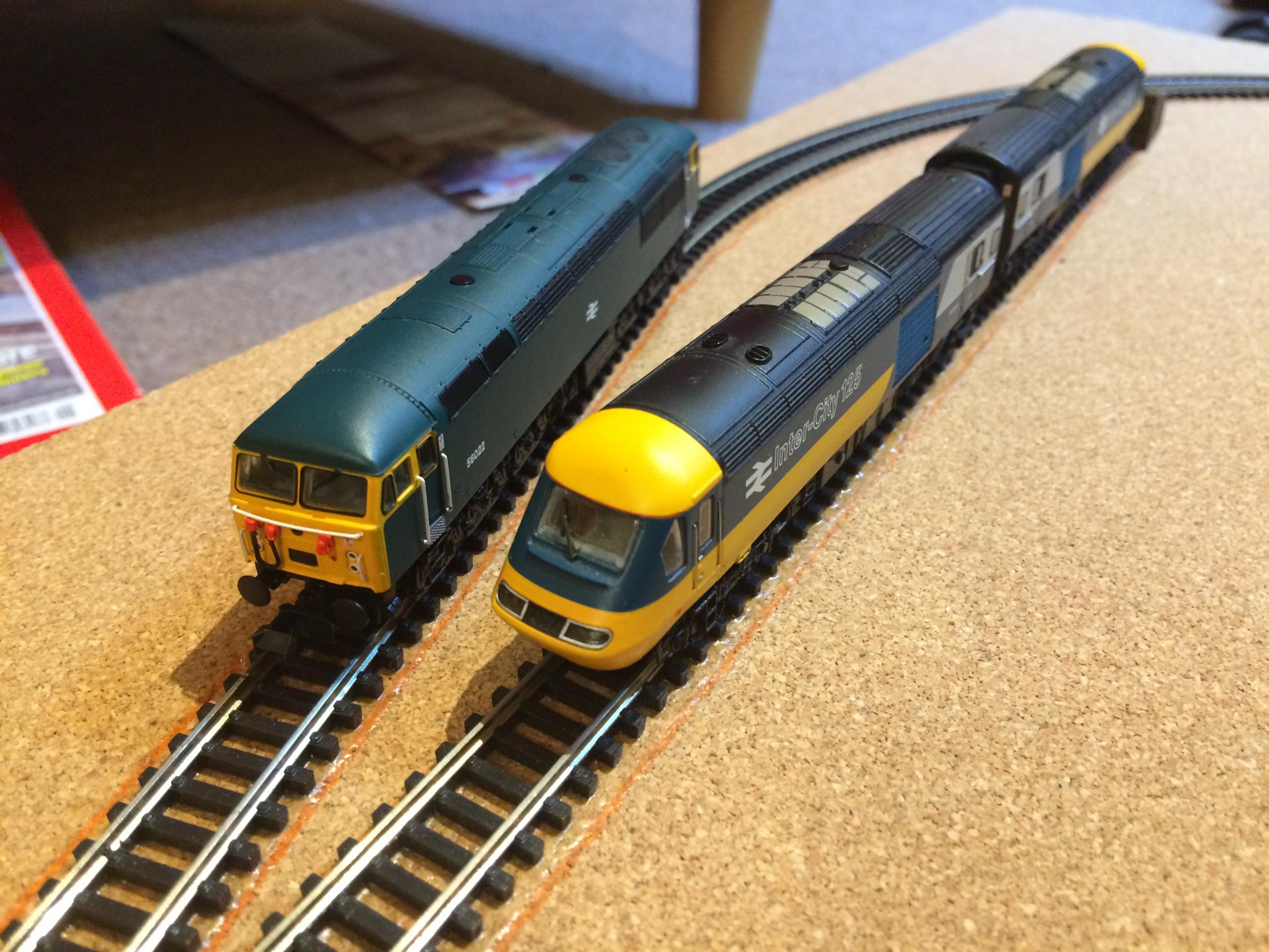

Well, I had a bit of a Dapol weekend:
The 56 was inspired by Bruce, amongst others, and the HST was the result of a number of saved searches on ebay.
It turns out, however, that both have their shortcomings.
The 56 will not go round my test track without derailing. I think it's just objecting to the 9" set track curves - does anyone know the minimum radius it'll go round? There's nothing in the instructions, but I seem to recall that R2 (whatever that is) is specified as the min for quite a lot of stuff.
And the HST: well, where to start. But the main problem is that someone has been inside and rewired it, so that the unpowered car short circuits. The/a previous owner had put insulation tape over the bogie contacts to make it useable, but I think it's going to have to go and see a specialist at some point soon.
I'm not sending it back, because it's exactly what I want, so will just have to fix it. The headlights don't work on the powered car either, so that'll need looking at too.
Tony
@Yet_Another  I have just acquired a Dapol 56. My test (Kato) track is a 4' x 2' oval with a passing track. One of the pieces in the passing track is the tight radius, (sorry I do not the radius off hand - will look it up a bit later), curve and the 56 derails if using that piece, so they obviously do not like tight radii! It runs beautifully on the outer oval.
#4187
Quote from: Yet_Another on July 22, 2018, 11:22:30 PM
I think [the 56] it's just objecting to the 9" set track curves - does anyone know the minimum radius it'll go round? There's nothing in the instructions, but I seem to recall that R2 (whatever that is) is specified as the min for quite a lot of stuff.
I am very surprised that a bogie diesel won't go round 9", it must have a poor bogie turning circle?    R2 minimum is usually a restriction for  larger steam locos especially those with shaft drive and/or full size front bogie wheels behind cylinders.
If the likes of Fleischmann or Minitrix etc. were to make a model with such restrictions there would be an outcry, given that both firms' minimum radius is less than 9".
Yet_Another
Thanks @dannyboy , I'm glad it's not just mine!
I can't find anything on the Dapol website concerning the tech spec of these (or any other) locos.
As far as I could tell last night, it was the wheelbase of the bogie that was popping off, rather than a restriction in its rotation.
TBH, it's not a problem operationally, as I won't have anything this tight on the layout. Just a bit annoying and as far as I can tell undocumented.
Tony
Skyline2uk
Ref Dapol Class 56 and 1st Rad; none of my three de-rail on this radius.
In fact, I don't have a locomotive in my fleet (90s Farish to latest Farish and Dapol) that does.
I am afraid to say it seems random (and apparently I have been lucky).
Skyline2uk
Quote from: Yet_Another on July 23, 2018, 01:51:57 PM
Which is still very odd, given that the wheelbase of a bogie is the same or less than a typical 0-6-0 loco.   Maybe a twist in the track and not enough slack in the bogie pivots?

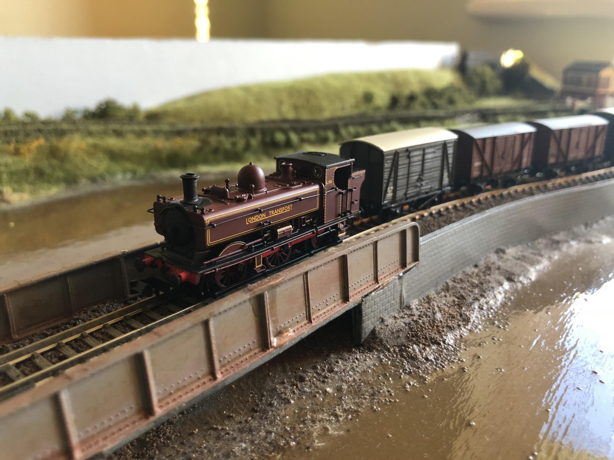

Knight of the Thistle
Here's my latest acquisition... definitely a "Rule 1" purchase but I love Panniers and have happy memories of seeing LT-liveried versions operating on both the South Devon and Paignton & Dartmouth railways last summer!
Skyline2uk
Quote from: Knight of the Thistle on July 23, 2018, 09:09:39 PM
Would be VERY rule 1 for me, but I do very much approve. I have been captivated by LT Panniers ever since I was allowed onto the footplate of one as a boy at (I think) the Bluebell.

Yet_Another
Quote from: ntpntpntp on July 23, 2018, 02:36:26 PM
Definitely not a twist in the track - it will do it on any of the four corners of my running in oval, which is laid on a completely flat board.
I can't find any minimum radius spec for this loco, so I've written to Dapol.
Tony
That's a lovely model. And there is something attractive about the LT livery.
A very good rule 1 purchase!  :thumbsup:
