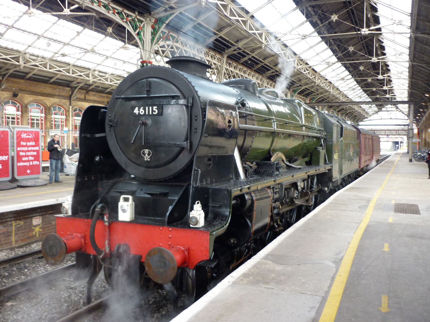

I travelled behind 'Scots Guardsman in 2012 from Preston to York and his performance was exemplary.
Preston
York

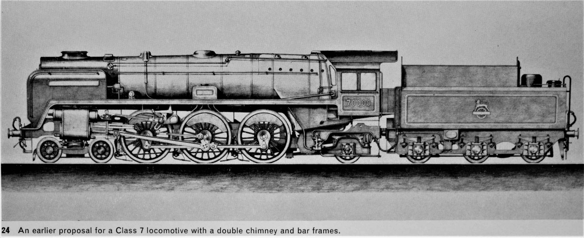

'Prior to Ell's work, it had been proposed to fit the larger standard engines with double chimneys as Plate 24 portrays, but this was based upon previous LMS experience where this arrangement had shown marginally more favourable results on the 'Duchess' Pacifics and the Class 5 mixed traffics. However, Ell was able to show the way to better results with correctly proportioned single chimneys than had been obtained formerly with some of the double arrangements, and it was decided to initiate the new series with the simple single arrangement leaving future development work any trend to multiple nozzles at a later date.'1
Plate 24, from a BR illustration, mentioned in the quote is interesting - a double chimney 'Britannia' with bar frames:
I think the late Mr Cox's quote is fascinating. That use of 'marginally' might have been fair enough for the 'Black Fives', but surely the results of the 1939 trials showed more than a marginal improvement for the 'Princess Coronations' ('Duchesses'). And the quote completely ignores the magnificent '2A' boiler, with double blastpipe and chimney, which transformed any LMS 4-6-0 to which it was fitted. Yes, the 'Princess Coronations' performance in the 1948 Locomotive Exchanges was less than could have been expected but the 'Converted Royal Scots' set the rails on fire (metaphorically!).

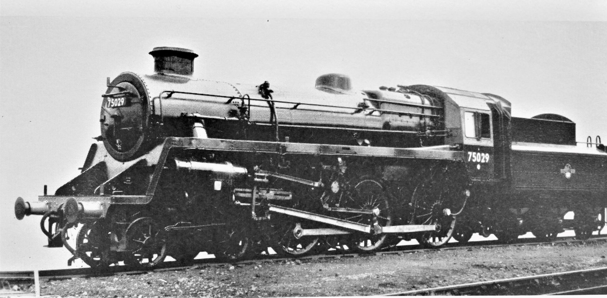

Mr Cox went on to bemoan the fact that Swindon and Eastleigh Works produced different-shaped castings for the double chimneys. He didn't like the Swindon version.
[The Swindon double chimney as fitted to No. 75029. [British Railways photograph]
Please forgive the missing rear of the tender. Whilst this would be typical of my coarse photography, it's actually from the original print. By the way, No. 75029 is, happily, still with us, complete with double chimney. She's on the NYMR and requiring a major overhaul - there's a public appeal open. She was purchased from BR by the late David Shepherd and given the name The Green Knight.]
One wonders why, with all of Sam Ell's know-how, a double chimney was fitted to locomotives of only BR power class '4'. It was found, in single-chimney form, these engines could evaporate 19,600 lb. of water per hour. The double chimney increased this to 22,400 lb. of water per hour. This is an interesting contradiction of the results of Mr Ell's earlier work which implied a properly designed single blastpipe and chimney was the equal of a double arrangement.

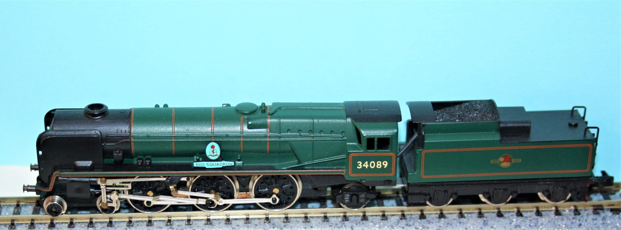

Mr Bulleid fitted the Lemaître exhaust to his three new designs for the Southern - the 'Q1' 0-6-0, 'MN' 4-6-2 and 'WC/BB' 4-6-2. The 'Pacifics' that were rebuilt by BR retained the Lemaître exhaust and consequent large diameter chimney, seen to good effect in this picturingham of 602 Squadron:
[I love this ProperlyPoole Graham Farish model, borrowed from the SuperSilly train set for the picturingham. It's full of character and reminds me of the delightful Hornby-Dublo Barnstaple (2-rail) and Dorchester (3-rail).]

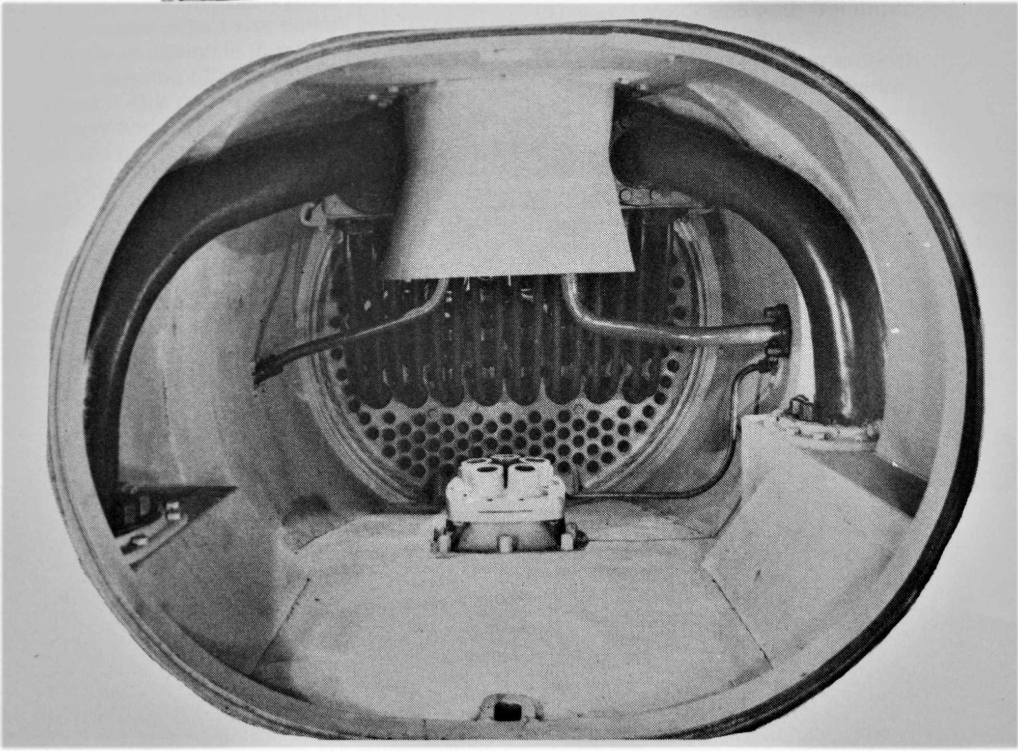

The boilers used on Bulleid 'Pacifics' were prodigious steamers - a combination of good design, thermic syphons in the firebox and Lemaître exhaust. Let's, courtesy of a BR Official photograph, have a peek inside a 'Pacific's' smokebox at Mr Bulleid's modified Lemaître exhaust:
The two pipes entering the chimney petticoat are exhausts for the brake ejector and the turbo-generator - the Bulleid 'Pacifics' had electric lighting. There is a ring of blower jets, provided with steam through the small pipe seen at the right, at the base of the blastpipes.
