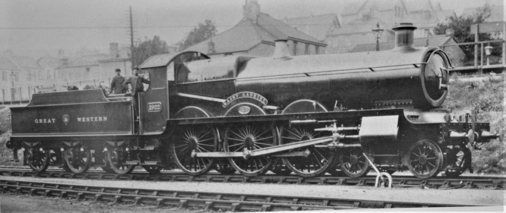

Yes, the GWR! Only it wasn't called a variable blastpipe.
When the production-series 'Saint' class 4-6-0s were introduced from 1905, everyone concerned with locomotive running on the GWR realised what superb locomotives they were. Mr Churchward had produced a masterpiece. He did that several times. With a high boiler pressure, long stroke cylinders and excellent valve events, they started away from stations with a 'one-two-three-four' of explosive exhaust beats.  Once underway, as the driver linked up the valve gear, the exhaust, whilst still crisp, was less explosive.
['Saint' No. 2922 Saint Gabriel, built in 1907. This series was the first to feature, from new, the 'Holcroft Curves' on the running plate. Earlier engines had straight running plates and looked severe. Mr Churchward was persuaded to prettify the outline and instructed Harold Holcroft to draw something satisfactory. It became part of the overall 'look' of GWR locomotives for as long as they were built.]
The Locomotive Inspectors noticed that the exhaust was pulling the fire around when the engine was worked at a long cut-off and reported this to Mr Churchward. Many Locomotive Superintendents of the time simply refused to hear any criticism, however mild and well-intentioned. But that wasn't the Churchward way. He thought that reservoirs connecting the exhaust passages would soften and prolong the beats and asked Harold Holcroft, then in Swindon drawing office1 to find a way to put this in practice. He did and an engine was fitted up and tested. No difference!
Mr Churchward and his people gave the matter more thought and arrived at the 'jumper top' to the blastpipe. This could move up and down and was lifted by the force of the exhaust at cut-offs over 40%. When the jumper top was lifted, it increased the area of the nozzle of the blastpipe. When the engine was linked-up, it resumed the normal lowered position, which gave a smaller blastpipe orifice. That way, drivers could make enthusiast starts without disturbing the fire. All that was required was maintenance to ensure the jumper top could move easily and didn't get jammed by oily carbon deposits. This was an elegant system as it was completely automatic in operation, requiring no input from the enginemen.

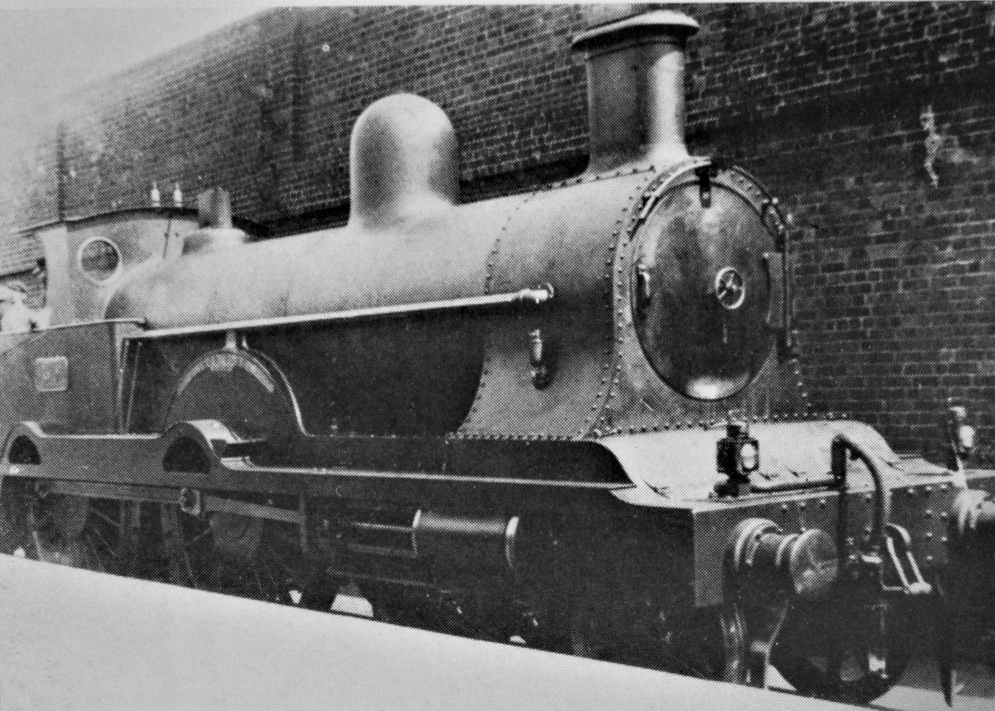

From 1897, Mr Webb fitted a few engines, including his first two four-cylinder compounds and the sole four-cylinder simple, No. 1501, with double chimneys, arranged in a single casing. The smokebox had a horizontal partition and the blast pipes were arranged so that one drew the exhaust gasses from the lower rows of boiler tunes and the other from the upper rows. The arrangement was that the exhaust from two cylinders passed into one chimney and from the other two into the second chimney.
The idea wasn't new - a few engines in Chile had a similar arrangement. Mr Webb's application was ingenious - too ingenious for its own good - and, after a couple of years, Mr Webb abandoned it. I'm glad that I've found a not very good photograph of one of these rarities - the picturingham is from that photograph:-

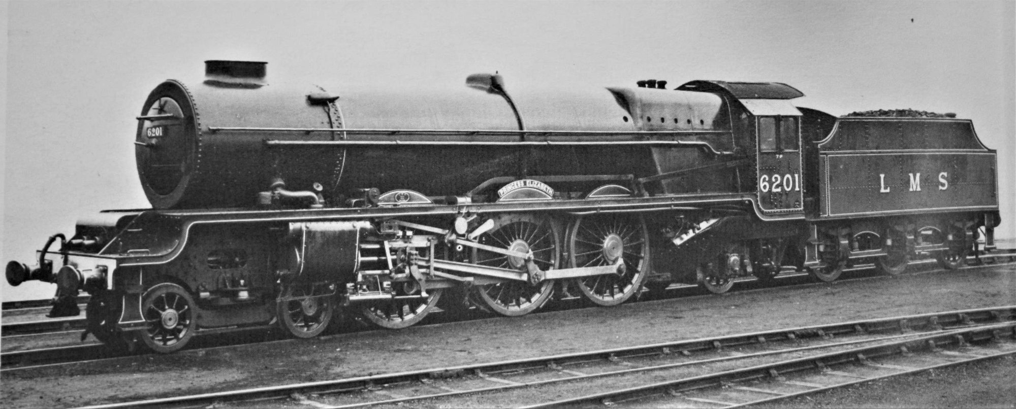

In 1933, Mr Stanier introduced his first two prototype 'Pacifics', Nos 6200 The Princess Royal and 6201 Princess Elizabeth. These had a short-firebox boiler with low superheat in the Swindon tradition. Their performance wasn't as good as hoped for and No. 6201 was fitted with an experimental double exhaust system. The exhaust of the inside and outside cylinders was taken separately to one or other of the blastpipes, instead of being combined in the usual way. Sort of shades of Mr Webb. As you might imagine, the experiment wasn't a success and the engine swiftly reverted to a single chimney arrangement. The eventual answer was a higher superheat and a firebox with a combustion chamber. The remaining 10 'Princess Royals' were delivered in 1935 with the new boiler.
[LMS No. 6201 Princess Elizabeth with the short-lived experimental double chimney. LMS Official Photograph.]

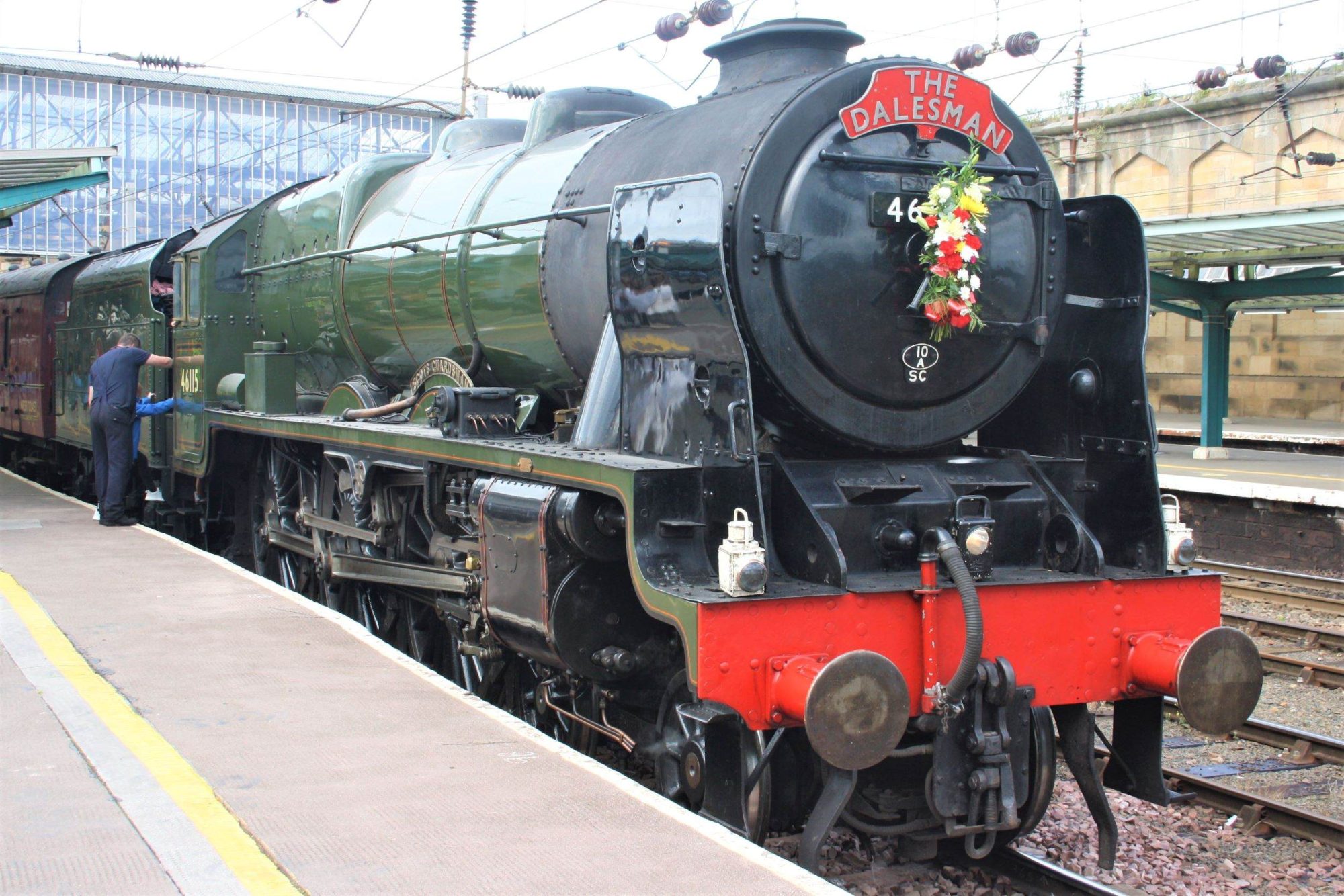

The 'Royal Scots' had been in front-line service for around 15 years and the earlier examples were becoming due for new boilers and cylinders. In addition, there was trouble from leaky smokeboxes, a problem alluded to earlier. In December 1942, authority was given for the 20 most needing 'Royal Scots' to be rebuilt, chosen by the state of their frames or cylinders. Although extensive rebuilds, these were known officially as 'Converted Royal Scots'. No. 6103 Royal Scots Fusilier was the first, in June 1944. The process took a while with the last to be converted, No. 46137 The Prince of Wales Volunteers (South Lancashire), not appearing until 1955. As part of the 'Conversion', the 'Royal Scots' were fitted with the 2A boiler and double chimney. These were magnificent locomotives and were, with the Bulleid 'Pacifics', the heroes of the 1948 Locomotive Exchanges.*
[Converted 'Royal Scot' 4-6-0 No 46115 Scots Guardsman at Carlisle Citadel on 18 August 2021. She gave us a splendid run over the Settle & Carlisle in both directions.]
