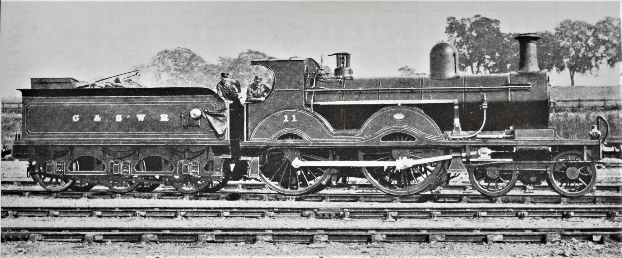

Then, in April 1897, Mr Manson gave those interested in British locomotives a surprise - the country's first four-cylinder simple expansion engine, No. 11 on the G&SWR. She looked like a member of the elegant '8' Class with the addition of outside cylinders and connecting rods. She was allocated to Carlisle steam shed and placed on top passenger duties - the 'Pullman Link'.
Unfortunately, she was not a complete success, being heavier on coal and water than the '8' Class engines also in the Pullman Link. Some claimed this was due to the additional demands for steam from her four cylinders, but the cylinder volume exceeded that of the '8' Class by a proportion of only 1.05 to 1.
It's always a pleasure to quote from the writings of the incomparable David L Smith; here he is on No. 11:
'They could not get it 'on the beat', a sine qua non with G&SW engines. It did its work, and ran its time, but they did not like it. When the first 4-6-0s came out in 1903 No. 11 became a sort of spare, sometimes doing station pilot work at Carlisle Citadel.'2
This suggests No.11's valve setting wasn't quite right. Incidentally, two sets of inside Stephenson link motion were provided, the valves for the outside cylinders being driven from the inside motion by rocking shafts passing through openings in the frames.
No. 11 was extensively rebuilt by Mr Whitelegg, the G&SWR's last Chief Mechanical Engineer, in late 1922. Little of the original was left apart from the wheels. Numbered 394 and, in a break with long-standing G&SWR tradition, named Lord Glenarthur after the company's chairman, the engine performed well on the Glasgow to Ayr services until 1931. After that, she was used on local work until withdrawal in November 1934.

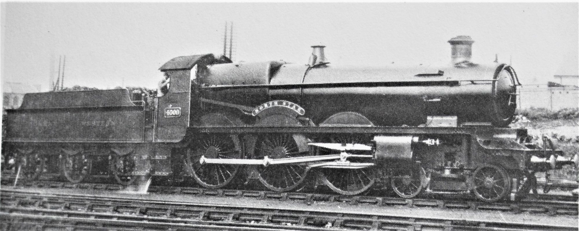

Great Western Railway 'Star' Class of 1907.
The shining star [Thank you!] in the firmament of four-cylinder locomotives. Mr Churchward's cross of USA and French practice combined with excellent Swindon detail design and workmanship produced a winner. Later enlarged as the 'Castle' and 'King' classes, locomotives to this basic design were built into the BR era. It would take a much better writer than me to do justice to the excellence of a 'Forty'. The enginemen loved them. In my view, their only competitor for the best British four-cylinder design is Mr Stanier's mighty 'Princess Coronation' class for the LMS.
Incidentally, the origin of the 'Star' class can be traced to three French 4-4-2 locomotives which Mr Churchward persuaded his Board to purchase. We'll discuss this when we finally get on the the part/s about compounding. Obviously, I'm engaging in delaying tactics as a volunteer to write these still has not emerged. Even although Bribery by Chocolate is on offer.
The picturingham shows GWR 'Star' 4-6-0 No. 4000 North Star. She was a very interesting engine, being built as a simple-expansion 4-4-2 in April 1906. She was No. 40 and soon named North Star. We'll discuss her performance compared with the French compound locomotives later. However, Mr Churchward was well aware that the adhesive weight of 55 tons as a 4-6-0, rather than 39 tons as a 4-4-2, would be jolly handy in sorting out the ferocious Devonshire banks. That's the steeply-sloping kind, not the money-lending kind, although they were, in all probability, ferocious as well.
Which meant he standardised on 4-6-0s for express passenger work, with the exception of The Great Bear four-cylinder 4-6-2 of 1908.

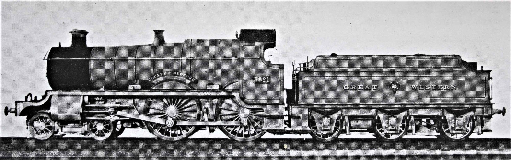

Thirty production 'Star' Class 4-6-0s, derived from No. 40, were put into service from February 1907. Once these were complete, No. 40 went into Swindon Works and emerged converted into a 'Star' and numbered No. 4000.
Her history doesn't end there because, in 1929, Mr Collet had her rebuilt as a 'Castle' - this happened to some of the 'Stars'. She kept her name and number and gave excellent service until withdrawn in May 1957. How the Great Western's shareholders must have given nightly thanks to this magnificent locomotive. BR, not having shareholders, was possibly less appreciative of her work. And what work it was - 2,110,396 miles run during her life of over fifty years. The highest mileage of any 'Castle', although, of course, she had a good head start on the others.
Although a 'Castle' was superior for all-out performance, in other circumstances some enginemen had a soft spot for a 'Forty' in good order as they were exceptionally free-running locomotives.  The late Kenneth H Leech, a professional railwayman and authority on GWR locomotives, explained why.
The 'Stars', as built, had 14 1/4 in diameter cylinders with 8 in diameter piston valves. The 'Castles' had the same-sized valves with 16 in diameter cylinders which could reach 17 in on final rebore.
'By modern standards the steam and exhaust ports were on the small side [for the 'Castles'' cylinders] and tended to restrict free running.'5

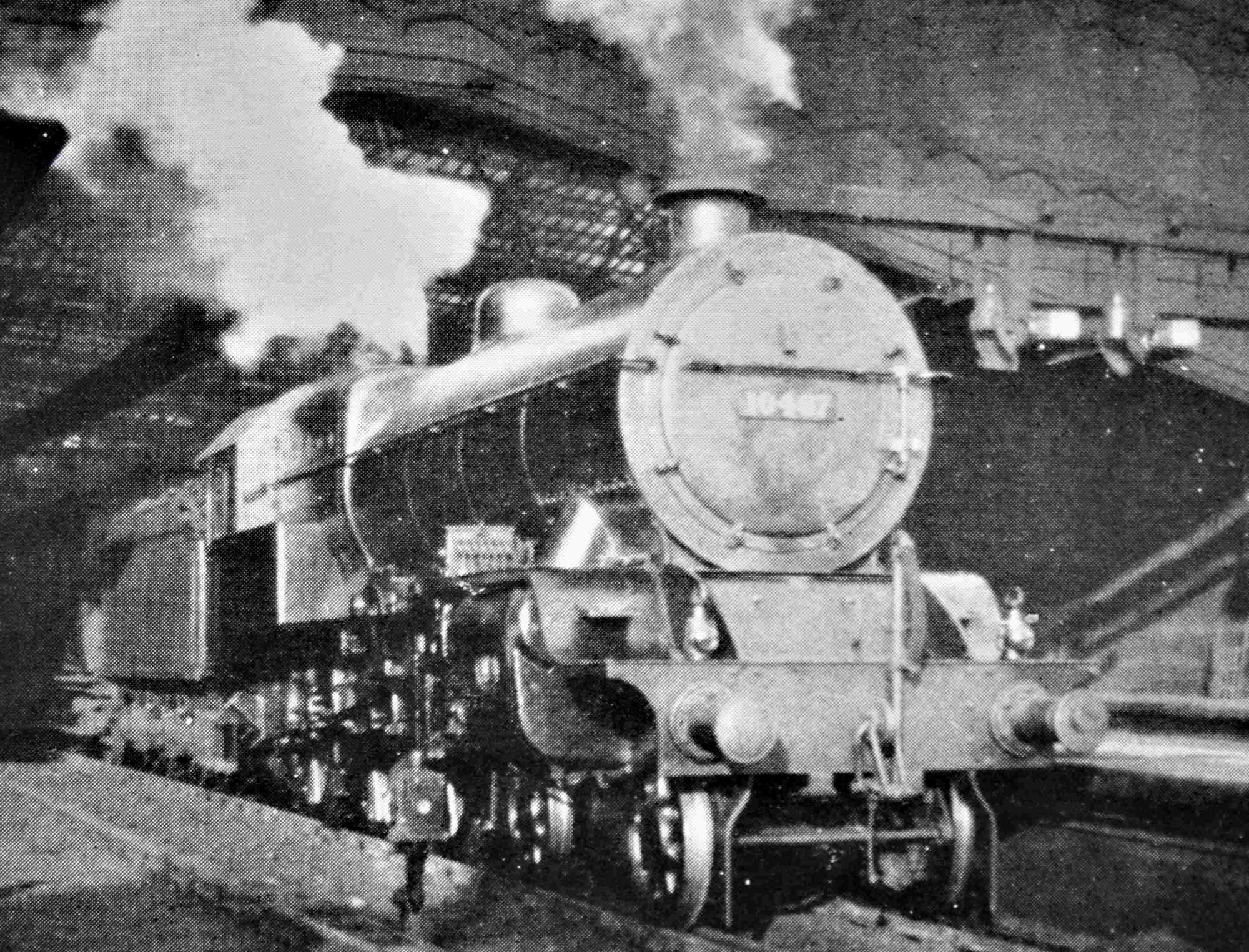

Unbelievably, the LMS built more of the class to help out on former LNWR lines. On these longer runs, their steaming became uncertain and their axleboxes had a worrying tendency to run hot.2
[One of the final series of Mr Hughes' improved four-cylinder 4-6-0s, No. 10467, built for the LMS, leaves Carlisle Citadel with an up West Coast Express. Thankfully, the Lancaster & Carlisle is much easier in the up direction.]

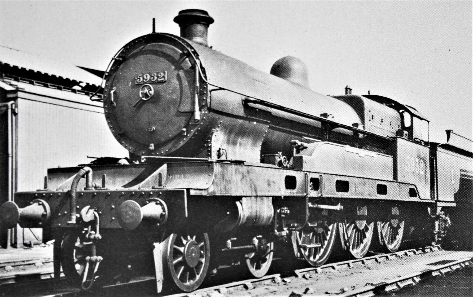

Dr Tuplin wrote that the '[LNWR 'Claughton'] design was superior to that of the Great Western four-cylinder engines, for example in accessibility of the main mechanism. ...]'3 High praise from someone who was even more of an enthusiast for Mr Churchward's locomotives than I am.
Unfortunately, poor airflow to the grate, inefficient blastpipe design and valves that did not remain steam-tight detracted from the class' performance. Detail design was poor and with a speciality of the trailing coupled axleboxes running hot because, with bearing wear, there was sufficient lateral movement to allow the wheels to shear off the oil pipe feeding the bearing.
[A 'Claughton' in LMS days, No. 5932 Sir Thomas Williams.  Unusually, she is attached to a tender from an ROD Great Central design 2-8-0. Unfortunately, the tender is not included fully in the original photograph - for once it's not the fault of my coarse photography.]
Tinkering with the fitting of Caprotti valve gear, mentioned earlier, and suchlike failed to save the 'Claughtons'. As mentioned previously, two were officially rebuilt as three-cylinder 'Patriots'. After that, the LMS didn't bother with the pretence and the 'Claughtons' faded from the scene. A near miss?

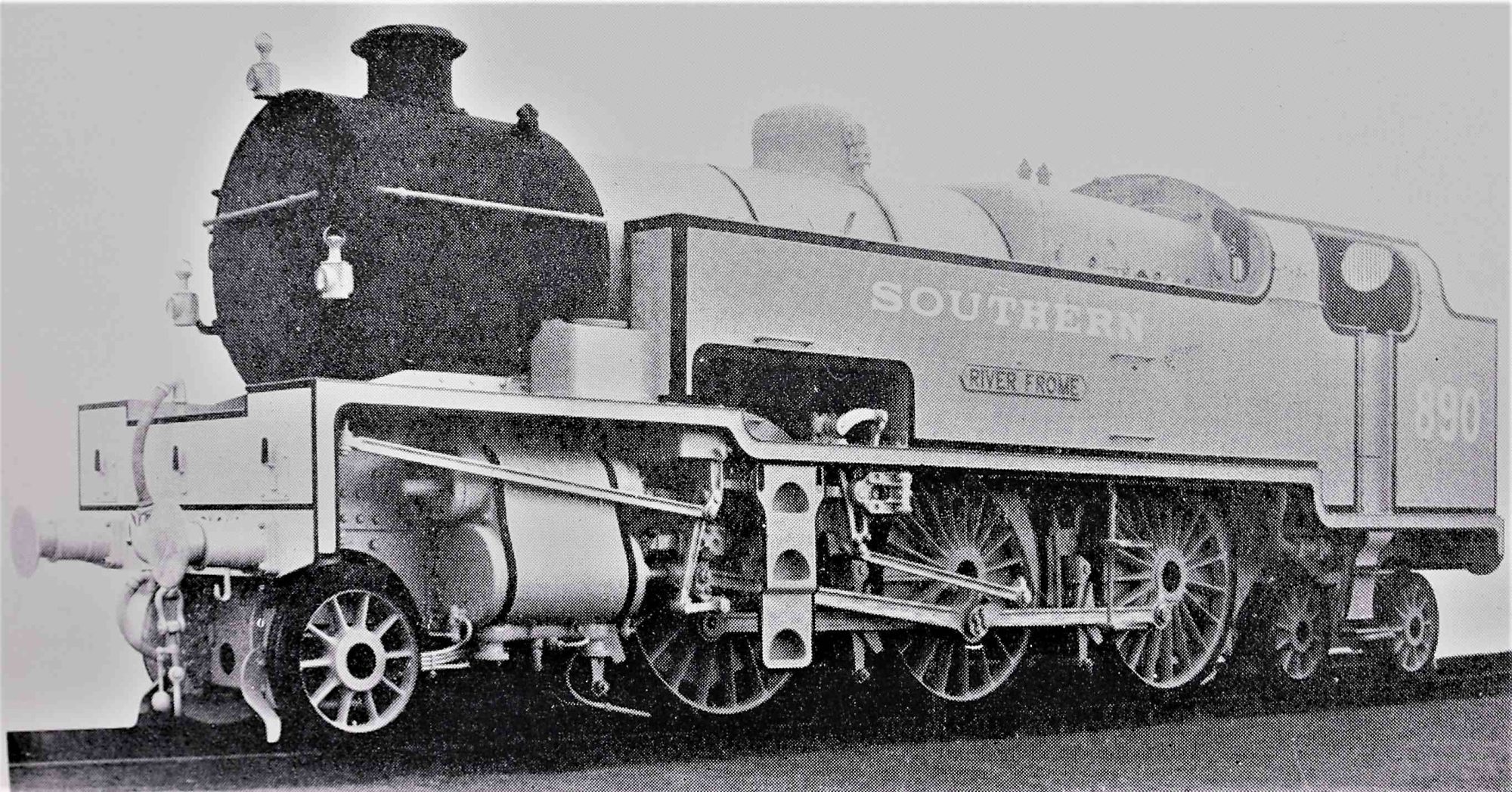

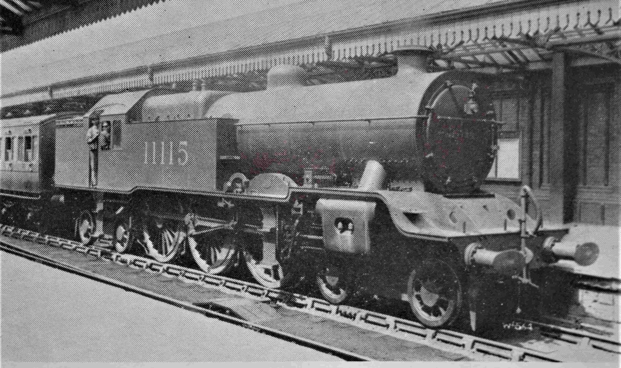

First, are the LMS 4-6-4T engines. LMS in name only - Mr Hughes was informed of a perceived need for a tank engine for secondary services and decided to base the design on his superheated Lancashire & Yorkshire 4-6-0 'Dreadnought' (we looked at these in Part 75). The original idea was to build 60 (yes sixty), but it then dawned on all concerned how long and heavy (100 tons!) these engines would be, with resulting restrictions on route availability.
In the resulting outbreak of sanity, only 10 4-6-4T locomotives were built, entering service in 1924. Twenty appeared in 1924/25 as 4-6-0s and the remaining 30 were cancelled. The perfect locomotive for these duties appeared after Mr Hughes had retired and Sir Henry Fowler had taken over as Chief Mechanical Engineer - that's not a sentence you expected to read, but the Fowler 2-6-4Ts were excellent engines.
Not unique as British four-cylinder tank engines, but the only class of more than one engine. Not a good investment for the LMS - all were scrapped between 1938 and 1942.

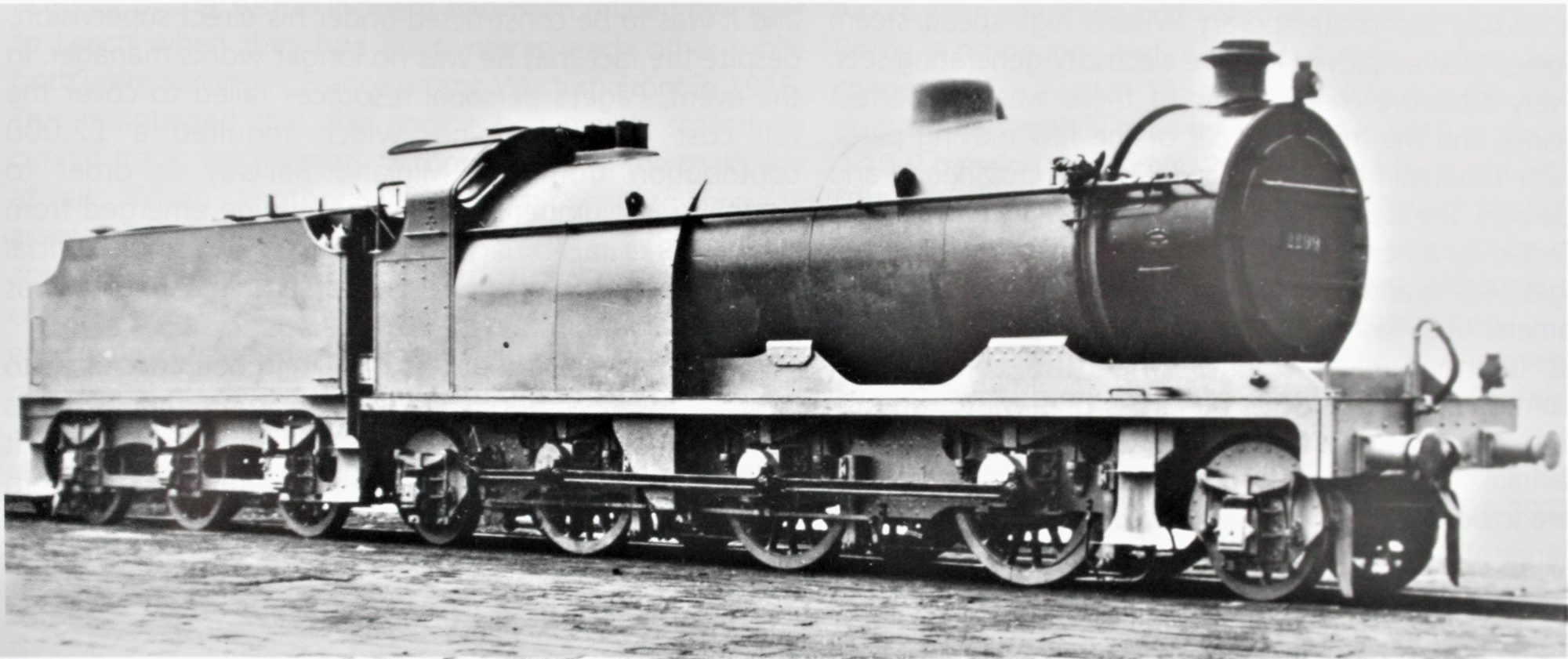

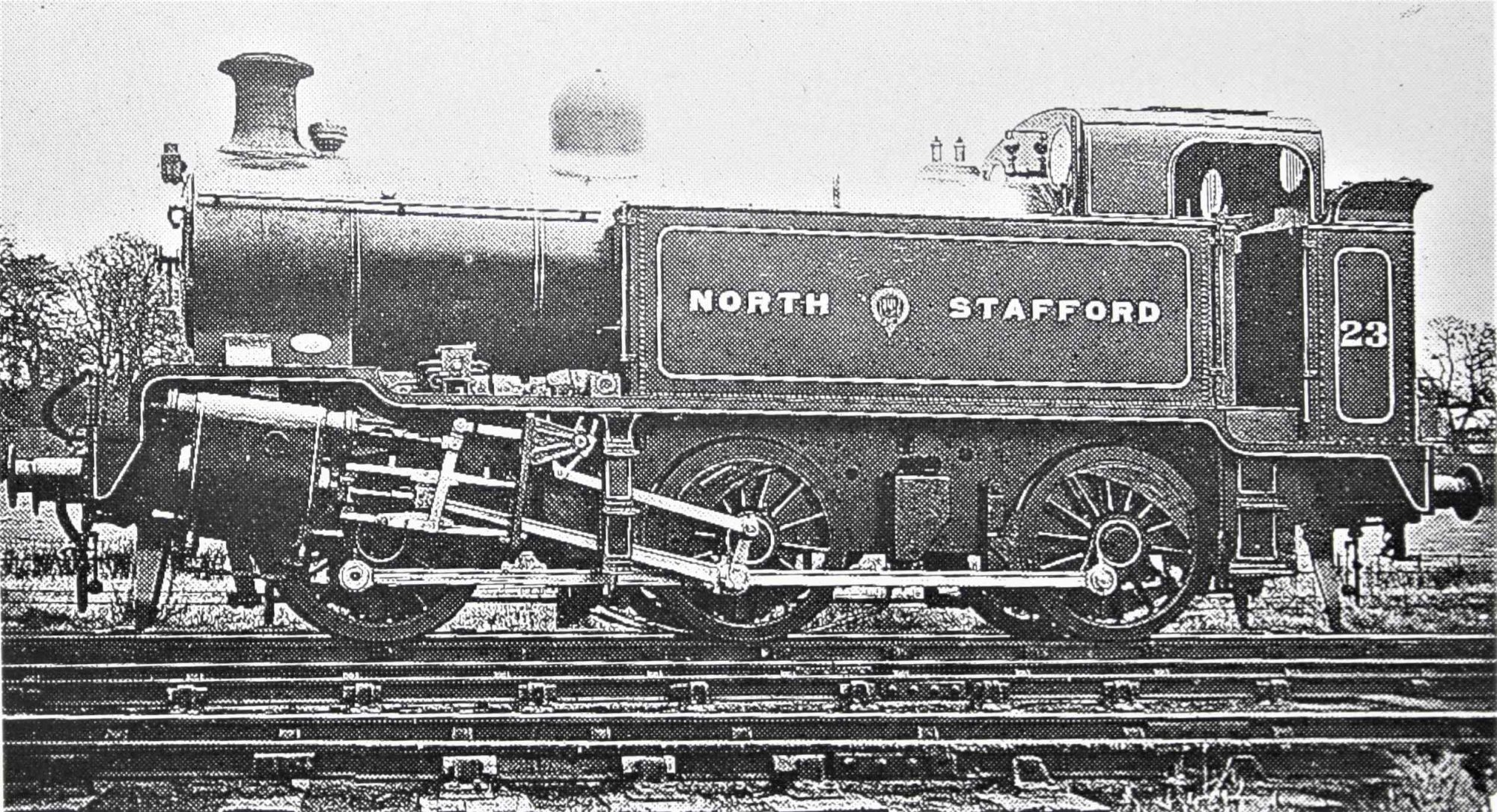

As built, the locomotive, NSR No.23, was intended for passenger work. The North Staffordshire Railway's main routes, put simply, were in the form of a cross - Macclesfield to Colwich (on the LNWR main line), and Crewe to Derby. At its centre was the densely-populated area then known as 'the Potteries' or 'the Six Towns' (did Fenton ever forgive Arnold Bennet for leaving it out of Anna of the Five Towns?), now, in its centenary year, called the City of Stoke-on-Trent.
Rather like the North British in Fife and the North Eastern in County Durham, the 'Knotty' had a monopoly in its area. Lack of competition did not mean a poor service and it was a smartly-run railway.
The area round the Six Towns had a busy local passenger traffic with lots of closely-spaced stations. Mr Hookham's experiment was to see if a four-cylinder locomotive would have such improved acceleration away from the many station stops that it would justify the additional cost and complication. The answer appears to have been in the negative.
Although she was rebuilt as a tender locomotive for freight work in 1924, she has the distinction of being the first four-cylinder tank engine in Great Britain. Numbered No.2367 by the LMS and renumbered 8689 in 1928, she was withdrawn in the same year.

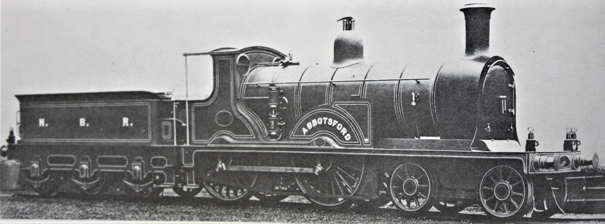

NBR '476' Class - the 'Abbotsfords' - boiler pressure 150 psi. 18" x 26" cyls.

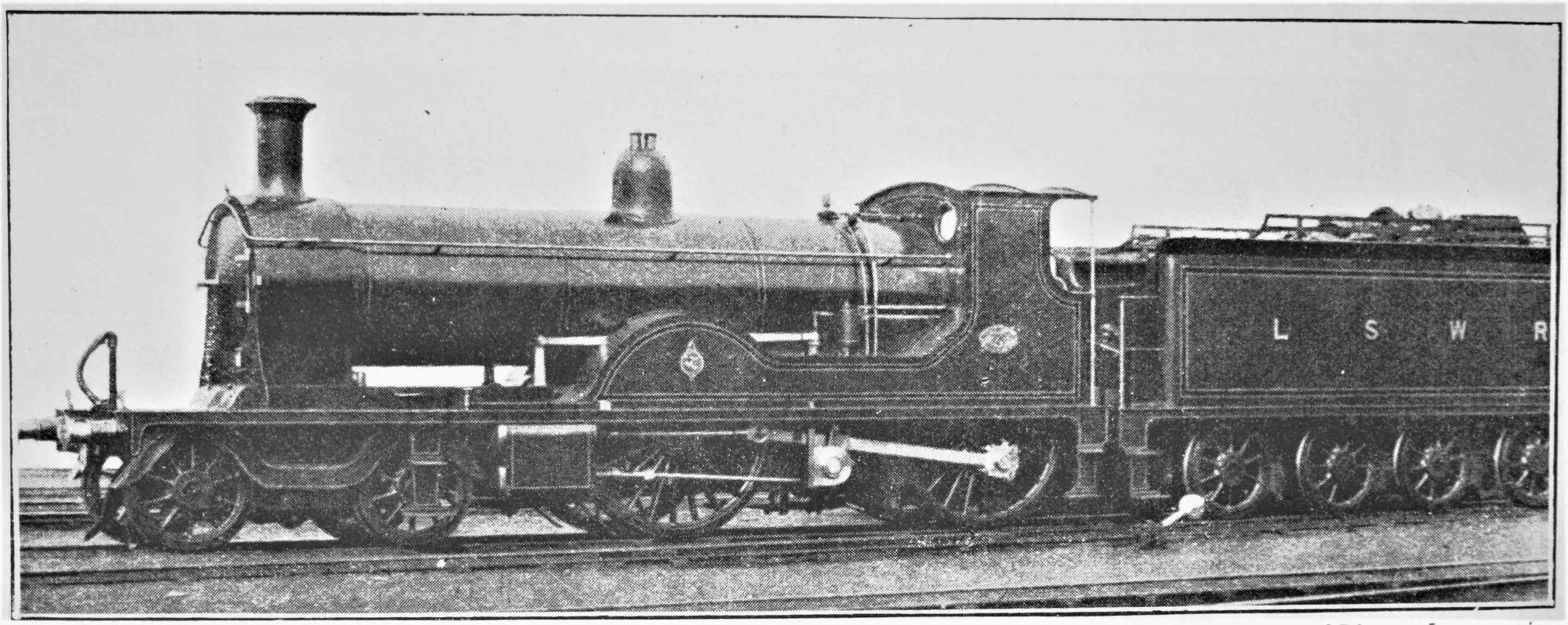

LSWR 'T9' Class - the 'Greyhounds' - boiler pressure 175 psi. 18 1/2" x 26" cyls.

The GWR 'County' 4-4-0s of 1904 had a particular reputation for this misbehaviour. I maintain it wasn't Mr Churchward's fault. The LNWR was to blame with its weight restrictions on the Shrewsbury & Hereford joint line. I believe Mr Churchward, who designed the class with the restrictions of this railway in mind, always considered the 'Counties' as a stop gap. Once heavier locomotives were permitted, they could be dismantled and their standard parts used for new construction. Certainly, they were rough riders; with 18" x 30" outside cylinders and a coupled wheelbase of only 8 ft 6 in, it would be difficult to imagine they would be anything else.
There is a 'back and forward' motion originating from the reciprocating masses of the locomotive's pistons, piston rods, crossheads and a proportion of the connecting rods. As we saw with the GWR 'County' 4-4-0s, there is also a phenomenon called 'swaying couple' caused by the action of the reciprocating parts which is the cause of 'nosing' mentioned above. Both of these, if allowed to develop unchecked could lead to the locomotive becoming potentially so unbalanced that it throws itself off the track.

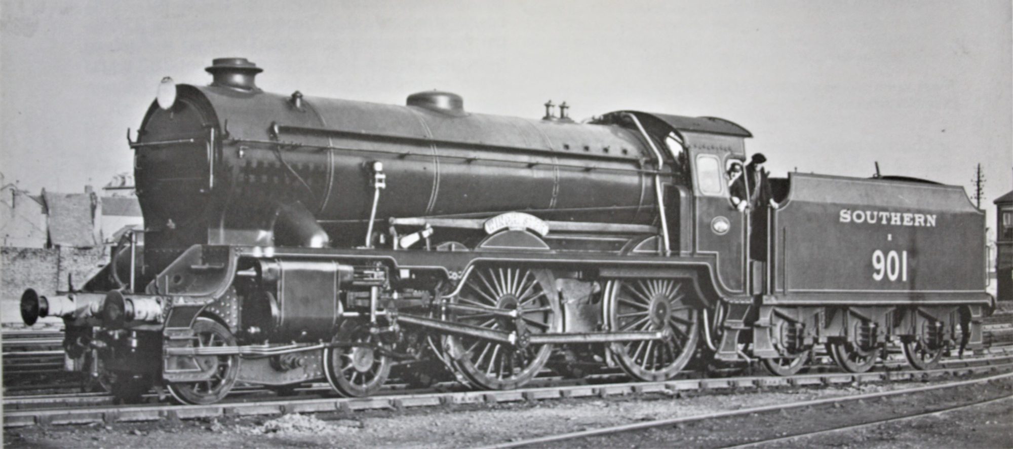

A Southern 'Schools' 4-4-0, again with three cylinders, has a balance percentage of 30% with a hammer-blow of 0.27 tons at 5rps, 70mph.
[SR 'V' or 'Schools' 4-4-0 No. E901 Winchester. Was there a better class of 4-4-0 in Great Britain? Ten-foot coupled wheelbase and three 16 1/2" x 26" cylinders. Like the GWR 'County', the class was designed for a railway with weight restrictions (the Hastings line). The use of three cylinders (and a slightly longer coupled wheelbase) made the riding so much better than the GWR engine. The engine weighed 67 tons 2 cwt but had little hammer-blow.]
Such a reduction in hammer-blow, with consequentially less potential for damaging the track and under-line structures, is an important advantage of more than two cylinders. A good civil engineer will consider hammer-blow when calculating the maximum permissible axle weights for any route. If the civil engineer chooses to be co-operative, a locomotive with low hammer-blow can be allowed a higher axle weight. As we have seen, the LNWR 'Claughton' four-cylinder 4-6-0s had a smaller than optimal diameter boiler due to the civil engineer deciding to be uncivil.

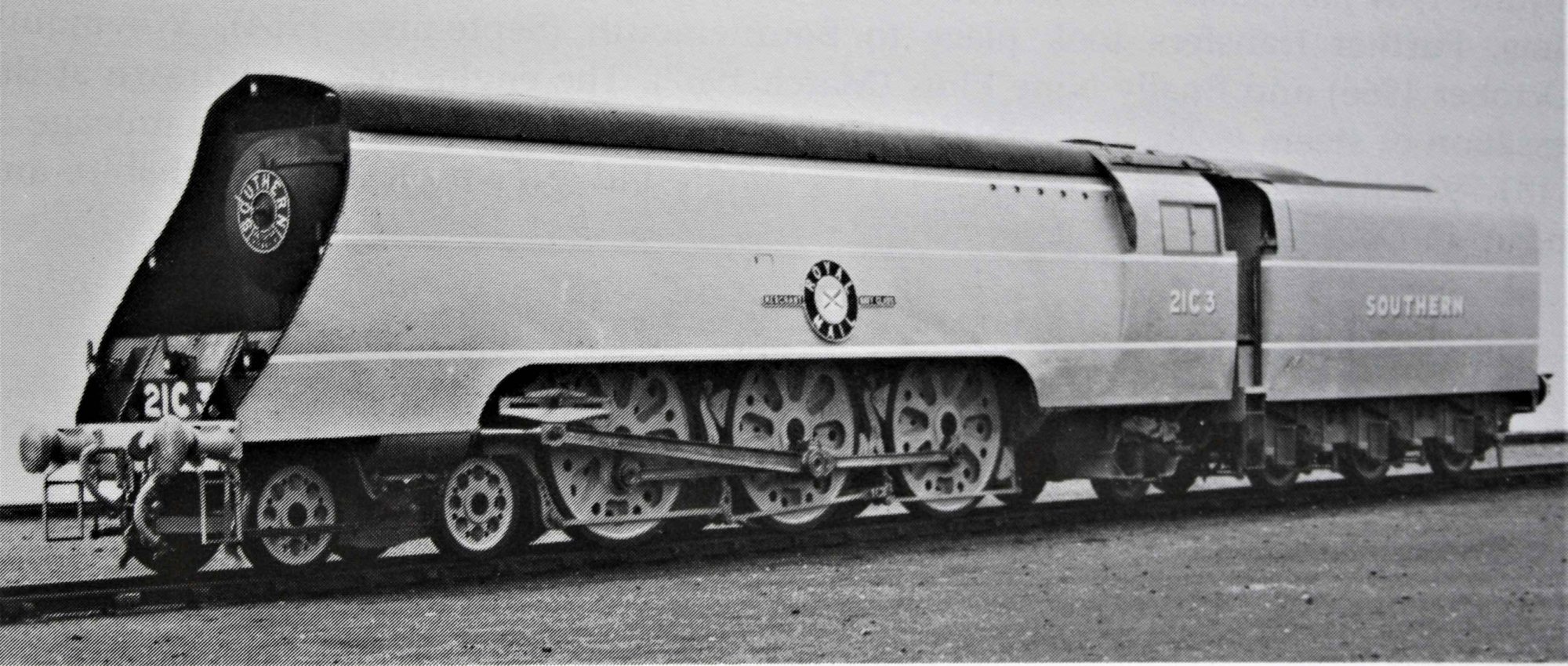

The engineer was OVS Bulleid and the locomotive was the 'Merchant Navy' class 4-6-2.
A few years later, a different team of engineers were designing a 4-6-2. They decided on two cylinders. Percentage balancing of the reciprocating weight from 60% to 30% were considered and 40% was decided on. Hammer-blow was 6.6 tons. The locomotive class concerned is, of course, the BR Standard 'Britannia'.

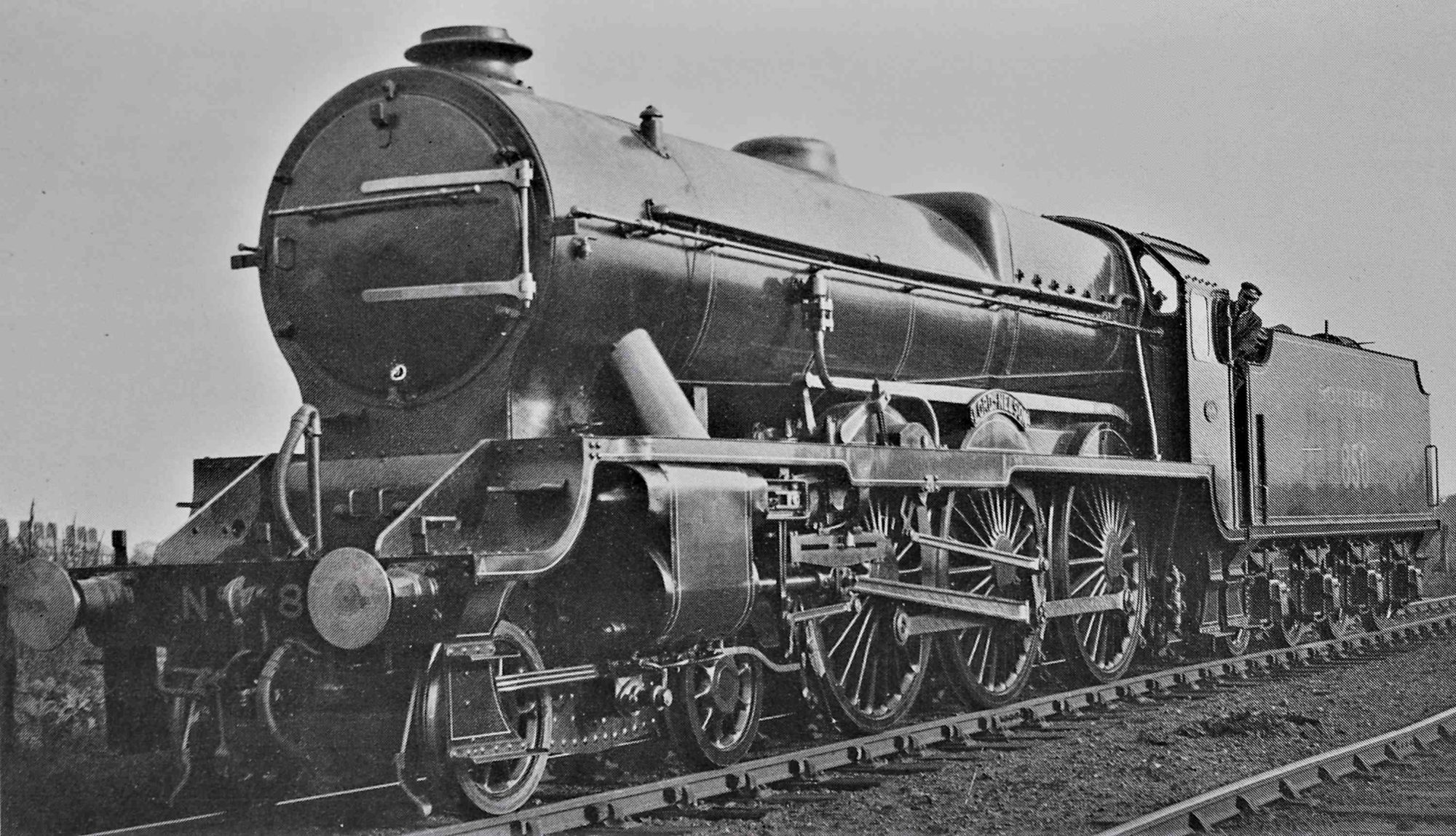

Although the original Urie engines required some improvement, Mr Maunsell's own version of the 'N15' 'King Arthur' 4-6-0, introduced in 1925, was a very good engine indeed. However, The Southern Railway's Operating Department planned to run 500-ton trains (equivalent to about 15 carriages of Southern stock) at 55mph average speed.4 and appears to have projected there would be a requirement for 16 locomotives capable of working these trains by 1928.
Mr Maunsell and his assistants, James Clayton and Harold Holcroft, got to work to design such a locomotive which would comply with George Ellson's limit of axle-loading of 21 tons. They knew not to fall out with the Chief Civil Engineer. The 'King Arthurs' were already over 20 tons axle-loading, so there was not much room for manoeuvre.
To decide whether the new engine was to be a 4-6-2 or 4-6-0, Mr Maunsell made use of his good relations with Sir Nigel Gresley on the LNER and Charles Collett on the Great Western to arrange for Mr Clayton to travel on the footplates of 'A1' 4-6-2 and  'Castle' 4-6-0s respectively. Mr Clayton was highly impressed by the 'Castle' and considered the relatively short distances to be run on the Southern did not require a wide firebox.
Mindful that a 4-6-0 would be cheaper to build and that the 'Castle' had made such a good impression, Mr Maunsell decided on a 4-6-0. The next decision was three or four cylinders. The former SECR 2-6-0, No. 822, which they had designed, had shown the advantages of three cylinders with six beats for each revolution of the driving wheels.
However, Mr Clayton's high opinion of the 'Castle' led them to favour four cylinders, although the GWR practice, with normal 90o crank setting, gave four beats for each revolution of the driving wheels. Mr Maunsell decided to experiment with Mr Holcroft's crank setting arrangement and a Drummond 'P14' 4-6-0, No. 449, which had been superheated by Mr Urie, was converted to eight beats for each revolution of the driving wheels in early 1924.
Tests were conducted with the engine in its original condition and then with the 135o crank setting. The converted locomotive used 10% less coal per ton-mile and evaporated more water per pound of coal. The driver stated he could start heavy trains in a way he couldn't with the unconverted locomotive because the eight light exhaust beats for each revolution of the driving wheels didn't pull the fire about in the engine's shallow firebox in the way four strong ones would have done. The Test Engineer reported in favour of the change and Mr Maunsell agreed that the 135o crank setting should be adopted on the new locomotive.6
No. E850 Lord Nelson left Eastleigh Works in August 1926 and was subjected to extensive test, in which she performed without difficulty. Satisfied with this, Mr Maunsell obtained authority to build the remaining 15 members of the class which entered service in 1928/29.

Five of the class received major modifications in Mr Maunsell's time. The one which concerns us now is No. 865 Sir John Hawkins. It is, I think, an interesting story.
During a meeting of representatives of the Running Departments of the 'Big Four', the Great Western men tried to convince those from the Southern that, contrary to the opinion of Sir Vincent Raven and Sir Nigel Gresley, a train was more rapidly accelerated by a series of 'tugs' than by the smoother tractive effort of the 'Lord Nelson' engines' eight exhaust beats for every revolution of the driving wheels. The Southern's Running Superintendent suggested this to Mr Maunsell, who said he was willing to put it to the test if an opportunity presented itself.
This occurred in 1934 when No. 865 required repairs to the crank axle. During the repairs it was altered to a 180o setting, rather than the 135o standard for the class. As such, the engine now had the normal four-cylinder arrangement of four exhaust beats for every revolution of the driving wheels.

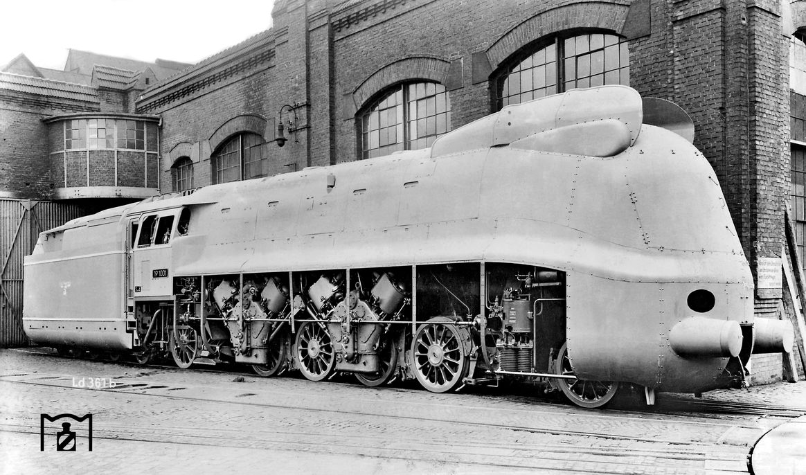

Very interesting, I have never heard of this locomotive with a "flat-eight" engine before.
If you wanted a steam loco with V-eight power then there was one in Germany: the 19 1001 (Henschel's 25,000th locomotive), completed during the Second World War in 1941 :doh:
works photo Henschel, from Eisenbahnstiftung
This was a 2-8-2 (or – as the driving axles were not coupled – a 2-2-2-2-2-2?) where four V-twin steam motors powered the four driving axles. The drivers were unusually small (1,250 mm) for such a high-speed locomotive certified for 175 km/h – just over half the size of the comparable classes 05 and 61 (2,300 mm) – but the 19 1001 was exceptionally smooth even at top speed.
The steam-motor locomotive was one of the more promising and successful experiments of the late steam locomotive era. The 19 1001 was even shipped to the United States after the war for technical examination but steam didn't have a future there, and she was scrapped in the early 1950s.

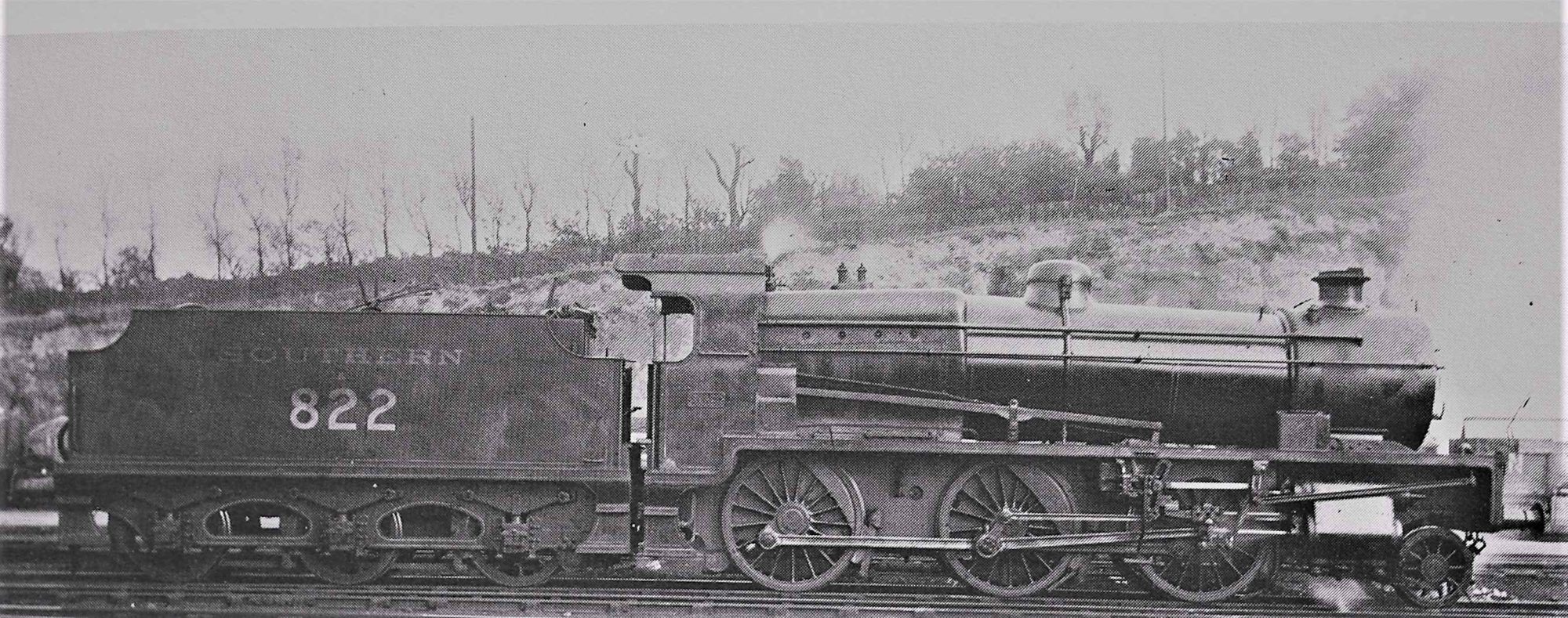

Yes and no. Mr Maunsell got Mr Holcroft to design three-cylinder versions of his 'N' 2-6-0 and 'K' 2-6-4T. These engines appeared in 1922 and 1925 respectively.

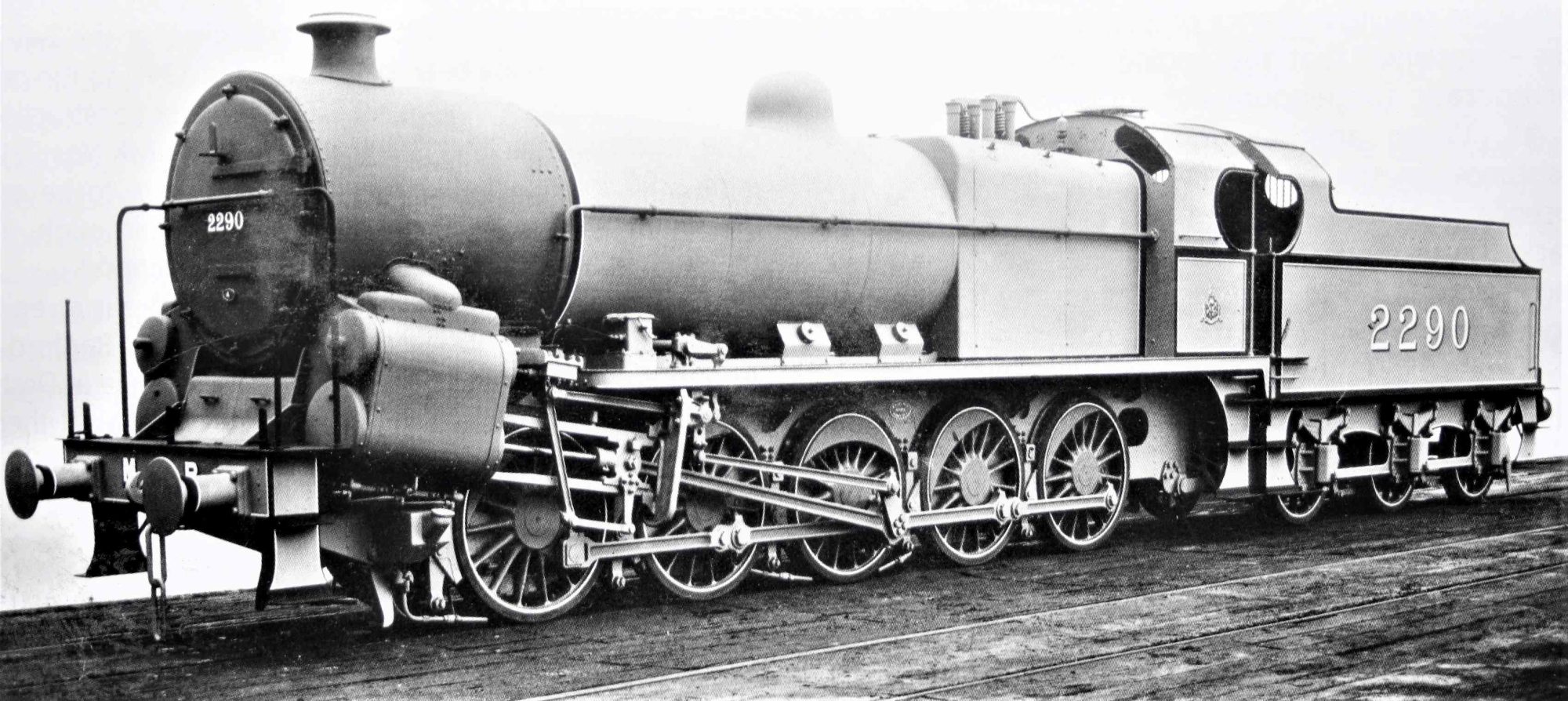

['N1' three-cylinder 2-6-0, No. 822. Completed at the end of December 1922, this was the last engine to be built for the SE&CR.]
['K1' three-cylinder 2-6-4T No. A890. Withdrawn with all the two-cylinder 'K' or 'River' class locomotives after the fatal Sevenoaks derailment on 24 August 1927, she was rebuilt as a 'U1' 2-6-0 in June 1928.]

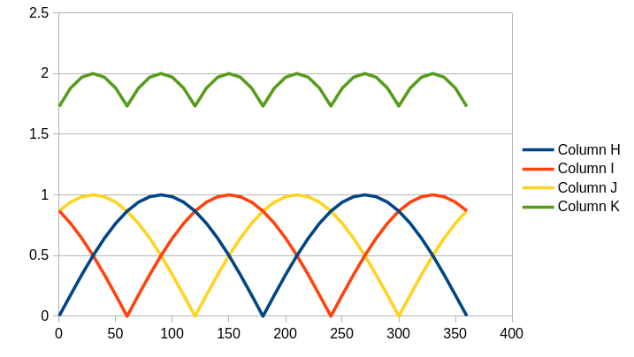

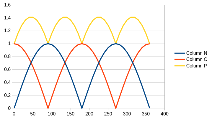

Quote from: Jim Easterbrook on April 01, 2025, 07:47:27 AM... so the torque from one cylinder is a rectified sine wave. Put three of these together at 120° offsets and they add up to a constant torque.
Absolute twaddle! "Rectified" functions are a pain to think about so here are some graphs.
Two cylinders: red & blue are torque from each cylinder, yellow is their sum. This shows the starting torque falling to 71% of maximum four times per revolution.
Three cylinders: red, bliue & yellow are torque from each cylinder, green is their sum. This shows the starting torque falling to 87% of maximum six times per revolution. Better, but not perfect.
