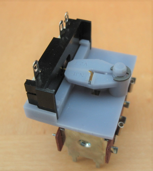

Good answers have been given above.  Here's my take:
I use Peco PL-10e motors mounted underneath the baseboard (not directly attached to the points).
I use Code 55 live frog points. You don't have to do this but I always add a feed wire to the frog via a changeover switch to ensure reliable continuity over the long term.  I prefer the PL-13 black slide switch (glued to the bottom of the motor with epoxy).  I've tried the PL-15 twin micro switches and whilst they work they can be fiddly to adjust for N gauge and also I don't like the "back-pressure" they apply to the point rod.
An added complication is the small throw of some of the code 55 points such as the 3-way and the slips: for those I found even the PL-13 can sometimes be tricky to position so that the changeover switch works reliably.  To get round that I've developed my own 3D printed mount for the PL-13 which includes a lever action to magnify the throw seen by the switch. So far these have worked very nicely on my most recently laid trackwork.
