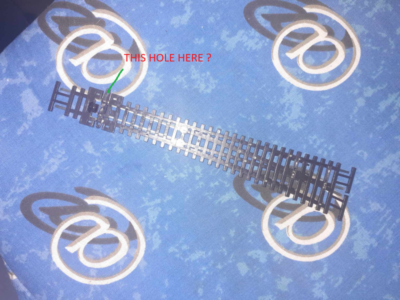

Grassyfield
I see thank you my bad also. Just want to double check it is this hole here right
#35
Yes that is correct, the actuator pin goes through the hole in the end of the tiebar.  If it's as bit tight don't force it, open the hole out slightly with a drill bit or rat-tail file.  The point motor will stick out more on one side of the point than the other.

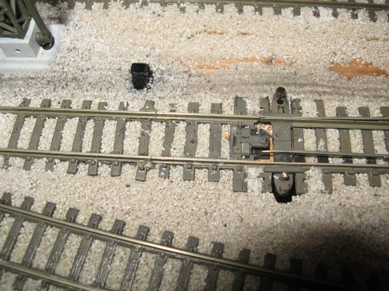

Here you can see the end of the actuator rod up through the tiebar hole nearest to the camera.  The hole in the baseboard is about 8mm diameter.

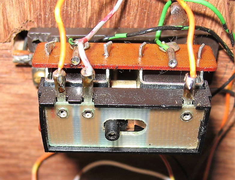

Here's a view of one of my PL10-Es mounted on a PL9 mounting plate and with a PL13 slide switch glued on for the frog polarity
Ignore the fact you can see the baseboard hole and rod on the far left, this was one I modified to make more space. Usually the baseboard hole will be above the middle of the motor.
When fitting the point motor under the baseboard is is important to align accurately to that the motor moves in parallel with the tiebar and also the rod is vertical.  There are different ways of achieving that, I use some scrap plastic jigs to centre both the motor and the blades so that I can then mark the mounting plate screws underneath.  (mounting plate not shown here, I would fit that to the motor first).
