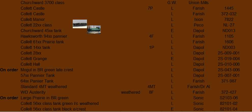

Being somewhat nerdy (aka anal) I keep a spreadsheet of all my locos, coaches, wagons etc with filters to help searches.
I'm 97% complete in taking pics of my locos as I thought it would be a good idea to have all the info in one place but, and this is the ball ache of doing so, the real PITA is resizing the pics with all the adjustments necessary so I can get things down to a size like this..........
Apologies for the 'nappy brown' background but I'm also ana nerdy enough to use colours from my Ian Allan Locospotter days. (Western Region was brown)
If anyone has any helpful suggestions other than 'don't do it' I'd be pleased to hear them

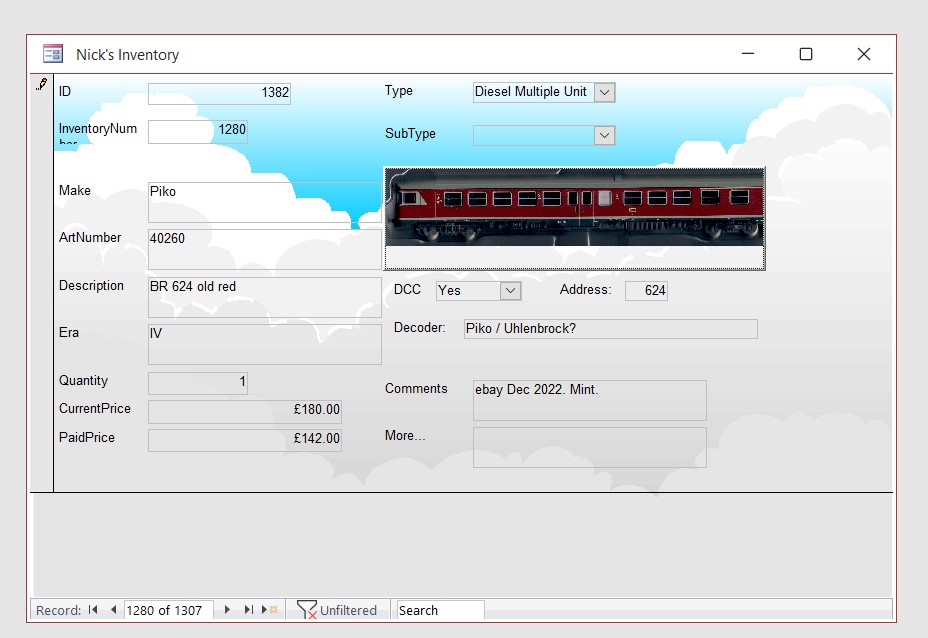

I found it a bit messy in Excel though, so I changed to using an Access database instead. I'm still pasting in small images of each item.
