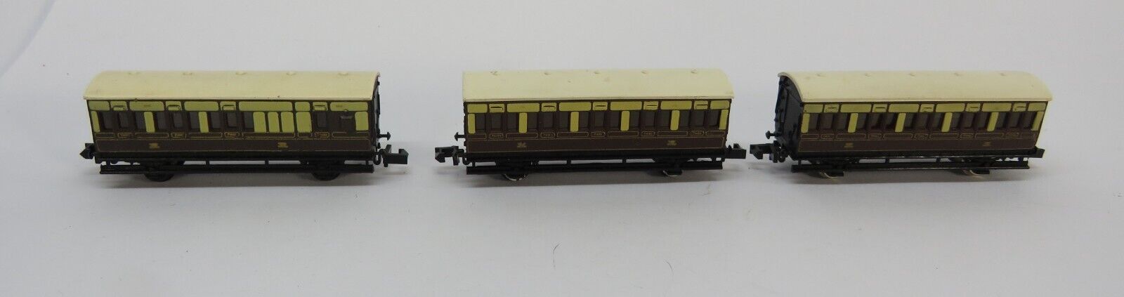

Suggestions please for suitable chassis, or how to repair axle boxes on GraFar 4 wheel coaches?
I've got some more 4 wheelers coming, and need to replace or repair the axle boxes, or replace the chassis. Ideal would be Dapol's 6 wheel chassis, but can't find any cheap chassis.

The old 1970s "U-bend" coupling version I see :) The plastic's probably starting to get a little brittle.

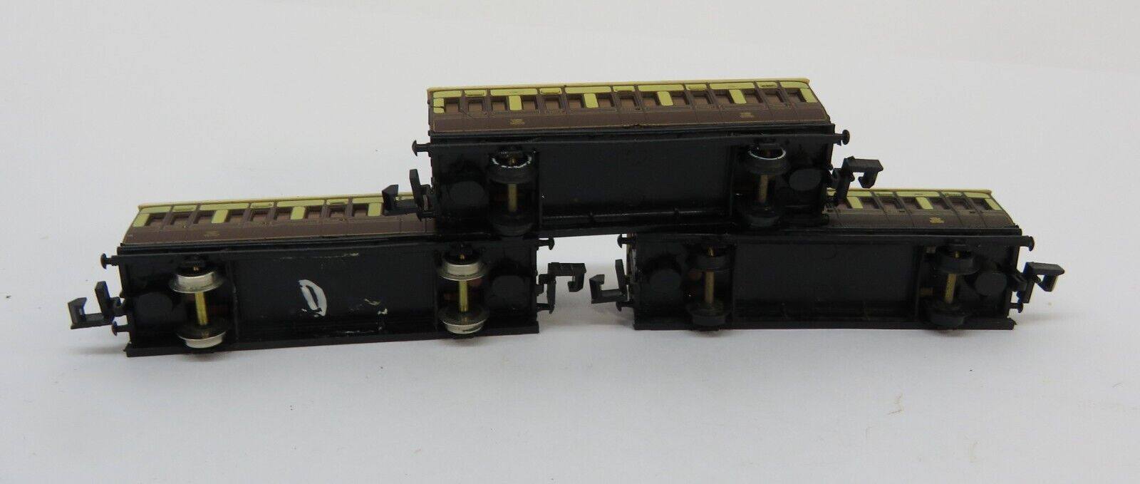

It doesn't look like the wheels are about to drop out from the photos. What's wrong with them? Wheelsets can be changed without swapping the whole chassis.
Dapol's six wheel chassis from the Stove-R is available for £7.20 from the NGS Shop.
Another option might be a brake-van chassis. Peco's is probably the least expensive.
If the couplings are showing their age then they can be cut off and replaced with new ones from either Peco (NR-102) or Dapol (2A-000-014).

Axle boxes are worn on a number of coaches, I've got around 30 4 wheel coaches. One has no couplings at all, two are Shredded Wheat. - and they just look good with 6 wheel chassis under them. I'm aware of the Dapol chassis on NGS

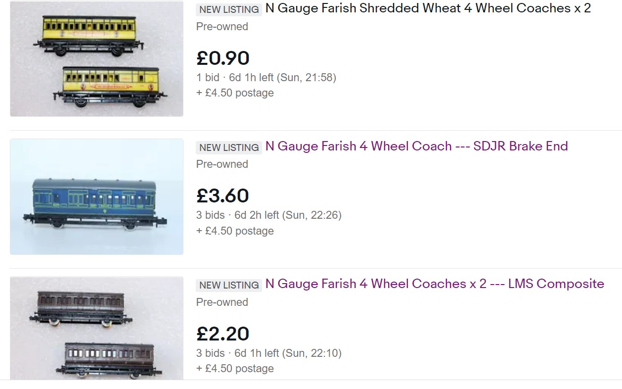

What do you class as cheap? I'm amazed that one seller is still trying "Buy it now" for £45
£10 or less.  There are some rarer liveries which can command a bit more (eg. S&DJR blue?) but the standard liveries are still common.   Looking at current ebay there are a few unboxed singles and pairs hovering at less than £5 current bidding, though of course you have to factor the postage on top.

Axle boxes are worn, as in axles move, and move up as in chassis lower

Go back in 6 days and have another look at those coaches currently listed at £2 - £3.

@mark ellis  yeah looking at recent completed listing some boxed ones go high, some sold by best offer (I wonder how much?) some re-list as they're priced too high, but I still see some singles and pairs sold for £10-£13-ish each including postage.  eg. in May 3x original Grafar red boxed in great condition sold for £24.99 +£5 p&p.
As I say, if you manage to get to shows or swapmeets they can be found for £10 ish - always make an offer :)
Of course that may still be more than you want to pay if you only want the chassis so look out for the spare/repair and job-lot bundles :)
Have you tried fitting brass top-hat bearings? £4 for twenty from N Brass Loco:
https://www.nbrasslocos.co.uk/fitall.html#BEARING
(part number 23818).
Peco also sell them (NR-91, RRP = £5.30).
Drill out the existing axle bearing holes to 2mm (usually, double check with your bearings). Glue the replacements in the hole making sure they're as square to the chassis as you can get. It's also possible to melt them in place by pushing them into the plastic using a clean hot soldering iron. I've never been brave enough to try the soldering iron method.
As others have mentioned, it's also possible to extend the Peco chassis - slice in the middle and fill in the missing solebar/chassis with plasticard. It's possible to get C channel strips that are about the right dimension.
