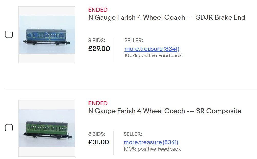

@mark ellis  yeah looking at recent completed listing some boxed ones go high, some sold by best offer (I wonder how much?) some re-list as they're priced too high, but I still see some singles and pairs sold for £10-£13-ish each including postage.  eg. in May 3x original Grafar red boxed in great condition sold for £24.99 +£5 p&p.
As I say, if you manage to get to shows or swapmeets they can be found for £10 ish - always make an offer :)
I've seen the S&DJR coaches go for £100 before now
Union Mills appreciation group on Facebook, and unnamed Union Mills website

Quote from: mark ellis on July 18, 2022, 05:08:05 PM
Quote from: ntpntpntp on July 18, 2022, 10:00:15 AM
The old 1970s "U-bend" coupling version I see :) The plastic's probably starting to get a little brittle.
These old coaches are usually quite cheap on second hand stalls at shows.
What do you class as cheap? I'm amazed that one seller is still trying "Buy it now" for £45
If its a SDJR one, he'll probably get it.
LMS generally sell for £30 each, GWR £25 each. These are VERY sought after coaches which, even in these financially difficult times, go for strong money.
