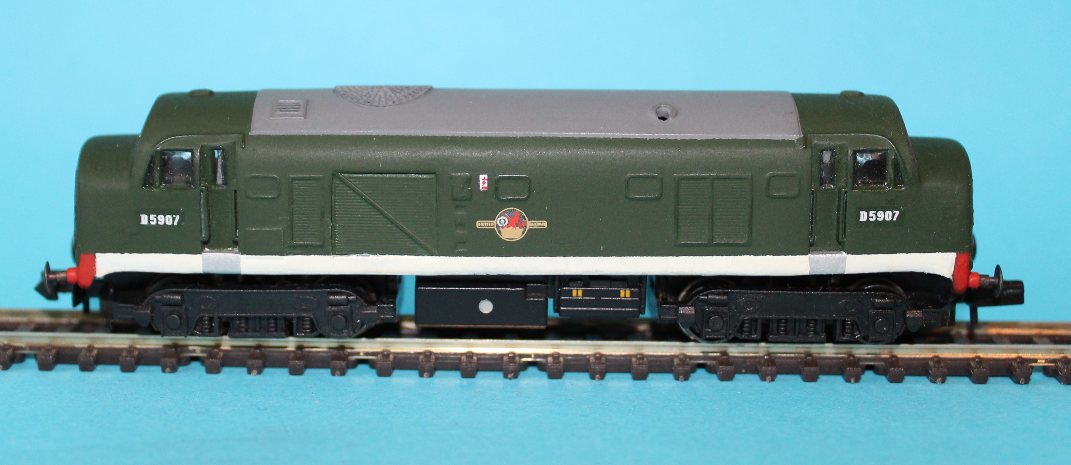

Many years ago, I bought a Sliver Fox Models Class 23 "Baby Deltic" kit (disc headcode version).
The kit was made of resin and the instructions state that the body fits either a Graham Farish Class 25 or Class 33 chassis.  As @Bob G said above, the chassis for the Class 25 and 33 are the same.  When I held a GF Class 25 chassis up against a Class 33, the wheelbase was identical.
I never bothered to fit the replacement resin underframe tank or the Class 23 bogie sideframes.
The photo shows this model mounted on a Grafar (made in China) Class 33 chassis.
Ian
